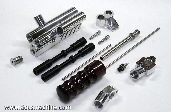

DocsMachine
Sep 16, 2006
1,888
How about parts for a double-barreled paintball gun? :D
I made every piece shown, on manual machines.
Doc.

In reference to what are good machinist message boards: I like the Hobby Machinist. It's a great place for regular dudes to be introduced to machining and machines. The Pratical Machinist is horrible for regular decent people. I go on it often, but only to keep up with the business side of manufacturing, and I probably haven't posted anything in the past 10 years or so.
As for myself, I have many glamour shots of past work. I used to work for a small outfit making non-destructive testing (NDT) equipment. I loved everything but the pay. I was one of two "manual" guys doing the short runs, 2nd ops (finishing stuff off a cnc), and prototyping. Probably the best perk was working on my own stuff in my own time. Unfortunately this is a no-go where I work now. Although I have a couple tackle boxes full of "sample" parts from my current job, I have no pictures... yet. But here's a few pictures of stuff from my NDT days. Each part was completely made by me. I didn't bother taking pictures of all the other stuff I didn't 100% machine. Main equipment: Sharp vertical mill with Prototrack retrofit and Monarch 10ee lathe.
Damn, that is some amazing, small work.
