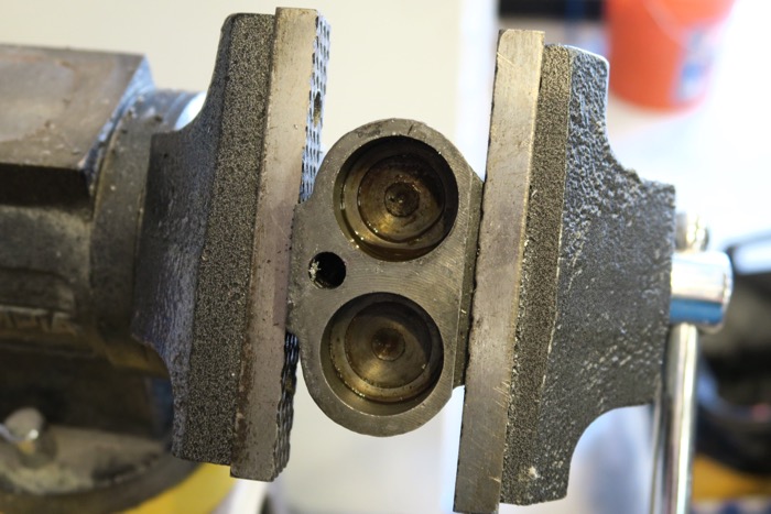

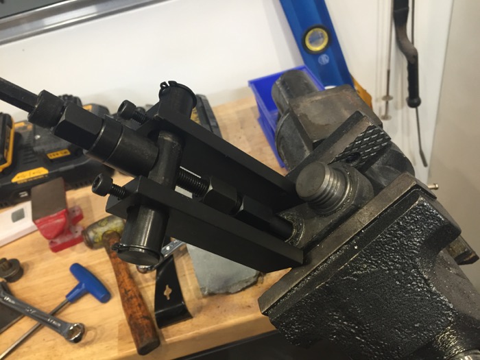

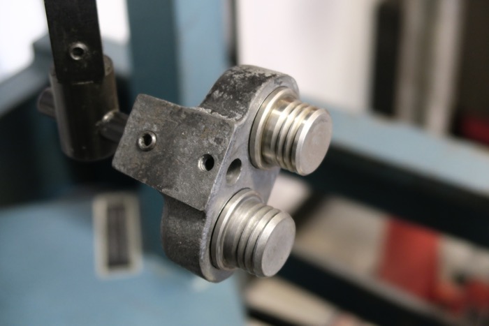

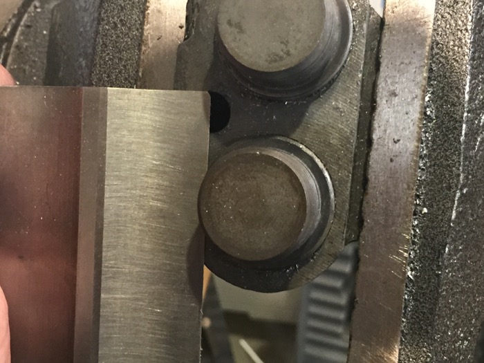

More remedial repair for the bandsaw. Honestly, that machine shop should be ashamed. These are all repairs that would have been squarely in their wheelhouse. I guess they just didn't care.

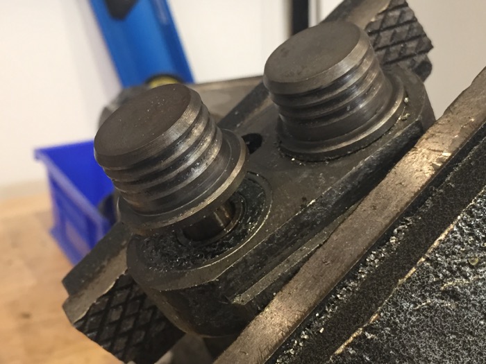

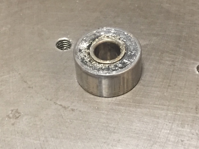

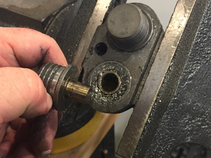

The upper set of guide rollers was jammed with swarf and junk, to the point where one of the rollers wouldn't turn. I hit it with some WD-40, and eventually got it turning mostly freely, but it was clear the bearing was a bit, errr.... crunchy. So fix it I must.
Of course, it's a blind bearing, with no way to push it out from behind. For that matter, the roller itself doesn't have much to hold on to. That's okay, because I've got these awesome titanium wedgy-thingies that a friend of mine gave me!
Just insert one on each side and give it a few taps with a small hammer:
Making progress:
A bit more:
And out:

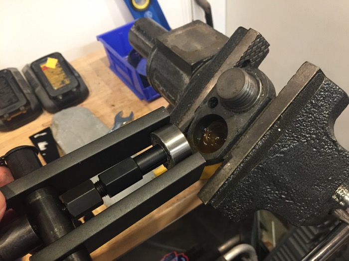

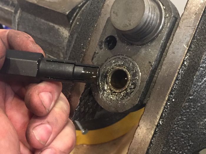

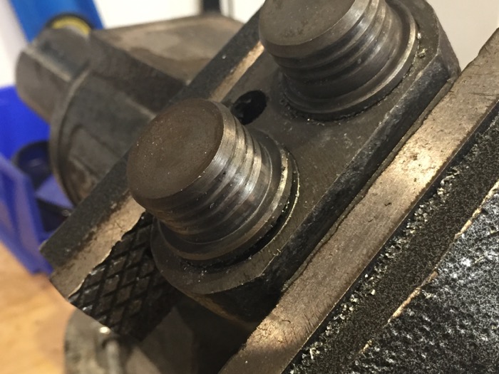

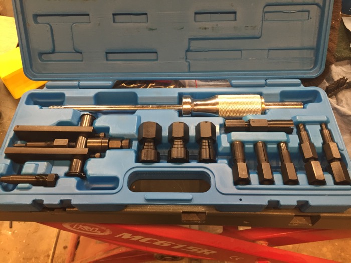

Okay, now for the bearing itself. As I said, this is a blind bearing, so no way to push. And that's why I own a bridge puller set! I haven't used it many times, but when I need it, it's a joy to use.
This end goes in and grips the bearing from behind:
Then a screw goes in the back to expand the end:
Then we erect a bridge to push back on the housing:
And as we start turning the forcing screw, out comes the bearing. Like butter:
Voila! The whole job was maybe 20 minutes.

Shouldn't there be some kind of protection guard parallel with the guide bar?
Yep. It was missing when I bought it. I'll probably fabricate something to fit there. The original is just a thin piece of sheet steel, bent at 90°, with a short rod welded on the end.

Would you mind share the details on your bridge puller set? I have seen that puller style used with a slide hammer, but the bridge looks to be much more useful.
Modern Jess
Jan 2, 2011
1,362
Bay Area, California
Sure thing. This particular one is officially called a Motorcycle Blind Bearing & Bridge Puller. I probably bought it at Amazon (which is where that link leads). It has a slide hammer, of course, but the bridge part (which has an adjustable width) is, as you say, more useful.
If I can answer any other specific questions about it, let me know.

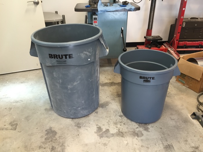

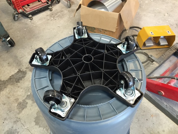

This will probably not be a very exciting post, but it marks a bit of a milestone for me.
I've had the big trashcan on the left since the beginning of the remodel project on our house:
My contractor bought it to aid with general debris management, and since it was on my dime, he left it when the project was over. I've used it extensively since then, as it fits the giant 55 gallon super-heavy-duty contractor bags rather well. The downside is that those bags won't fit in our curbside trash bin, and any extra trash not in a bin has to be put in a 32 gallon bag, with a paid sticker attached. So that has meant I've taken many, many of these bags to the dump. And that's been a workable solution, since the construction of the shop and organization of all my **** has meant lots of other reasons to go to the dump.
With construction winding down, though, the opportunities to take a load to the dump have been dwindling. I made a run yesterday, and it was actually a bit of a challenge to fill up the truck.
Time to transition to a new model. The can on the right in the picture above is a 20 gallon model, which fits the 32 gallon trash bag pretty much perfectly. I should be able to fit those bags into our trash bin, once we upgrade our service to the next size (we have a very small bin at the moment).
So I'll have to empty it more regularly, but that won't mean a trip to the dump.

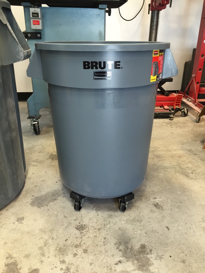

Of course, I couldn't leave well enough alone. I've said all along that everything in the shop has to be on casters, and this is no exception:
The rolling base was originally meant for large potted plants, but I think it will work just as well for a fully loaded garbage can.
Lu-Max
Jan 8, 2014
745
I use the same bucket with the detachable Brute rollers. I have a spare set actually, but probably too late for you.

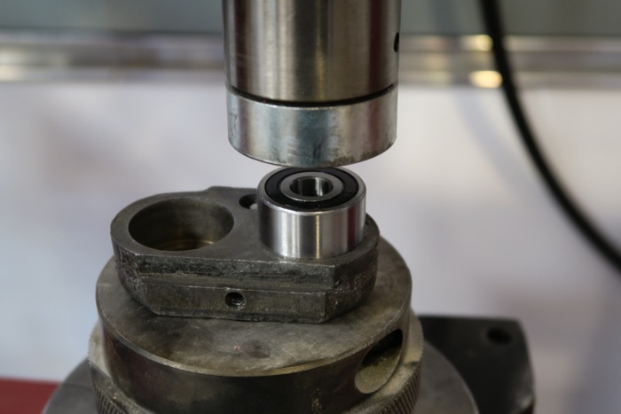

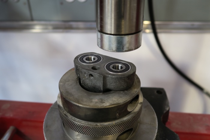

I decided to go ahead and pull the second bearing out of the guide housing, since the first one was full of rusty liquid. Sure enough, the second one had some muck trapped behind the bearing. Not nearly as much as the first, but enough to be problematic.
Pressing the new bearings in:
And here's the finished part, mounted back on the machine:
Note that one of the guide rollers is a different color than the other one, as I replaced it. The one that was stuck had become faceted from the blade dragging against it. It wasn't much, but enough to think maybe I should replace it while I had it off. Fortunately, the guy that got me into the Roll-In saw to begin with had some extras squirreled away and gifted me one. Good timing!
Getho
May 29, 2010
12
Melbourne, Australia
Its not often I'm impressed with a bin!
Out of curiosity, do you have any details on that press? I'll need to press in some sprocket dampeners soon and was considering buying a press instead of hammering them in.
Heh. It was more symbolic than anything, though I've found in the last two days that being able to easily wheel it over to wherever I'm making a mess tends to keep the mess down.
I do. It's a Torin Big Red 20-ton press. I specifically wanted one with a gauge, and specifically did not want a bottle jack. It's a pretty good press -- better than I thought it was going to be for what I paid for it. It's primary use for me was pressing in (and out) Vespa final drive gears. One of them (the axle) takes a tremendous amount of force to press. If there's a mismatch in the tolerances of the parts, they sometimes take well in excess of 40 tons to separate, though generally it's between 5 and 15 tons. It's a little big for my needs (Vespa gears are small) and barring the occasional need for 40 tons (which is obviously out of reach of this one) I could probably stand to have a smaller press taking up less space.
What I really want is a bench top 20-ton press, but I haven't found any of those.

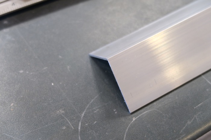

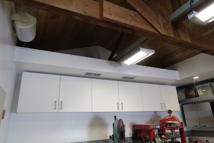

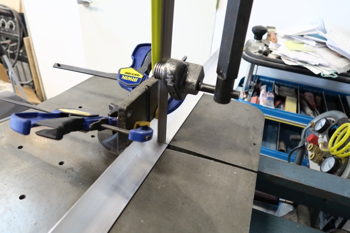

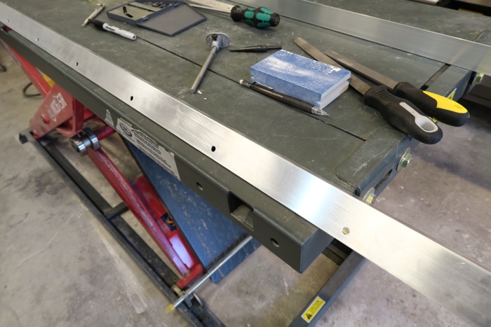

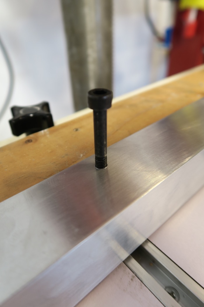

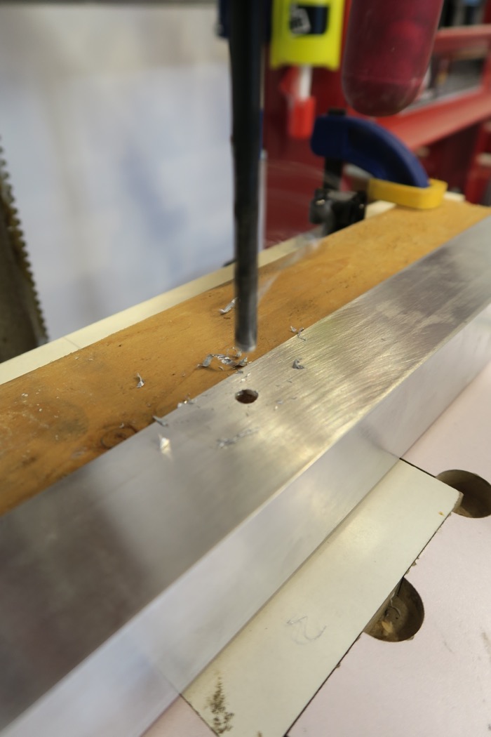

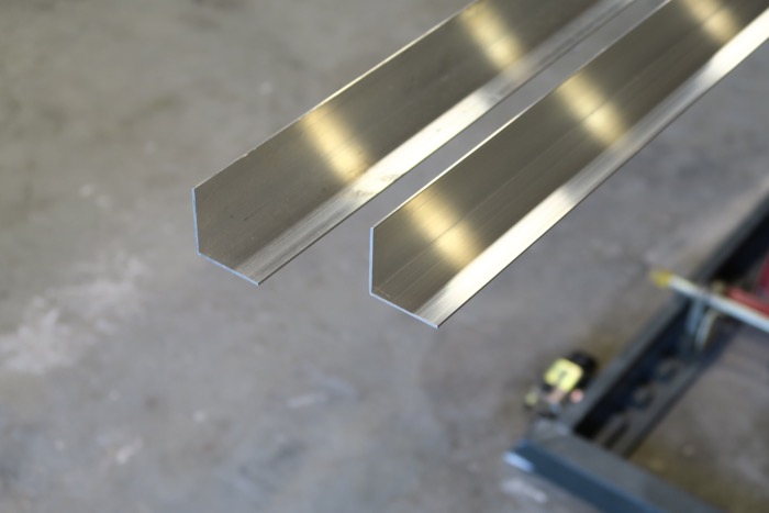

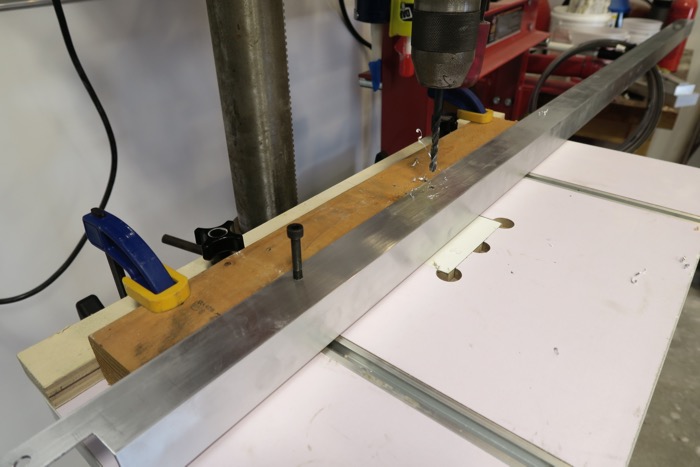

Time for an update. I'm at the point in the project where I'm doing trim / finish stuff, so I have to actually be careful. So many sins are hidden by finish work, but when you get to the finish work, where are you going to hide those sins? :dunno:
I've been putting off finishing the back storage loft for a while now. I really didn't want to climb up there and stuff myself into the tiny space so I could mud / sand / tape / paint. I wasn't wrong. When I finally did, it was a giant pain for such a small space. Many times I thought about just starting to pile stuff in there, since I'll never see the wall again, but I resisted that (very strong) temptation. I finally completed that part a week or two ago (sorry, no pictures -- kind of boring) and now it's time for the final detail.
I need to finish the transition between the plywood shelf and the drywall facing. It's just kind of painted over at the moment, there are a few gaps, and in person you can see the transition between them:
This is what I'll be using as trim:
My new band saw made quick work of cutting through the angle aluminum:
And left a nice clean edge:
I did some math to figure out hole spacing, and set up a simple pin jig on the drill press:
This gave me a piece of trim with nice consistent holes:
I then used some big fat SS #12 round head sheet metal screws for a kind of bygone industrial look, and attached the pieces to the loft. Voila!

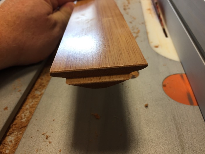

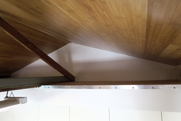

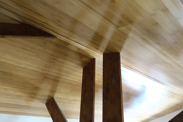

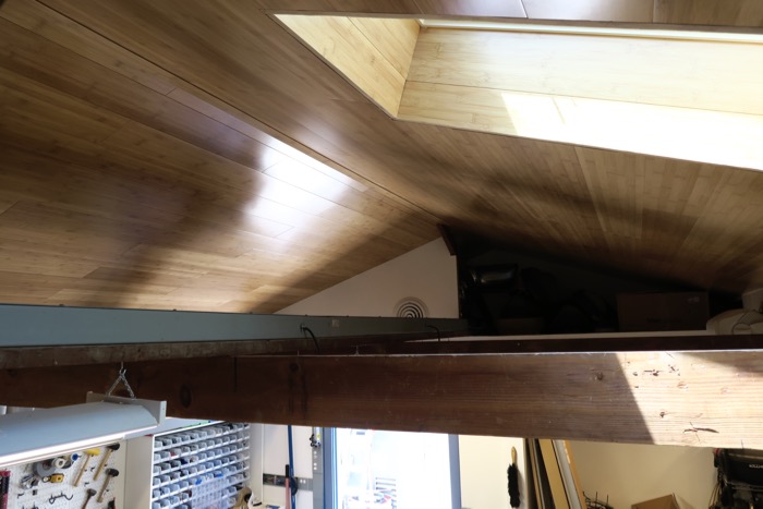

For my next bit of finish work, I'd like to draw your attention to the ceiling. I started work on the ceiling in late 2012, and it's now early 2015. I've been putting off the little details (mainly around the peak) because... well, it was hard. There's fiddly bits to cut around, it's hard to get the tongue-and-groove pieces into the peak, and there was still a gap running right down the center.
Time to stop whining.
I spent a day getting the odd pieces to fit around the obstructions, which involved heavy experimentation with some very extreme angles on my compound miter saw. And yes, I did end up cutting off another piece of the aluminum fence by mistake. Also, a lot of hand cutting with a pull saw, and a fair amount of whittling with a utility knife. Eventually, I got those pieces to fit.

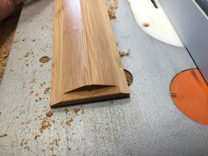

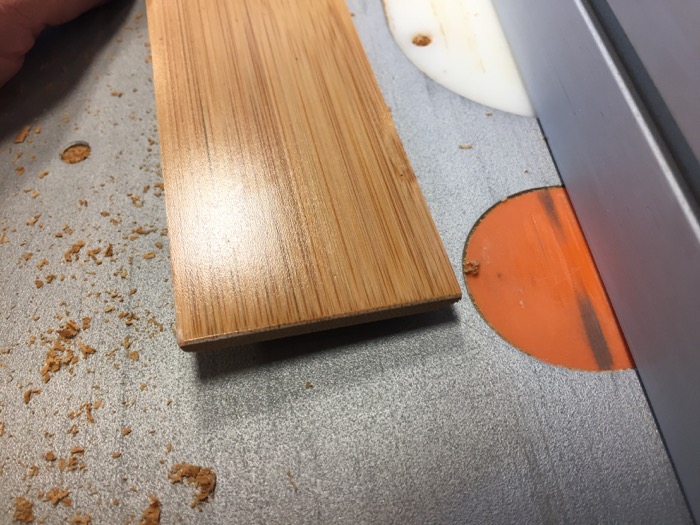

The final detail was a piece of trim to run down the center of the peak and hide the gap. I've been looking around for a suitable piece of trim stock, to no avail.

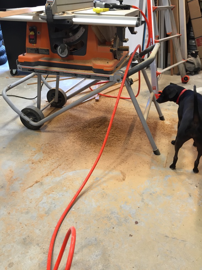

So I made my own. I've got a table saw. And I've got a bunch of leftover bamboo TnG flooring. What more do I need?
Here's the finished piece of trim. It involved ripping down pieces of flooring into two-inch strips, and then making blind angle cuts into those strips. My table saw was pretty unhappy by the end of the process -- I think I dulled the blade pretty badly. But I made enough of these to finish the ceiling:
Stella, inspecting my work:
And the finished ceiling:

That looks like what I want my floors to look like!
Then all you need is a big pile of bamboo flooring. ;)
This stuff came from HD, and it was not cheap, but not expensive either. Somewhere in between, though at this point I can't remember specific prices. I chose it because it was TnG on all four sides, solid bamboo (three layers, actually) and finished / sealed on all six sides.
And bamboo has excellent dimensional stability. All the better.

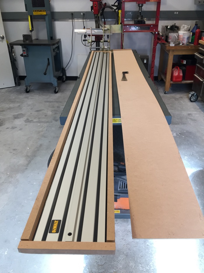

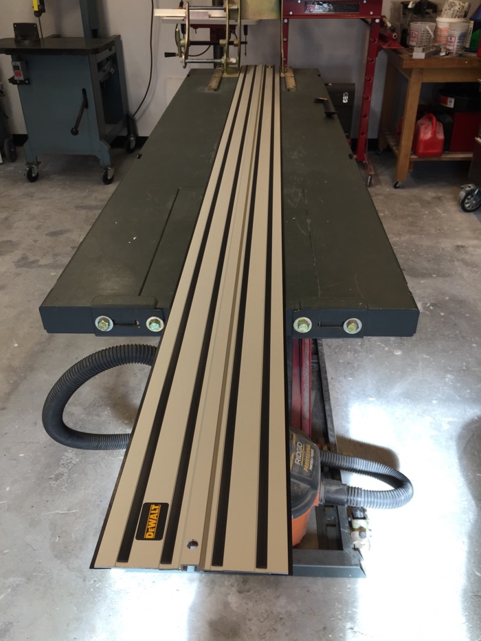

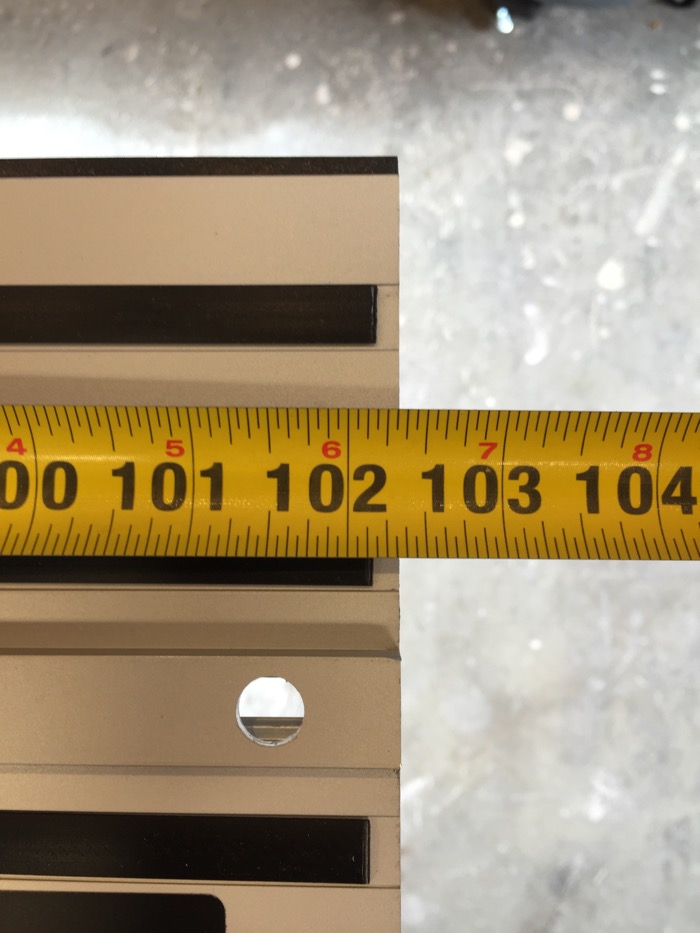

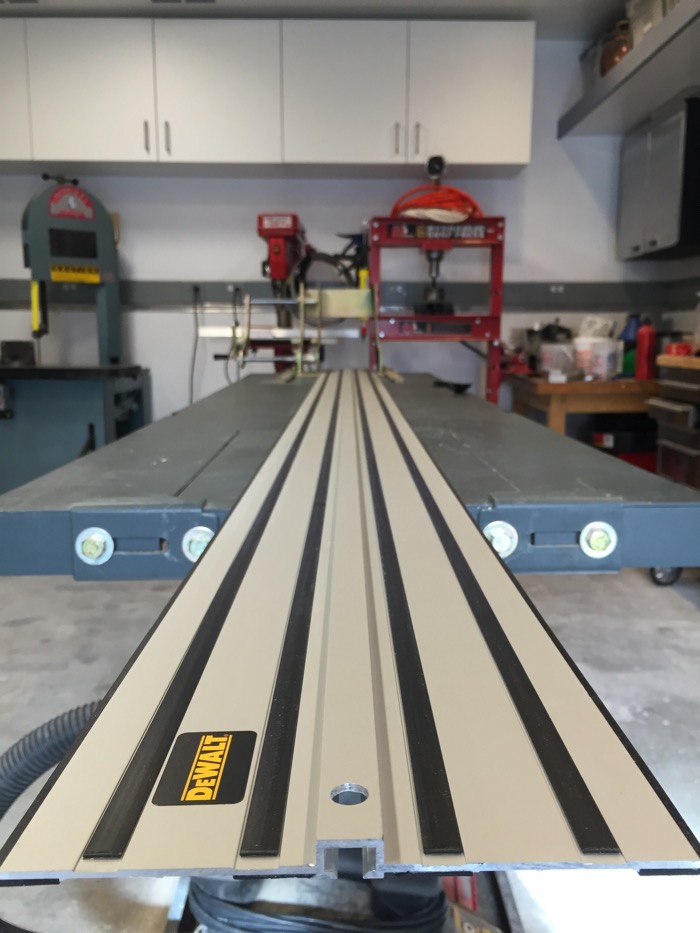

This showed up recently as well. I am perhaps abnormally excited about it. It even comes in its own specially-built wooden crate.
It just goes on forever...
This should be sufficient for ripping a full sheet of plywood.
Rockcam
Jan 16, 2010
256
Grand Rapids
Jess:
102" track will be great for breaking down sheet goods. If memory serves, you are a Festool fan as well - what made the DeWalt a better choice for you?
