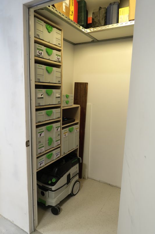

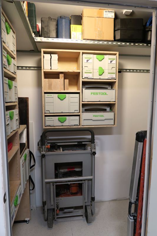

This weekend, I was able to make some progress on the compressor closet. I've intended all along to make the most of the closet, given how much precious floor space I permanently carved out of the shop. Initially, the closet was only intended to hold a compressor, and nothing else. I had some issues figuring out how to not have the door to the closet interfere with everything else, though, and the surprising solution was to make it bigger. This allows the door to open in a spot where it doesn't interfere with anything, while also giving me some extra wall space (both interior and exterior).
Somewhat accidentally, the alcove inside the closet ended up being just about perfectly sized for the standard Festool systainer box. This shelf holds almost all of my systainers, plus makes a space for the CT26 vacuum. I should also point out (full disclosure) that most of these do not actually hold Festool tools -- I like Festool, but I like the systainers even more, and use them to store most of my oft-used woodworking tools.

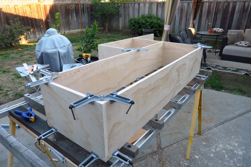

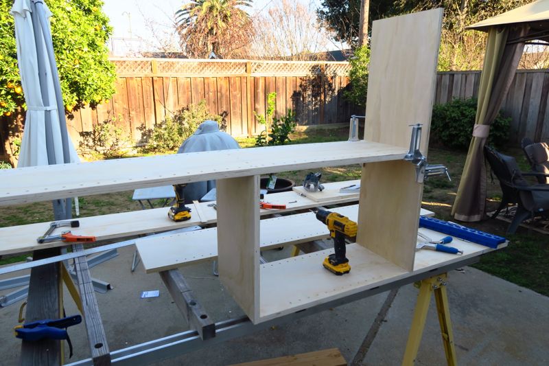

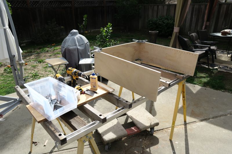

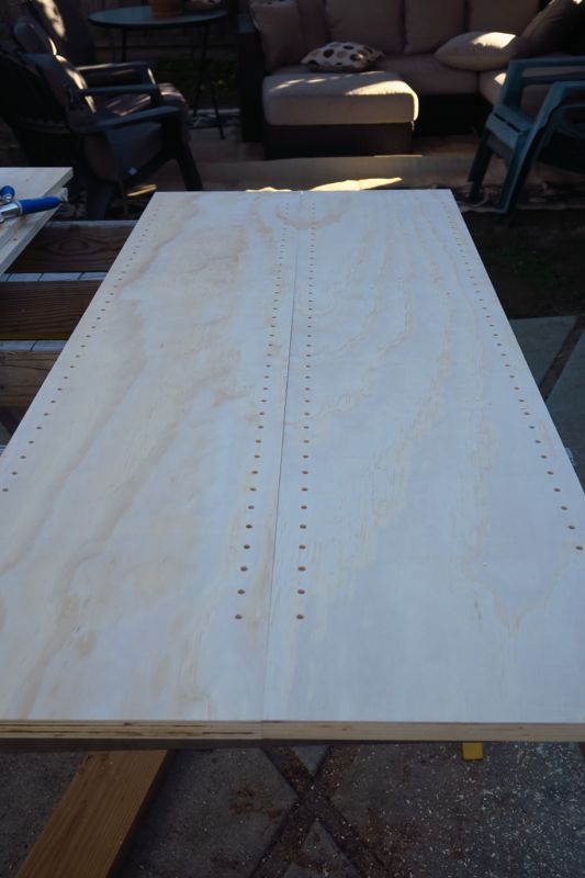

Here's the starting point, using my DeWalt tracksaw to break down a sheet of plywood. I ripped one sheet into four perfectly matched 11.25" x 8' pieces.

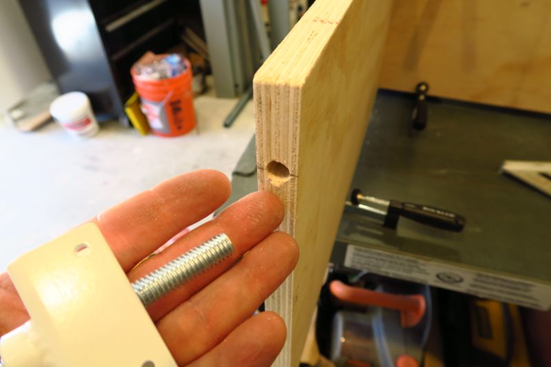

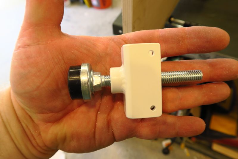

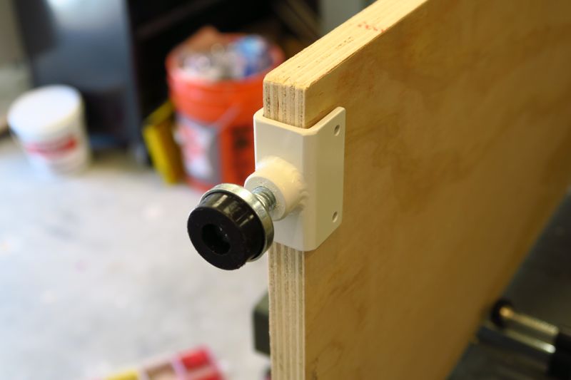

One of the problems I had to solve was how to keep the edge of the shelf off the floor. I went to talk to my machinist friend to ask him for ideas, and he ended up making these awesome foot adapters for a panel edge. Clearly, he's a much better welder than I am. And he painted them, too! I am going to owe him for this.

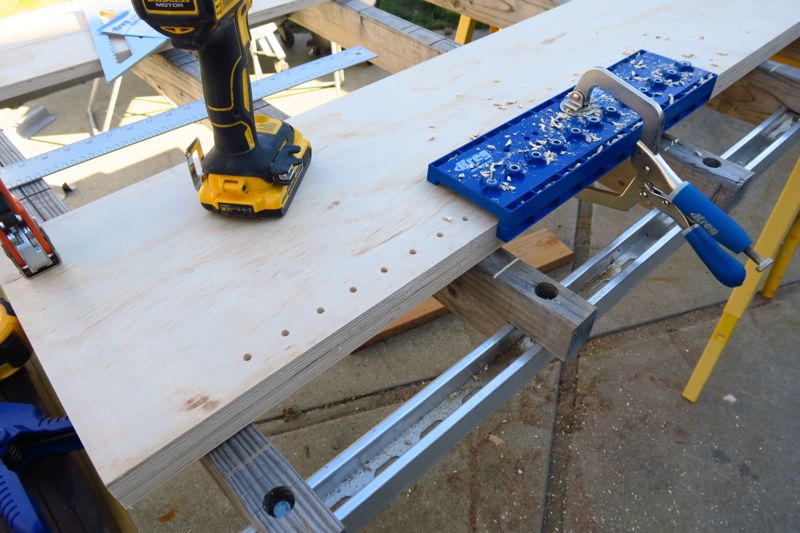

Next up was drilling all the shelf pin support holes:

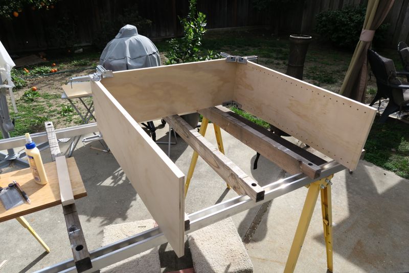

Assembly begins:
I swear I used every corner clamp I had. The construction is screwed and glued, so I didn't use any bar clamps.
A bit of test fitting to see how much stuff I actually had:

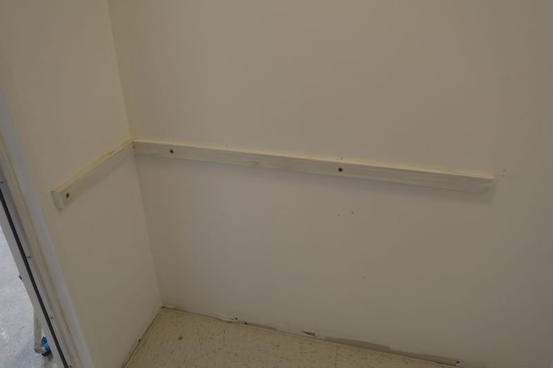

Preparing the wall in the closet for installation -- here's the cleat that supports some of the weight:

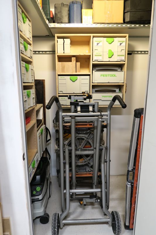

And here's the end result:
And of course there's a spot for my beloved vacuum:

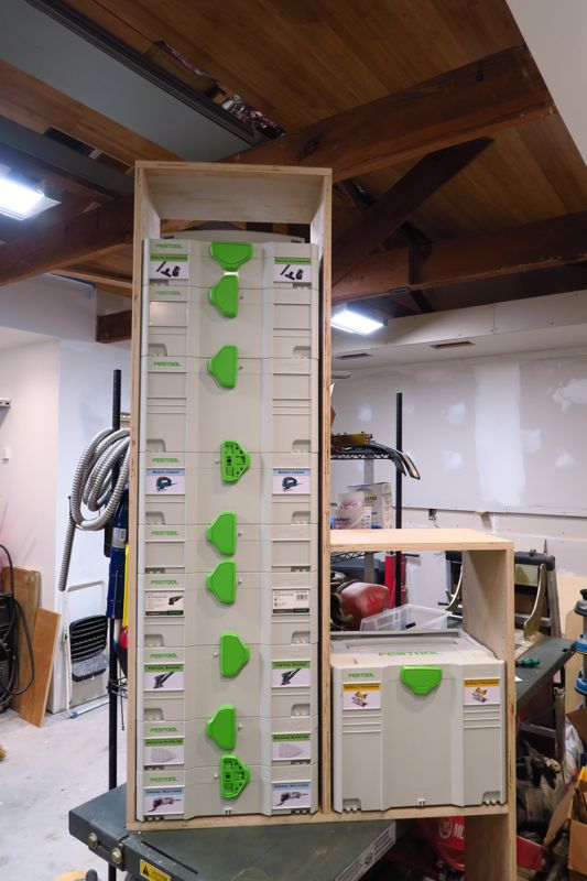

After I got the shelf installed (and after I bought my machinist friend lunch) I broke down another sheet of plywood into the pieces necessary for the next cabinet. But that's another post for a different day. :D

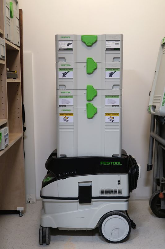

I like the custom tags on the systainers- very organized. Looking good!
Yeah, those are actually pretty cool. I discovered as I was exploring the world of systainers that the label slot holds standard vinyl ID cards. I bought a printer that would print CDs, bought an aftermarket ID card tray (that fits where the CD tray would go) and a bunch of blank vinyl ID cards and voila! Photographic, color-coded ID labels. Certainly makes it easier to find stuff at a glance.

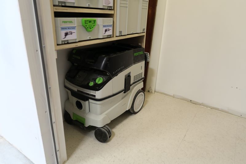

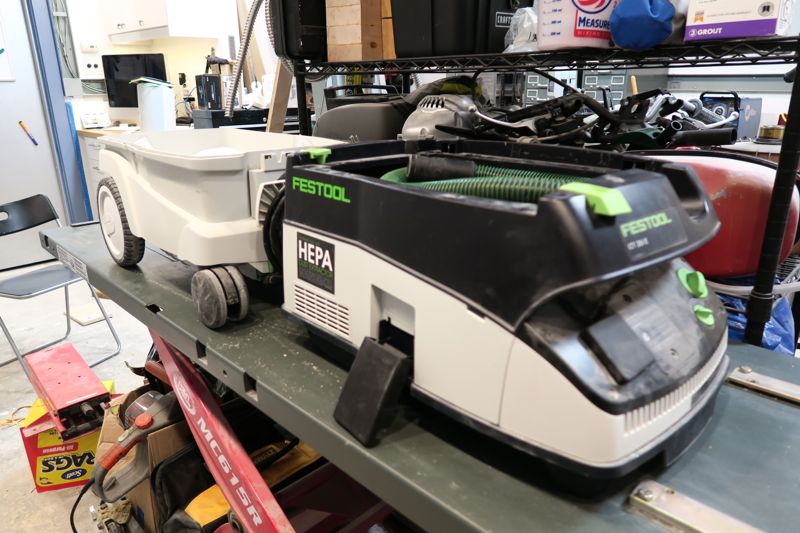

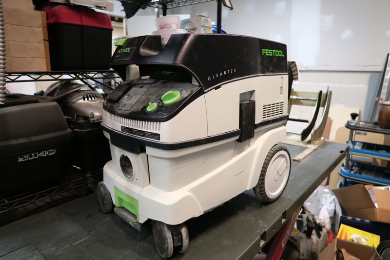

How is that vacuum? Would you prefer the 26 over de midi?
Love, love, love the CT26. It was actually the first piece of Festool gear I bought, and I was immediately blown away. It's hard to articulate -- in the field of vacuums, which are utilitarian and commoditized -- why one vacuum should be so much different than the rest, but I'll try: it's exceptionally quiet (and I really mean that), it's highly mobile (the big rear wheels and front swivel wheels are well placed for stability), the "hose garage" allows for neat and tidy storage, the ability to stack and lock a big pile of systainers on top is really handy, and the auto tool-on mode is very convenient (though not especially unique here). Every detail seems well thought out, right down to the internal feet on the top motor section that you can use to set down the top when you've got it open for bag changes. It also has a very long, beefy, heavy-gauge cord, since it is a de-facto extension cord for all the tools that you might plug into it.
There's a lot to like about this vacuum cleaner. :)
I don't have any real experience with the mini or midi, so I can't really speak to those. They look similar, just a bit smaller.

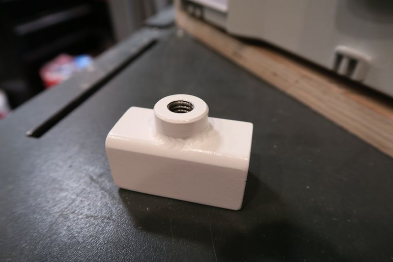

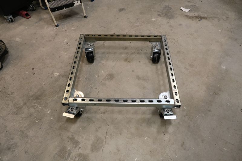

Jess, the custom feet are perfect.
Knowing nothing about the Festool vac, how would you compare it to a standard shop vac. Can it do wet? Bag only? Quiet is nice...
I'll pass that along to my friend Gary, who took it upon himself to fabricate them for me when I couldn't find an off-the-shelf product. They really do make the whole thing come together.
It does wet (though I've never tested it) and it also does bag (but obviously not at the same time). And between the bag and the HEPA filter, there's no dust. The capacity is smaller than a typical shop vac, but for whatever reason it took me forever just to fill up the first bag, even using it attached to the track saw for various projects. I thought maybe I had made a mistake by not getting the Grande Loco model, but this one seems to have more than enough capacity for me. It's also much lower to the ground than typical shop vacs, which goes back to what I was saying about mobility. I always found regular shop vacs on wheels to be clumsy, tipsy affairs.
Besides being much quieter, it has an adjustment for how much suction to apply. This accomplishes two things: (1) It makes the vacuum more usable when attached to a sander (as too much suction would stick the sander to the surface) and (2) it reduces the power consumption, which can come into play when you've got something plugged into it that uses a lot of amps (typically in-rush current at startup). A good example would be my compound miter saw: Sometimes, with the vacuum turned on high and the compound miter saw plugged into it, I'll trip a 15 amp circuit when they both turn on. I have 20 amp circuits to solve this problem, but I occasionally forget that getting that big blade moving takes a lot of juice, and the two tools at max will be over-budget.
In short, it's not any one thing that makes this vac awesome (though the quiet comes close). It is the sum of its parts, the gestalt that makes it wonderful. All the little details that make it a noticeable joy to use.

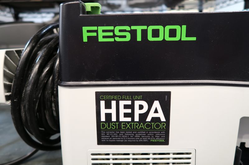

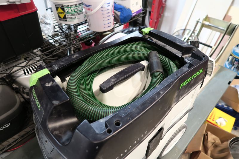

Here are a few photos of the CT26 to go with my description(s) above.
Here's the hose garage that keeps the anti-static hose tidy. Note also the handle by which you can carry it around (i.e. out of the back of the truck) when necessary:
The obligatory cord wrap (not unique to this vacuum, but I've had models without any provision for cord wrapping!)
The motor unit separated from the catch section. Hard to see here, but the whole motor unit is resting on its own internal integrated feet:

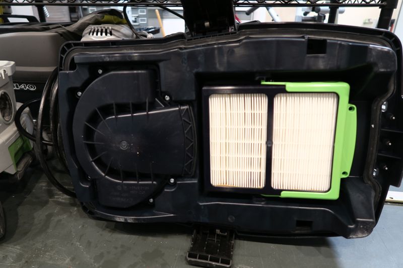

The business end. I've had this for over a year, and the HEPA filter looks brand-new. The bag does a great job of filtering dust.

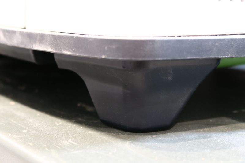

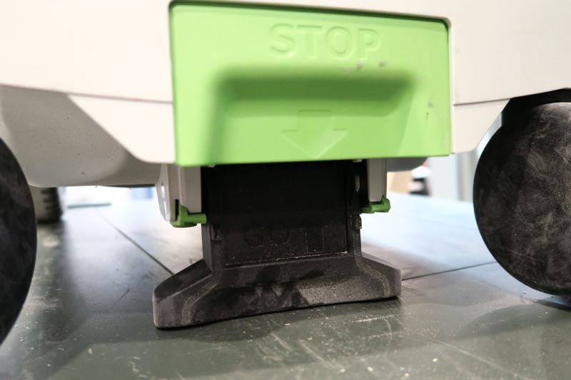

Here's one of those internal feet poking out from inside:

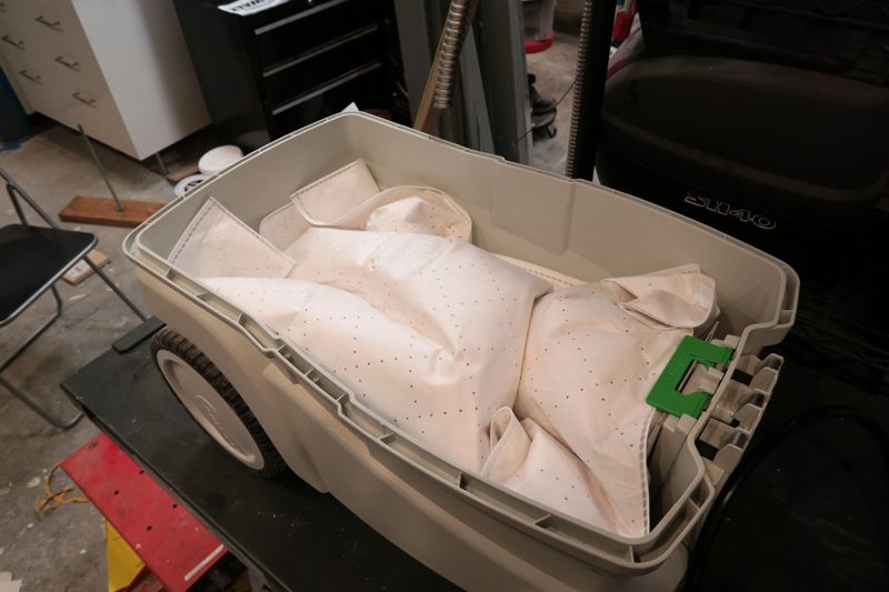

The catch bucket with bag installed:
Kickstand to keep the unit from rolling when you don't want it to:
Certification:
And finally, it carries your tools around for you. The systainers are locked in place by a pair of built-in systainer fastening clips. Even with this much weight on it -- and very top heavy -- it's still quite stable.
Like I said, it's hard to really articulate why such a lowly device as a vacuum cleaner is worthy of such high praise. But when you experience it, you just know.

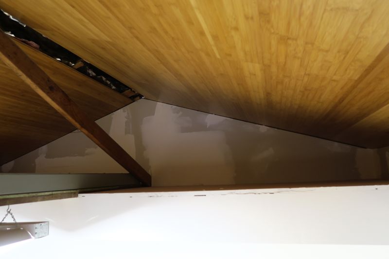

Your ventilation scheme could also be used for the house itself during mild parts of the year.
In a way, this is in fact practice for something more ambitious on the house itself. We have a whole-house fan (installed by the previous owner) that does a great job of cooling off the house after sundown in the summer, but it sounds like a helicopter in the central hallway of the house. It also requires us to run around and open all the windows in the house before turning it on. I'd like to replace it with something quieter that is smart enough to draw in fresh air (run through a filter, natch) when the temperature differential is favorable, just as I have done with the shop. Instead of a whole-house fan that you run for a little while, though, I'd prefer something with less CFM (and less noise) that could be run for longer periods of time. An HRV / ERV almost meets that requirement, but they are built primarily to preserve inside temperature, not change it. So I want something conceptually similar to an HRV, but without the heat transfer core.

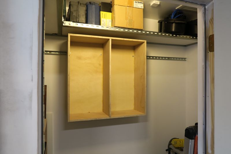

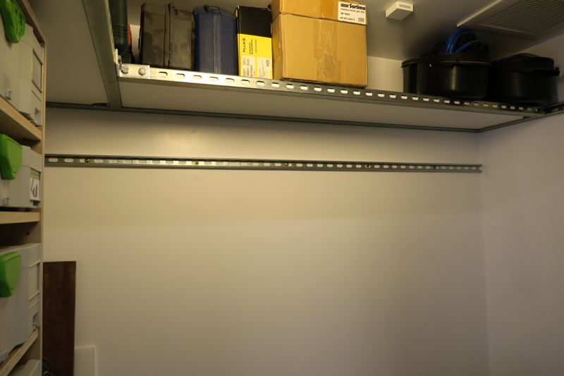

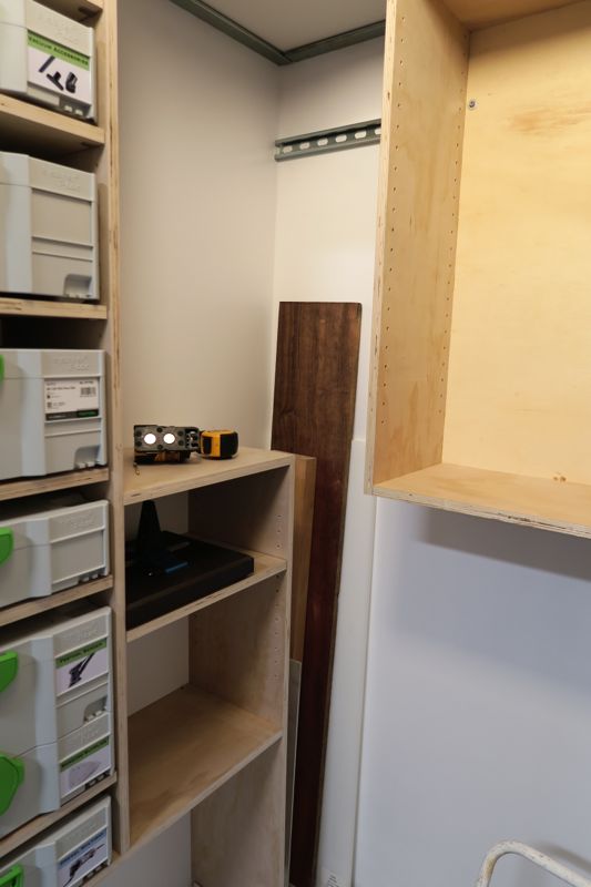

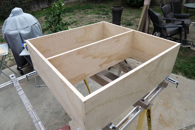

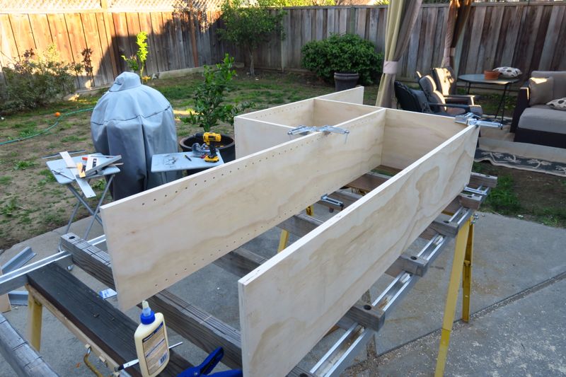

I seem to be running behind on my thread. I finished the second cabinet in the closet a week or so ago, but haven't posted pictures. I've now moved on to mudding and painting the last wall of the main room, pictures to come shortly.

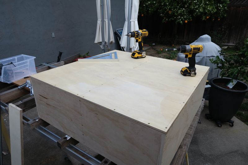

Here's the cabinet going together. Pretty simple construction:
Then it was time to prep the closet. Unistrut to the rescue (again). This is the "shallow" variety, so as not to bump the closet off the wall too far. I'll use the spare ends on either side to hold the plumbing for the air lines down the road:
The cabinet was then bolted to the strut channel with 1/4" bolts and some washers:
This detail shows why the first cabinet was constructed in such an odd shape. Plus, I wanted to be able to get longish-stuff into the corner to keep that space from being dead:
Here's the cabinet all loaded up, with the fold-up table saw parked underneath it:
And here's the compound miter saw parked in front of that. It does make it awkward to get in and out of the closet, and I might get tired of that. But right now I'm really happy to have the miter saw out of the way:

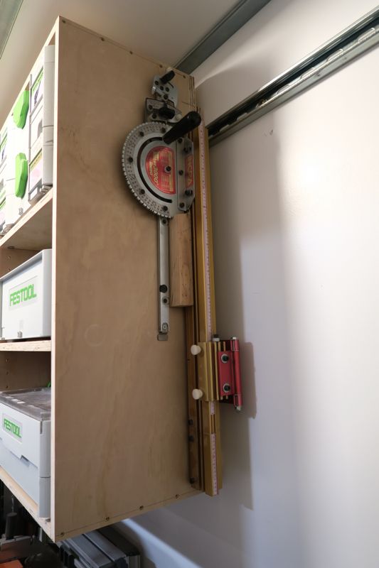

Unexpected bonus: I've had this Incra miter gauge floating around for a bunch of years, and it has never really had a good place to live. Now it does:

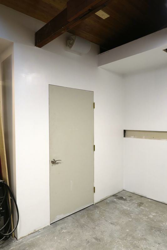

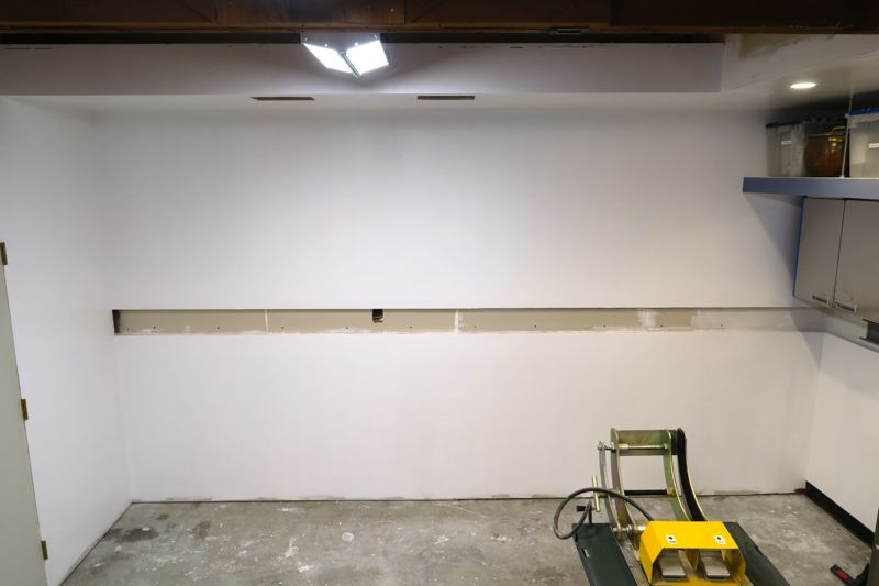

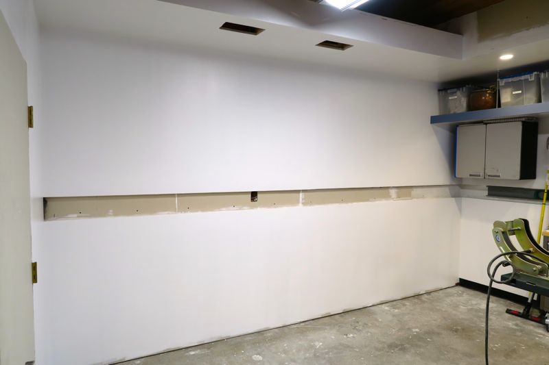

Okay, on to the fourth wall!
I took today off to give myself a three-day weekend, with the intent on making some progress on the fourth wall of the shop. I surprised myself by actually finishing it. Part of that was due to starting with the mudding on Friday night (worked until 11:30pm or so) and part of that was due to the general approach of "F-it! Nobody can see this detail!". There are defects in this wall, to be sure. But in the grand scheme of things, I'm pretty happy with it.
There are still a million little details to address, but the key word in that phrase is "little". There are very few "big" things left to do on the shop, and I can't tell you what a relief that is.
Some obligatory pictures:
Outside of closet was included in this weekend's work:

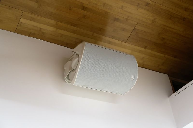

Also managed to reconnect the speaker over the closet door, so I have music again. I am so stoked!

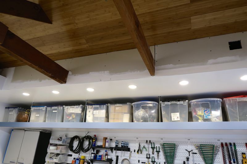

Lest you think I'm done, though, I still have to finish the vertical soffit on the first wall:
And the back wall of the storage loft:

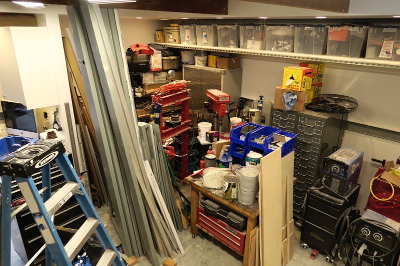

And if you were wondering where everything in the shop went, it's over here, in the (eventual) mill corner.

One question, could you provide a bit of detail on the saw horse work platform? It looks like you've used unistrut and secured the cross boards to the unistrut. Does it break down for storage?
It is exactly as you guessed. Two pieces of aluminum unistrut (to make it a bit lighter) with sacrificial 2x4 cross beams bolted to the unistrut with typical unistrut hardware. It doesn't break down, unfortunately, though I could take it apart in a pinch. I've mostly just left it outside year-round, sometimes on the sawhorses for months at a time. One additional detail is that I mounted 2x4s to the sawhorses, cut to the same inside dimension as the unistrut rails. This allows the rails to rest on the saw horse and keeps it from moving side to side at the same time.
I took the idea from the now-defunct Benchmark Worktable, which would have been the ideal tracksaw cutting table. Sadly, the company went belly-up, despite a really good product.
Looking great, what if you took the fold up table and laid it on it's side against the back wall (behind the table saw), would that give you enough room to move the miter saw around the corner?
I have similar saws, and I don't have a specific space for them. I like your use of unistrut as well. How are the casters under the card files doing?
Modern Jess
Jan 2, 2011
1,362
Bay Area, California
There's room for it right this minute, but eventually a 60 gallon compressor will go into that end of the closet. I only have rough dimensions for that (I haven't actually settled on one yet) so I'm kind of playing wait-and-see as to how much space I have left after that. I might be able to move the miter saw further to the right.
So far so good, they're holding up well, with one exception: I think I bent one (or both) of the lock / unlock levers, when it was locked with the wheels not poking out the front. I think it snagged on one of the bolts. I had some trouble unlocking one of them, and I haven't investigated the damage yet.
