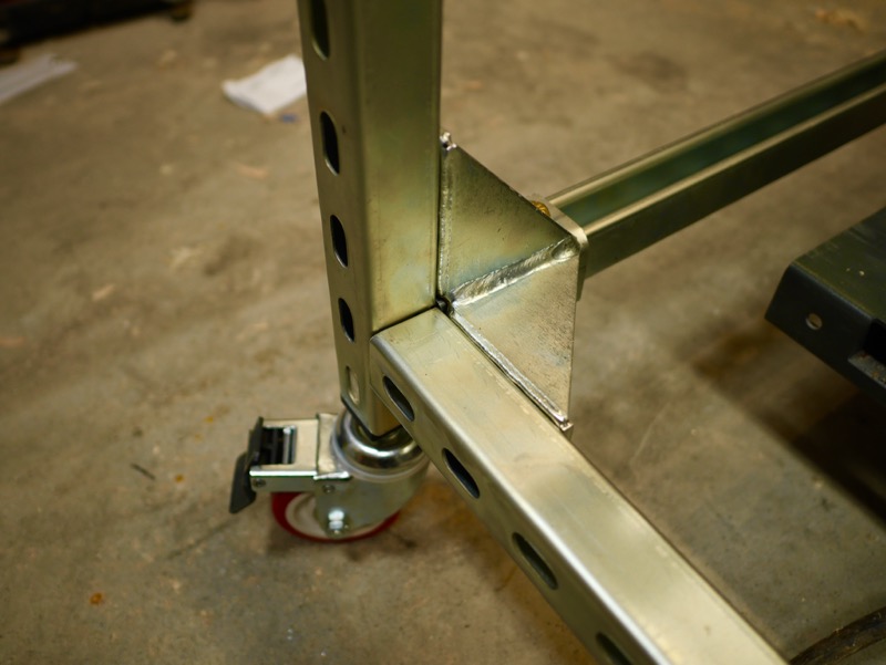

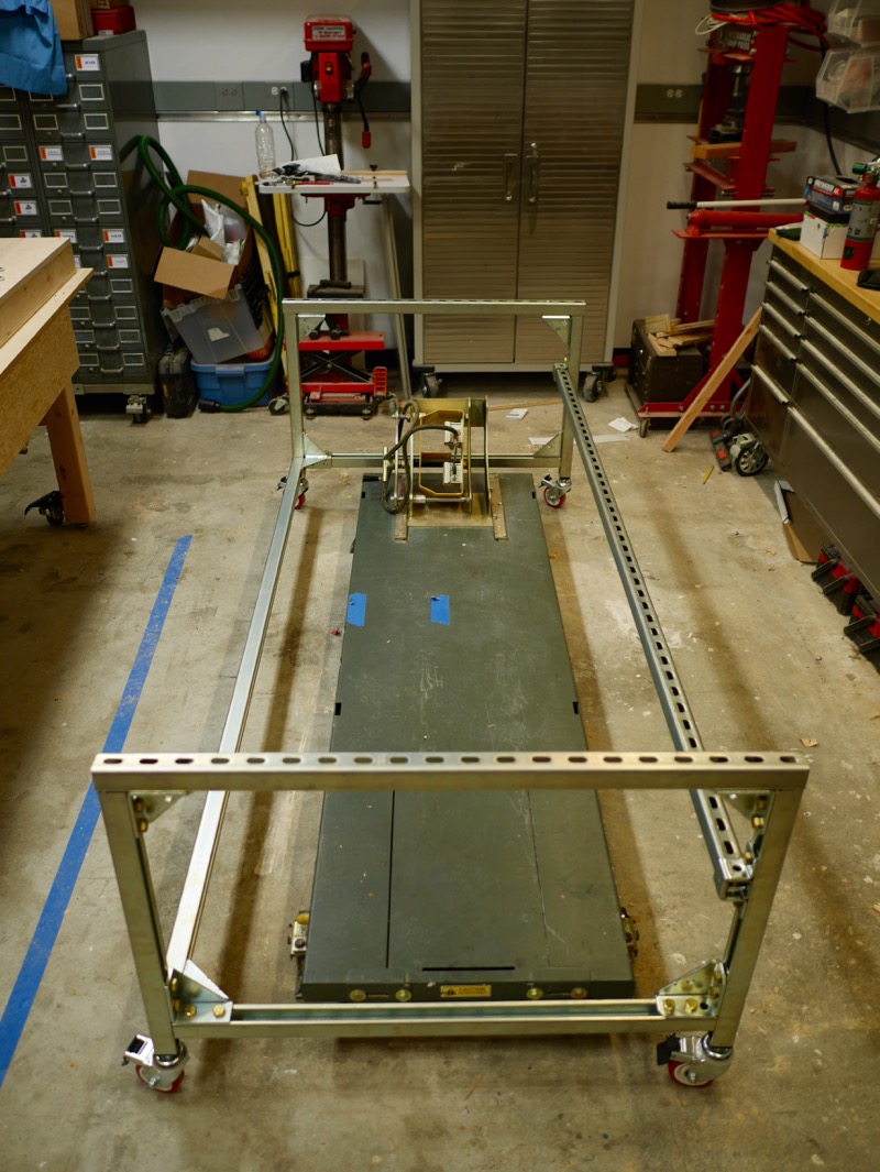

Disaster!
Shortly after the above photo was taken, unable to withstand its own gravity, the frame collapsed in on itself in a pile of steel, inadvertently ripping a hole in the fabric of space-time.
Just kidding! It's actually quite rigid. I got a feel for it as a bolted the last two pieces of channel into place (the two long stretchers) and was chuckling to myself as I finished. And it's actually not quite finished yet -- I'm using a temporary connector in one corner where a gusseted connecter will eventually live, and that should stiffen up the one direction where the frame can still flex a bit with force applied.

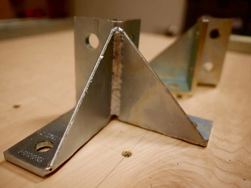

These are the brackets that were holding up the construction up to this point. They showed up on my doorstep last night:
I still think there's room for improvement. The long stretcher on the left-hand-side is oriented with the open face to the side, because that's the only way the bracket could work. I wanted to feel how much deflection I would get before I did anything drastic, and now that I've felt it, I would like to make it stronger.
The easiest (but not necessarily most effective) way to do that would be to sister another piece of channel -- oriented with the open side up -- to the existing stretcher. This would only be attached to the stretcher, and wouldn't have any attachment point to the rest of the frame. To do so, I would have to drill holes in the side of the new piece of strut channel and bolt it to the open face of the existing one. The open top of the new one would then be used to bolt through the cabinet that it will be supporting along several points. I think this will be sufficient, but again, I'll have to feel it to know for sure.
A more complete solution would be to replace the existing stretcher with one of the factory-doubled channels that Unistrut makes, and orient it along its strongest axis. This would raise the whole bottom rail a bit, and start eating into the cabinet space, so that's the compromise -- strength for space. Is it worth it? I may yet find out.

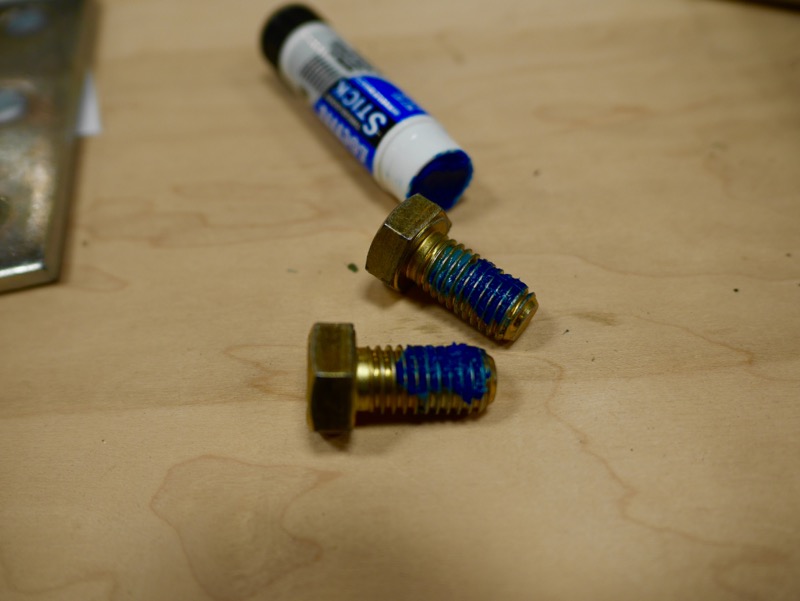

Another open question is whether the loctite I applied to all the bolts will be sufficient, or whether I'll have to resort to split rings, which I was trying to avoid:
After tightening all the bolts half a turn past freaking tight, I was surprised, when making adjustments here and there, how easy it was to unbolt some of them shortly afterward. That's something else I'll have to keep an eye on.
All in all, though, I'm very pleased with the way it's shaping up. I love it when a plan -- or three planes -- come together. ;)

Perfect time to seam weld that strut channel together...before somone drops some red matter in your shop and a space-time paradox ends the world :)
So the corner brackets are an off the shelf SC product? How did you mount the castors?
Yep. Unistrut P2226, which I bought from unistrutsales.com. I hesitated to use it in the first iteration of the mkII bench, because they're a bit expensive for what is basically a big hunk of metal with some holes in it. They're really the only corner connector that makes sense for this application, though, so cost went to the bottom of the optimization list.
Threaded square tube endcap inserts. They're meant for square tube, obviously, but someone on Amazon showed a picture in his review of how they could be pressed into the end of a piece of strut channel. It shaves a bit of plastic off as they go in, but they do fit. And despite being plastic/resin (with a metal threaded insert), they're rated for some ridiculous weight limit. I chose the 1/2"-13 variety and matched the casters to that.
EDIT: The first ones I got were from Amazon, but then I changed my mind about the thread size. The ones I used were from McMaster: http://www.mcmaster.com/#60945k22/=13v8k2o
And those are rated for 1,000 pounds apiece. That should just about do it.

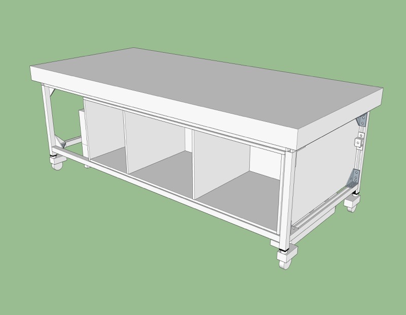

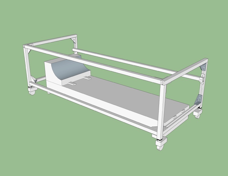

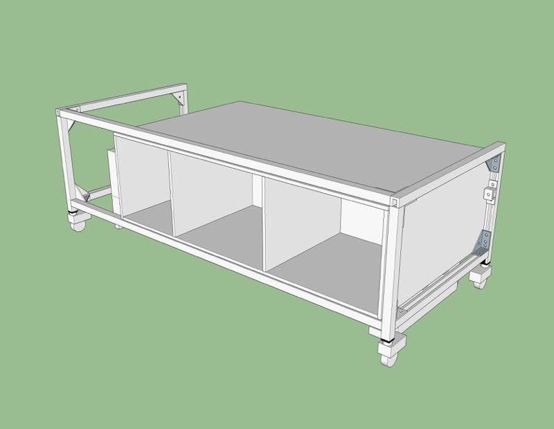

Addendum: The one direction that the frame can currently flex is if I stand in front of the short side and push the top edge away from me. The one additional bracket I'm still waiting on will alleviate that, I think, but I can probably do more.
I've decided to add another long stretcher, running between the top corners on the left-hand-side (referencing the photo of the frame above). On the far end, it will be braced with a corner connector that joins three pieces of channel with one more additional gusset, oriented in the direction that will help prevent that flex. I can't use that additional gusset on the close end, because it will intrude into the cabinet. But the other end (the end with the wheel clamp on the motorcycle lift) is fair game.
So now I wait some more.

When the top is added it will do the same as having runners at the top of the left and right sides (as pictured)
edit: well other than corner gussets, the top will not give you that. But you are adding cabinets to the space under the top, right? That would serve as a really good gusset.
Modern Jess
Jan 2, 2011
1,362
Bay Area, California
Mostly, yes. But since the front and back (as pictured) are only 1 5/8" wide, and since we're now talking about screws into plywood, it seems like there's still going to be an opportunity for the frame to parallelogram a bit. The extra gusset in the far left upper corner -- plus proper 1/2" metal bolts into 1/4" thick metal brackets -- should resist that, yes?
Modern Jess
Jan 2, 2011
1,362
Agreed. The cabinet will brace the heck out of the frame. But I'm now in the mode of trying to prove that strut channel can be made rigid, so relying on the cabinet as bracing feels like cheating. Plus, the lower stretcher on the left deflects a bit more than I'm comfortable with, so bolting the cabinet to the upper left stretcher (that I haven't added yet) should help carry the weight of the cabinet.
Or, to put it another way: Can't hurt, might help.

Here's the design I'm currently working from. This has evolved slightly in the last 24 hours to add some additional stiffness. The cabinet has also evolved significantly since the last time I showed it in a different thread. I've eliminated the sub-horizontal surface, and the cabinet now fills just about the whole volume.
