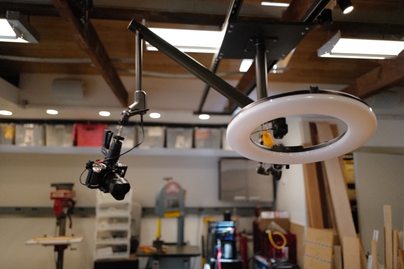

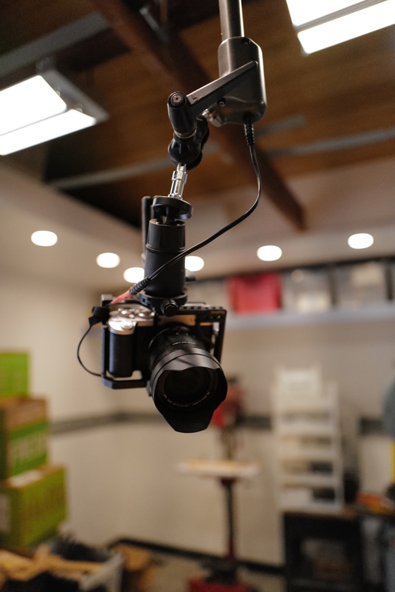

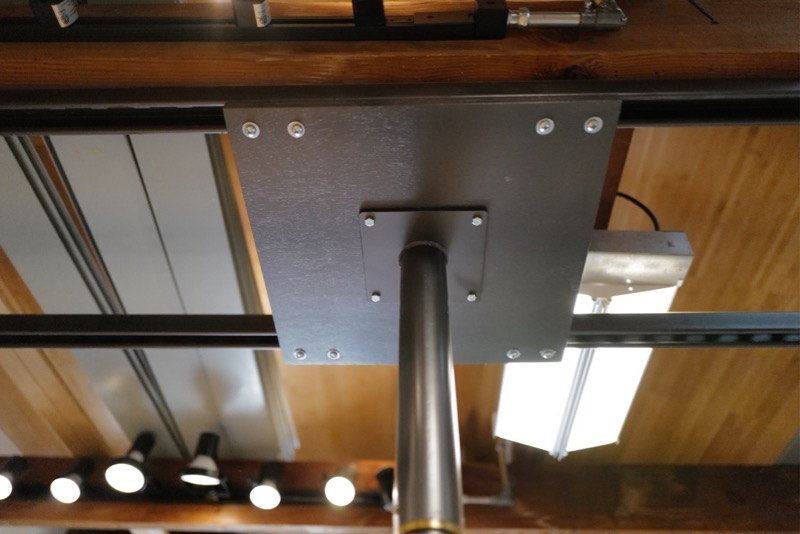

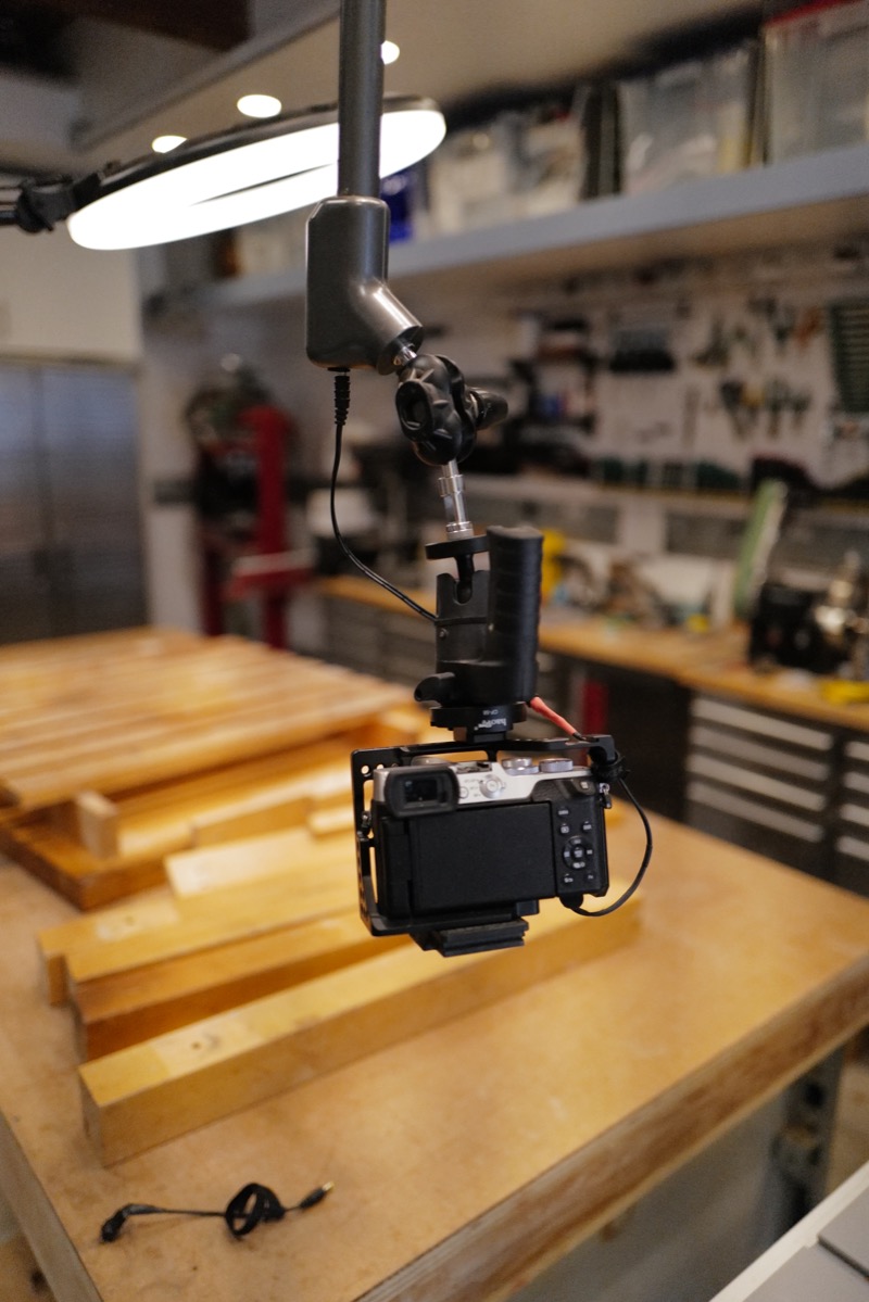

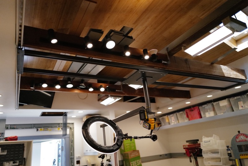

Camera Gantry

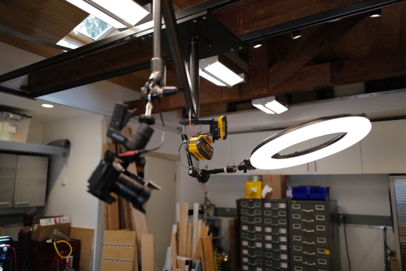

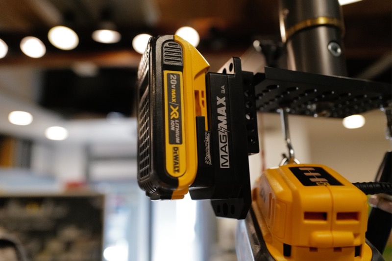

This is a slightly larger update to my shop.
I mentioned earlier in the thread that I had been making YouTube videos. One of the issues for me (and the reason it took so long to actually make my first video) is that there are few things I despise in this world more than tripods. The very last thing I wanted to be doing in my shop was constantly tripping over the tripod legs.
In the context of a workshop, tripods mounted on benches are especially awful, as they jump around when you are pounding on the bench. This makes for pretty terrible video.
So, I built a camera gantry. Because of course I did. And I built it largely out of unistrut. Did you think it would be anything else?
This actually took some doing. I needed sticks of strut channel that were 16 feet in one direction and 11 feet in the other direction. This wasn't something I could pick up at Home Depot, but a local plumbing and fittings yard had 20' sticks in stock from a previous order that never got picked up. I also needed to have parts of the system welded together (so as to be as low profile as possible) and that required removing the galvanization from the ends. And *that* ended up requiring a wooden rig to hold the ends of the strut channel 16 feet in the air while the other end got dipped into a bucket of acid. Fun!

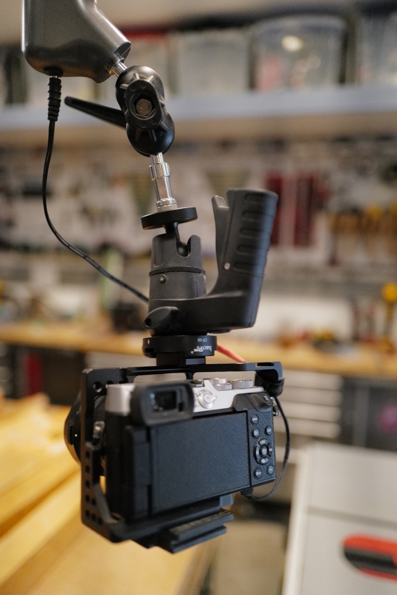

I also cobbled together a bunch of pieces -- camera cage, pistol grip tripod head, and assorted fittings -- to make the whole thing aim-able in any direction:
The business end of the gantry is the arm from an operatory light -- what you would colloquially call a "Dentist Light". I bought it used off of eBay and modified it to hold a camera rig:
Also hanging off of the base (via a standard camera rig cheese plate) is a Magic Arm, which will articulate and then hold that position when you tighten the central knob. I use it to hold a variety of supplemental lights -- the one shown here is the largest I've used.

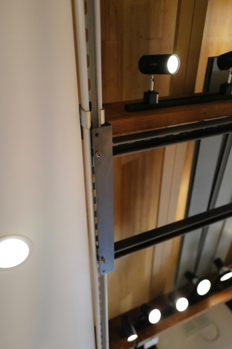

The arm is mounted to a central post suspended to a trolley up near the rafters. This also took some doing -- the operatory light came missing the other half of the interface it is normally mounted to. A machinist friend of mine made an adapter on his lathe that interfaces to the original operatory light pivot and slips inside a steel tube, which is then welded to a flange. That's mounted to a piece of plywood with four standard unistrut trolleys, and slides right-to-left on the 11' section of track:
That, in turn, rides on more unistrut trolley wheels on a 16' section of track that runs front-to-back at the edges of the soffits:
Shooting a video takes an enormous amount of time, and getting everything set up is time consuming. The last thing you want to do is to change the camera battery every half hour and then have to set everything up again. The fact that the gantry moves in X and Y makes hardwiring power extremely difficult, so I have to rely on battery power. Since I already had a bunch of DeWalt batteries on hand, I decided it would be best to harness those via a couple of adapters.

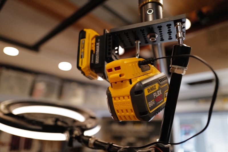

This monster battery powers the light through a DeWalt USB adapter that I've removed the electronics from (it burned out in an unfortunate incident :sad: ) and now just runs straight 18-ish volts from the battery. This is right within the range of the light I'm using, conveniently:
The second battery is attached to a purpose-built DeWalt adapter made for the photo world, and puts out 14.4V. I run that through a cable placed inside the dental arm down to the business end, where I can plug in a variety of adapters. In this case, I'm running straight into a dummy battery adapter that I kind of hacked together from parts. There's a DC buck converter in there that drops the voltage down to about 8V for the Lumix GX8 camera I'm using at the moment:
I have also experimented with using other cameras in place of the Lumix, specifically a DJI Osmo Pocket and a DJI Osmo Action. All of the cameras I use have WiFi interfaces of some kind, and I can frame the shots and start / stop recording from an iPad or an iPhone out of frame.
The setup isn't perfect. The long 11' section suffers from predictable geometry issues, and sometimes racks, binding the trolley wheels against the inside of the strut channel. I've mitigated this somewhat by adding some bearings on the trolleys that help keep the trolley off the sides, but it still binds a bit sometimes. Generally, if I am pushing from the middle, it will glide right along.
The whole thing also moves quite a bit. This generally isn't a problem once it settles, as it doesn't really get touched once a shot is set up. But sometimes I have to wait for it to stop swinging after I set up a shot.
Overall, the gantry has been a huge boost to making videos. I can move the camera around quickly and aim it at whatever I'm working on, and allows me to switch angles often to keep things interesting. Nobody wants to watch the same angle for 20 minutes. I can move down low to almost the surface of the bench, or go up high and do an overhead shot.
If I had it to do over again, I would probably make an articulating arm from scratch that ran along a narrower central track. That way I could still move front-to-back within the shop, and side-to-side via the articulating arm.
I've been teaching myself to tig weld, so maybe that project will happen. Someday.
Oh, and here's a video of the gantry in motion.

Who has red tools AND yellow tools. Unheard of!
Some diagonal bracing in the gantry might go a long way to preventing racking.

I was actually all yellow until a few weeks ago. And just to be clear, all of my DeWalt stuff has served me extremely well. I practically built the whole shop with a DeWalt 12V drill and driver.
There were a couple of tools in the Milwaukee M12 line that I really wanted, though, so I decided to move out my DeWalt 12V tools and switch to Milwaukee for all the smaller 12V stuff. I'm keeping my DeWalt 20V Max stuff for now. Too much invested to switch.
Yeah, it would definitely help. The main problem is that the whole thing can rotate sideways, which binds no matter what. I think I have a long-term plan, though, so I'll probably hold off on any major changes just yet.

I have been considering something similar but not the gantry. That’s next level. But I have a Foba combitube kit that I’m planning on using on the ceiling. Look up Foba stuff as an option for arms and such.
Love the Foba system, and it was systems like that Foba that I was drawing inspiration from. I just wanted to do something cheaper and custom-fit to the space. Plus, I can't resist an ambitious project.
In retrospect, the movement of my system is definitely limited by the crudeness of the unistrut trolley wheels and the flex inherent in the system, so it's debatable whether I went the right direction. :)
Still, it works.

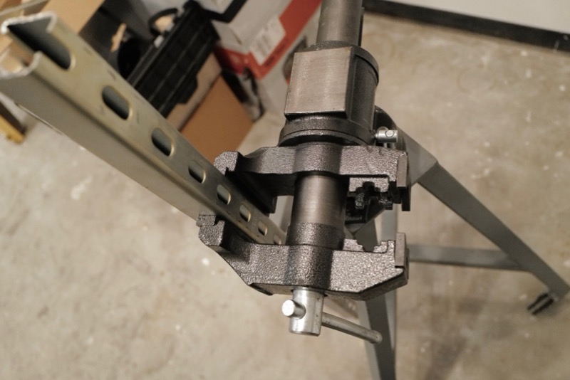

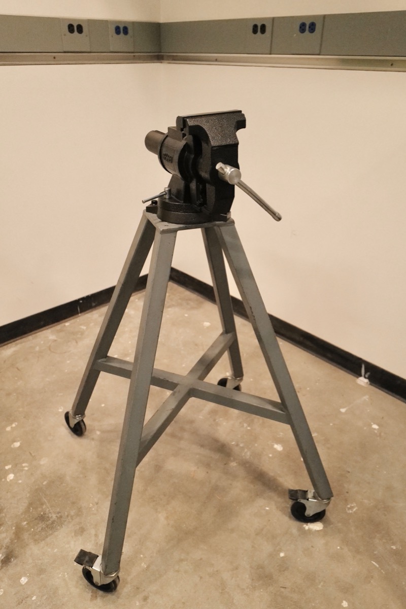

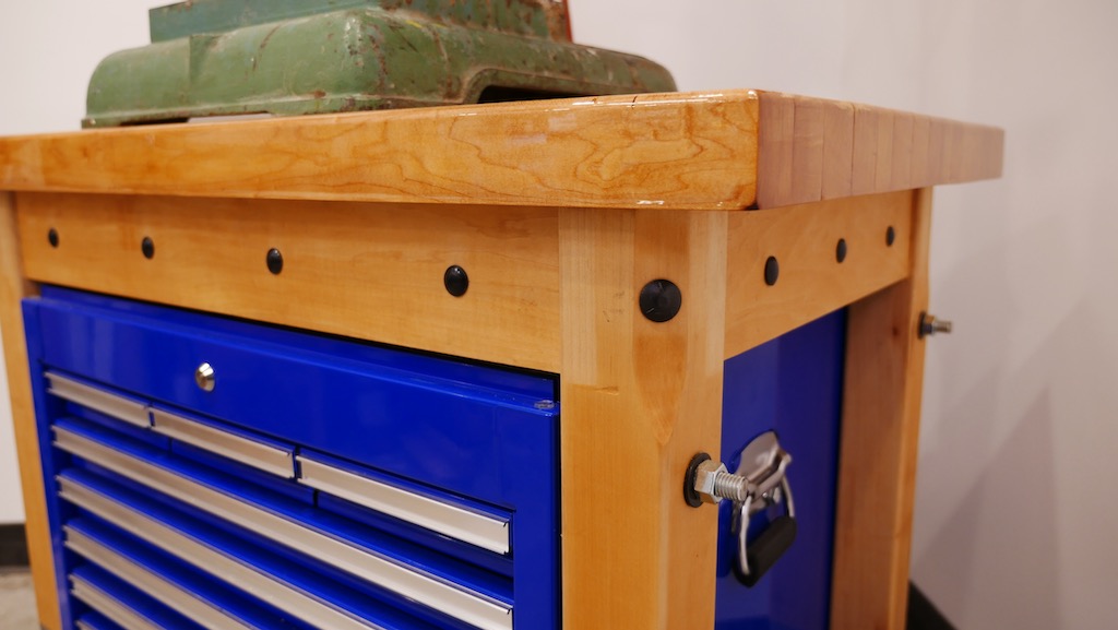

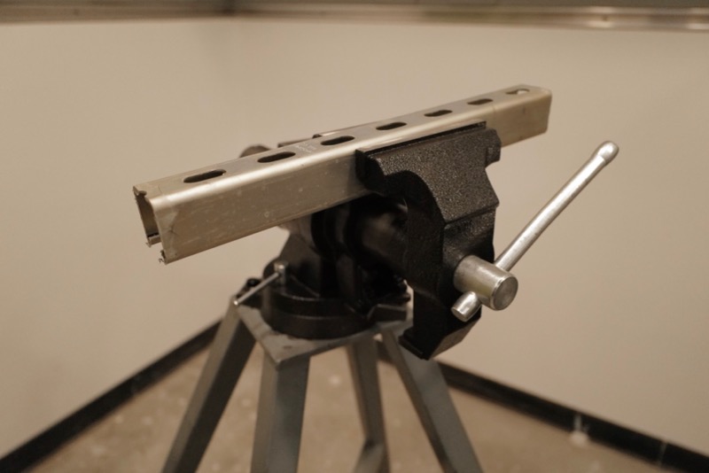

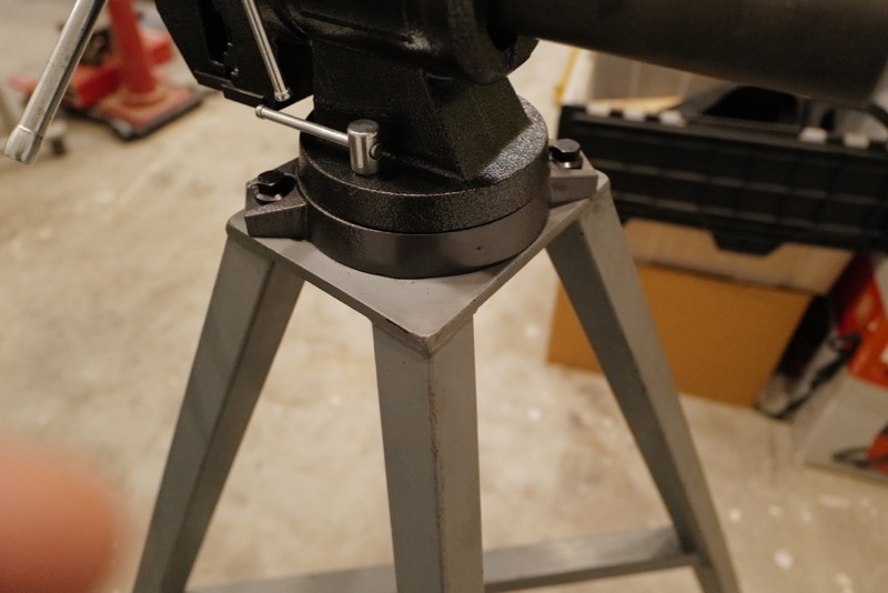

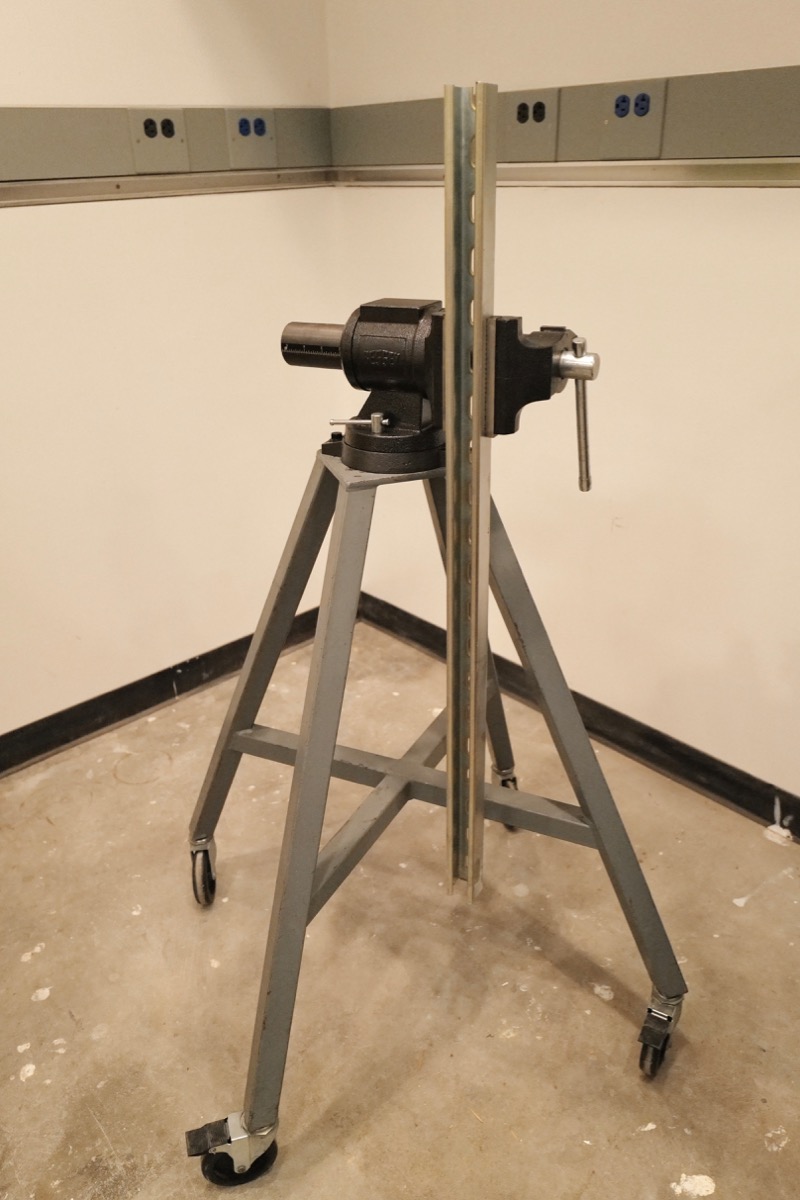

Mobile Vise

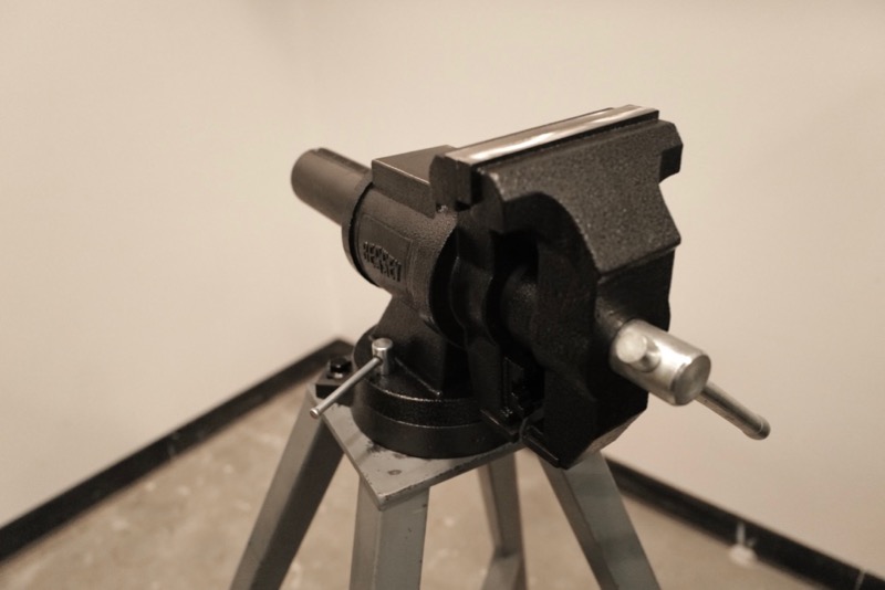

Another little project for the workshop. I've been dissatisfied lately with where my vise is mounted. It's on a rolling tool bench, which is awesome, but grinding or cutting metal in that particular corner of the shop gets messy, and for various reasons the cabinet has to stay there.
What I really wanted was a way to take dirty jobs outside (I say that now, when it's perpetually sunny in California) and work out there. As it happens, a friend of mine gave me this great shop-built stand which used to hold a Beverly shear. The top is excessively small, so that constrained what I could use it for, but it dawned on me that a vise would almost fit.
I had to make a few modifications, though. The three mounting points on this particular vise would not all fit on the top. Given that this will primarily be used for work holding, though -- cutting and grinding, and not pounding, bending, or otherwise reefing -- I figured I could get away with only two heavy-duty 1/2"-13 mounting bolts. The stand will lift off the ground long before the bolts will break, anyway. Five minutes with an angle grinder and a diamond blade (and some finish work with a flap disc) and I was in business.
So here's my multi-function, multi-purpose mobile vise. The rotating jaws give me the ability to hold vertically or horizontally (or anywhere in between) and of course it has built-in pipe jaws. To be clear, the vise itself is a PoS vise -- unworthy of the Vises of Garage Journal thread, for sure. But it's versatile and it was relatively cheap, and I certainly didn't mind cutting it up literally on the day I brought it home.
Voila!

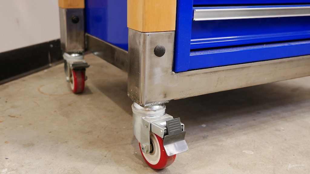

Working on one now. It’s a slow process, especially when I have to stop work in the middle to order materials and then wait for them to arrive. Some video projects occupy my bench for weeks at a time.
You’ll recognize the project from the corner cleanup video. I am rebuilding the rolling butcher block table that I collapsed at the end.

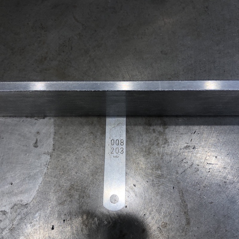

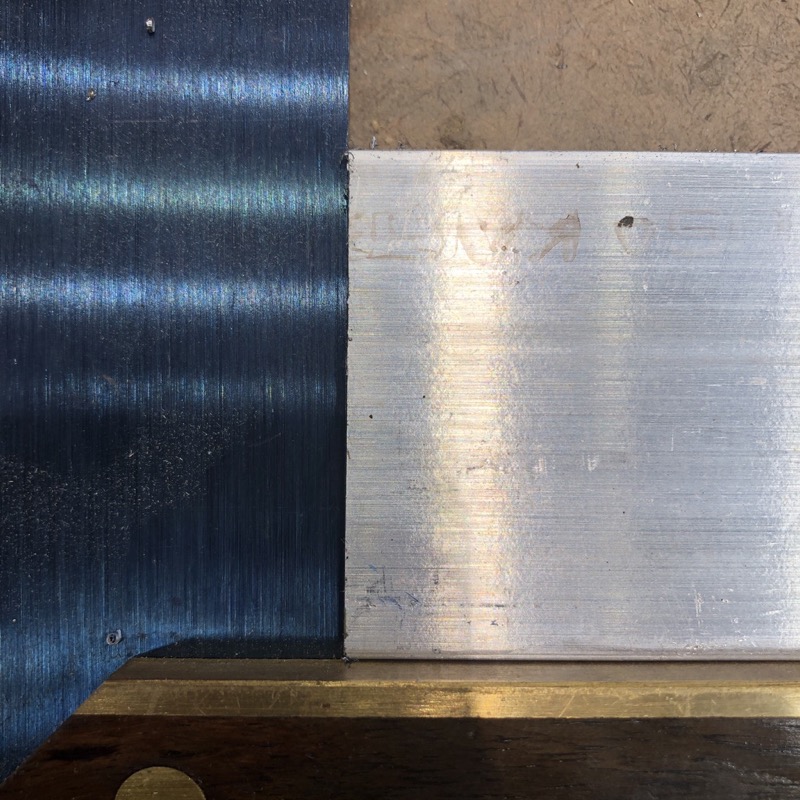

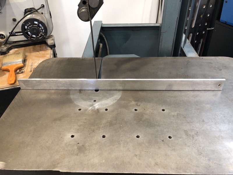

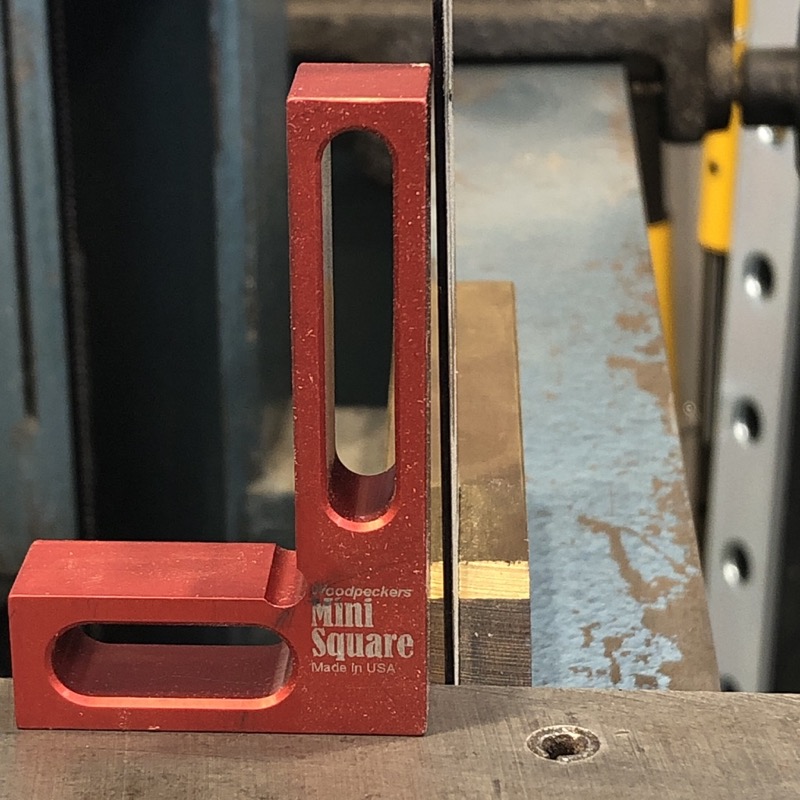

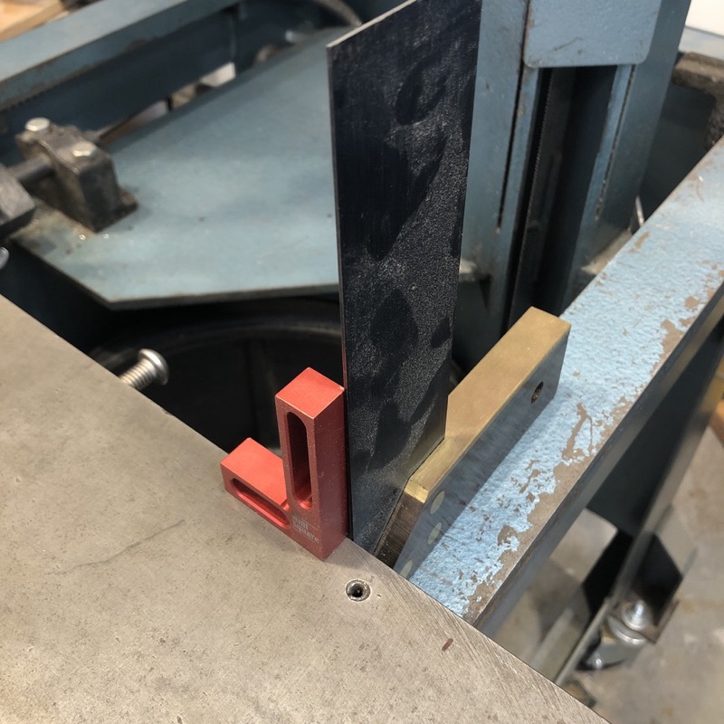

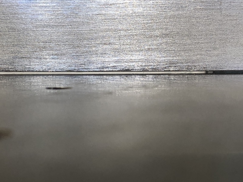

Bandsaw Table Shimming
This weekend feels like a complete loss. I worked hard, and accomplished something, just not what I wanted to accomplish.
A ways back I bought a Roll-In metal cutting bandsaw at a public auction. It was pretty well abused, but it cleaned up okay. I've never really gotten it to cut straight, though. I've always been a bit confused by the fact that the blade is out of square in different directions, depending on where on the table you check it for square.
At long last it occurred to me to put a machinist straightedge across the table to see if I could figure out why things were so wonky. Lo and behold, the cast iron table is not nearly flat.
There was nearly 40 thou of dip in the center of the table. And the rear edge of the table where the slot starts was completely misaligned.
The likely culprit here is that one of the main frame rails that the table sits on tips inward a bit. These two squares kind of show the incline:
Having the table tightened down in a misaligned state for 20-odd years seems to have left the table permanently warped. Even without being bolted to the frame, the table has a dip in the middle.
Time to break out the shim stock.
Two days later (mixed in with other household tasks) and countless bits of shim inserted and removed, I managed to get the dip in the center down under 0.010", and the rear halves at the slot almost lined up:
I must of tightened and loosened the four bolts holding down the table at least 100 times. I probably could get it even better, but frankly I am completely over it at this point. I just want the damn saw to kind-of-sort-of cut straight.
Here's my final test cut:
Good enough. Onward!

On another note, I am still somewhat dissatisfied with the squareness of the cuts on my metal-cutting bandsaw. Maybe it's unrealistic of me to expect it to cut square. It's got a blanchard-ground table, though, which sort of hints that the machine was intended with at least some modicum of precision.
Alas, this table is warped. And the slot has been massively opened up in places due to blade drift. I've just gone ahead and ordered a new table from the company (thankfully, they're still in business -- this saw is 20 years old) and some nifty accessories. I am determined to get good, repeatably square cuts out of this thing.

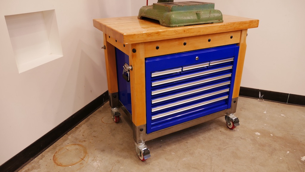

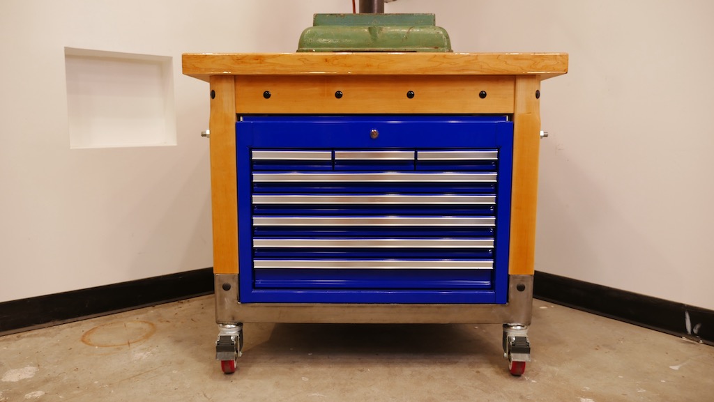

Some of you have probably seen this on the front page of GarageJournal already, but I finally finished the monster drill press bench I've been working on for months. I've posted a full build thread in Fabrication and Techniques:
FrankenTable Drill Press Bench
You can see a video of the whole build process here:
Some pictures of the finished bench:
