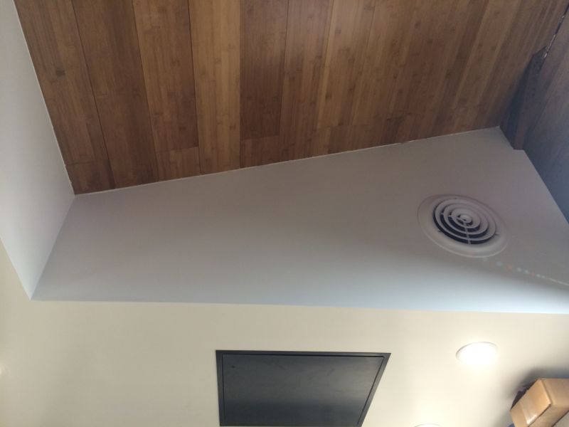

Intake, Redux
I've been monitoring the temperature data in my shop for the last week or so, and I am not entirely happy with the results. The automatic ventilation comes on and runs as I've coded it, but I'm not seeing a rise in temperature that I can directly correlate to the fan being on.
I think this largely comes down to two factors:
1) The make-up air inlet into the shop is undersized. At only 4" (compared to an 8" exhaust) it is clearly imbalanced. I knew this, of course, but didn't know how much air I would need to draw through the shop to equalize the air temperature between inside and outside. Apparently, I need more.
2) The make-up air inlet placement is sub-optimal, at least for this season. The inlet is placed up high, as is the exhaust fan. They're on opposite ends of the shop (which is good) but with both being up high, it tends to replace the warmest air in the shop with outside air, which may or may not actually be warmer than what I'm exhausting. In the summertime (which is probably more important in my climate) that arrangement will work reasonably well, as getting rid of warm air and replacing it with cool night air will be great.
I can't really fix #2 without sacrificing noise containment and/or running big ducts up the wall. And I'm not willing to do either of those two things.
I can fix #1, though, by adding another make-up air inlet to the shop. Naturally, I've got to hide the ductwork, and this will not have a significantly better placement than the first one. But it will more than double the inlet capacity I have today, so that can't be a bad thing.
I started out Saturday by cutting a hole in the drywall and taking out the insulation. Then I cut a hole from the other side and inserted a vent. That does an immediate 90° turn inside the wall, then another 90 to come out behind one of the rafter ties (which will be boxed in later).

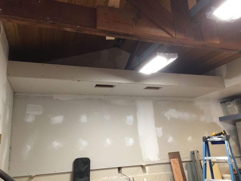

At this point in the project, I'm starting to look around and wonder where I'm going to put everything. Not only do I have Too Much Stuff, there are still a few major things (like the CNC mill) that aren't even in the shop yet. I always knew that I wouldn't be able to have everything I want in the shop -- my interests are just too diverse -- but I don't think I really anticipated the level of crowding that I'm now looking at. I'm going to have to get imaginative, or throw some things out. Probably both.
How on earth do people manage to share their garage with a daily driver? I'm extraordinarily lucky in that I have a workshop that is separate from the garage, and the garage itself doesn't ever get used for cars. Even with that, I am simply out of space.
Modern Jess
Jan 2, 2011
1,362
Bay Area, California
If you can't go out, go up.
I'd love to. I don't think I can pull it off, though.
That said, I'm doing my best to use the space high-up that would otherwise go to waste. The suspended shelves are a good example of that, and I have a few more ideas up my sleeves.
The real issue I'm having right now, though, is where to put the machinery.

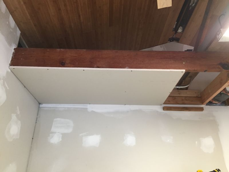

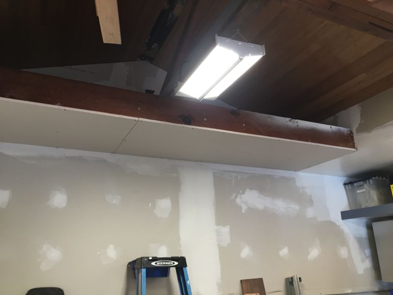

Ah, the drywall milestone! Congrats.
On the stratification issue, other than a ceiling fan, what are you thinking? 63F would be suntanning weather here right about now :) We saw -30C last night :-(
Modern Jess
Jan 2, 2011
1,362
Thanks! I would actually be more excited, but I know that hanging it is the easy part. :)
I was thinking of a simple enclosed box fan (though probably smaller) up above the rafter ties, aimed sideways across the flow of air. The air should blow against the slope of the ceiling and down the side of the soffit into the space below. I'm picturing (I hope) kind of a circular flow pattern that mixes the upper and lower air. The fan could be tucked out of the way fairly easily, and powered by the NEMA conduit I have running down the middle of the shop.
You're right. 63° is really quite comfortable. At this point I'm looking at the difference between outside and inside in the abstract, rather than the absolute temperature. The weather has been warm the last week or two, making this all seem silly. But we get cold snaps as well.
Put another way, it's the principal of the thing! :D
