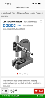

Hi Guys, I don't have room for a floor press or I would buy one.
Is there another tool out there, so I can avoid the hammer and socket approach to removing and reinstalling.
Thank you

Pic would help. Bolt, nut and a few correctly sized washers might work. Or c-clamp. Just want to be careful how and where you press the bearing races.

How big are we talking here?
I use something like THIS to install smaller bearings and it works great. Obviously, it isn't gonna handle a very large bearing.
Thank you! I am talking something like a 5 inch sprocket that has a 2.5 inch diameter bearing

Anyway, I have used a ball joint press and a couple pieces of 1/4" plate to press bearings into things.

Measure the interference. Usually proper bearing fits are basically a zero fit. AKA, heat the sprocket with a torch, and the bearing should fall right in.
This right here. If you don't have a torch the stove or a hot plate will heat the sprocket just as easily.

I generally use an oven. I keep a small toaster oven in the shop just for things like this.
Yep, any of the above. I use the freeze/heat technique often. I use a light bulb:

In the past, I used a drill press to press bushings and such. It just takes a little common sense to know when you're applying too much force and could possible damage the drill press.

Bearings should always be pressed in with either an arbor press or a screw type press. IMG_5550.jpeg
I have a full set of specific bearing drifts for all of the smaller sizes. For larger bearings you can usually use the adapters out of a Ball Joint press kit. Sockets also work. I save the old bearings that I remove and then take them apart and save the outer races to use as drifts in the future.
99% of the time if a bearing is tough to press in you probably don’t have the alignment correct. In the kit above the bearing drifts and cups use the same ID to accept the screw so everything stays aligned with the cup that’s machined to align perfectly with the bore the bearing is going into.
You can make your own press with threaded rod some bits and grade 8 washers. Acme thread works best. A thirst bearing between the nut and the drift is nice too.
