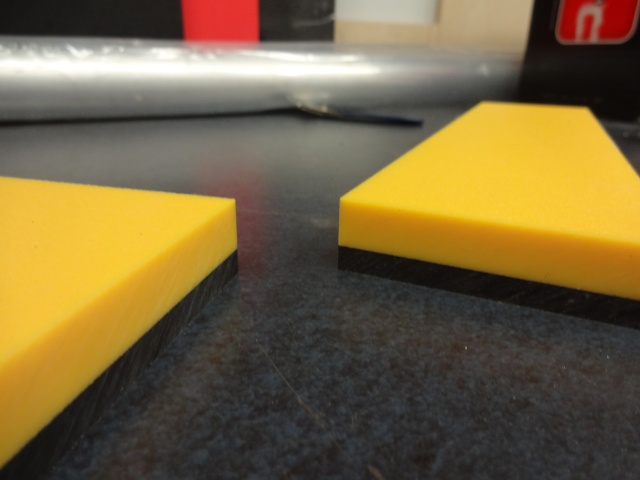

Where are you getting your material? I like the colors but having a hard time finding anything.
Thanks for the inspiration.
Rick
I bought the yellow and blue stuff from this guy on eBay. He has a few listings for various sizes.
http://www.ebay.com/itm/1-2-inch-Ki...489?pt=LH_DefaultDomain_0&hash=item3371ddf829
I think its actually called King Colorboard. i found it using the Keywords: king & starboard and the color ones jump off the page if you look at the pictures. It's not on ebay often.

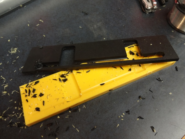

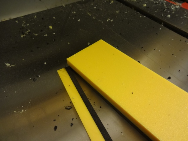

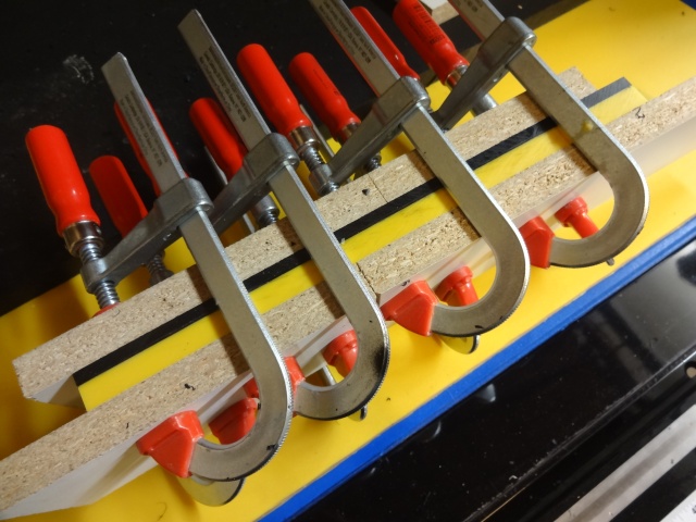

Got a little impatient tonight and pulled the clamps off of the plastic, took it out to the saw, and trimmed it up. It's been setting since Sunday at about 4pm so that's 4 full days of dry time at 70 degrees.
I had to cut it with the black side down otherwise the heat appeared to smear the black into the yellow. The cut turned out amazing. It almost looks like one piece of material that's two colors.

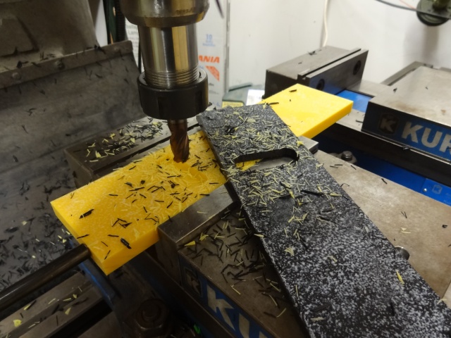

I threw have of the piece on the mill and ran the 3/8-inch impact socket extension program. The first hole gave a really nice glimpse of what was to come.
And then a sucking sound and the material separated. I couldn't believe it but the glue was still not dry between the two pieces of plastic. I think the bond had started however I may need to be extra gentle when cutting by reducing the depth of the cut, slowing down the feed rate, increasing the RPM, and/or reducing the step over. I also need to sink the material fully into the vise jaws. I had most of the 1/4-inch HDPE sticking out over the top so the material was mostly being held in place by the glue (which was dumb).
I pulled it out, cleaned it off, stuck it back together, sank it deeper in the vise and continued. Unfortuantely a later step muts have been way to aggressive for the glue and it pulled it apart again.
Bummed, I took the second half of it and re-clamped it. Maybe all of the posts on the internet are correct, you can't glue HDPE together. I do wonder why the green and red cutting board stuff stuck together well. Maybe the food grade stuff is more porous (though that doesn't make any sense to me).
Back to waiting. If this doesn't work I'll try an epoxy but I'm more motivated than ever to make it work seeing the potential.

Curious if you scuffed up the surfaces before gluing? With the HDPE being so slick, a rougher surface may help a little, maybe not.
Steve <<<< Jealous of your mill skilz!
I've been doing some research on HDPE and it seems that "welding" is the only real effective way to bond two pieces of HDPE due to its characteristics. For gluing, as you indicated, a scuffed or textured surface helps. The starboard has a textured surface that's likely more textured than if I were to rough it using a large fly cutter or something so I left the surface alone. That being said, I have no idea how the surface is prepared when it is manufactured. The creation of the textured surface could impact adhesion...I have no idea, I'm not a plastic-ologist. This is just **** I ponder when I'm wasting shop time watching what some call "Must See TV". Anyway, the last time I glued it, I pre-heated the surface until it was tacky, applied the glue, and clamped quickly. If it doesn't work, I'll try an epoxy. If that doesn't work it's too much effort for the tool box I'm thinking.

I'm no 'plastiologist' or even a machinist for that matter, but why not run the program twice, once on each piece and then glue/epoxy them together?

lilscorpion, would it make sense to countersink a few holes from the bottom up into the top piece, and put some small screws in it? I think glued and screwed would hold much better
+1 This is what I would do, heck I would even do them from the top down and use some nice SS #6 flat head cap screws, but I like that look so may just be me.
You have woodworking tools and know how to use them. Make a double sided dovetail "key" and then put a dovetail into the top/bottom. This will give you one thick piece of material that will hold until the glue dries. You should be able to machine through it without fear of damaging your bits.
...and you don't have to wait for the glue to dry.

Yeah, I've considered using fasteners. Bottom up wont work because the top material is only 1/4-inch thick. Top down would work but I'd have to leave space enough to have them but I could easily do it. I've been attempting to stay fastener free so I don't have to program around them. Stainless on black would look really nice though. I could even find black if I wanted them to blend.
Huh...interesting idea. Not sure I could pull it off with the top being only 1/4-inch thick but on deeper trays (like 1/2-inch on top and bottom) I could do something like that. Would make a really interesting pattern machined as well. I'll keep that one in the back of my head. I like it.
I certainly could. Hadn't thought about it. Only issue with machining the top layer seperately is I'd need a fixture plate to attach it to because the 1/4-inch isn't rigid enough to clamp in the vise by itself. Not a huge deal but it adds another step to the process.

Scorpion....have you give double sided tape a try? Any time that we milled thin plastic we used double sided tape. But we had to be very careful separating the parts. In your case, put the tape on, put your top piece on, then clamp them to insure a good bond between the two. You should have no problem at all.
I've not heard of that? Any special kind or just heavy duty double-sided? I'll get some, slick trick. Im gonna go get some epoxy today so I can pick up a roll while I'm there. Slick trick, thanks for the tip. Would you still use plastic if you cut all the way through it or just for surface machining?

Do what you're doing, just use clamps on the material while machining. I do a lot of parts out of 1/8" and 1/4" Lexan. Most of the time I clamp a backer block in the vise, then clamp the material to the block. No glue involved here, but it holds the part securely.
A couple of clamps will prevent the process from stressing your glue joint.
Are you Climb milling or Conventional milling?

We used double sided tape when we cut all the way through the plastic. I looked for my roll that I had in my toolbox to see what brand it was but the wife must have latched on to it. I'm fairly certain it was 3-M brand. The peelable covering was green and white. Believe it or not, but we've used it on the wet grinder to hold down parts to grind.

Regarding the glue, it would seem to me that the melamine glue would dry around the edges where air could get at it, but the rest of it wouldn't dry because air can't penetrate through the material. In other words, the inner glue would behave as if it were still in the sealed glue bottle and remain liquid.
Have you tried contact cement?
I was thinking the same thing about how it's drying. I wasn't able to put it in a sentence though so I'm glad you were able. Actually, today I went to Lowes and looked through the various epoxys and found that gorilla glue had the strongest holding power that was still clear out of all off them so I purchased a stick. I glued up two 24-inches long sections 3-inches wide and they were dry in about 3 hours. Dunno why I never tried an epoxy before, the dry time is way better than the melamine glue even in cold weather (likely because of the chemical reaction when mixing).

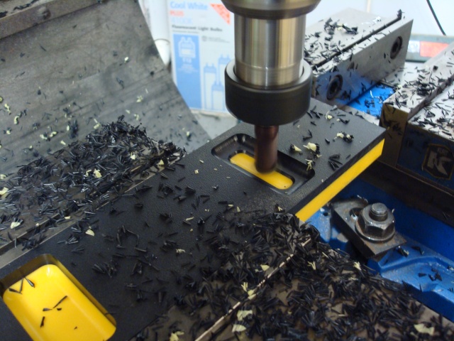

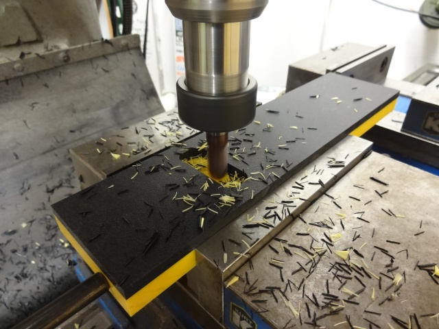

I really was off to a kick-a$$ start. I reduced the depth of cut per pass to .100 and kept the speed where it was (about 2200rpm).
As soon as the cutter had to go deep enough where the 1/4-inch (black) HDPE was fully on the side of the end mill, it broke the top piece loose. It was looking really great too. So for shoots and giggles I decided to finish it no matter what so I could see it. Without any glue left bonding, I threw brads in at strategic locations to ensure it wouldn't shift. The brads did the trick really well however they were needed all over the damn place because of the number of spots where the material get's scarce. I don't like the look of the brads however it does give me an idea of what the finished piece will look like if I can work it out.

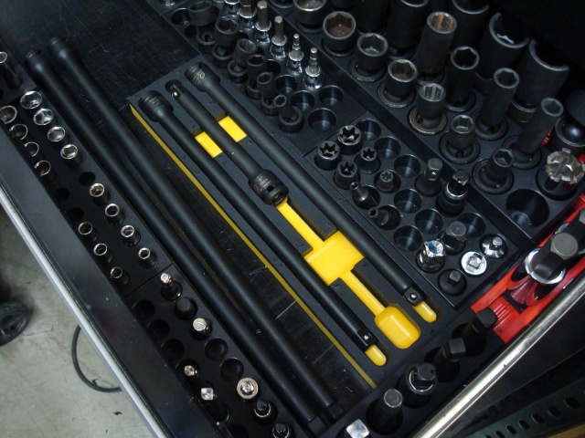

It really does add another dimension to the drawer and I can totally see how it will bring it to life. Looks neat when a tool is missing too.
One of my thoughts was that I might be attempting to do this two layer design on the wrong tray. This tray does have a bunch of really thin pieces that clearly are going to be difficult to hold down. Maybe this would be better for a socket tray or something else where there's much more material left after cutting (and between the pieces).
I have two more I can cut - one that's left over from my melamine glue attempt and the second from this round with the Gorilla Glue. At the recommendation of dladcock (about 10 or so posts earlier) I'm going to try to reverse the cutting direction from conventional to climbing. That may reduce the pressure but I don't know if it will make enough of a difference. I'm also going to try the fastener idea just in the corners to see if I can give the glue some help. Maybe that will be just enough to keep it from breaking loose in the first place. I keep thinking of the double sided tape thing and can't figure out how it would be any stronger than the glues except for one thing (that intrigues me), maybe it will be able to flex slightly and never offer that "break free moment". I may have to try it before i give up. Closer though. :rocker:
