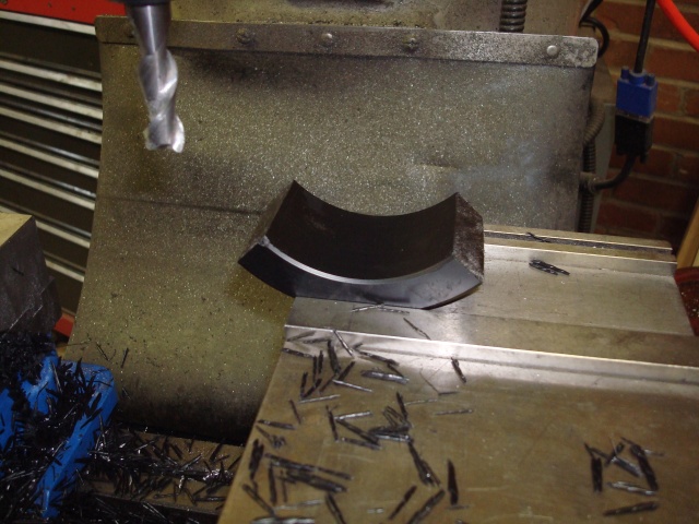

I was thinking the same thing about how it's drying. I wasn't able to put it in a sentence though so I'm glad you were able. Actually, today I went to Lowes and looked through the various epoxys and found that gorilla glue had the strongest holding power that was still clear out of all off them so I purchased a stick. I glued up two 24-inches long sections 3-inches wide and they were dry in about 3 hours. Dunno why I never tried an epoxy before, the dry time is way better than the melamine glue even in cold weather (likely because of the chemical reaction when mixing).
I really was off to a kick-a$$ start. I reduced the depth of cut per pass to .100 and kept the speed where it was (about 2200rpm).
As soon as the cutter had to go deep enough where the 1/4-inch (black) HDPE was fully on the side of the end mill, it broke the top piece loose. It was looking really great too. So for shoots and giggles I decided to finish it no matter what so I could see it. Without any glue left bonding, I threw brads in at strategic locations to ensure it wouldn't shift. The brads did the trick really well however they were needed all over the damn place because of the number of spots where the material get's scarce. I don't like the look of the brads however it does give me an idea of what the finished piece will look like if I can work it out.
It really does add another dimension to the drawer and I can totally see how it will bring it to life. Looks neat when a tool is missing too.
One of my thoughts was that I might be attempting to do this two layer design on the wrong tray. This tray does have a bunch of really thin pieces that clearly are going to be difficult to hold down. Maybe this would be better for a socket tray or something else where there's much more material left after cutting (and between the pieces).
I have two more I can cut - one that's left over from my melamine glue attempt and the second from this round with the Gorilla Glue. At the recommendation of dladcock (about 10 or so posts earlier) I'm going to try to reverse the cutting direction from conventional to climbing. That may reduce the pressure but I don't know if it will make enough of a difference. I'm also going to try the fastener idea just in the corners to see if I can give the glue some help. Maybe that will be just enough to keep it from breaking loose in the first place. I keep thinking of the double sided tape thing and can't figure out how it would be any stronger than the glues except for one thing (that intrigues me), maybe it will be able to flex slightly and never offer that "break free moment". I may have to try it before i give up. Closer though. :rocker:

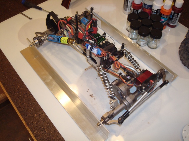

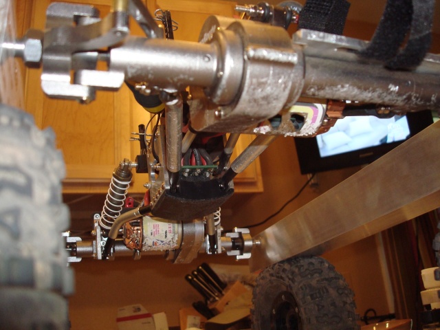

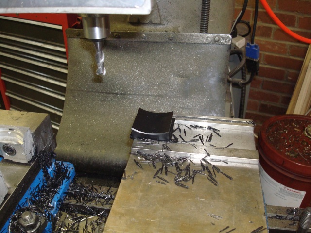

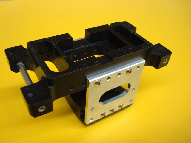

So I looked back for mill projects and ran across these pictures. About 3 years ago my son and I got in to the RC Rock Crawling thing. A couple of the local hobby stores would have rock races on Friday and Saturdays and we'd go down and complete. At the time people mostly bought kids and occasionally someone would try to fabricate one from scratch. Usually a function of saving money more than to really fab one themselves. In my case I figured I could make it exactly as I wanted and save money at the same time.

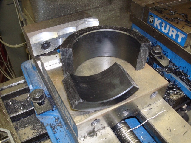

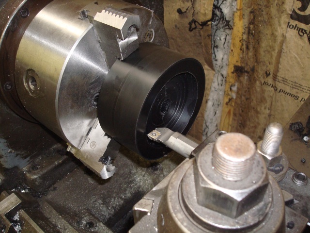

I started with the skid and by boring a piece of 12" delrin I had on the lathe.
I parted it off and then used a sawzall to cut in into chunks.
Chucked it up in the vise
and machined the sides flat which I'd use for reliefs where I could attache the side plates.
Then I machined the side plates out of 1/8-inch aluminum and drilled the holes to match on the skid. I machined a flat square piece of 1-inch thick delrin for the chassis itself and then sank some aluminum pieces of tubing in the holes where the shocks would mount to strengthen it up a little.

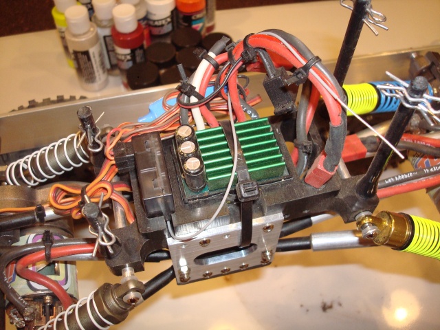

The bottom of the skid also had mounts front and rear that I attached control arms to. The natural curve of the skid, and the nature of plastic, allowed it to slide easily along rocks though it did hang down a little.
The top part of the chassis was machined to match the electronics that needed to be mounted into it. Everything had it's place and locked nicely to where it needed to be. This picture shows a zip-tie holding in the speed controller however I ended making some small clamps for it a little while later. The wires were a bigger hassle than the electronics themselves.

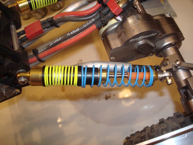

I took a pair of the aluminum shocks I had a machined the threads off the body so I could make little delrin plastic spring retainers that allowed me to use the shock as a dual rate shock. This allowed for some crazy compression setups. The little orange piece on the shock shaft is gas line used as a bump stop so you can adjust the hard stop as well.

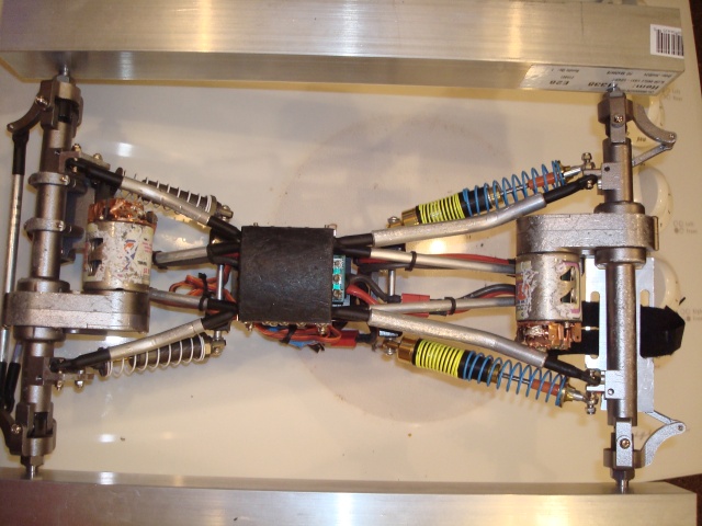

Here's a bottom look at the buggy (after a few races). To the right is a battery plate I machined out of 1/8-inch aluminum. All of the links were tapped on the lathe and then the lowers bent for additional clearance. All of the shock mounts on the axle side were machined on the mill using extremely small aluminum angle.
Here you can see a better shot of the front raised shock mounts (axle side) and the chassis from the top. I had to rotate the motors up and to do so I had to do some minimal machine work to the gear housings themselves but it almost didn't count it was so trivial.

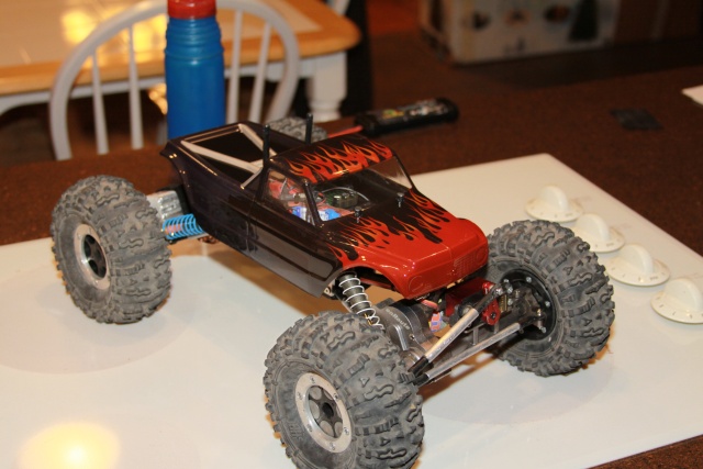

Here it is finished with a fresh coat of paint which was incidentally my second airbrush project. I've had a little more practice since then.

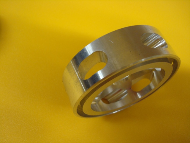

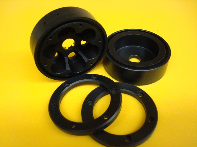

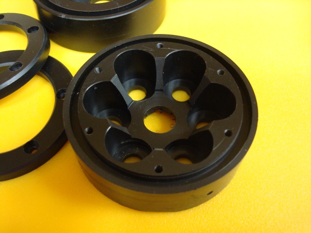

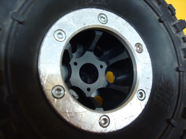

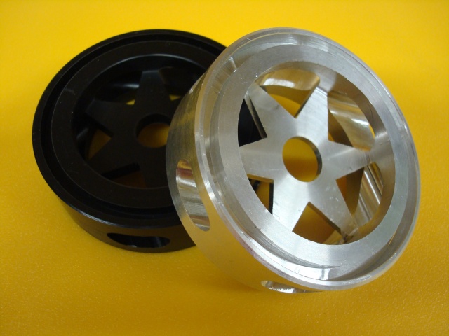

All of the wheels were made using the Lathe and the Mill. The lathe was used to macine the blanks including the tire bead groove. The holes were all drilled/milled on the mill. Couple of ops here so I try to make a bunch of them when I do.
The larger holes are not thru-machined so that I can add large steel dowels to the wheels to add weight. Adding weight in the front end helps it climb better because it helps get more weight over the front tires.
I machine the beadlock rings out of both aluminum and plastic. I use the plastic on the inside and the aluminum on the outside because it can handle the rash a little better...and adds to the bling factor.
I've played around on the mill and made a few different designs in both plastic and full aluminum wheels. These fronts look like 6-spoke.
I got the look by off-set machining down into the center of the wheel and then rotating it 60 degrees on the indexing head. Sometimes I can't stop thinking about something so I just have to do one or two to get it out of my head. Don't think I ever made a full set.

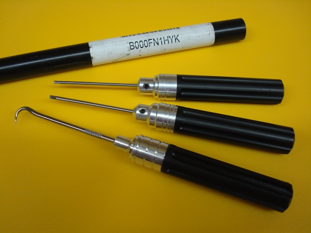

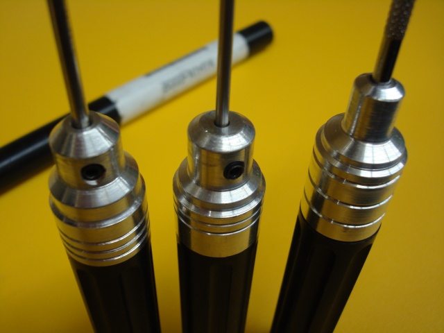

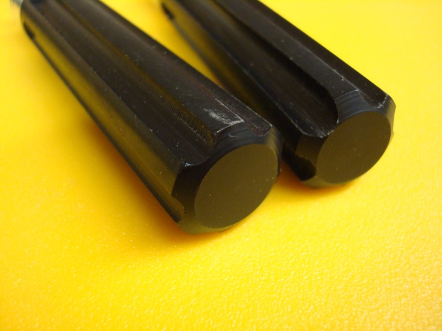

Saw a set of micro-hex screw drivers at one of the RC Rock Races and really wanted a set. I was going to make the handles out of aluminum (that's what everyone else had) but during another project I noticed that the 3/4-inch delrin would be kinda slick. I made one for each of the common hex sizes and then had a third I tapped so I could use some picks I had that had threaded shanks.
To make then durable I decided to make the heads of the handles out of aluminum so I could tap them and put small set screws in them to retain the shafts.
An 1/8-inch ball mill was used to cut the grip into the handles and then tapered them to finish them off. I got a lot of compliments on them but now take them for granted.

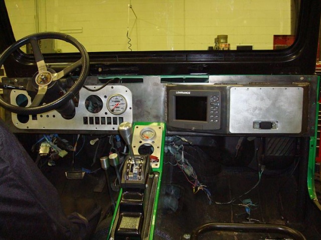

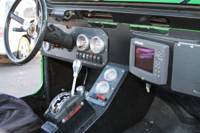

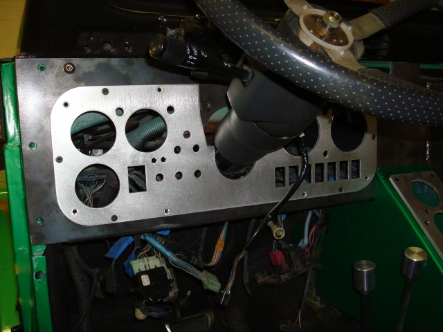

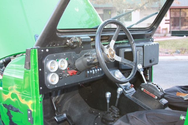

Here's a sample of some fill size fabrication on one of my project jeeps. I wanted a instrument cluster that was a little different than what most typical jeeps had. I made the main panel out of steel but then the gauge clusters out of a 1/4-inch piece of 6061 AL. The glove box retained the factory latching mechanisms so I had to machine it to accommodate them for fitment and depth.
Both of the gauge clusters (center console and drivers instrument) had to be machined heavily on the back to get everything to fit correctly. I retained the factory headlight switch and added rockers for all accessory control. What started out as a simple gauge cluster turned into a 20-some hour machining project. The rocker switches required 1/8-inch depth, the headlight switch had a goofy mounting bracket, as well as some reliefs on the back of it for clearance of some of the bracing. Because I only made one, I did all of it manually so I wouldn't make any mistakes.
As with most fabrication projects, in and out many times to get everything just right. Then I had it double powder coated (wrinkle grey with clear over the top).
And the driver's side view
