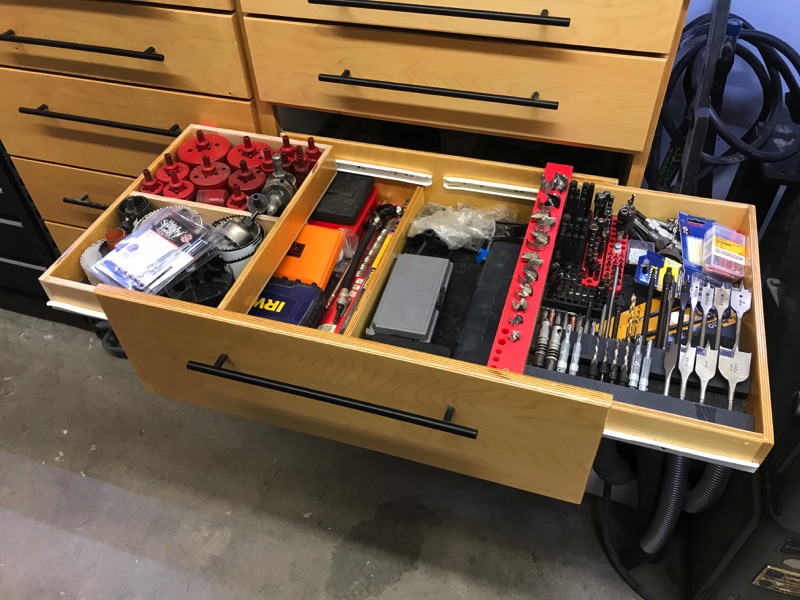

Just spent a lot of time reading through all 28 pages and love it all..
The thing that got me most however was one of the first posts.. it showed draws within draws..
What a great idea.. I've been making tool draws for my collection of old stuff and have been less than pleased with the waste of space putting small stuff in deep ish draws really is. since this photo I've unearthed at least three times more punches and drifts that need to go in here..
https://scontent-lht6-1.**.fbcdn.net/v/t1.0-9/33501348_430682114024375_7007171325890396160_n.jpg?_nc_cat=0&oh=34b524157b343342a4519109ce05da6a&oe=5BAE2BB5
and so in short..
I'm stealing that idea of draws in draws.. :) hope you don't mind..:thumbup:
Great work by the way.. Mines just a small hobby shop but it does get the odd paying job, something I'm trying to get more of as I head for retirement hence the refit. keep up the good work.. I need more ideas..lol

Definitely interior ceiling height. I need just enough headroom to have the bridge crane be able to pick up a truck and move it over the top of another truck, so it may need to be a bit higher, once I get to the engineering stage, I will let you know.
That drawer inside a drawer is definitely one of the coolest things, best use of space possible. Any regrets or things you would do differently?
L
lilscorpion
Mar 15, 2010
3,626
Colorado
The drawer within a drawer worked really well for me to make the space more accessbile in deep drawers (as Lee Ceitic commented) especially when I wanted to put things in the drawer that were fairly small or best suited for more shallow drawers. After using them for about 7 years I realized a few things:
  1. Getting something from the bottom part of the drawer required me to slide the top part of the drawer out of the way. An added hand movement.
  2. The drawer bottom, internal drawer slides, and clearance needed to make the inernal drawer work ended up being wasted space
  3. There were some special considerations necessary (in advance) when building a drawer within a drawer in order to make it as strong as a regular drawer
No storage system works perfectly for all of the various kinds of tools I have. IN the end, each comes with it some compromises. In many ways what I had before was just as ideal as what I now have. The sweet spot was probably something that incorporated both old an new thinking..

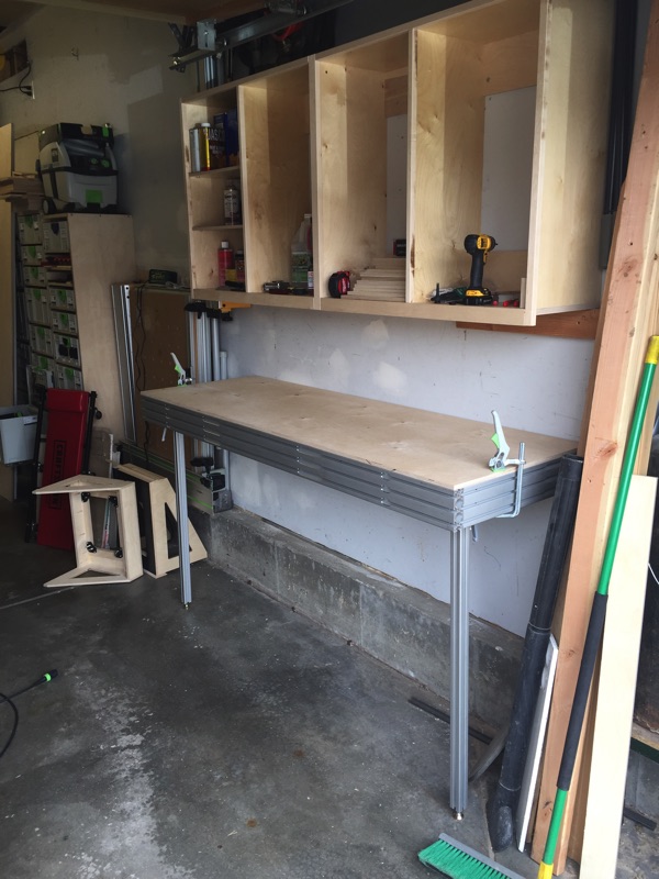

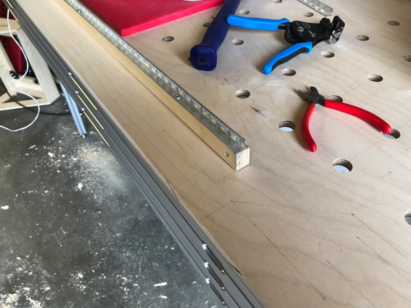

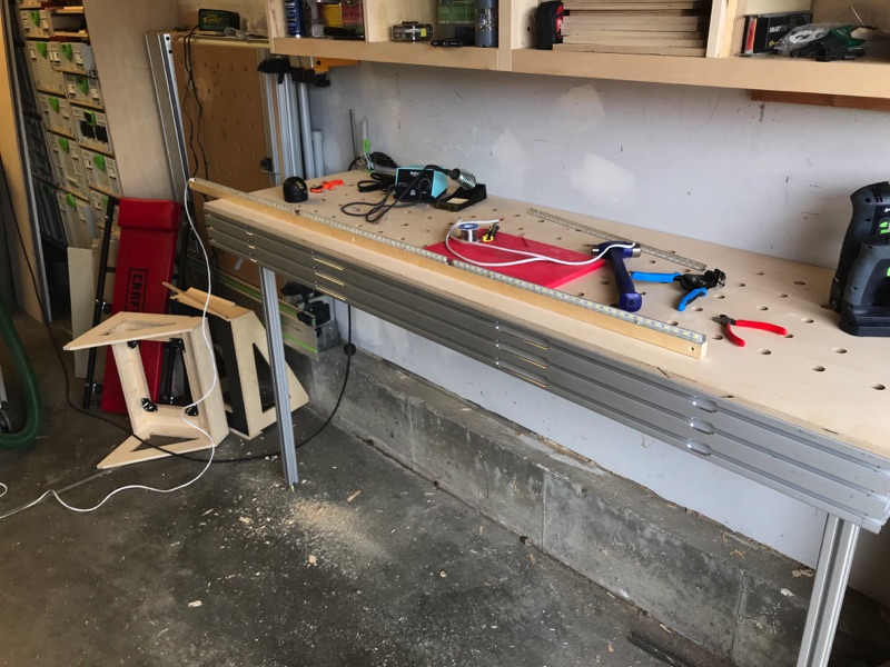

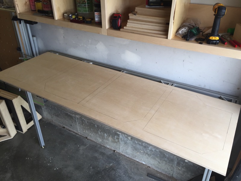

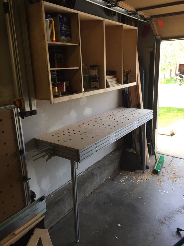

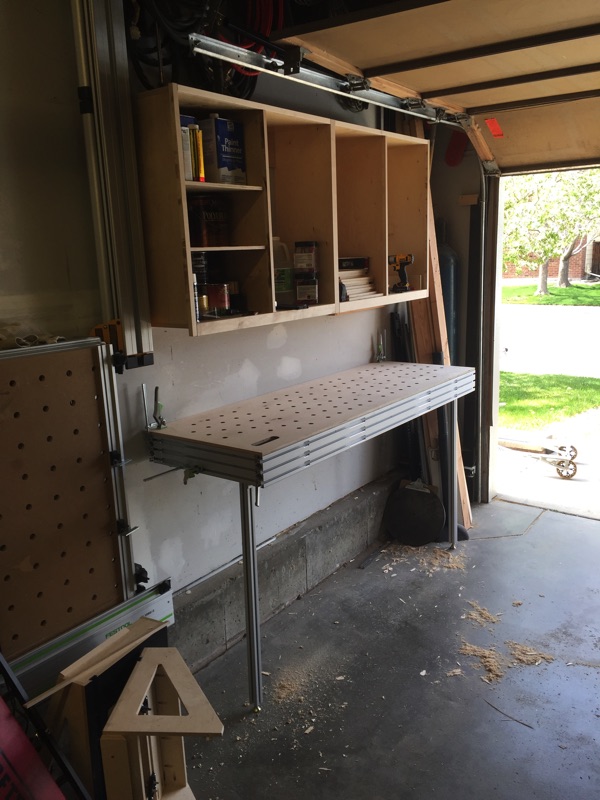

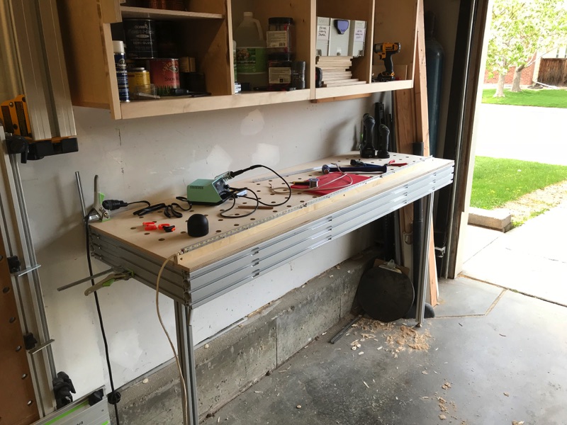

With the frame complete, I move on to making the top. Since the frame is fairly heavy, I decided to make the first one out of 1/2-inch Baltic birch plywood to save weight. This first top will be the universal fabrication top so I’ll laminate it to give it some resistance to glue and other chemicals.
With the ply cut to size, I want to machine some holes so I can clamp through the table. Since there’s a substantial amount of frame I’ll need to map it out so I don’t inadvertently drill into any of the supports. I start by tracing the fame from below.

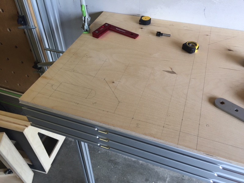

I then measure and transfer the frame locations to the top. With a clear understanding of where not to cut, I lay out where the clamp holes can be.

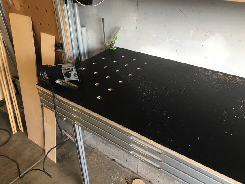

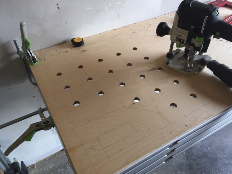

To allow me to use all of my various clamping implements from my MFT, I machine the holes to be 20mm. Dust collection on the Festool router is king. Last time I did this same task there’s was dust everywhere. This time only a little.

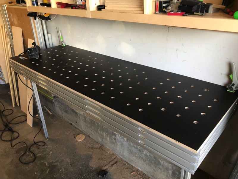

A shot with all of the holes machined. I’m just OCD enough for the lack of hole symmetry to bug me a little. I had planned on cutting two longer slots for hand-holds on either end.

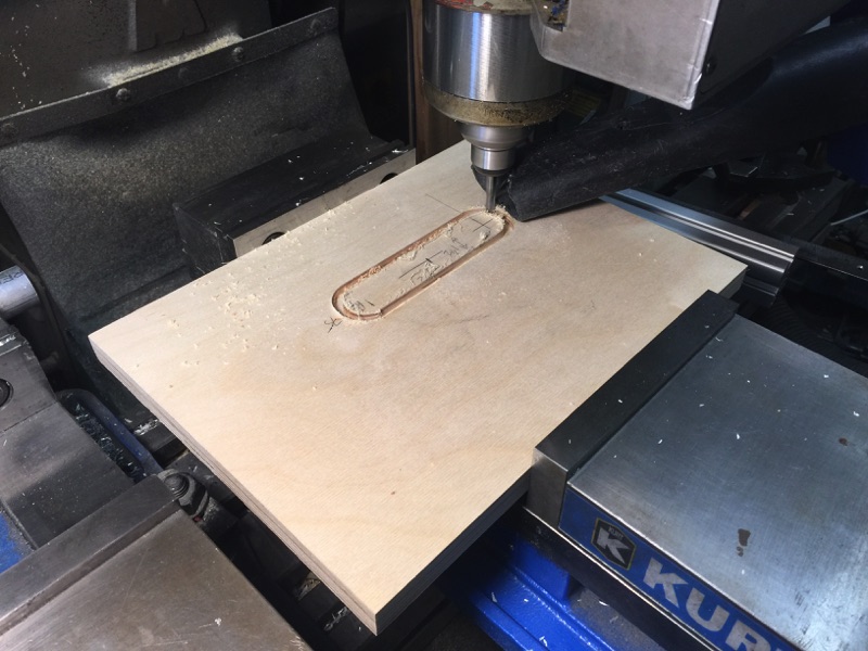

Hop over to the mill and make a template out of scrap ply. I’ll use two of the edges to reference perfectly in the corner which eliminates centering or measuring to get the hand hold where I want it.
After cutting the first one I realized that the same location on the other side wouldn’t work because I forgot the legs offset difference between sides (damn it). Looks fine with one hand-hold, moving on.

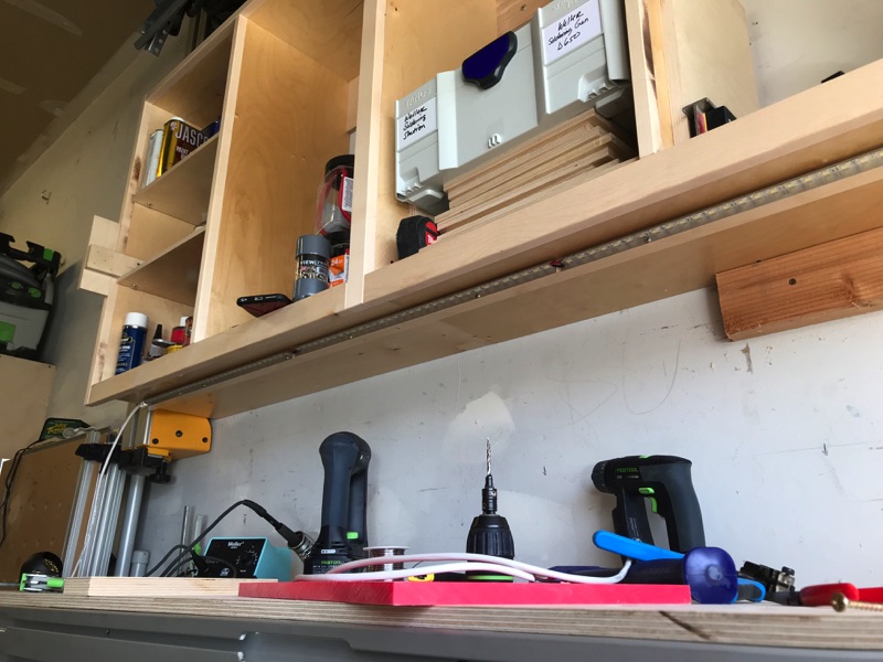

Though there’s ample light on this at this bench when the garage door is open, there’s very little when it’s not. This seems to be a really good place to install some of those lights I salvaged from the older cabinets. I have 4 left at about 22-inches each which I have in the pile on the bench which could be repurposed here nearly perfectly. The bench/cabinet length is 6-feet so 3 of them should be enough.

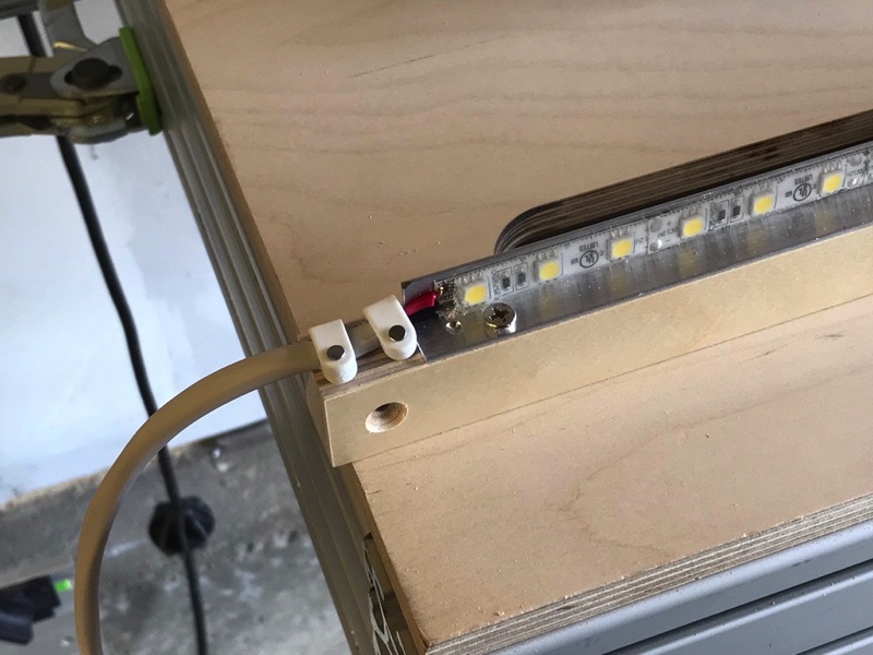

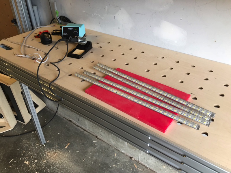

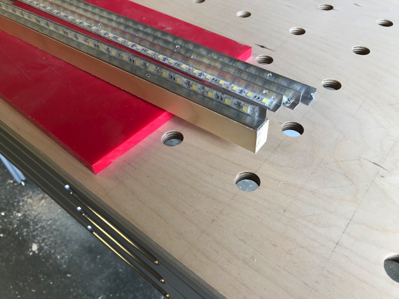

Here’s a shot at how I’ve been making under cabinet lights. I use some 1/2x1/2 aluminum channel and the 3M backed led strips stick to them well. Then I use 1-inch strips of scrap to make mounts and screw the aluminum channel to them.
The three strips become 1.
The rigidity if the ply strip allows the whole assembly to hold tightly under the cabinets (no sag) with only 3 screws over the total length of the cabinet.
Any movement of the wire and the stick-um loses its fight which then puts pressure on the soldered wires so I add a couple wire clips and nail them into the wood strip.
This is the first time using the bench. At just over 44-inches high, I was concerned that it might be too high. As it turns out it’s much easier on the back for things like soldering and other activities where I hunch over to do the work anyway.
With these out of the way, I can move back to laminating the top.

I just want to take a minute to thank you for the inspiration. Over the last month or so, I've read every post in this thread and in the original thread. I've been lurking on GJ for awhile, but I find that the community is so vast, often I have nothing to add to the discussion.
My OCD is not as robust as yours (which means I'm not going to be making drawer inserts fitted for each individual tool), but I think the biggest benefit from your work - and from the sharing of your work - is that you are making a full-on attempt at working within the space limitations that you have.
It seems as if everyone here on GJ (myself included) feel that the answer is more space - or a bigger workshop. Sure, I'd like bigger, but after a serious examination it is apparent that I need to use the space I have more efficiently.
Anyway, thank you - and carry-on.

Not done, had to work a minute. ;)
Lamination goes quick. I used the same matte black that’s served me so well on my other work surfaces. Once laminated I have to re-cut out all of the holes with the flush trim bit.
A 1/16 round over bit is used to finish each of the holes. I prefer the round over to the chamfer (45*) because it leaves the hole edges feeing completely smooth.
To attach the top to the frame, I used all I had - 5/16 machine screws. The shear hugeness of their heads required way too big of a chamfered hole for my woodworking chamfers. This forced me to use my 1-inch 3-flute countersink I use on the mill for metals. Problem is, a 3-flute on a hand drill tends to leave wobble-shaped holes…so they’re not perfect but they’ll do. Mostly hidden by the fasteners anyway (but I know they’re still there).

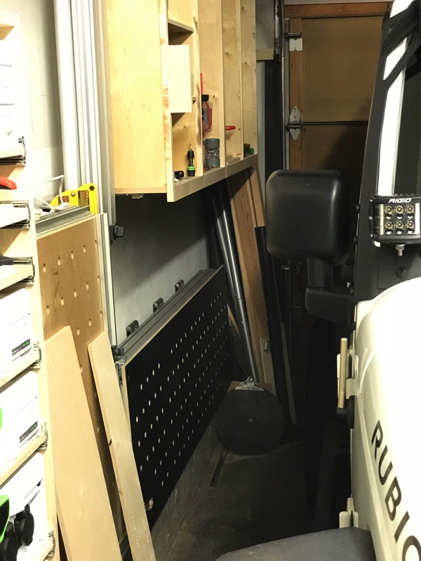

As the table folds away, the laminated surface is there to protect it against bikes, doors, etc. Ironically though, the door of the Jeep would most likely hit the upper cabinet first.
