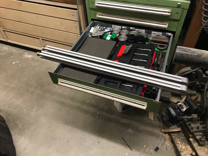

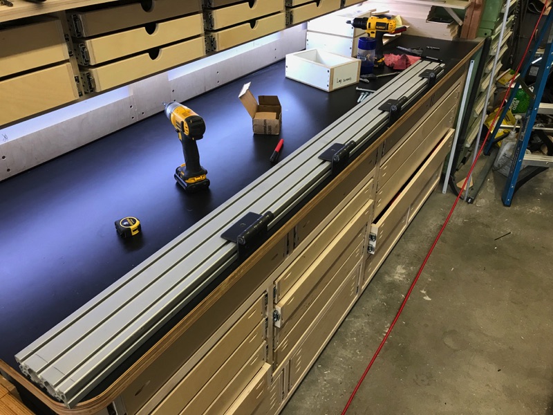

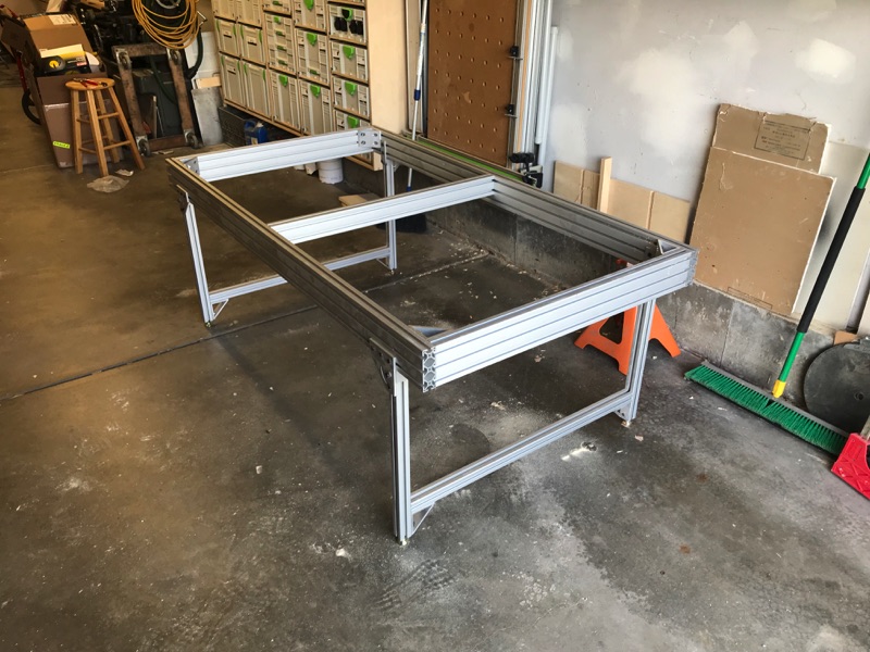

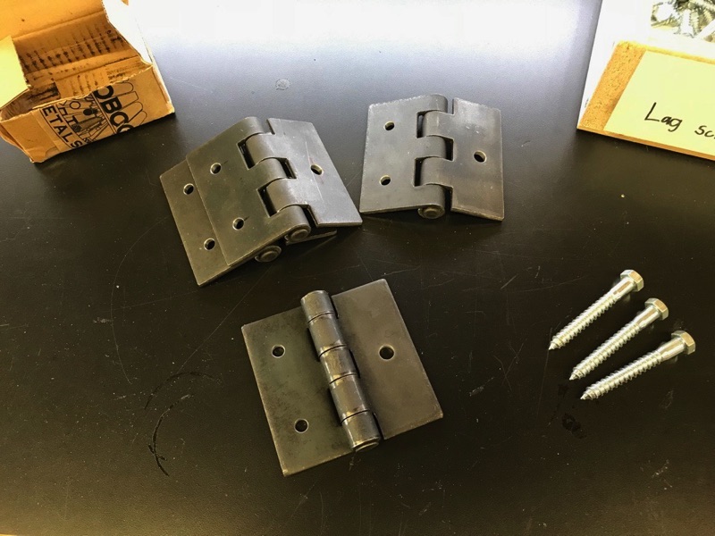

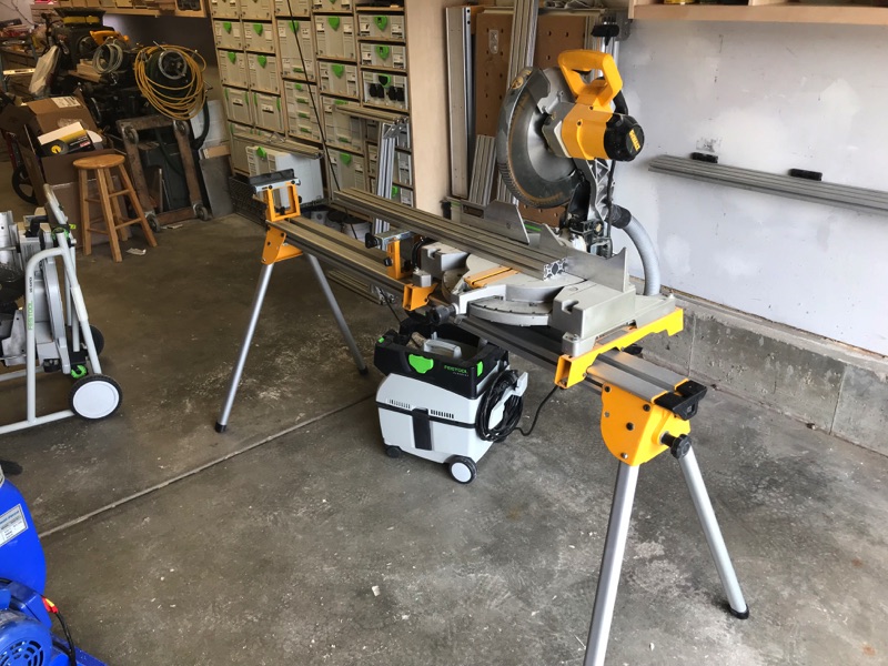

The last pair of slides didn't show up last week so, in order to keep things rolling, I needed to move on to another project. Here’s a 80/20 assembly table I built about 5 years ago. At the time I wanted a larger table so I could use it in two modes:
1) I could lay a 3/4-inch sheet of material on it and fabricate full sized cabinets on it.
2) Swap out the sheet for a torsion box too that would allow me to use it as a super huge fabrication table/bench
The idea was great in theory but I found that it was just clumsy enough setting up and breaking down that I’d only use it in the really big projects where the garage would be in build mode for months. Now, it’s current configuration, it’s 6-feet long by 42-inches wide.

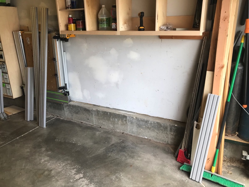

I was thinking that it would be cool if the thing was somehow attached to the wall in a way I could flip it down, use it, and flip it up. I started shopping around for some hinges that could handle the weight and found these builder heavy duty weld-on fence hinges.

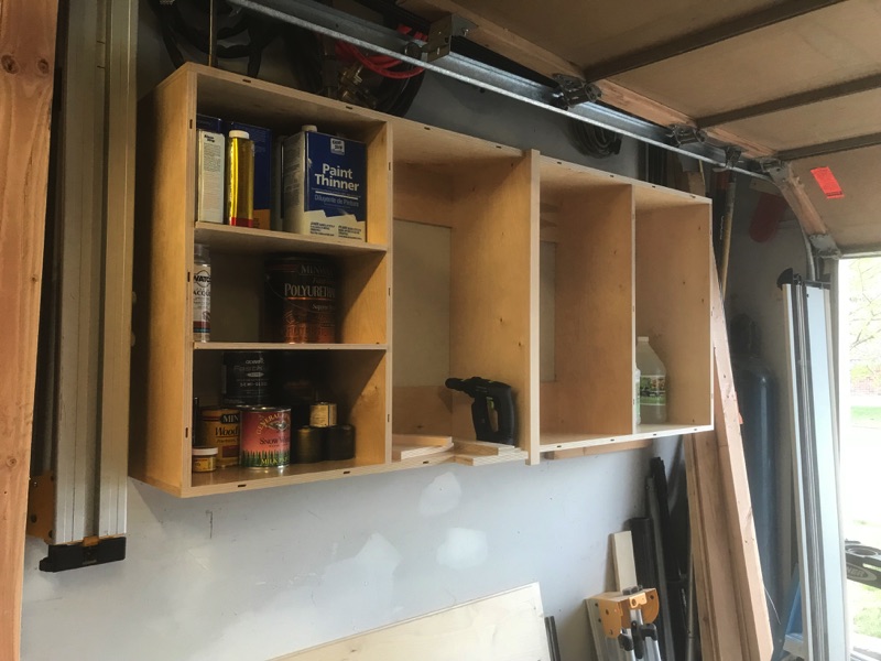

Originally I had built this cabinet to just replace the smaller one that was there previously but the more I look at it, the more I think I’d like it to find a way to make better use of this space.. Most of this time I set up the miter-saw 2-feet off this wall but there’s no reason why it couldn’t be another work space if I had a bench top. If I did, it would need to fold down so I can get the Jeep in the garage.
I was really liking the idea but some simple measurements indicated that the fold down work surface, when in the up position, would be higher than usual for my benches and sit about 40-some inches off the ground. I kinda liked the idea of a higher work surface though. Quite frequently I find myself hunched over a 36-inch high top so adding 4 inches didn't seem like that big of a deal. I liked the idea so much, I just went for it and started disassembling the bench.

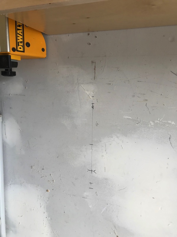

With the bench completely disassembled, I now needed to plan out where it would mount on the walls and how wide it could actually be.
I marked out all the studs and doodled some work surface heights until I found a good compromise which left it wide enough to be useful yet still clear the foundation when folded down.

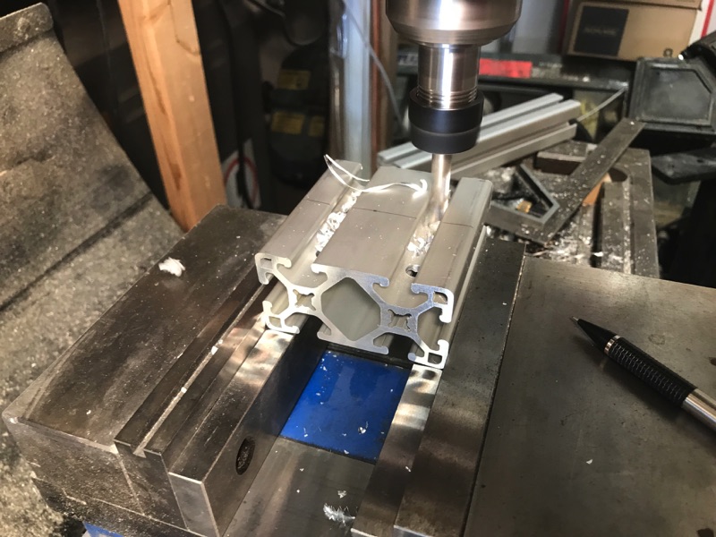

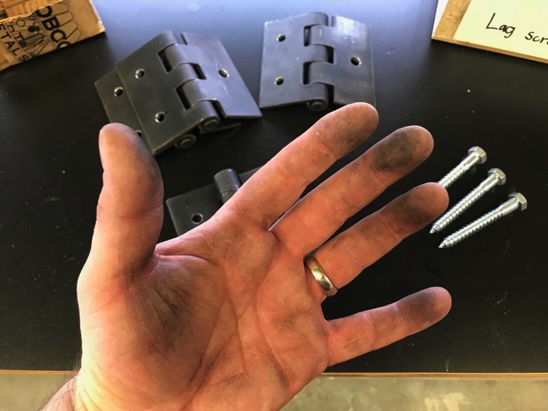

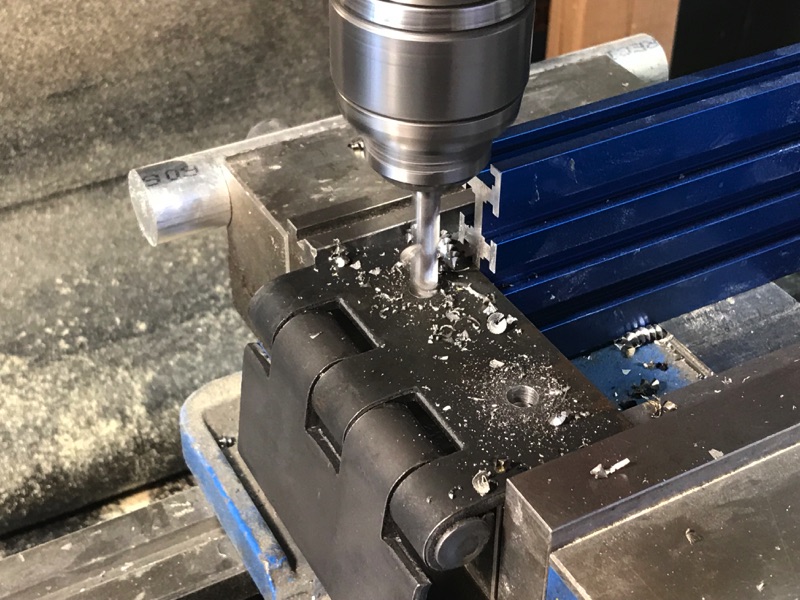

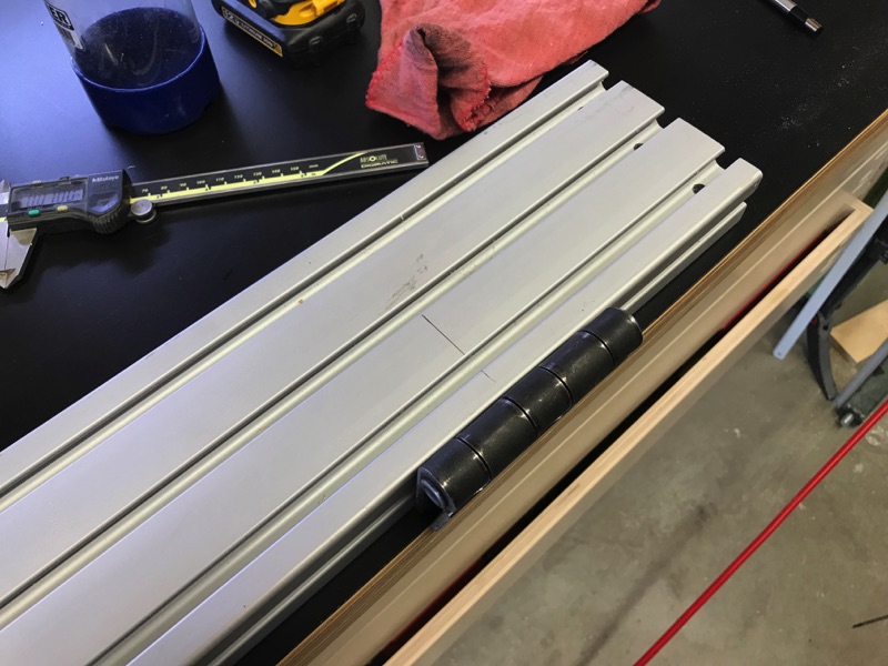

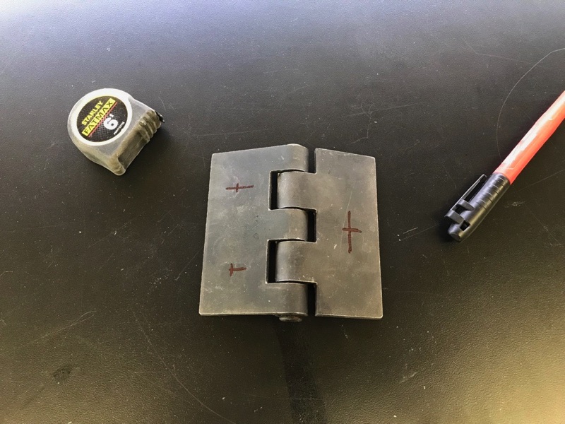

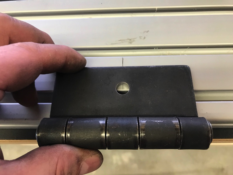

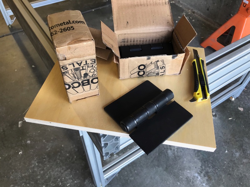

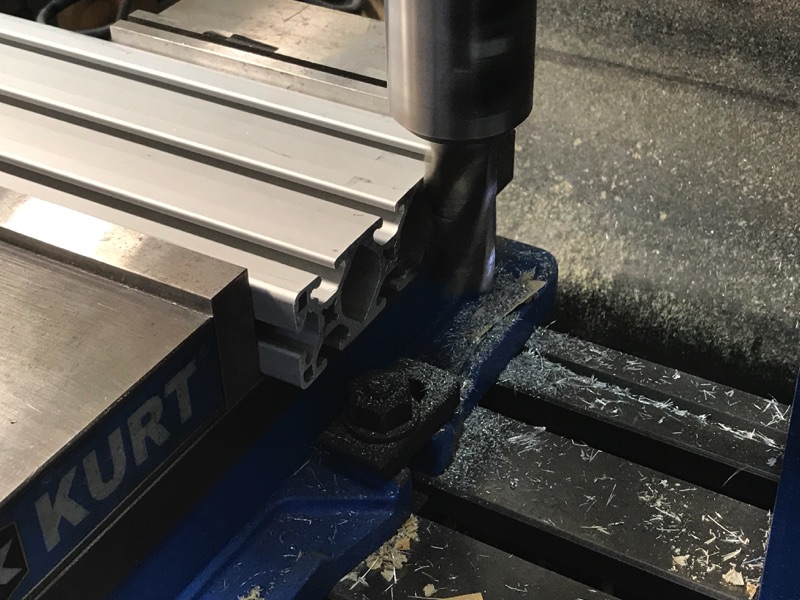

Now to machine the attachment holes for the hinges. On one side I’ll have two which will attach to the extrusion. Two on the extrusion side because they’ll force the hinge to sit perfectly perpendicular to the extrusion.
A couple of gratuitous Mill pics - first one I’m center drilling the hinge for the extrusion side.
Now for the wall side. I measure the bolts I have and they’re 3/8-inch. I’ll drill a centered hole for just one so I can sink it right in the middle of each stud.
A flashback moment - I’m reminded why I enjoy wood so much more.

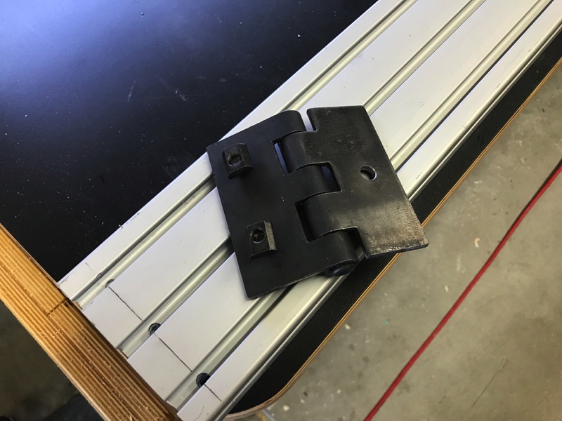

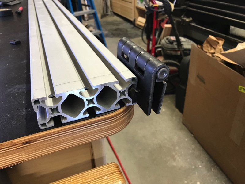

T-nuts are installed on the hinge.
And then the hinges are slid on to the bottom of the extrusion.

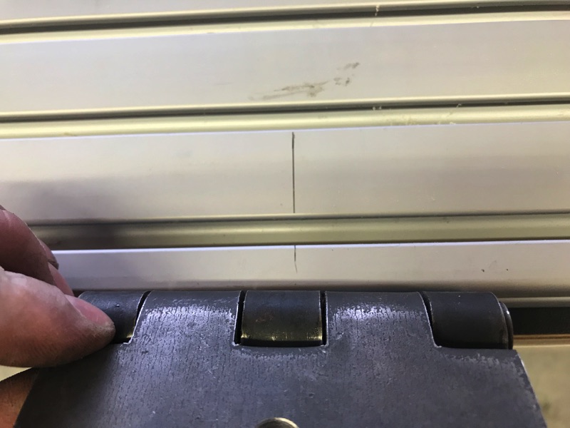

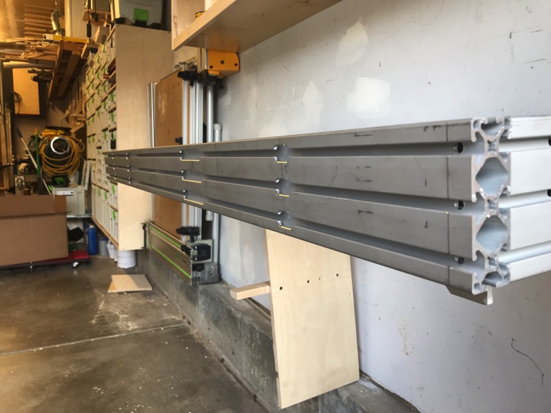

I then measure out and mark the spacing of the studs I noted earlier from the wall.
Slide the hinges down to the marks
And locate them so the hole for the lag screw is perfectly aligned with the hole (which are aligned perfectly with the studs).
Do this three more times until all of the hinges are in place.

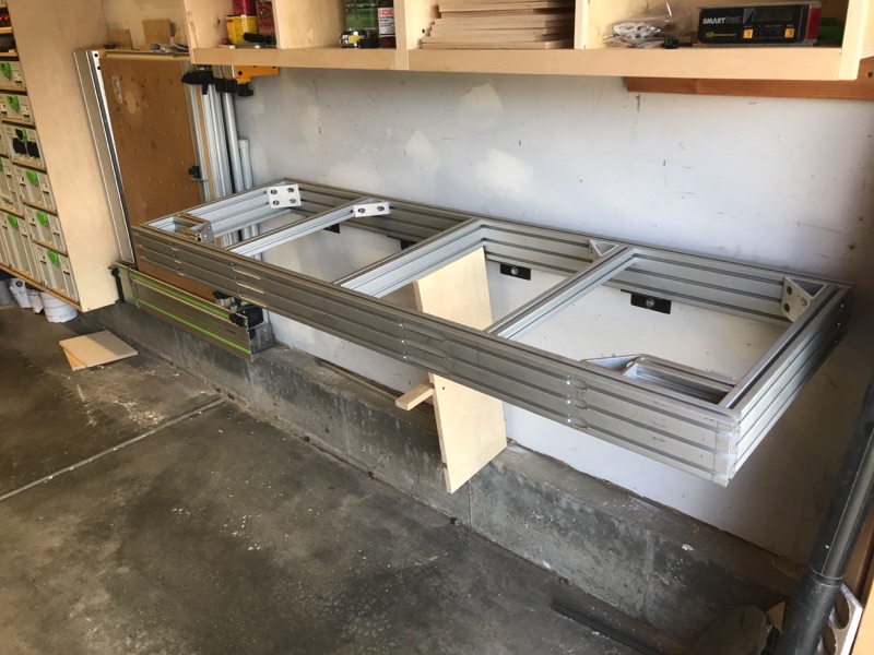

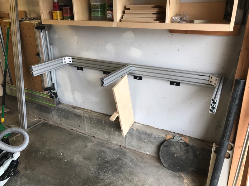

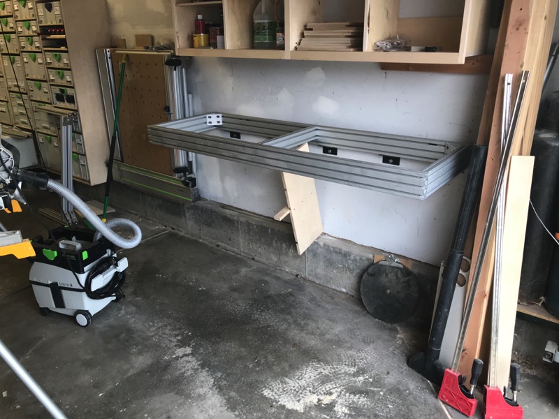

After mounting it to the wall, I verify the plan is good by making sure the table can be as wide as I thought. I get out my Dewalt miter saw and set the stop. I’m cut down the table spreaders to 22-inched which should net me a total finished width of 25-inches

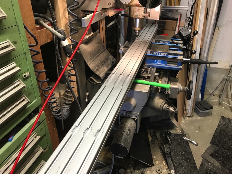

After cutting them down, I take a pass or two on the mill to ensure the ends are square.

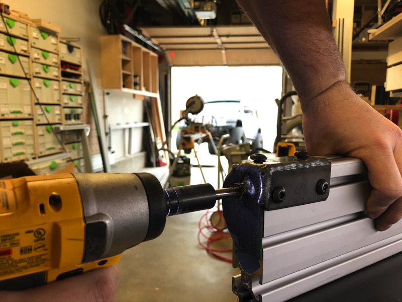

Cutting them down requires that the shortened end gets the-tapped so I get out my impact, my tapping fixture, and knock ‘em out.
One by one I reinstall the pieces back to the main assembly.
Until I can add the front rail back.

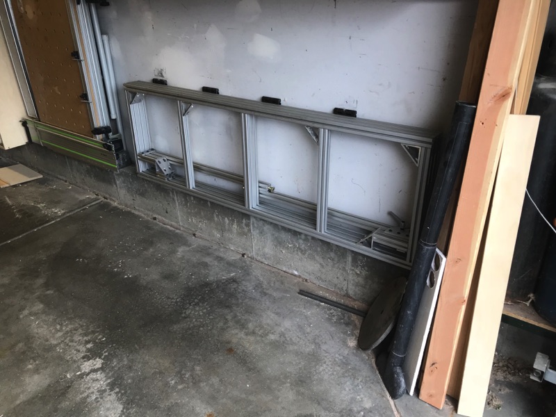

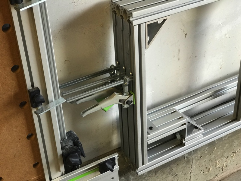

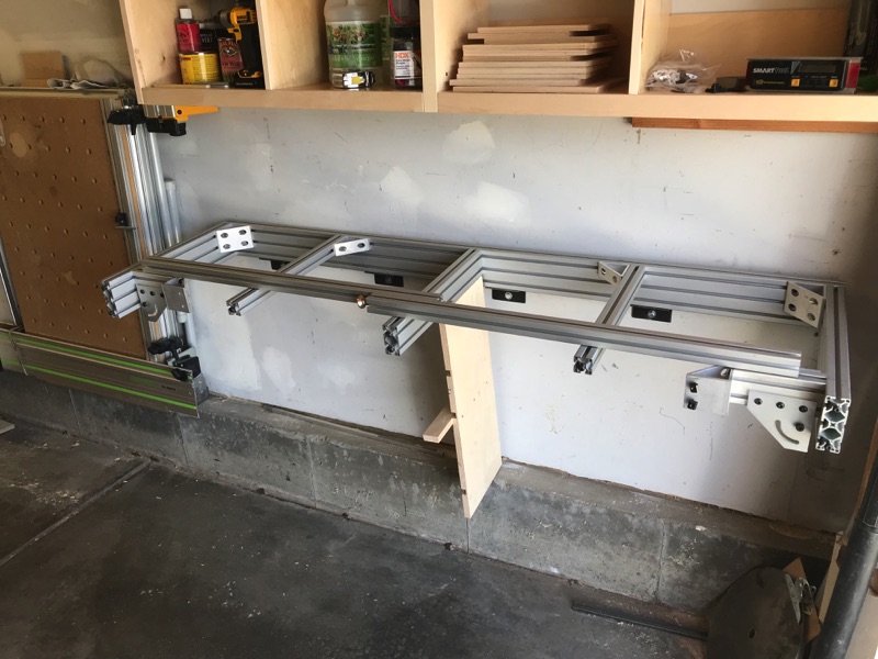

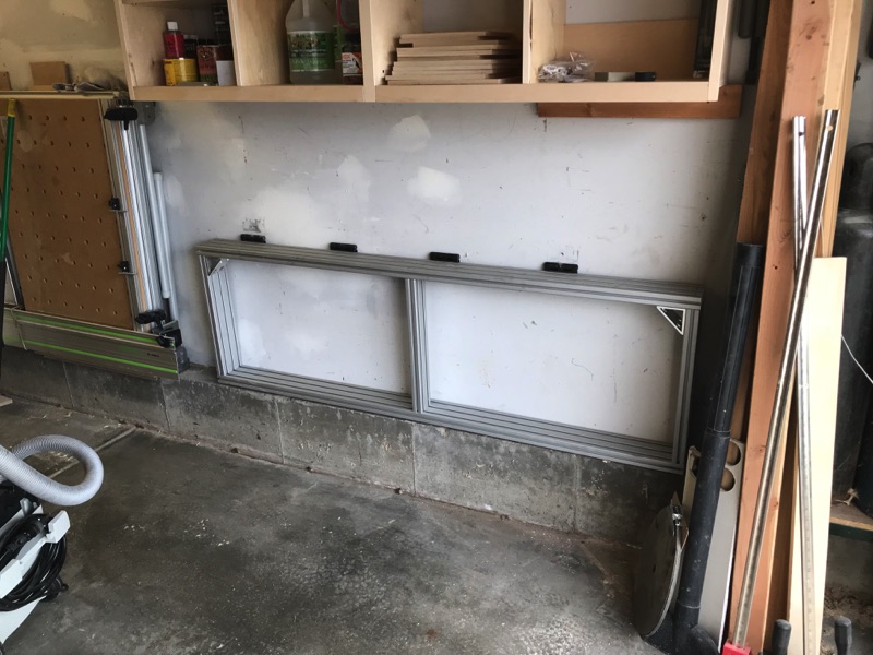

Folded down. It’s just barely wider than the foundation lip.
It's easier to visualize now but the next trick will be in mounting the legs. At exactly 6-feet in length and about 36-inches off the ground, the legs will be too long to fold up in either direction. I'm going to have to do something special here to make it all work.
Strouty
Mar 21, 2010
38,208
Southern Maine
Could you have the legs fold at an angle and make it work? They may fit within the two rectangles you have made.
That’s what I’m thinking. In order for the table to fold nicely against the wall, the legs need to fold up into the cavity and sit flush with the bottom. On the angle the legs can be almost exactly 36” long (which is how long they need to be) and sit flush but I’m not sure the 90-degree living hinge will be able to rotate the full 90-degrees with how exactly 36” it is. The challenge will be to figure out how to mount the leg brackets which attach parallel to the extrusion.
Strouty
Mar 21, 2010
38,208
Southern Maine
I was thinking you may mount them on those inside corner braces, you may even have to remake the braces as the angles probably won't match up due to the leg length.

If I could get them to pivot, I’d probably skip going all the way to the ground and attach them to the foundation. Unfortunately they’d not be long enough to mount this way otherwise. Need ~34”, have 27”.

Been thinking about how to do this. I could machine them out of aluminum angle and use a piece of 1515 to support it from above/inside. All I’d have to do is machine the ends to complementary angles and it should work. Would have to get fancy on attaching it to the frame using standard 80/20 attaching methods though.
What about triangular shaped pivots out of ply attached to the wall (vertically) that fold out and support the top ? Roughly as where you have drawn the red lines. You would have to shim out the hinges from the wall so it would still fold back down over the thickness of them though.

80/20 has plans that utilize the method you’re recommending. If I had started out with thinner extrusions I’d probably go this route. I’m keeping this idea in my pocket for now as a fall back. I’d like to keep it as close to the wall as possible even if that means i have to get creative with the legs.
Hm...but the “flaps” could mount to the underside of the table and serve the same function...interesting.

That was my thought as well. You could even use smaller 80/20 to make the wings.
Think that’s going to be plan B. I have so much “extra” stuff left over after reducing the size (I now have 4 legs, 2 cross-supports, a bunch of gussets, and a grip of hardware). Im thinking I should start with laying it all out on the bench and see if I can come up with a way to solve the problem with the parts I have. Spending more feels wasteful.
Plywood is on hand so it wouldn’t cost more. Concern I have is the table is so damn strong they way it is, using only plywood seems like a paradox
I like GB’s idea as you mount the pair of leg supports on edge with a hinge outside of the table which keeps them at the same width as the table. You could then mill a slot in the legs so that they could stay attached as the table swings up and you could use a threaded knob to tighten keeping it all very compact.

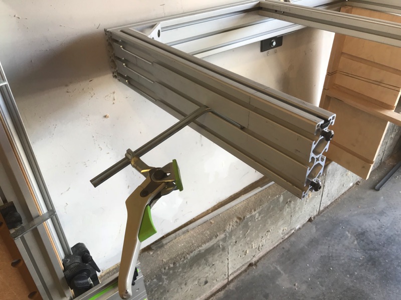

Back to work on the flip up bench.

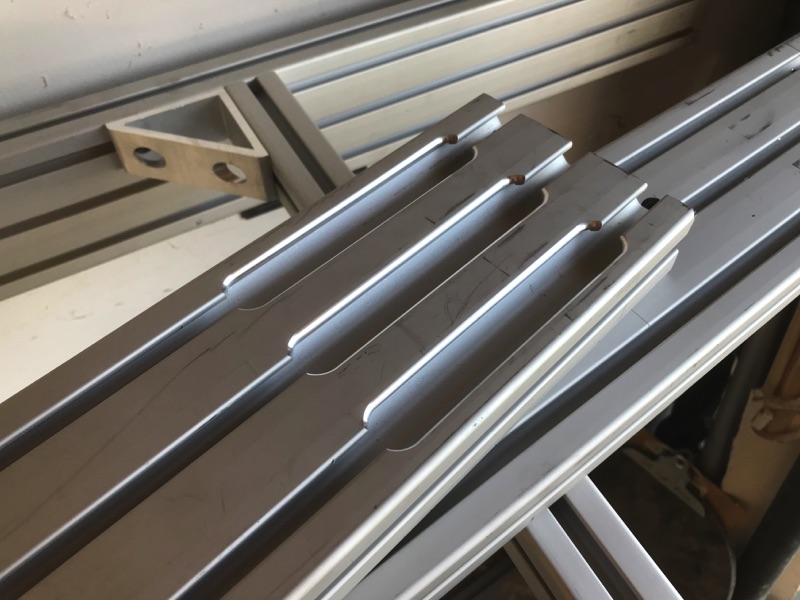

With the basic construction of the bench complete, I disassemble it so I can make a few modifications. I use Festool ratchets clamps quite frequently so I decided to cut some slots that would allow me to more quickly slide them into the extrusion. The 3-flute aluminum end mill makes quick work of what’s just slightly thicker than .250.

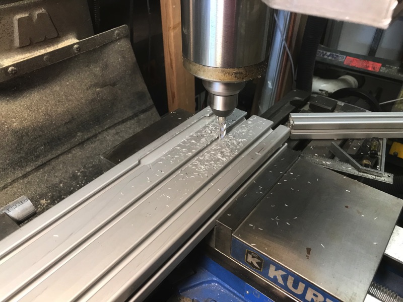

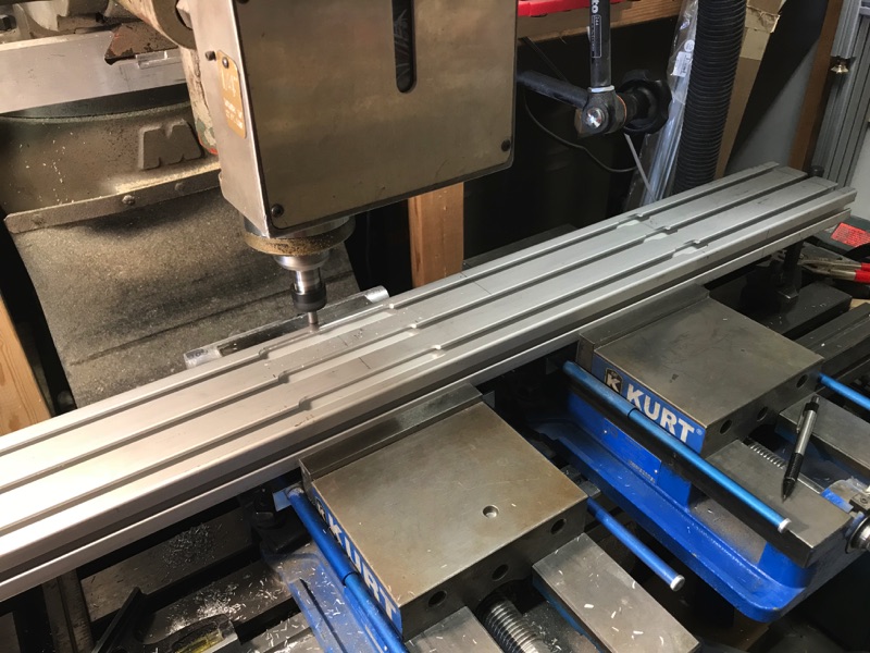

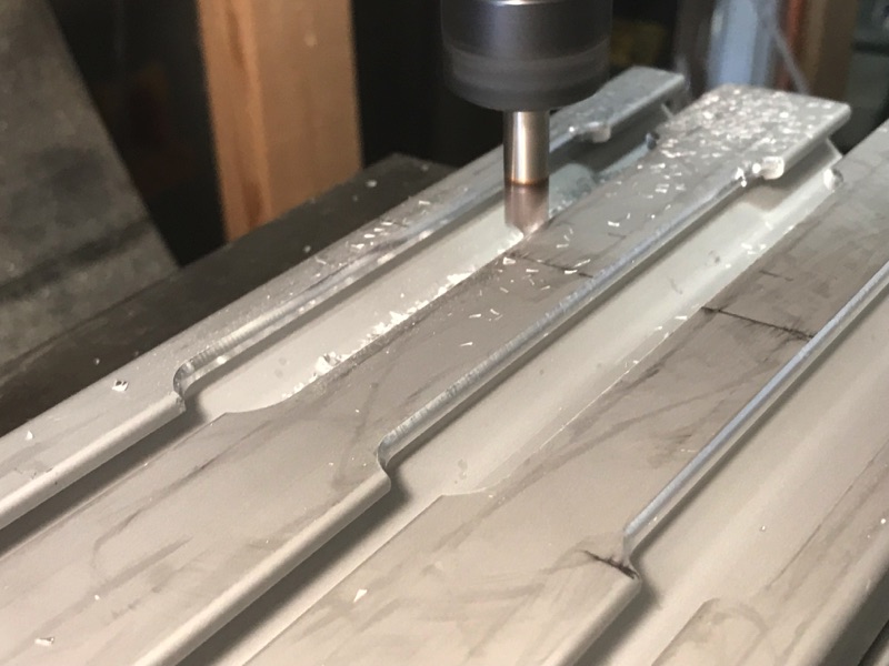

It just so happens that I have a radius end mill that has the same radius as the edges of the 15-series extrusion so I use it to break the edges of the slots.
These slots turned out beautifully.

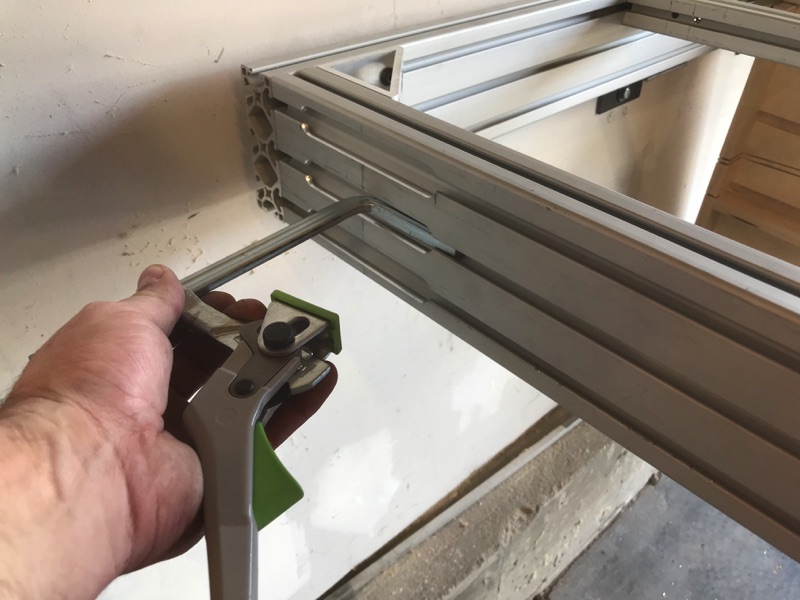

With a loose grip, single hand, and barely paying attention the clamp heads easily enter the slots.

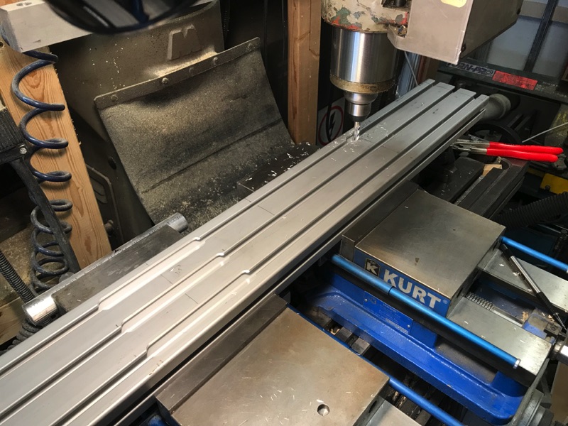

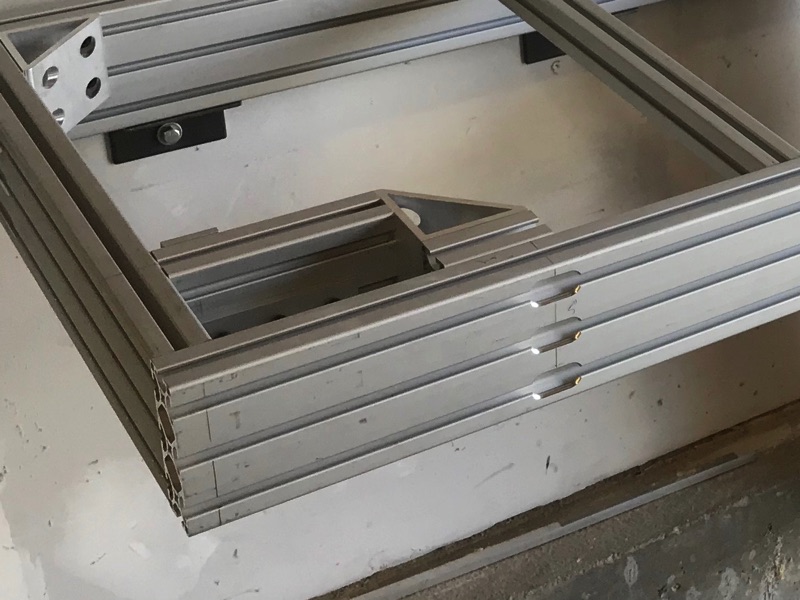

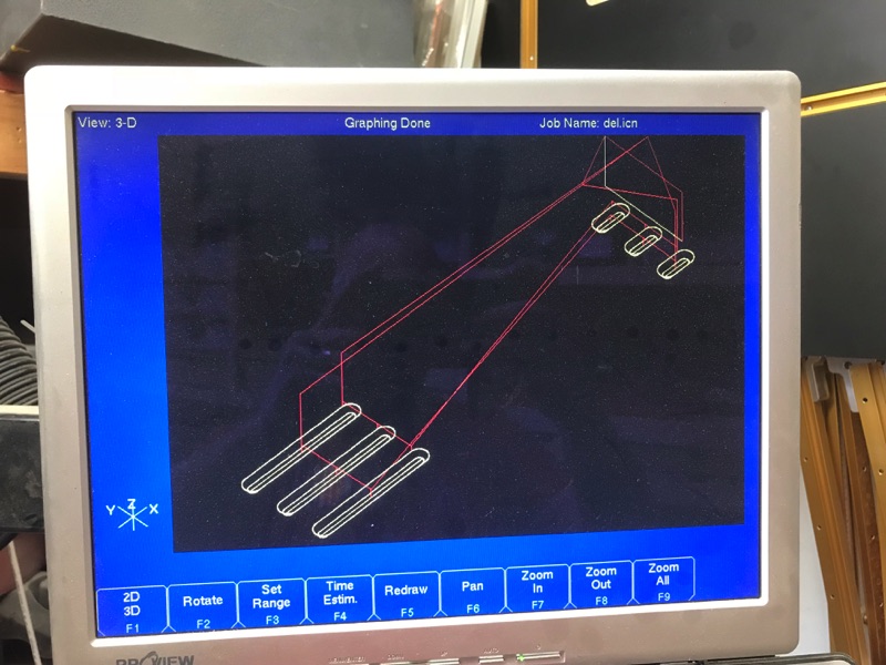

On what to do with the front rail. I want to add two sets of these clamp access slots. I’m also going to add a set of shorter slots about 14-inches away so I can make fixtures for the bench later. I have a few ideas I’ll continue to think through but, for now, I’ll cut the slots and move on.
With the 6-foot rail supported, I cut the slots.
Flip it end for end and cut the next set. This will leave me with perfectly symmetrical slots.
And finish the slots the same way I did on the sides by rounding them over.

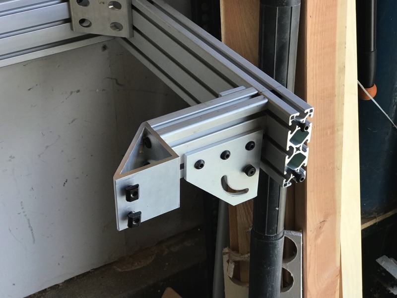

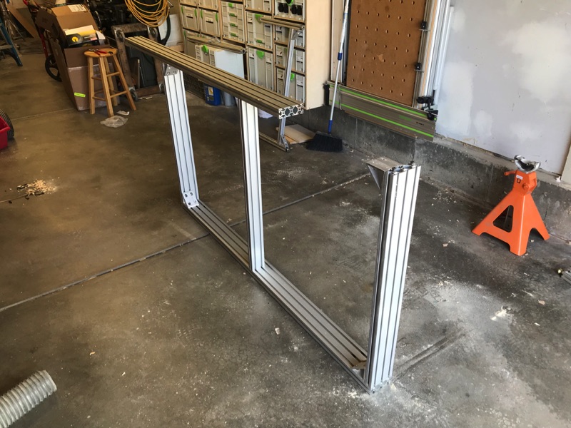

Alright, now for the fold-up legs. I wanted to start out attempting to use parts I had so I laid overlying out on the bench and did some thinking. About the only way the legs can be the length they need to be is if they fold up sideways into the table. The legs need to be 36-inches long and the table is 60-inches long total. I started by making some simply arms which would support the brackets and mounted them all the way to the edge of the table.
With the brackets in place, I needed a set of legs. The previous legs were too short to use on this bench but I was able to use two of the previous cross members which were only a few inches too long. After cutting them down, i only needed to run the tap in an inch on one end so foot could adjust all the way in.
With the set of legs, I now was able to actually see what I'm up against. I realized that if I offset one of the legs 1/5" then they'd fold up next to each other. Out of dumb luck the middle x-member was a 1530 (not 1545 like the perimeter of the top) which allowed the legs to fold up inside. Almost like I planned this all along.
I used the drop from the original 1530 x-member to make the spacer. I cut it to be the same size as the angle brace and drilled through-holes so I could attach it to the face.
Time to mount the front rail
I didn't get a great picture of the spacer but you can see it in there. The only downside is it adds just a little unnecessary weight. I'll live.
Looks sweet. I’ll have to machine some custom caps for the ends at some point.

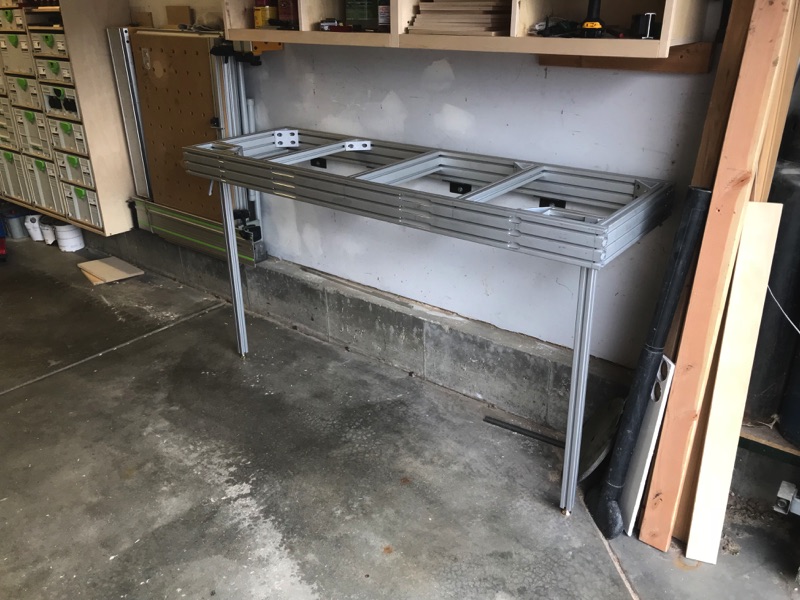

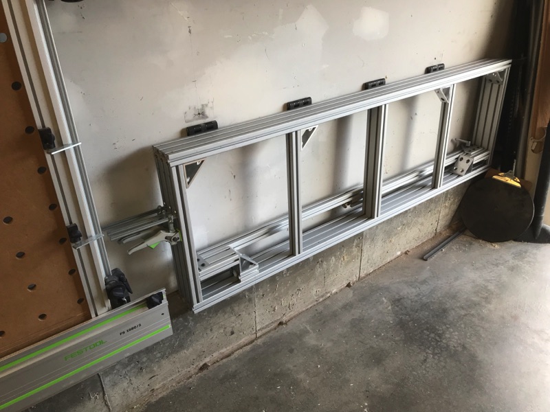

Installed the legs and leveled the bench. Holy **** is it strong. The 1545 beams are super over-kill for such a small bench. I'd bet that 1530's would be plenty.
Folded up, it only sits slightly more off the wall than it did before. The pivot brackets of the legs stick out the bottom by about 1/2-inch. I could slot the drywall I suppose if I really really wanted it to sit flush. It's good enough.
This is kinda neat unintended feature. I can now store clamps on the bench while it’s folded up. There’s just enough space between the MFT and the table so I can access them up or folded down. From now on I'll keep 3 here.
Getting a little closer. Next will be the top.
