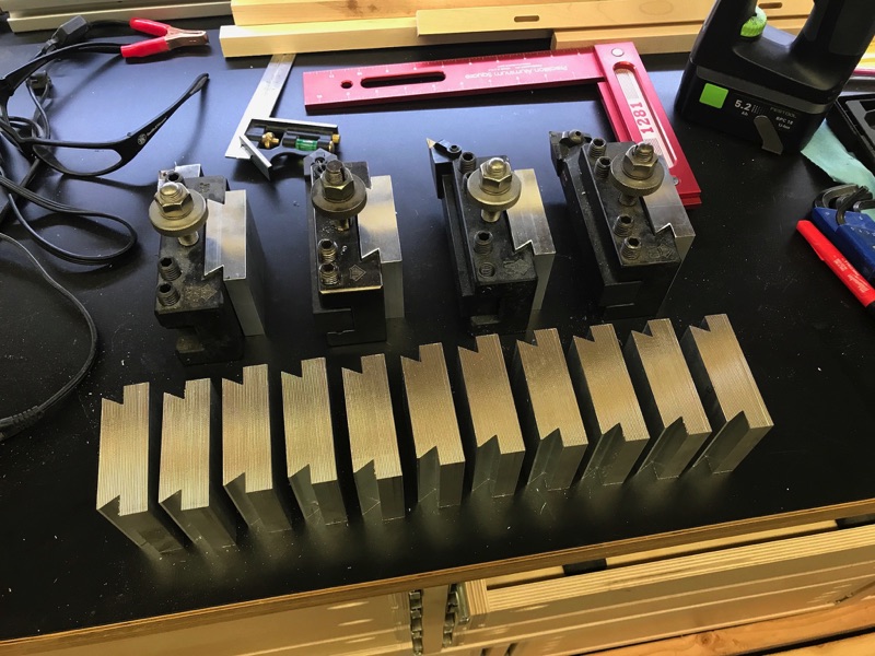

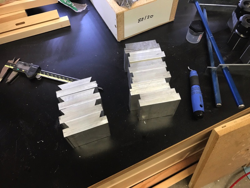

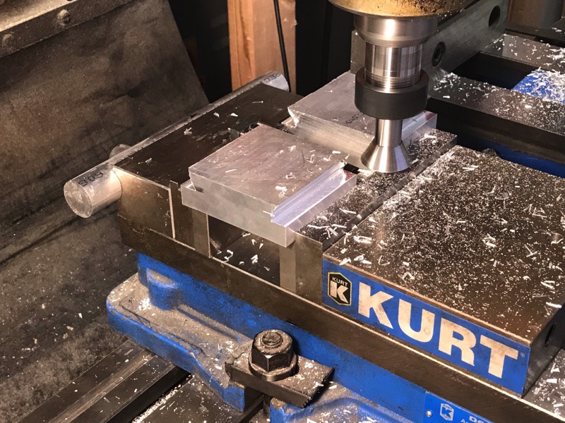

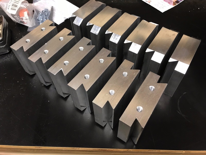

Building up some parts for the lathe tooling organizer.
L
lilscorpion
Mar 15, 2010
3,600
Colorado
Are those aluminum?

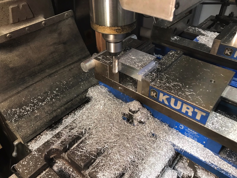

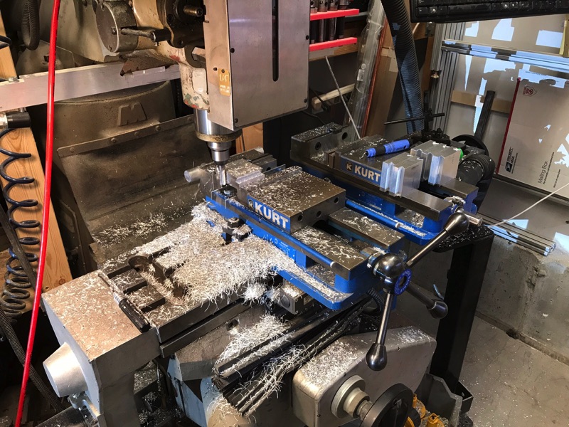

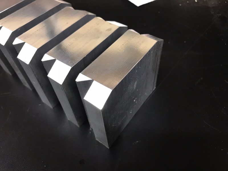

Yes, 6061. Started out with 1x3 bar. Started by roughing operations to square the bandsaw cut ends and then relieve the excess for the dovetail cutter. Before and after dovetail.
Dovetail cutting with a single insert cutter takes longer than I like being an impatient person. Hindsight I'd get a more aggressive cutter.
Last op is to clean up the ends with a finishing end-mill..
Machined a profile into the upper edges. This will make more sense when the organizer comes together. More or less, I needed to clip the corners do I don't cut my wrists putting the tooling away.
and then a way to mount them to the organizer - #7 drilled holes followed by a 1/4-20 spiral tap
The upside is I got about 16 made. The downside is that I realized I need about 20. I had to order more material and run another batch. The "batch" work isn't difficult, it's just time consuming. What ***** is that I find myself in a situation where I really only need 4 more but I should probably go ahead and make 10 more so I have extras just in case. This way of thinking is a curse if I never need another and a gift if I find myself wanting one or two more a few years from now...

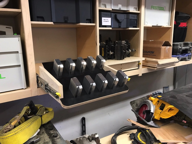

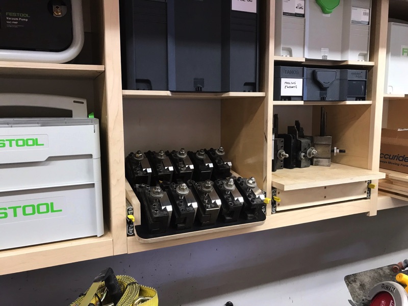

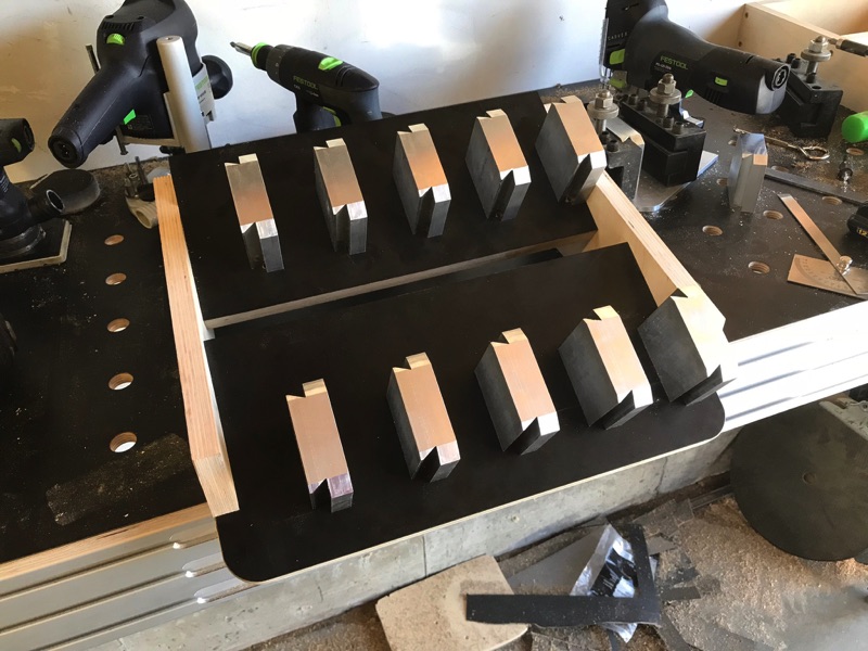

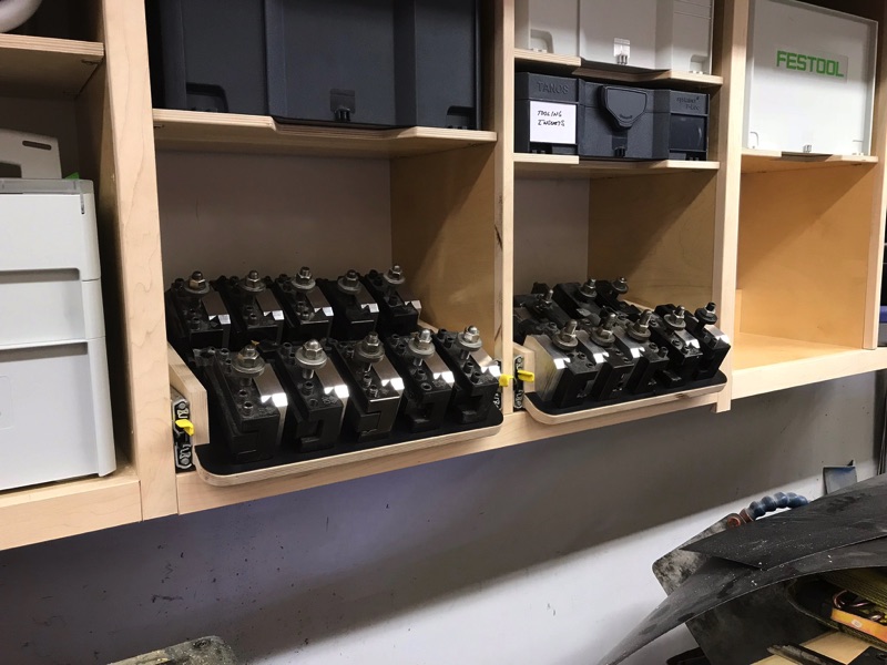

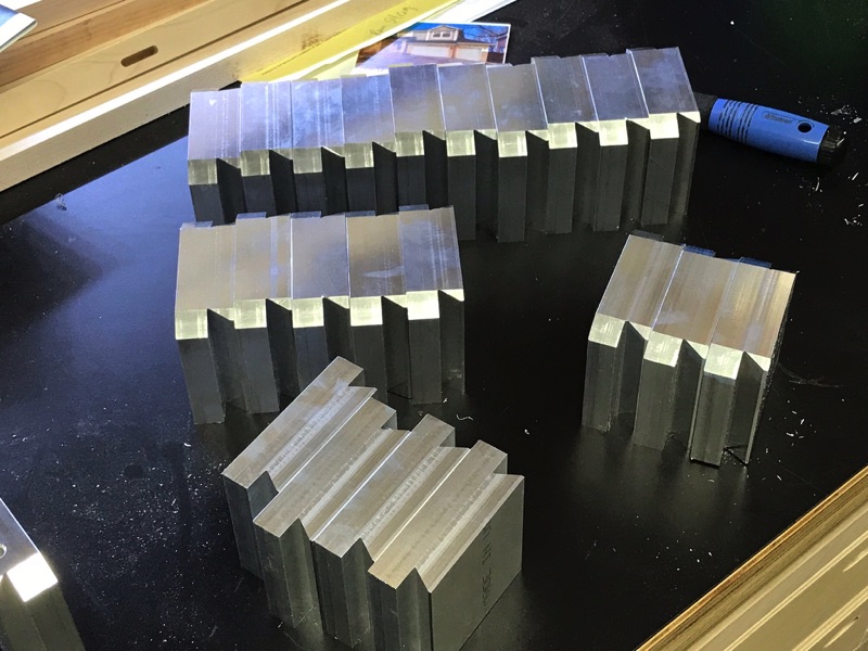

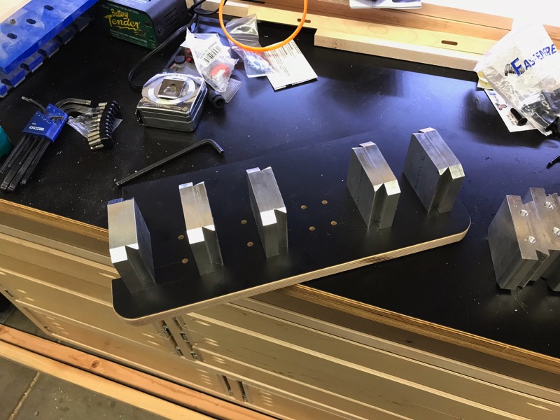

Yesterday I got to more bars of 6061 so I could make the remaining holders needed for the lathe tool holders. Though I really only needed 4 more, I decided to make all that I could out of the material (8).
The pile slowly builds. At this point I have about 12 hours in machining time.

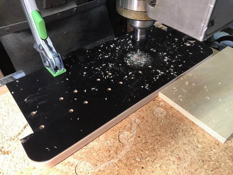

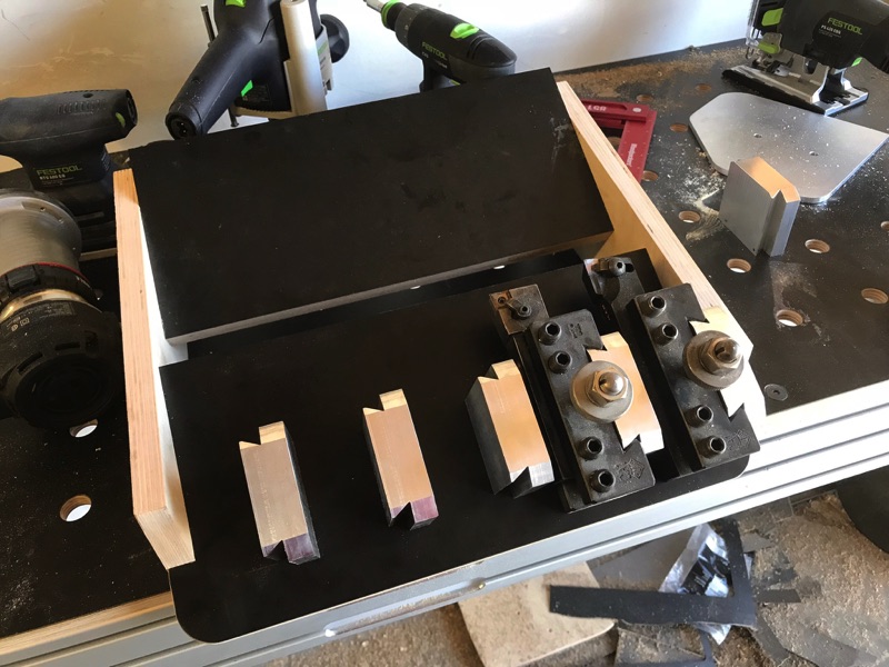

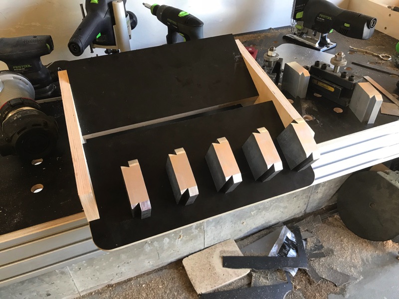

I re-designed the trays that will hold the tooling (thanks to some feedback I realized i was being lazy). This new layout is more space efficient and tips the tools towards me which makes it extremely easy to see which tool I'm going to grab. The laminate will help protect the wood from the oils and fluids.
Holes were drilled through the surface and counter sunk from behind so that I could attach the holders using 1/4-20 flat head screws.
Spacing worked out quite well actually. Five holders per "shelf".
Test fitting the tools.
I have a lot of right hand tooling so I set the rear spacing to be identical to the front. This allows a total of 10 tools on this one shelf.

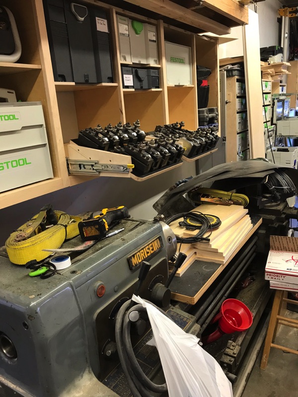

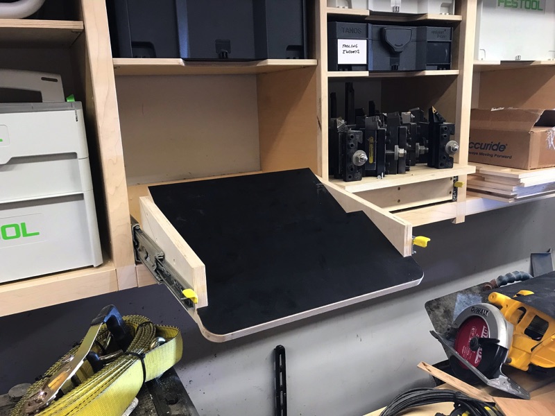

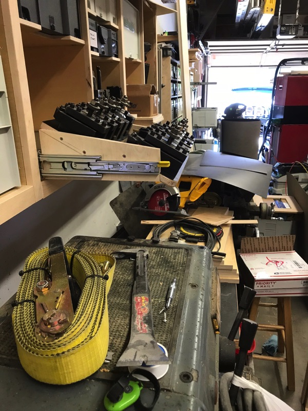

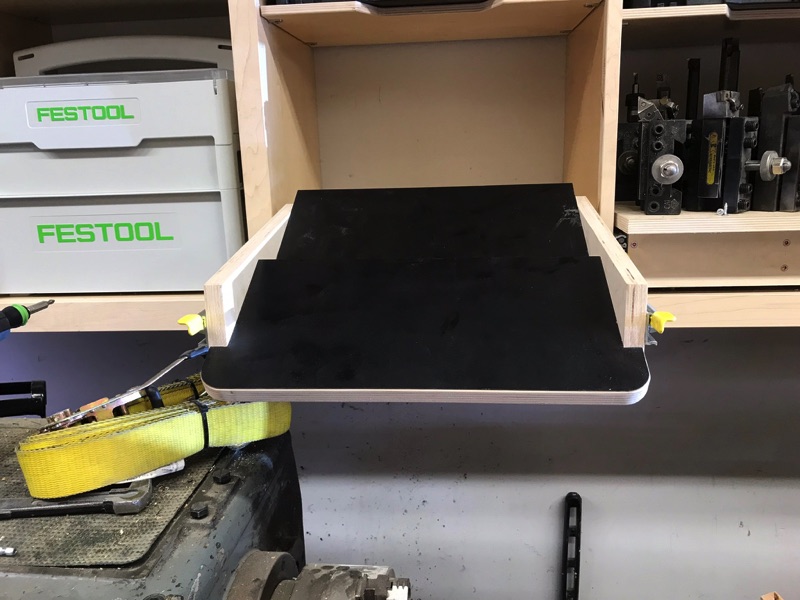

Get it mounted on the slides in the cabinet.
Locked in and loaded.
Now all 10 tools are easily accessible and visible. the 5 most commonly used tools are in the front and easily accessible when the drawer is closed. When it's open, I can access all 10 without moving one. Here's the drawer fully extended and locked. The tools sit perfectly over the chuck and slightly ahead of the tool post. For the most part, the tool comes off the rack and nearly straight down to the tool post.

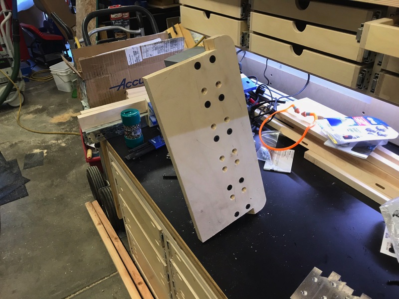

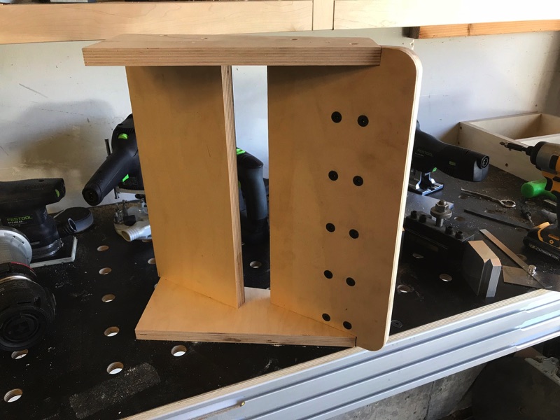

On to drawer #2. This one I wanted to make a little more universal. This drawer will have all of my boring tools, parting tools, etc. Since some of these tools are duplicated, I want the drawer to be easily changeable in the future for when I buy new tools so I needed to be a little more generic than I was with the last one with hole placement. Can't assume they're all right hand tools either. front shelf gets drilled for both left and right tooling. The hole spacing worked out perfectly. I can mix and match whichever I want as long as they're the same sized tool holders.
For now, three lefts and two rights are what I need.
Back received even more holes with the ability to move the holders forward or backwards as well. I had a few boring bars that were longer than the others so extra space may also be necessary in the future. Installed the holders and got it loaded up.
This new design ended up creating enough room above the drawers to add more shelves for more stuff which is awesome.
Now I gotta figure out how to store the lathe chuck keys, calipers, files, etc as well as how to store all of the tailstock tooling. I have some ideas...

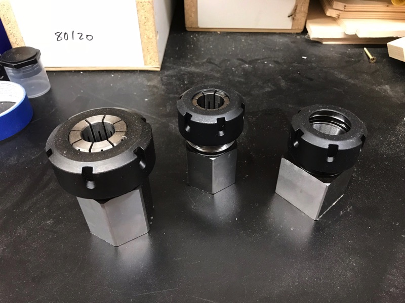

Other than the fancy quick-change collets, there's 3 kinds:
Spring Collet - as the drawbar pulls the collet into the spindle, the taper of the spindle closes the spring around the tool. These hold the tools very securely and the tool rarely moves. Downside to them is that the collet no longer hangs onto the tool when it's removed from the spindle (during a tool change). If you're intent is to run a few parts that require multiple tool changes, you'll have to come up with a way to re-set the offset of the tool in the collet. It's very difficult to get it back exactly where it was and, as you'll find out, nearly impossible to even get it close. Another downside is clamping range. The design of the collets allow a very limited clamping range on a single collet. This means that you'd need to have a substantial set in order to be able to hold every size tool. Even the set that increments by 1/32nd won't hold every drill bit I have in my box.
Tool Holders - this is a holder that has a hole machined to to hold tools of very specific sizes. A 3/8 holder can only hold a 3/8 tool. One or more set screws are used to put side load on the drill and lock it in place. Some tools have flats machined on their shank specifically for the tool holder set screws. The problem is when the tool doesn't. The hardness of the tool may prevent the set screw from being able to retain it well and the tool can move in the holder. Up-side, wen compared to the spring collet, is that you can change the tool without worrying about the tool moving in the holder.
ER-Collets - Benefit of the Spring Collet for clamping force and the repeatability of the Tool Holder when pulling it in an out of the machine. Given how the springs are machined, there's a much broader usage range for a single collet than the Spring Collets have. With a "complete set" of metric and SAE, I've never encountered a tool I cannot run.
In my experience -
I have a set of spring collets and don't use them much. They're great if clearance is an issue or the intent is to run a single op where tool location won't need to be repeated ever again. I mean ever. If I think I might need to change tools during an op, I don't use a spring collet.
I will only use tool holders to hold measuring tools (dial indicators or offset gauges that load into the spindle) or tools that have the flats machined on them. I've been burned so many times by a tool moving just a bit in a holder that I don't even try anymore. In fact, I'd probably sell all of mine if I were given the chance.
I use ER Collets for everything that doesn't have a flat machined into it especially drill bits. I also only use ER collets on metric tools. Buying a set of metric collets was the easiest way to add the capability without a crazy investment.

Was creeping around eBay and found this - a ER collet that slips inside a spring collet. Guess spring collets can now allow repeatable offsets if these bottom on the face

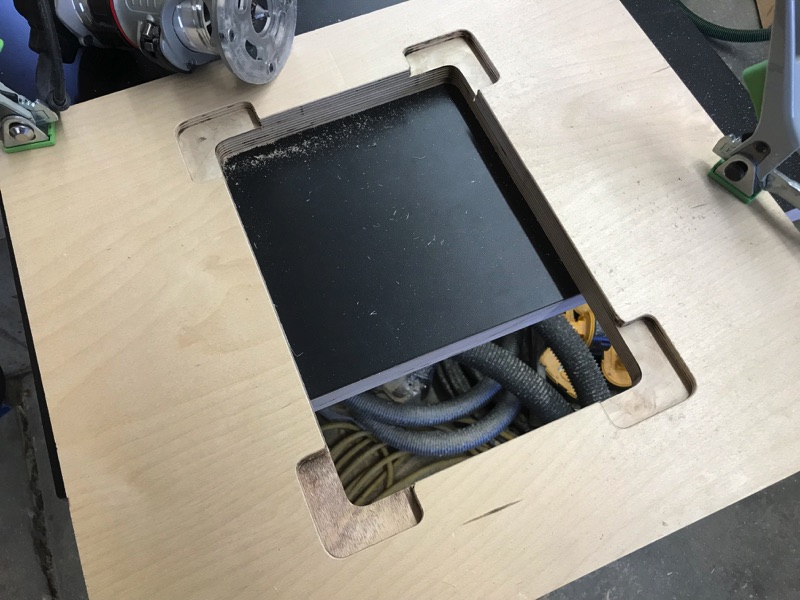

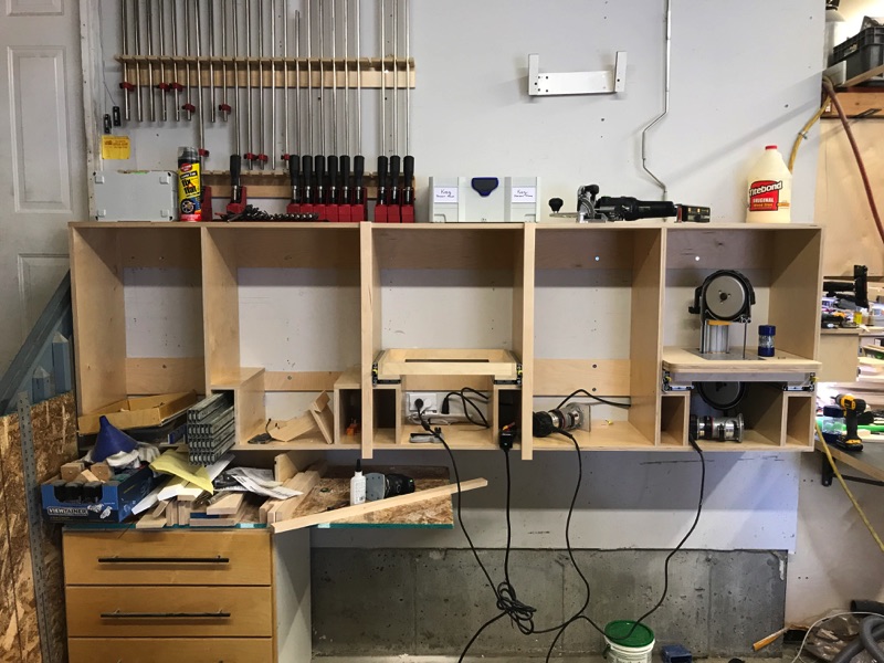

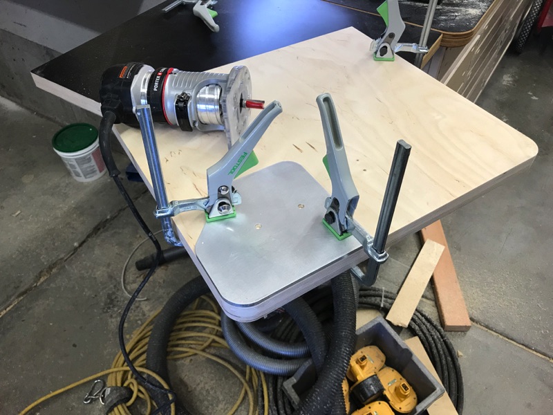

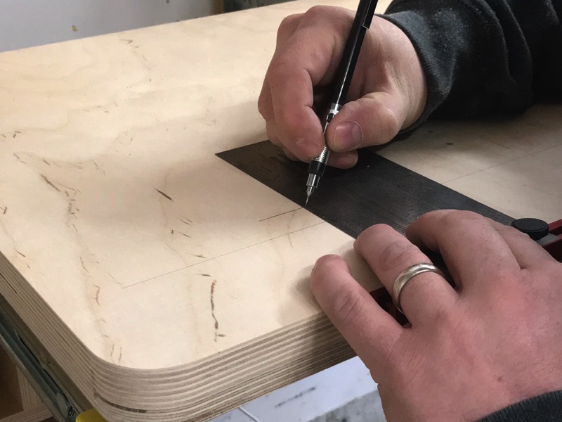

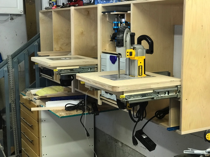

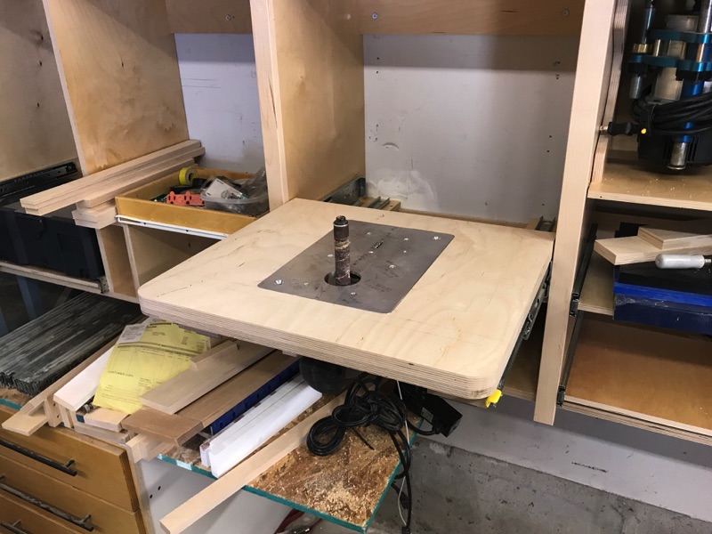

Picking up where I left off - Router Buddies Mk2 - I had gotten the cabinet assemblies hung on the wall, re-assembled the prototype (aka #1) and got the slides and frame built for #2 before I ran out of parts and couldn't go any further. I needed 2 more sets of the Kreg router plate levelers, another pair of locking drawer slides for #3, and 2 more switches. This week everything was delivered but one of the switches and the locking slides which I found out on Friday were backordered (*****).

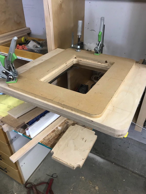

I had glued up two more tops last night in prep for today so all I needed to do was square them up, cut them to size, and machine the radii into the fronts.

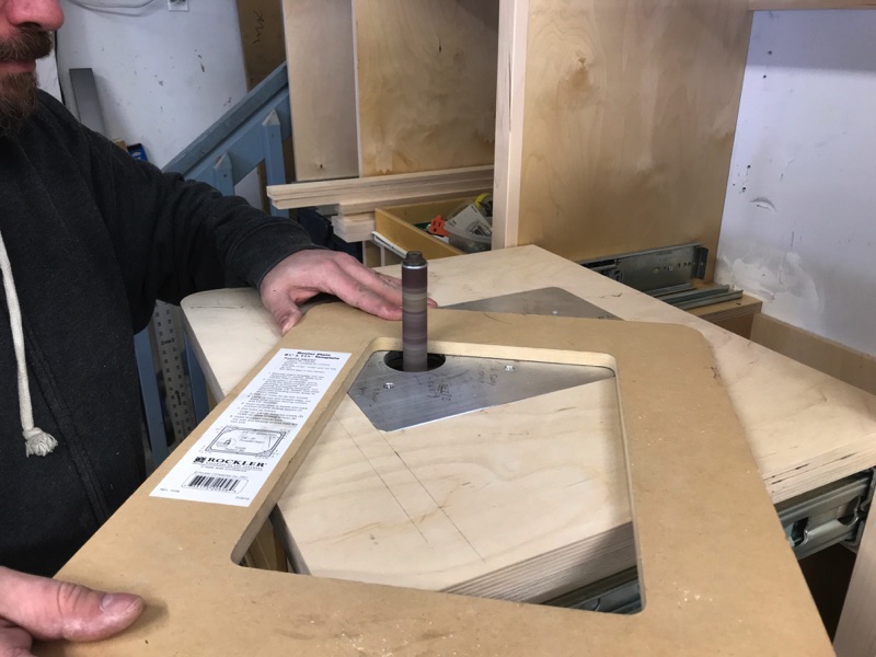

I then mock up the top to figure out where I need to place the template for the router plates. Since I want all three to be the same, I use the first as a pattern and mark it the same on the second and third. I through-drill the corners with forstner bits so that the router has an easy place to plunge and it's less effort to change directions in the corners.
With the template in place, I make 2 passes with the router to prevent the surface from chipping and splintering when rough cutting the profile with the jigsaw.
Now a finish pass is all that's left to leave clean cut.

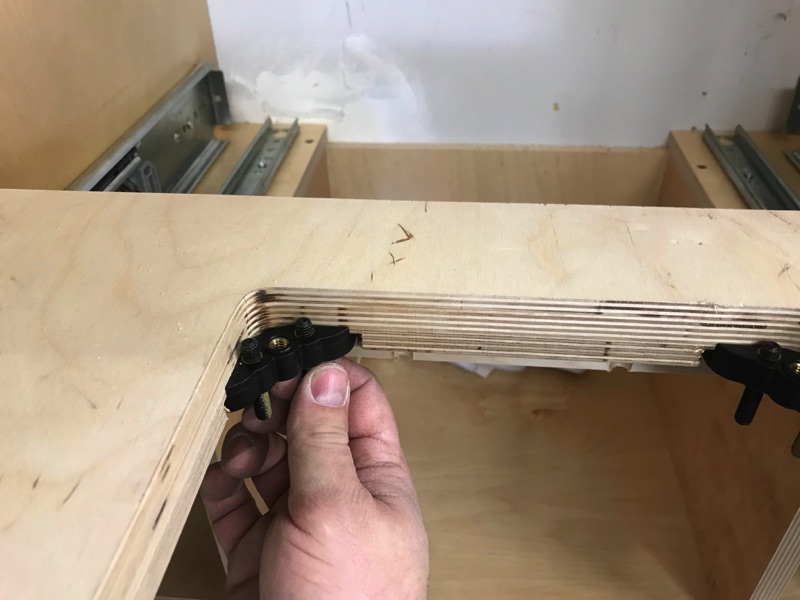

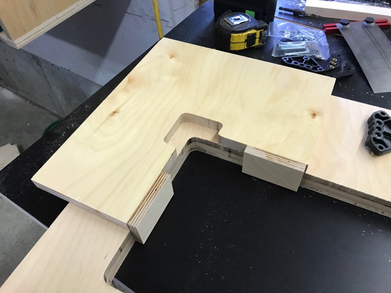

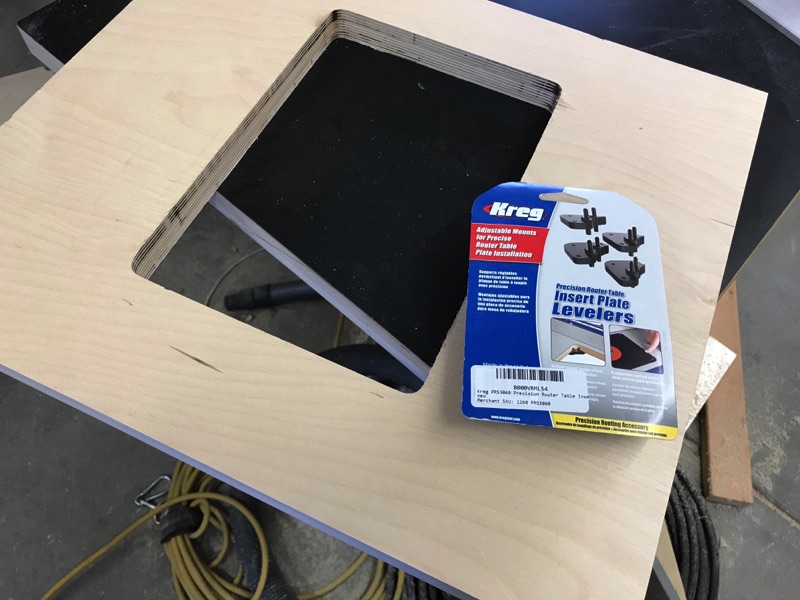

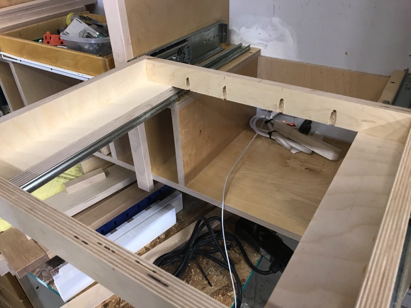

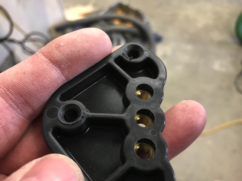

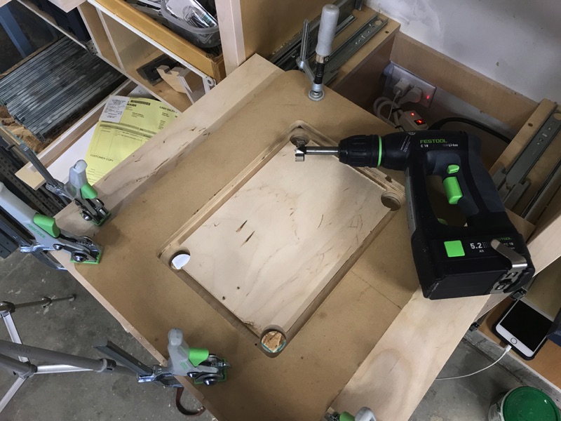

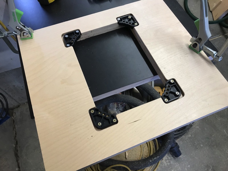

Now for the Kreg router plate levelers. Normally these are really easy to install. you just push them up from the bottom in each of the corners and screw them in place.
I can't in this case though. Because of the close quarters inside the cabinet, the cut-out is nearly the same time by the light weight frame I made to support the top which will force me to recess the leveling feet. To accomplish this I cut out a pattern of the feet and glued some guides so that I could easily locate in each of the corners.
A few passes with the router and the corners are prepped.
I was a little too perfect with the depth so I actually had to countersink the leveling feet so that the screws would sit flush.
Installed and ready to be attached to the frame.
The top will be attached by pocket screws through the frame.
With the levelers in place, a little pre-adjustment (guessing) makes final adjustments go a little faster.
After some tweaking, the plate sits in the hole nice and level. Took longer than it should have to get #2 to this point even though I already had the measurements and plan.

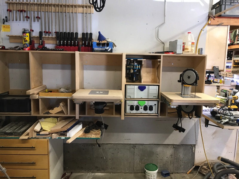

After getting the table assembled, I spent a little time getting the router plate module and systainers in place between the tables and swapped the tools out a few times to get an idea of how easy it will be. Now it's a breeze. Not sure if I'll feel the same way when I add dust collection. Last step was running the wires to the two switches so the tables are operational.
This picture gives a little perspective at how the stations will work. With both of them out at the same time, I have much more access to the full tables than I did with the old router buddies.

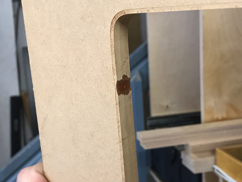

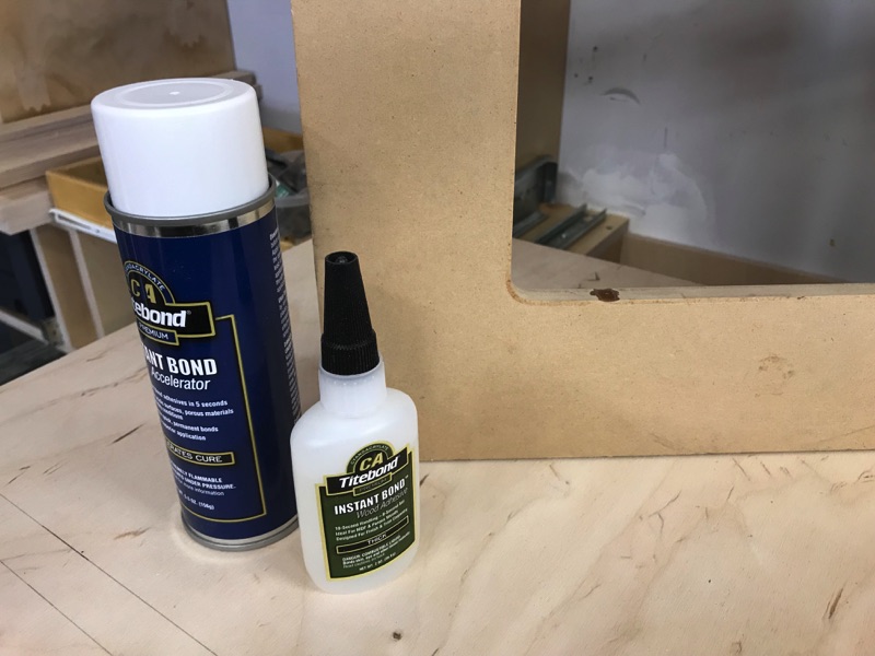

It didn't take me long to come up with a project to try them out on. During routing the plate opening in the second top I inadvertently nicked the side of the template with the router after my last cut. I've learned to fix these mistakes with CA glue.
You can apply a few drops in the cut out and the glue soaks in and then builds up to the point where you can smooth it out again.
then a little touchup and it's good as (or better than) new.
Table works extremely well. Plywood surface doesn't work very well but once this top is lamented, it'll be the sizzle. Now back to waiting on parts...

Is this template plate one you made or purchased?
I purchased it from Rockler maybe a dozen years ago. You can get them on amazon for most major brands of router plates for $15-$25. Make sure you check the dimensions of your plate before ordering one, not all have the same dimensions. Depending on the brand, they’re slightly different -
Rockler/Bench Dog - 8 1/4 x 11 3/4
Kreg/JessEm/Woodpeckers - 9 1/4 x 11 3/4
MCLS/Rousseau - 9” x 12”
You could make a really nice template yourself using scrap from around the shop. The only real trick is to get a router bit with a diameter 2x the radius of your router plates corners. Mine are 1/2 so I’d need a 1-inch bit.
If you have the bit or choose the make vs buy route, here’s a vid showing how to do it. Note - I don’t use double sided table like the guy in the video, I use clamps. I don’t trust tape).

I was referring to the corner radius template you're using in that particular photo. Sorry for the confusion.
