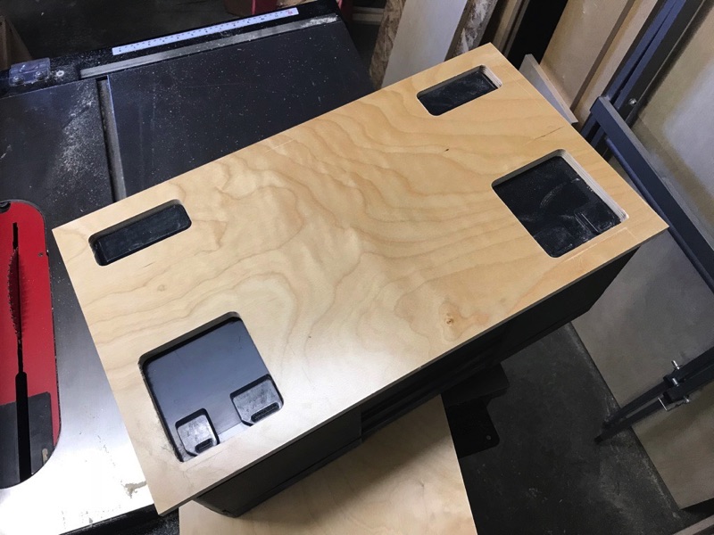

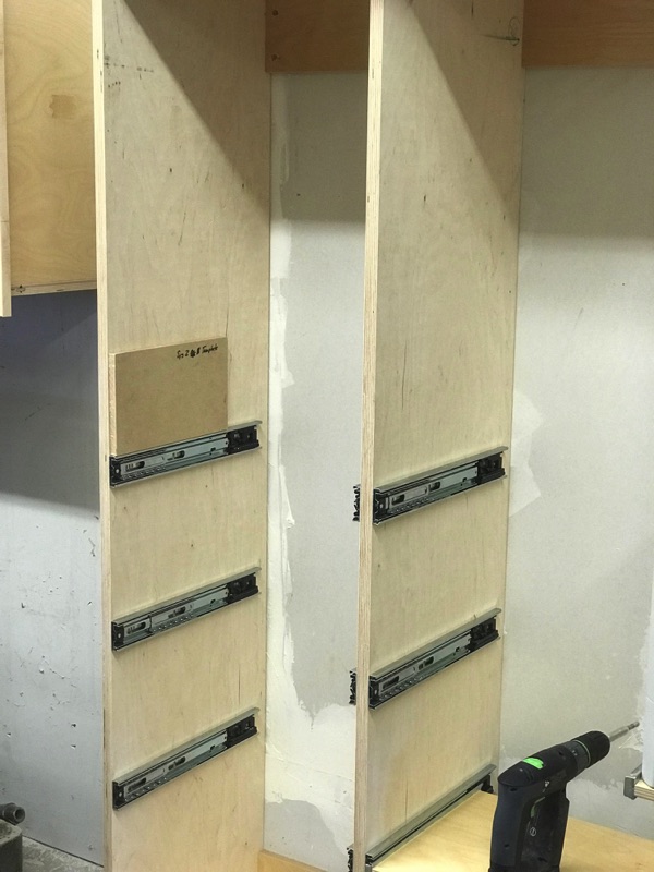

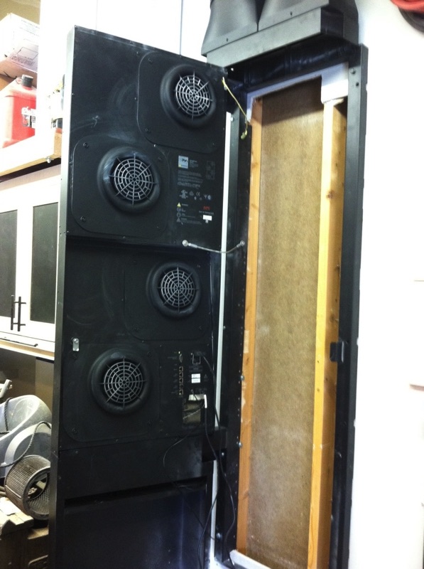

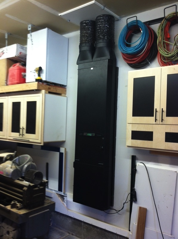

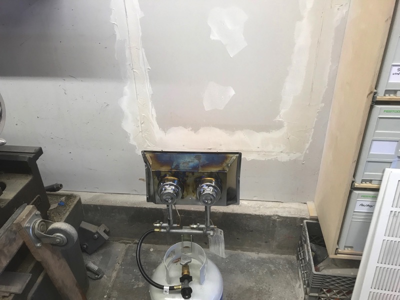

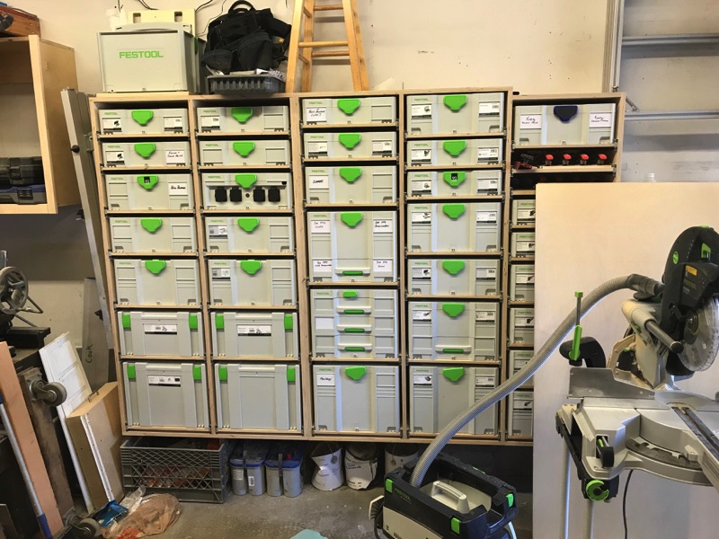

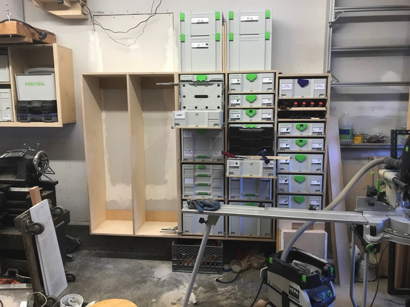

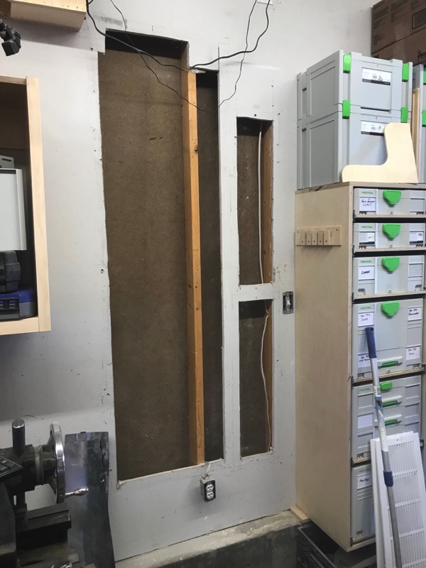

Now I can add the second half of the weekend's progress. I also expanded my Sys-Port so I could move my vacuum clamps off of the shelf and into sliding drawer assemblies.
In December of 2012 I “happened across” an opportunity to remove an APC from where I worked to save the company from having to pay for a company to remove it. For me it was a good deal because the unit worked just like it was new. My idea was to attach it to the wall in the shop and use it to evacuate the shop. I used the wall cavities as the duct work and added vents all around it so it could pull air from the room. Neat way to remove fumes, dust particles…you name it. The thing flowed 2200 CFM and moved some air. I’m sure I had it in my Tooling Organization thread.
Even looked cool.
The reason I’m pulling these old crappy pics back to the top is because I’m bringing you full circle…the end of the idea. I never did put the custom ducts in the attic to vent the exhaust air out through the soffit. Even if I had, I hadn’t solved the intake issue either. When you move that much air out of the shop you have to figure out how to get air in the shop otherwise it creates a low pressure condition (puts pressure on the garage door and makes it interesting opening the door from the house, etc. Usually I’d crack the garage BUT, when it was summer, I’d pull hot air into the garage off of the driveway which actually had a heating effect. In the winter…cold. I’m thinking ahead here. If I sell the house, it would have to go…so it goes now and I’ll use the space for better things and save all of the work I never did.

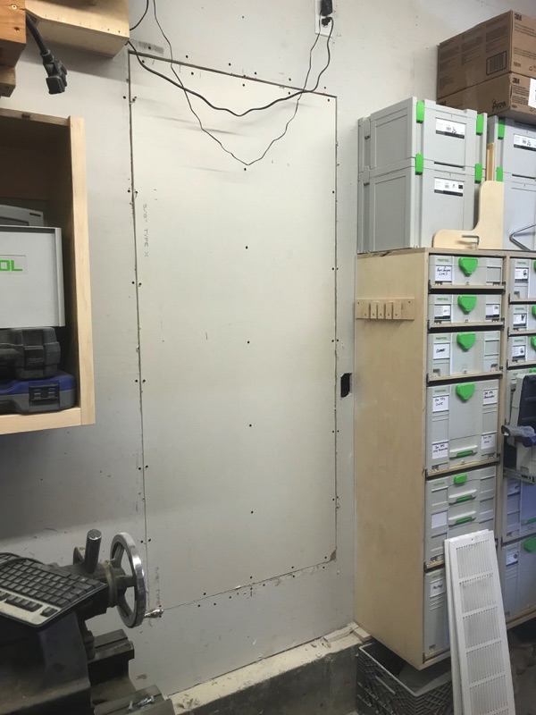

Of course I didn’t have enough drywall to fill the hole so I had to run to the store and buy a sheet.
I had little to no patience today so I got out the propane heater to flash cure the mud. I was chuckling nearly the entire time the heater was running.
And I’ll extend the sys-ports over the patch. I’ll have to finish the patch above them later when it’s a little warmer b/c I ran out of propane.
Since I kept all of my spacers, I can quickly add the slides for the inserts.
And the sustainers have a home.
On all of the drawer bottoms in the Sys-Port I cut in the feet so the sustainers can’t slide off when opening or closing them since the drawer are essentially flat pieces of plywood. Since I have a template, it's really easy to make more. The whole intent of this expansion was to create space for the systainers that house the Sys Vac (the bottom 4 in the above pic). But these systainers are the classic version which have much different feet than the t-loc style (all of my other systainers). In order for these to stay on the trays/shelves, I needed to create a template so I could cut in this new foot pattern.
Using a router with a pattern bit I have the 4 I need fairly quickly..
No more fan, no more hole, way more storage. Now all of my wood working tools are easily accessible and yet completely out of the way when needing to use the garage.

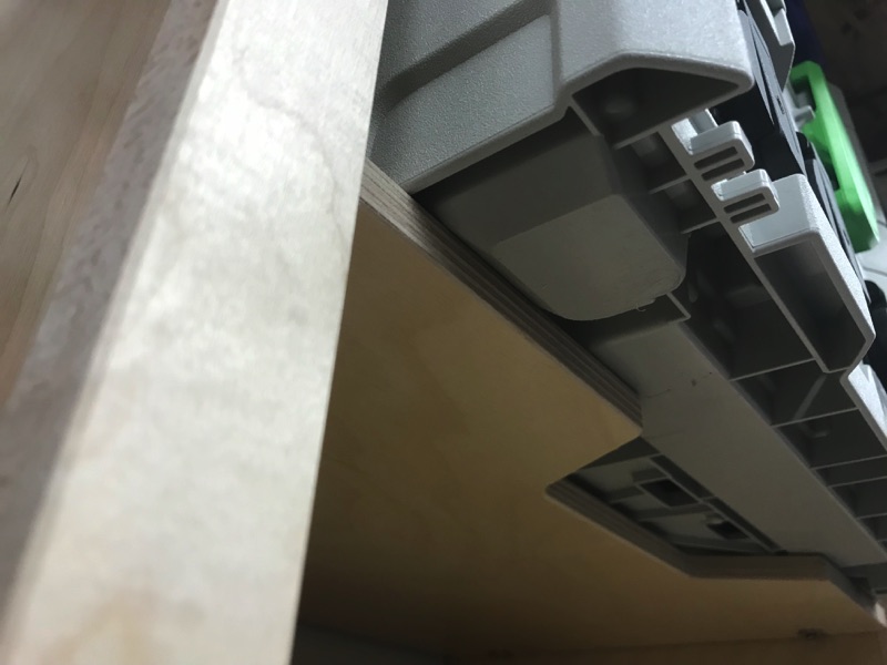

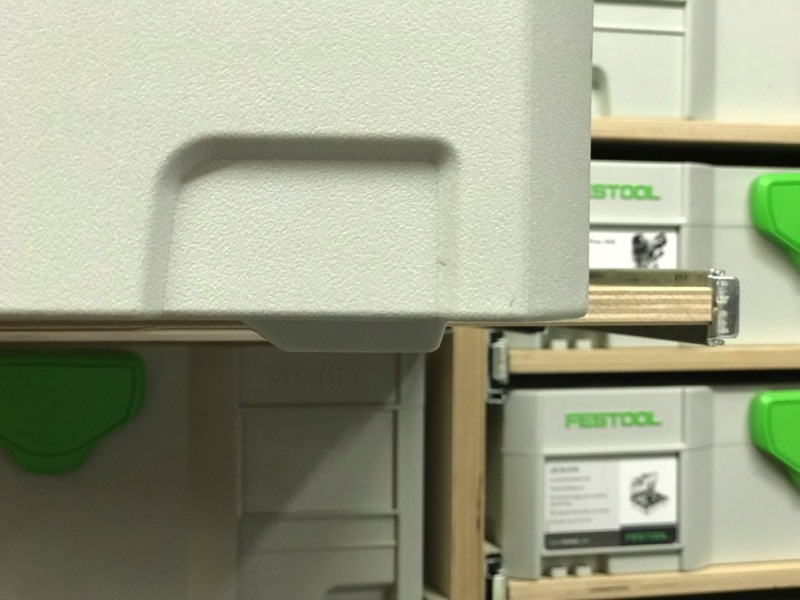

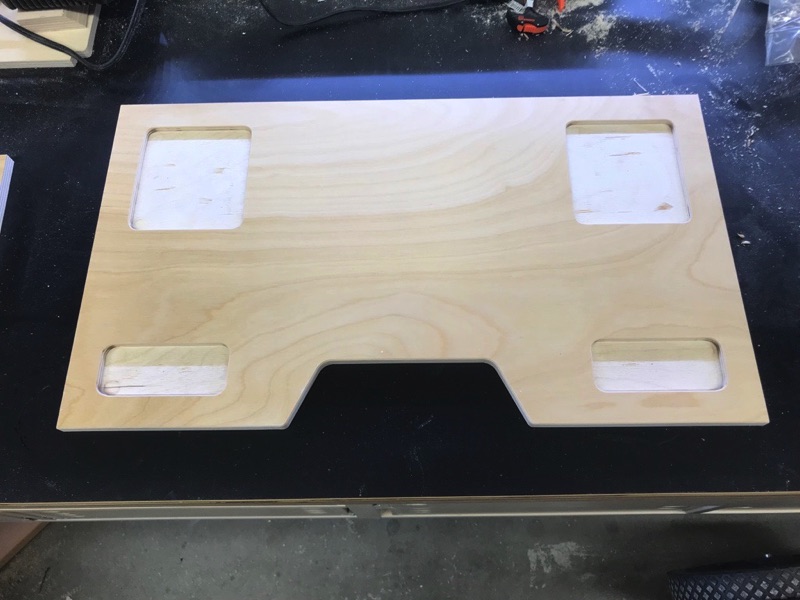

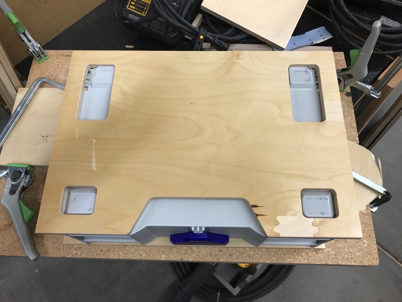

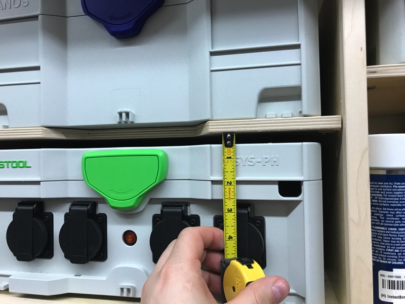

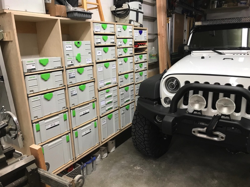

Shelving Solution
It was late march when I first put together the first upper cabinets for the new build. At that time I cut the systainer foot pattern into a shelf so it would help keep them looking organized (they'd auto-locate in the exact same spot on every shelf) and so they'd not be un-intentionally leave the shelf since the shelving has no lip. One of the replies was by rviecili who accurately summed up my initial thoughts -
rvieceli said:
...having to lift that systainer out of the dimples rather than just slide it off a smooth shelf would make me crazy after a few times.
As luck would have it, I'v only had to remove systainers from the shelves (which had the cut in feet pattern) maybe a half dozen times since then. Each of the times I swore it was a dumb *** idea and each of the times I was reminded I needed to spend some time thinking about how to solve for it. Since I'll be needing to make dozens of shelves in the up coming few weeks, I figured the timing was right to work through my little issue.

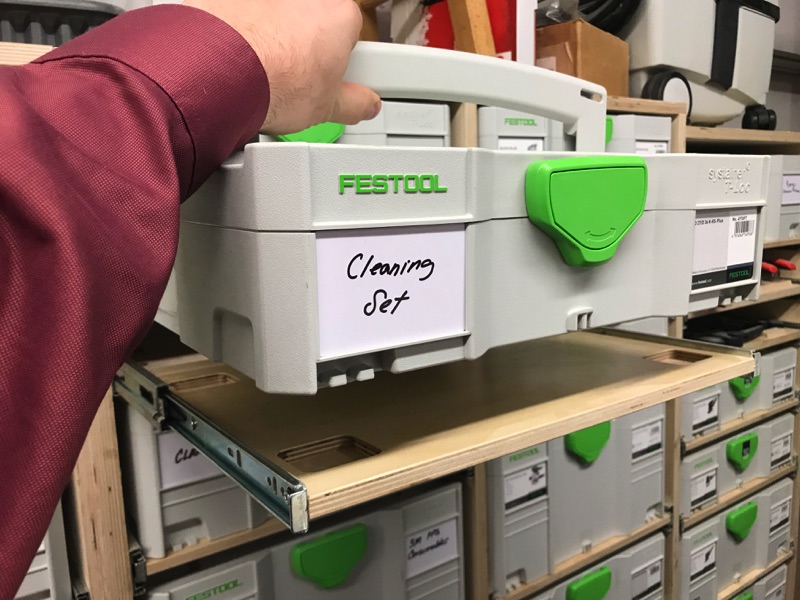

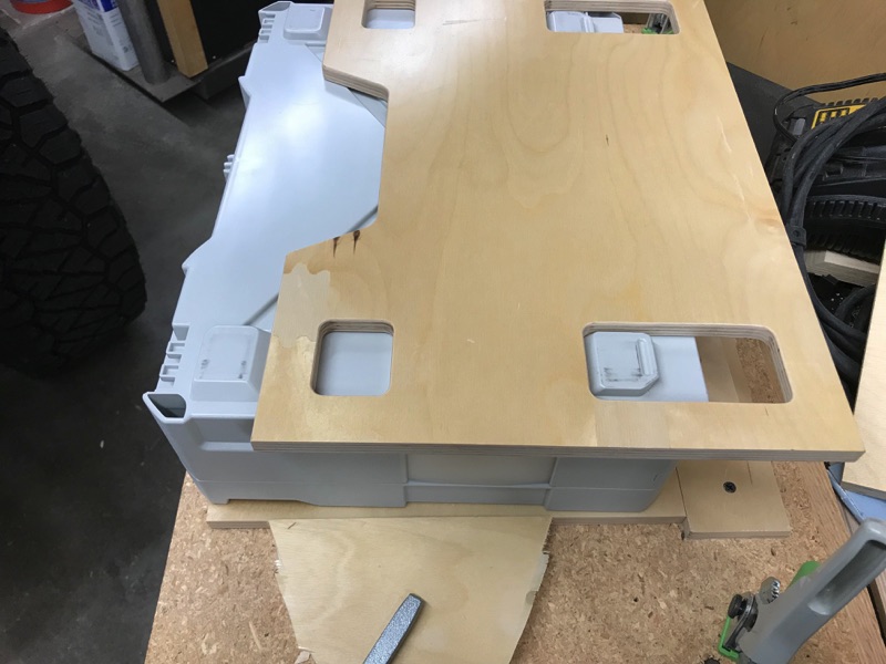

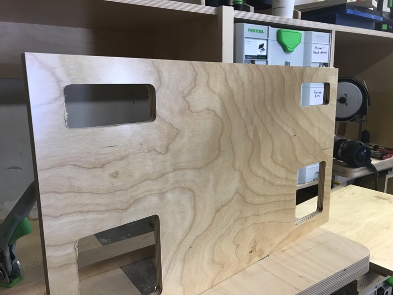

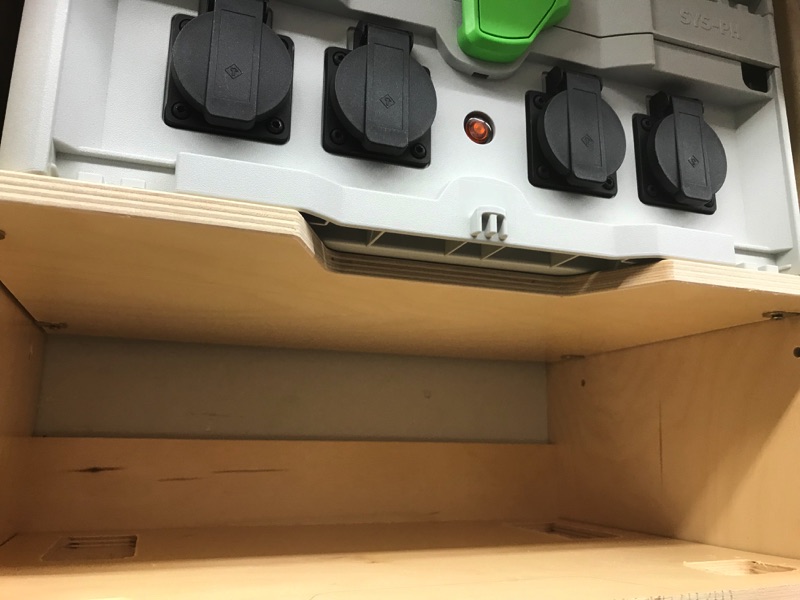

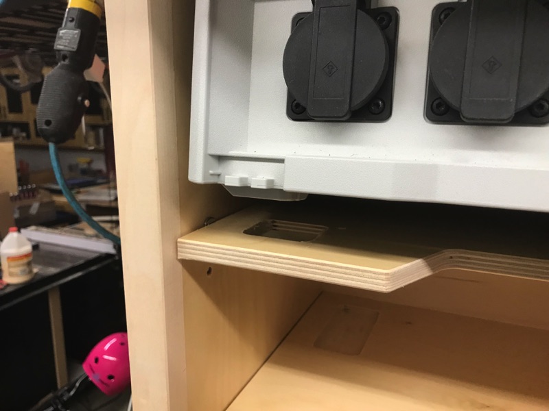

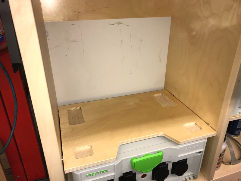

Here's the starting point - When removing a systainer from a shelf with the footprint cut in it’s easy enough to lift up the front feet however getting the rear feet to lift up in the same motion was difficult unless your lifting movement was nearly straight up. Since the tool box is on a shelf and above my head, lifting up is actually kind of difficult. In review, the previous template that I used for the feet locations looks like this -
After spending some time thinking about it, this design that has been used over and over again by I don’t know how many people, is very poor for this use case. The design is most frequently used to keep the systainer on a shelf of a moving vehicle - either an automobile or a movable work station. They work very well when they’re combined with drawer slides where you’re able to pull out the systainer
And use the handle to lift directly up.

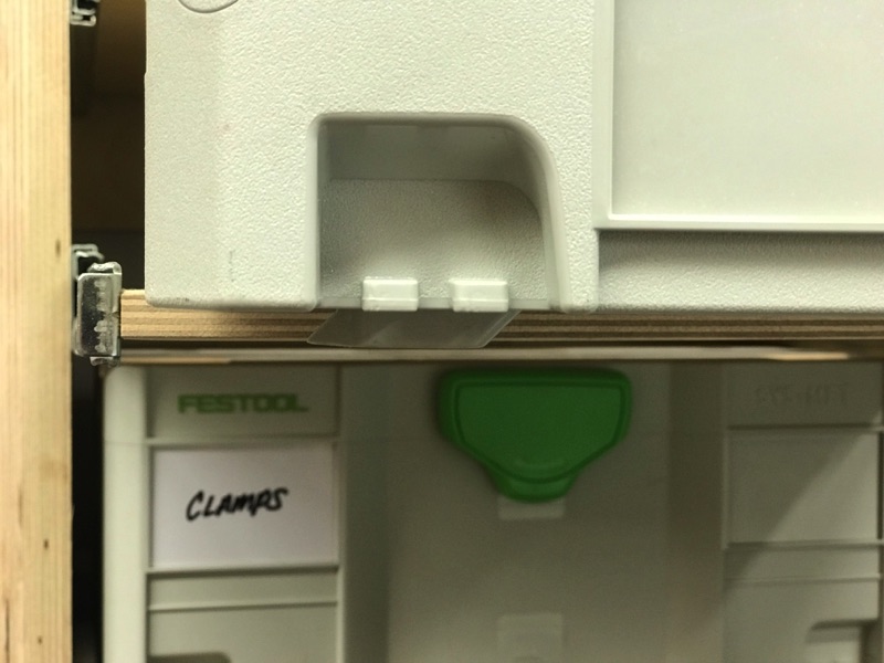

Here’s how the feet are designed on a systainer. To set context, the right of the photos are the front of the systainer so, in removing it from the shelf, I will always be pulling int to the right in the picture. This is the front foot. The edge that is to the front of the systainer (to the right) is nearly square.
Here’s the rear foot. The leading edge is angled forward at about a 45* angle (didn’t measure, just guessing). That leading edge should allow it to free itself from the rear pocket if the front of the systainer is tilted up.
Contained within the shelf, the systainer has a limited amount of up-travel. What’s more difficult is that I have to lift using part of the systainer like the t-loc/knob which isn’t really easy and certainly not efficient.
I can easily solve that by machining out the bottom of the shelf in such a way that I can get my hand under the systainer. A quick program on the mill and cut a profile that allows me to get my hand under the systainer.
With access now to the bottom, I can lift it up more easily and get a better grip on it.
So back to the limited up-travel. In my design just under 1/2-inchs worth.
I tested to see how much up-travel it would take to make the rear feet lift out of the rear pockets. Now I couldn’t measure, hold up the systainer, and take the pic at the same time but i think it’s clear that it’s much more than I have height-wise between shelves. Probably at least double. Now I could begin to space the sustainers further apart but that’s not a desirable solution (wasteful actually).
Given the way that the front feet are shaped (nearly square on the leading edge), I realized that using pockets to locate the rear feet isn’t necessary. the front feet are all that are really needed. If I elongated the rear recesses into longer slots which allowed the systainer to slide forward as soon as the front feet clear their holes. The rest may just have been dumb luck. I arbitrarily picked a length and stretched the holes in a new template.
Here’s the view from the bottom showing the Systainer seated fully in/on the shelf. Front feet are locked in place and the rear feet tracking in the slots.
Now rotate it 90*.
This is where it gets really cool. The slit length I picked, when the systainer is slid forward, kinda pins the feet in such a way that they’re captured in such a posting where the weight is still mostly over the shelf. Fully loaded or empty, it won’t and can’t rock forward.
This new position now allows me to change my hand position or grab it with 2 hands if I think I need to.
In this position, the only thing that’s necessary to dislodge it from the shelf and physically remove it is to slightly tilt it forward. This causes the rear feet to lift out of the rear pocket and the entire systainer easily free’s itself from the shelf.
Looks good too.

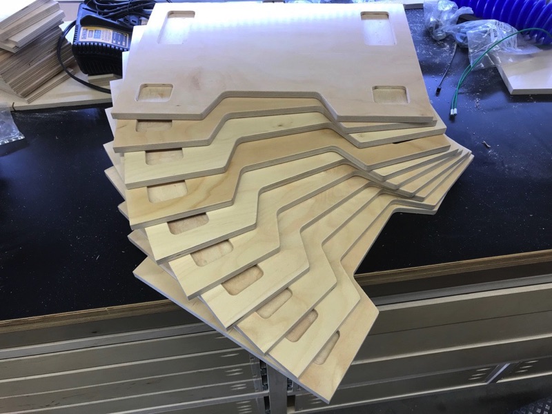

Pattern works and the concept is good enough to make some shelves today.

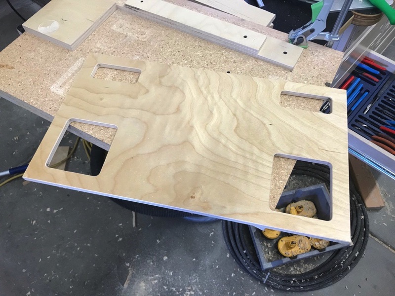

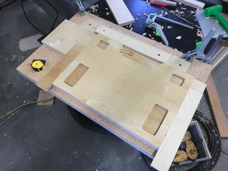

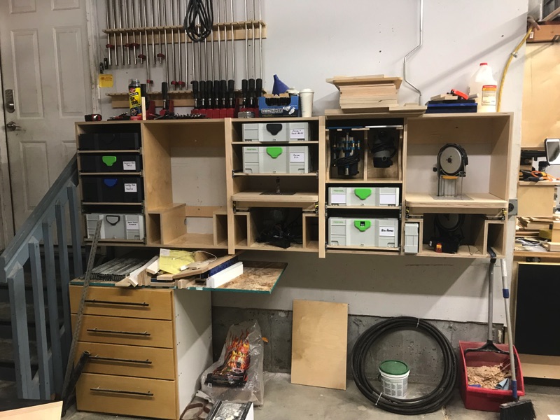

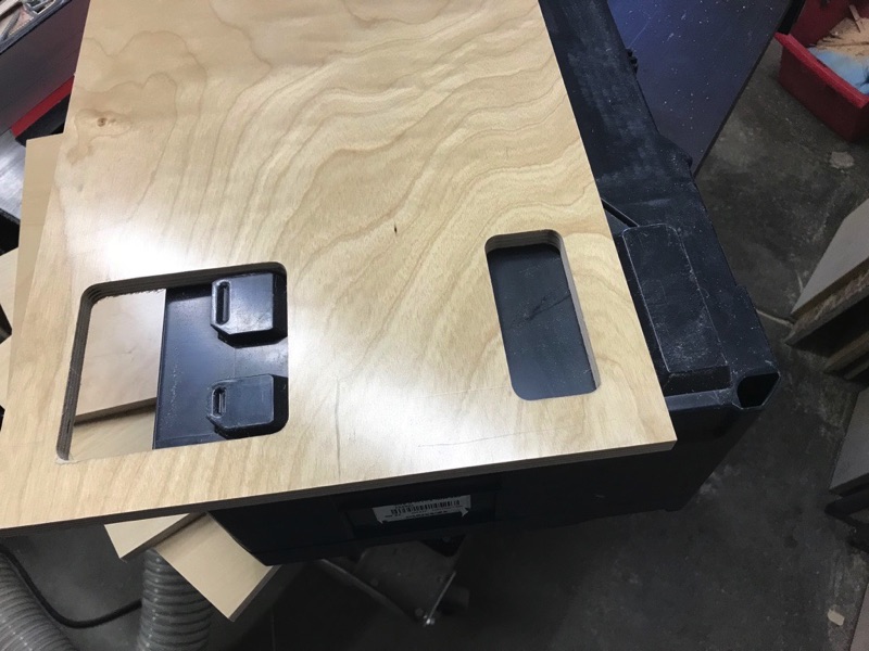

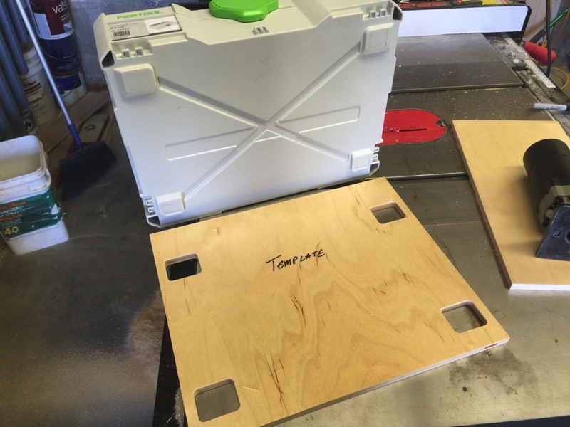

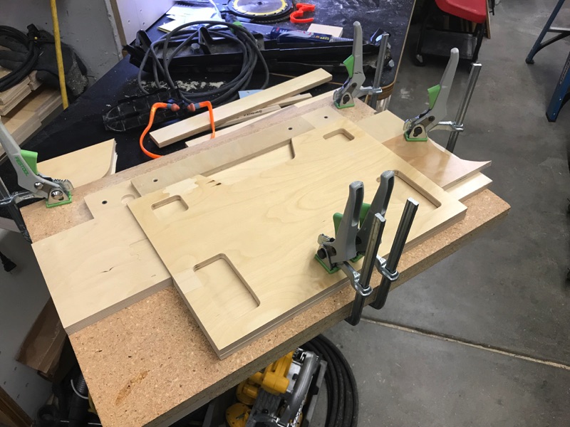

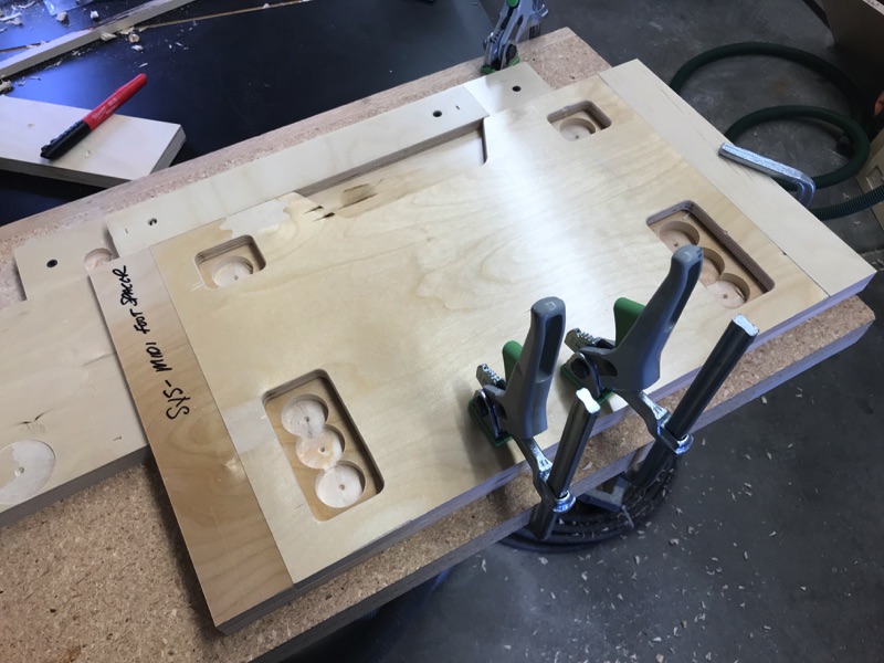

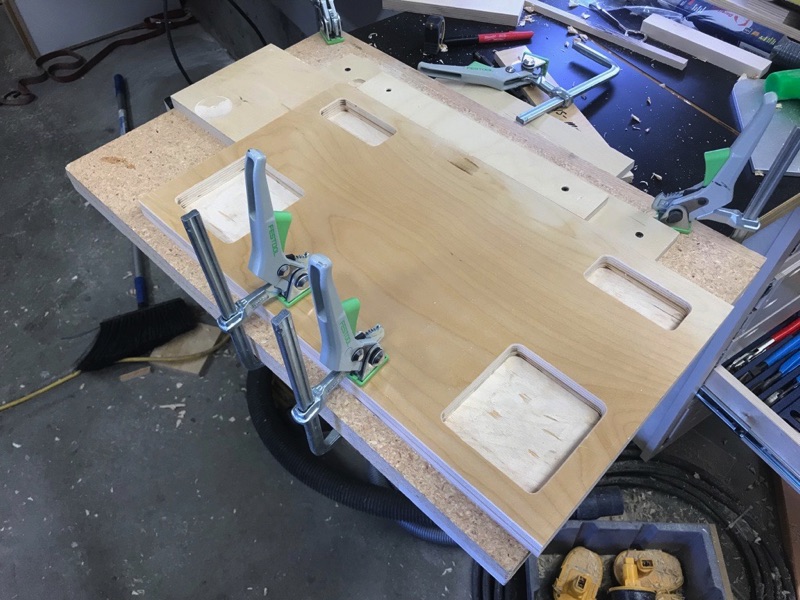

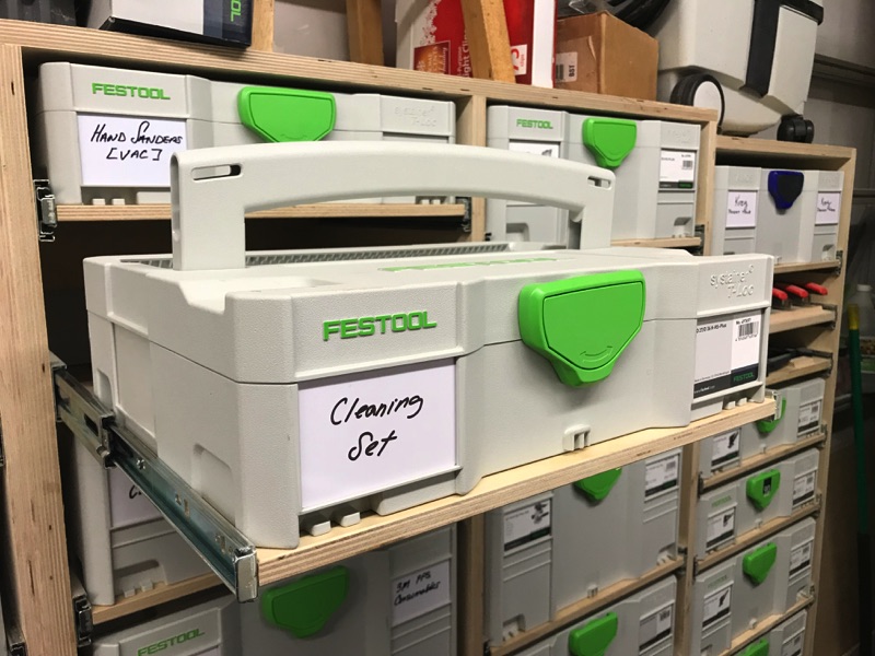

For those of you who have been following along, I've also added cabinets the correct width for the Systainer Midi's which requires a special width shelf and, they have different feet too. As luck would have it, the foot pattern is really just a modification of the smaller t-loc foot pattern.

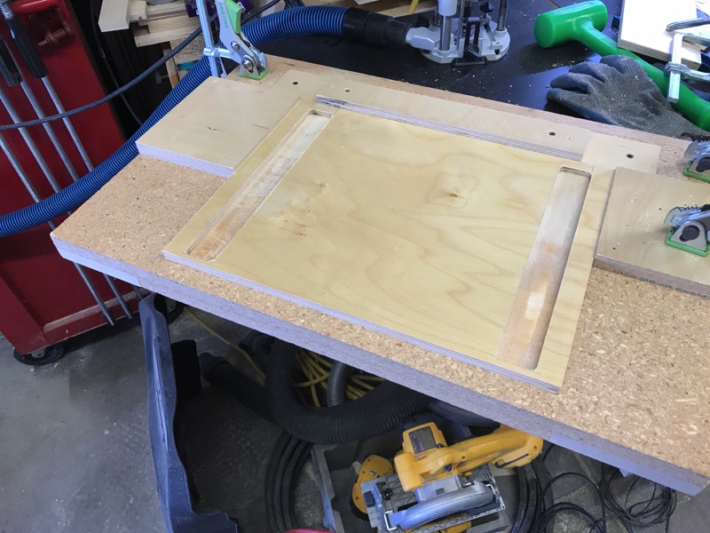

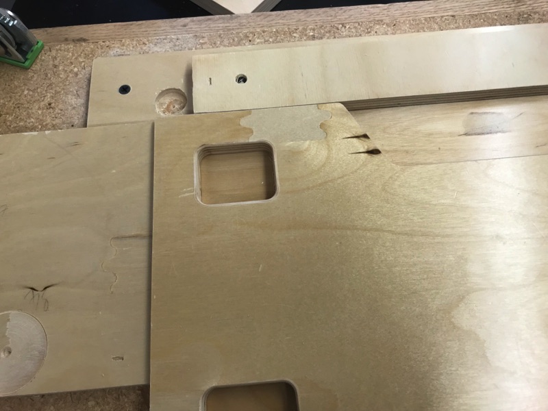

After taking a few measurements, I started by making spacers that centered the existing template (that much was identical between the two sizes. I then cut the pattern into the wider blank.
Here's where it got a little crazy. I then realized that if I slid the template over half the difference of the shelf sizes like so
And recut the profile taking a second to clean up the transition between the two cuts on the occulting spindle sander
it looked like this
I got a near perfect fit.
And the second position works just like on the standard T-Loc.
With the template ready, I can now make a few of these. Only really need half a handful.
Back in the jig over a fresh blank and trace with the router..
Vola.

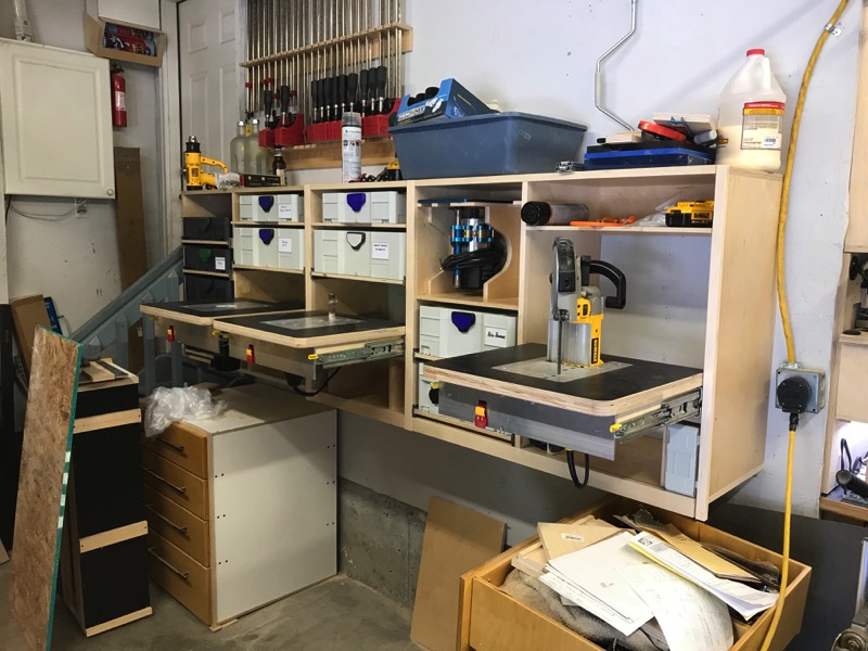

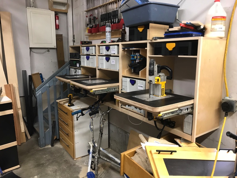

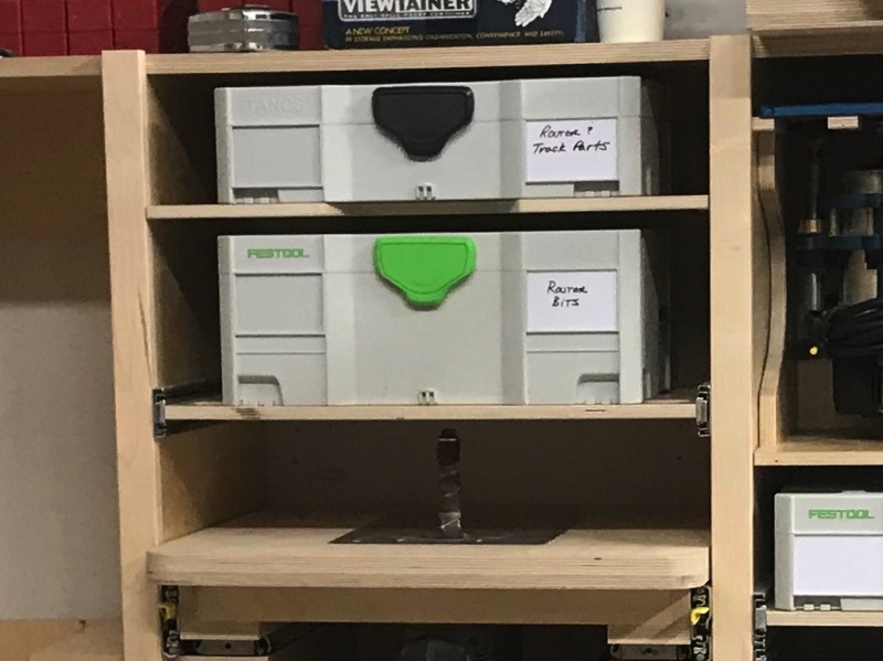

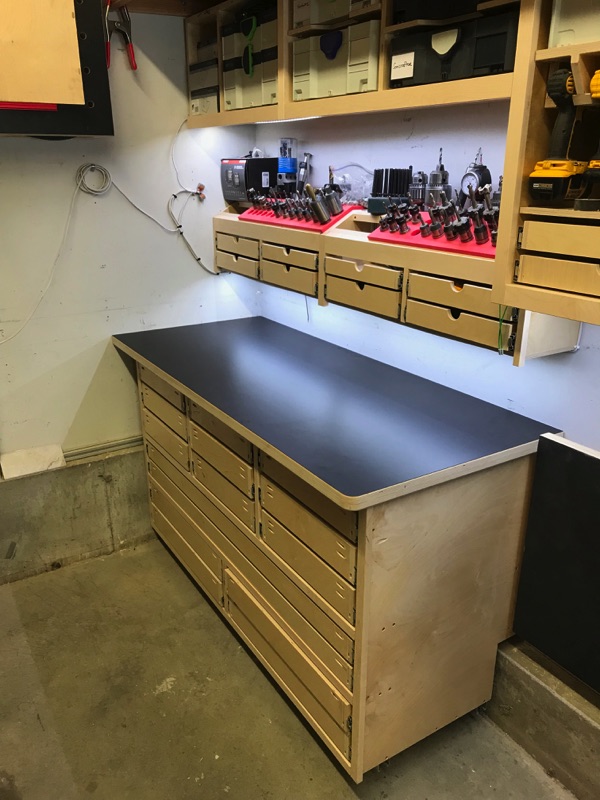

Finally received the backordered pair of drawer slides this week so I can pick up where I left off on the Sys-Port Workstation. Since I've made just a few shelves since then, I figure I'll do the easy stuff first. I start by setting the Systainer Midi shelves. Here's one that's push-release and one that's fixed with the standard sized Systainers to show perspective on the size difference.

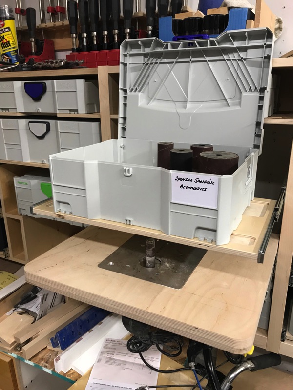

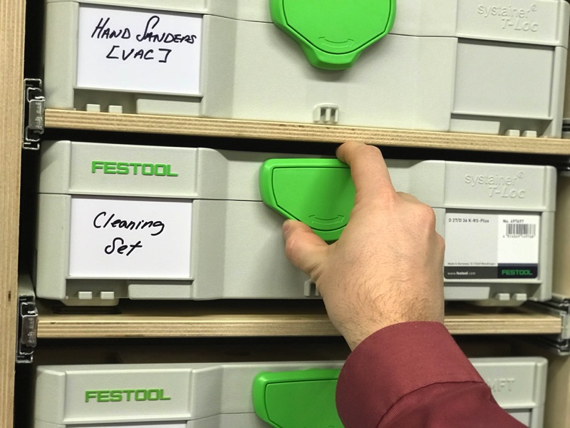

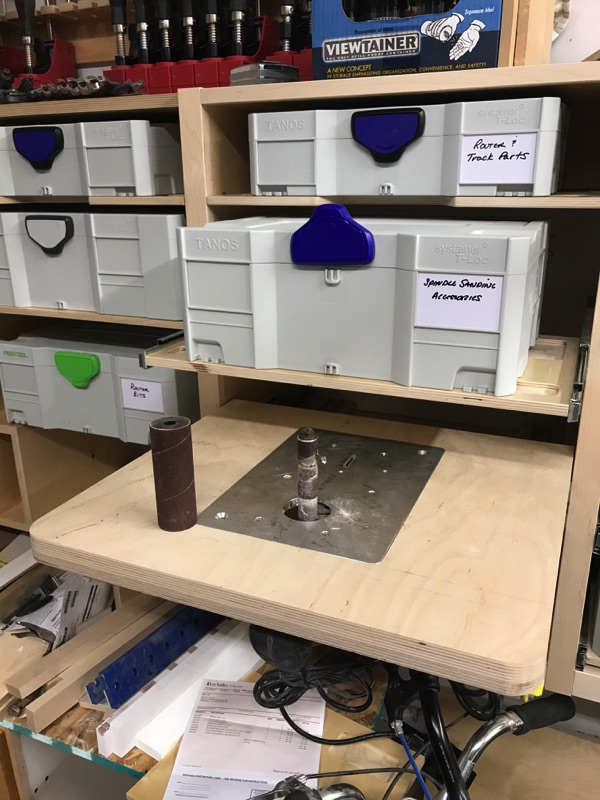

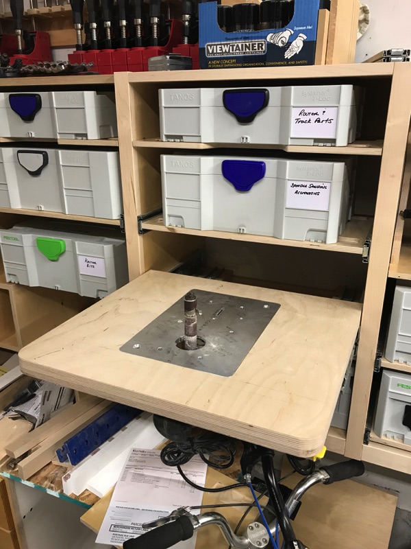

With the shelves in place, I can get a better view of it coming together and it becomes (just a little) more usable.
With the shelves in place, I can how show how the accessories can be nearly in the same place as the power tool. In the case of the spindle sander, all of the accessories can be stored right above the sander. Pretend the the sander is in use and I want to refresh the paper.
Without putting away the spindle sander, I can slide out the accessories, find the one I want, and remove it and the wrench from the systainer above without having to go anywhere.
Then, half close the systainer, swap in the accessory, and then put it all away.

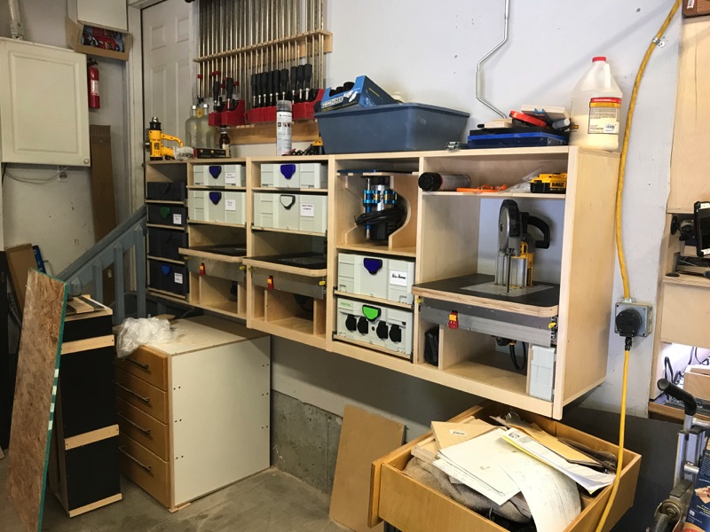

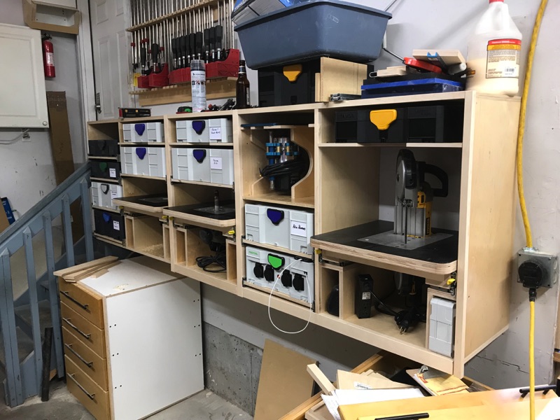

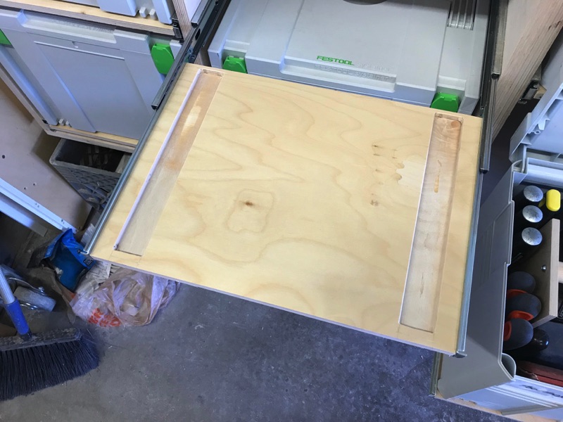

After getting all of the drawer and shelves in place, I finished the 3rd pull out and laminated all three.
The concept is nearly completed. With the tools tucked away, I now have a fully functioning Sys-Port Workstation.

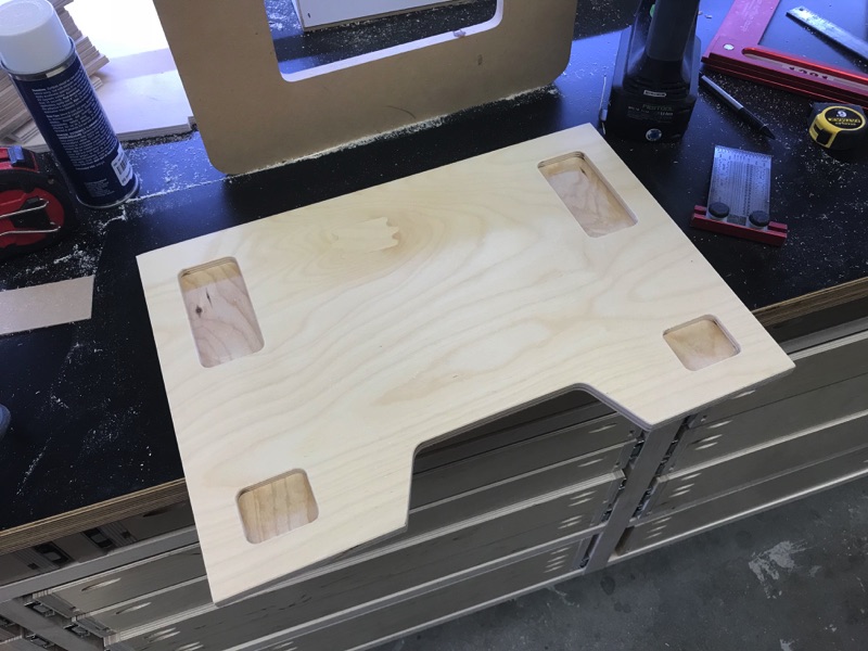

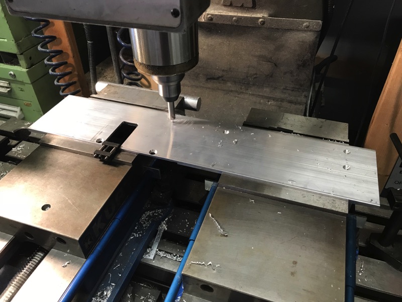

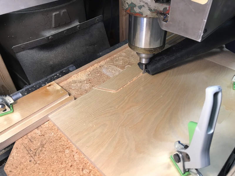

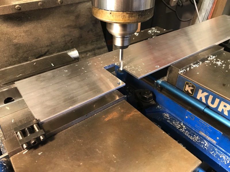

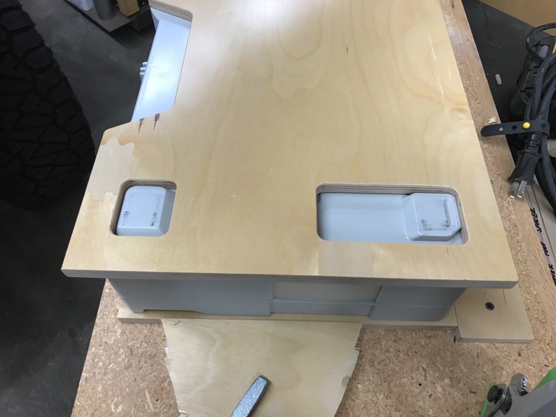

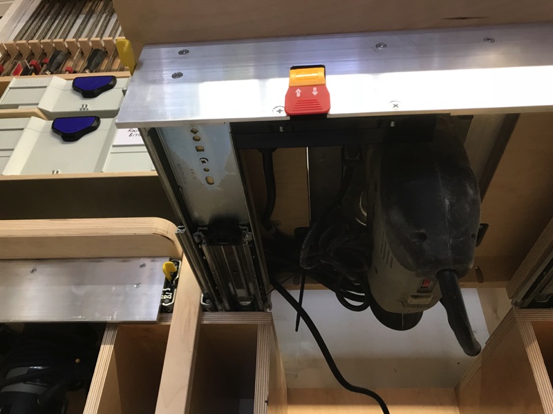

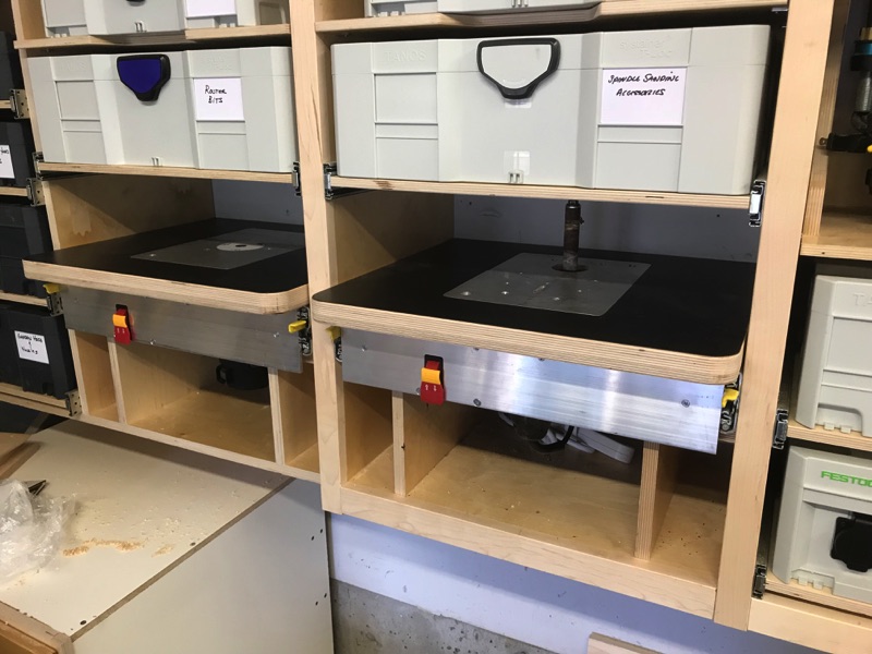

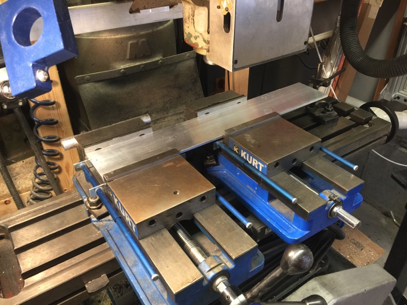

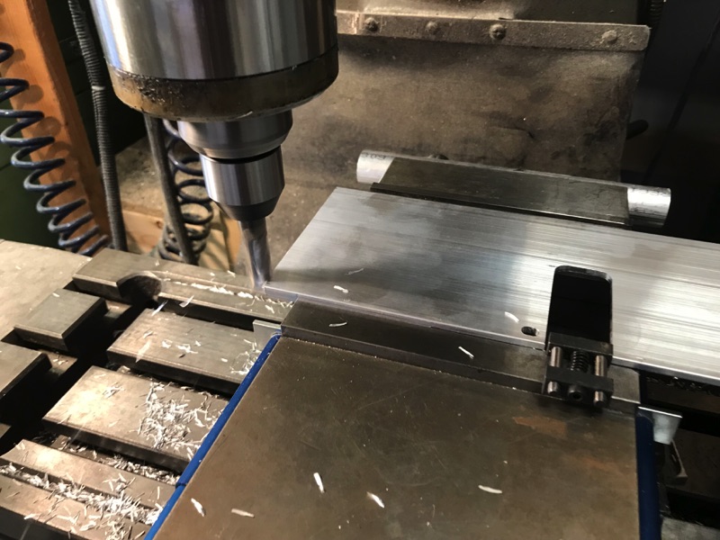

I've been using the Kreg power tool switches for my stationary router table for years so I decided to use the same one for all three of these power tools. It took me a few weeks to figure out exactly how I wanted to mount the switch and I settled on making a faceplate out of 1/4-inch 6160 for each of the slide out tables. I ordered 4. 1 to screw up as a test piece and 3 for the real deal.
I was trying to hurry so I dropped the plate in, set a stop and got to machining.
I needed to recess the switch into the plate so that the switch was easy to lift. I machined a pocket the size of the box leaving only about .100 of thickness. I figured I'd do one operation at a time so I banged out all 4 since I had it setup.
When I went to square the first end, I realized the error in my ways. By cutting the pocket and switch hole first, I realized that I had used the rough cut ends of the blanks to locate them against the stop on the far side making the pockets locate at varying locations in the blanks. Damn it, I always machine a reference edge first, I'm hurrying. After a little putzing around, I realized that I had left enough to either side of the hole to let the hole to become the new reference so I set a vise stop mid-vise so that all parts could not be aligned to it. Then I squared the left edge. Back on track.
There was no need to remove the parts for the rest of the operations so I consolidated them into a single cycle. This is the last step where i countersink the holes for the attaching screws so they sit flush.
and test fitting the first one right off the mill.
And the other 2
A little cable management to get the wires up and out of the way. Had to be creative and figure out how to make the switch wires permanent and the tool's wires temporary.
Minus a few trim boards, it's done.

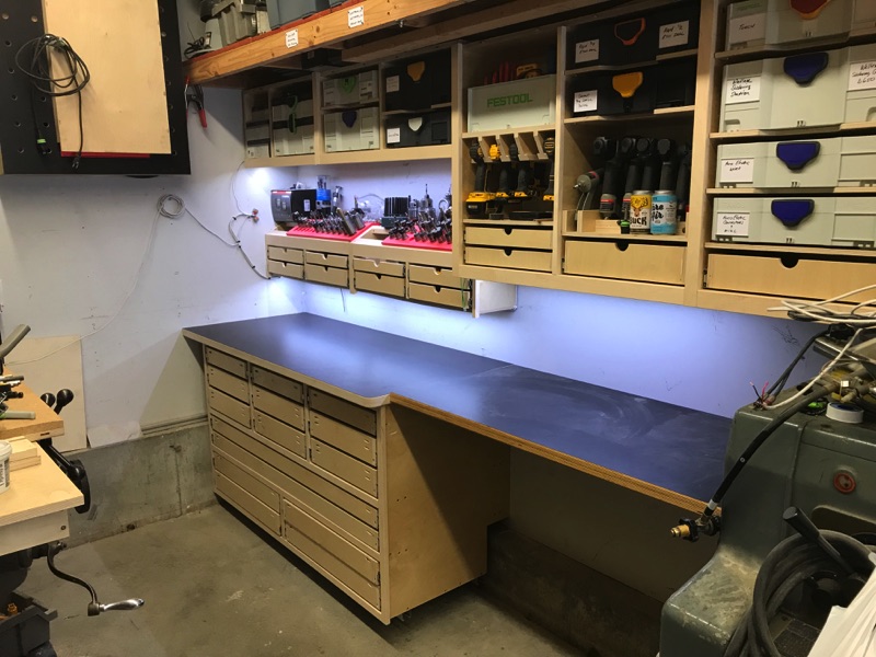

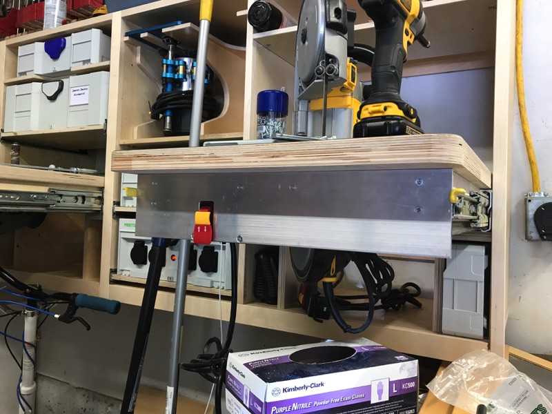

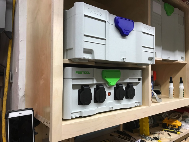

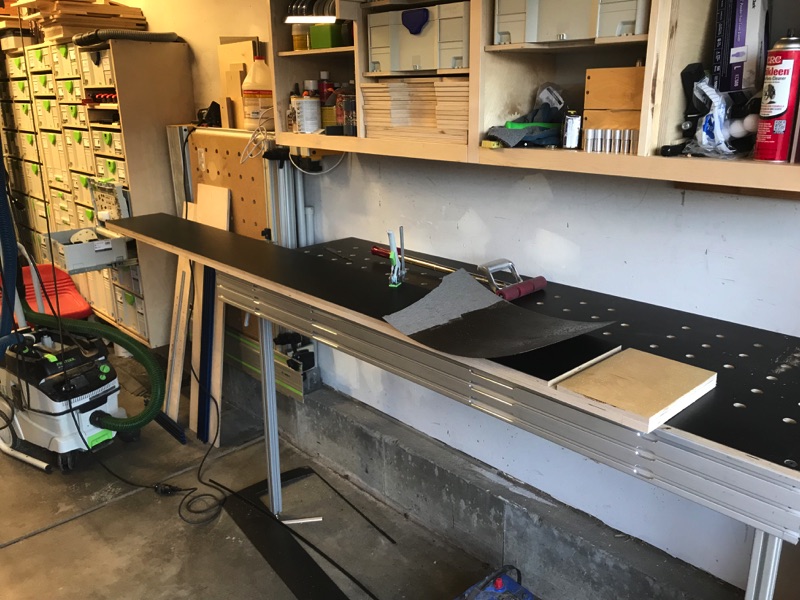

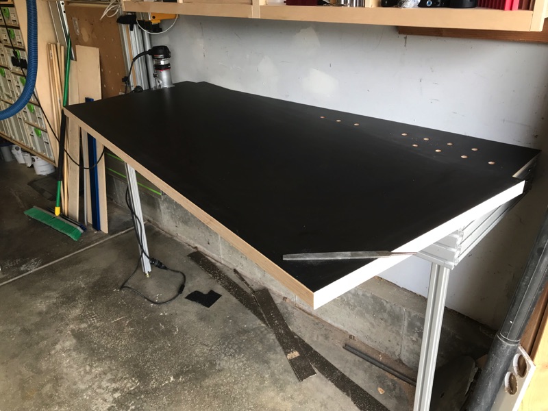

Looks like I'm getting some of these pictures posted slightly out of order but here's the wrapping up of the bench surfaces. laminated the top and did a quick round-over of the edge.
With the flip-up top in the up position, this is now the work surface I have adjacent to the mill. 2x the surface to keep clean too I suppose.

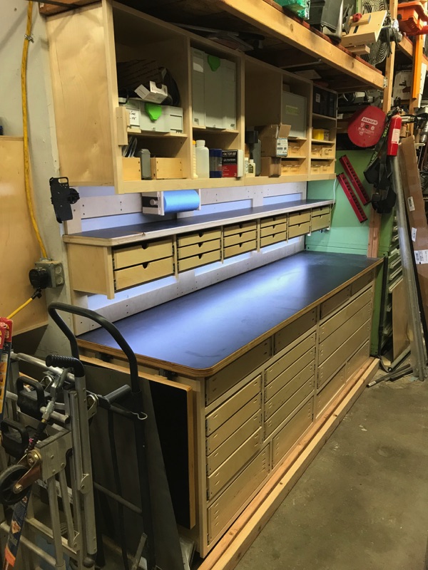

Mid-Uppers on the main bench have had a few random drops as a temporary top which worked just fine but left things feeling incomplete. Turning it into all one piece with laminate fills the void.

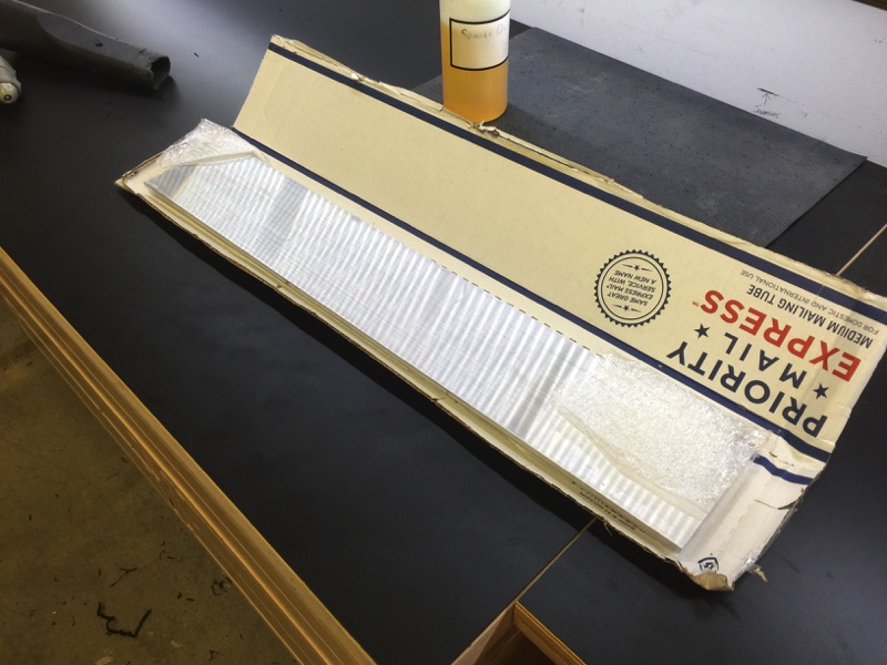

Did something a little different here. The laminate sheets I can get locally at the big box store are only 8-feet long. To avoid having a seam, I decided to add a t-track slot so I can attach stuff in the future. Maybe something like a tools rack for a dead blow hammer, tape measure, marking utensils...ideas?
L
lilscorpion
Mar 15, 2010
3,626
Colorado
Firebrick43 said:
Can you share some details of your spindle sander?

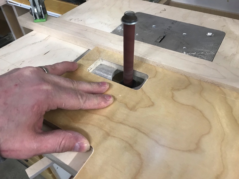

I when looking for router table ideas a few years ago I stumbled across this picture on images.google.com. Shows a router plate with a portable spindle sander attached to it. Had to have one.
During research, found that it’s the Porter Cable 121.
It’s mounted in a Rockler woodworking PC121 router plate. Even a few years ago both the spindle sander and the router table plate had been discontinued. I found mine used on EBay for about $200 in near new condition and then made a router table adapter plate for it.
After getting mine I learned very quickly that the Spindle sander is very difficult to use freehand, I tried it a few times. That’s probably why it was disco’d.
Today you can still find them in very good condition on eBay for between $200 and $300. The plate isn’t easy to find however, I just looked and someone is selling a spindle sander and plate combo right now for $300. Not a bad deal - https://rover.ebay.com/rover/0/0/0?mpre=https://www.ebay.com/ulk/itm/192586971181
Consumables can still be had. As luck would have it, many if the bench top spindle sanders use the same consumables. Steelex makes a variety of grits -
Powertech also sells their version (probably made in the same place)
The paper cylinders mount on rubber cylinders and Powertech’s version works on the PC121
Mounted in a table I find it beyond exceptionally useful. Most other spindle sanders are constrained by a fixed table and some kind of machine casing. This little thing can be in a full sized table and then move to a small table top unit a few minutes later.

Me too. Looking forward to seeing how good it is for only $75 all in. Didn’t realize until after that these use 3” long sandpaper cylinders instead of the 4” long ones my Porter Cable SS uses. This now means that I either need to cut the 4-inchers down or keep both sizes on hand.
L
lilscorpion
Mar 15, 2010
3,626
Colorado
Can you fit them all in the same bin?
I was tempted to order one too, but I resisted, so far.
There’s plenty of room to fit the sander and both sizes of consumables in the Systainer MIDI above the pull out sanding table. The new one I’ll use in a portable fashion though so I may decide to put it in its own Systainer. Think I need to use it first before I’ll make up my mind.

Been out of town and busy for most of July... The progress on the new shelves looks good.
How's the FT-5 build going?
Haven’t made progress on it since the last update. I’ve been stuck (haven’t found them yet) at needing to get two 80/20 90* internal connectors to set the motor mount rack (the right way)
If there is plenty of room for it, I would keep it together rather than taking up another systainer for essentially the same thing. It isn’t like you will get confused as to whether the 3” or 4” is the same.
Plenty of room. I plan to make an insert to organize the consumables too so keeping the sizes and grits together (or separate depending on your view) shouldn’t be a problem. Agreed that all of it should be together or I’m deviating from my consolidation plan immediately.
