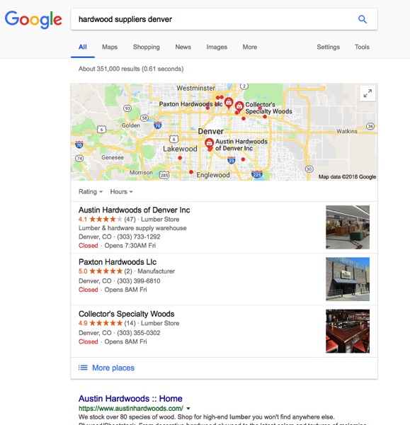

As for pre-finished vs regular (unfinished) baltic birch - where do you live? From what I understand, the pre-finished stuff can be special ordered into normal box stores. Since I haven't tried I don't know if there's a minimum purchase quantity (like a pallet) or not. May want to try your local Home Depot, Eagle, or Lowes like store. Go to the Pro counter and ask for pre-finished. Next time I'm in I'll do the same and report back. Otherwise, google the terms "hardwood supplier" and your city. When I do that for Denver here's what I get -
From personal experience in Denver, the top 2 are the two largest and both carry pre-finished ply. If I didn't have experience, I'd check out their websites first and then call if I couldn't tell from their websites. Give the query a shot in your area and see what comes up.
You don't need pre-finished for garage cabinets. In general, pre-finished is more expensive and shop cabinets don't even really need to be finished so it's up to you to justify the additional expense. I choose it because I'm have just enough practice building cabinets that I can (almost) plan once, measure once, and cut once...and the internet enables me to hide ALL of my mistake by simply deleting the proof before I upload pictures and post. That being said, I'd recommend using the nicest plywood you can buy from your local box store and start with that. The cost savings allows you to make a few mistakes here and there without feeling like you're throwing away money. Allow for mis-measurements and mistakes by planning to buy a few extra sheets just in case. Accept cutting a board to short...remember, it's the journey not the destination.

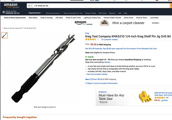

Shelves not being the same level question - I get what you're asking. The fixture I made is really a mistake of mine adapted to work anyway. The center holes were the original holes designed to be used with a spring loaded shelf pin bit like this:
The fixture/jig's center holes are the same diameter as the outer housing on the shelf pin bit. After using it a few times I realized that the jig prevented wood shavings/chips from leaving the hole thus jamming the drilling operation (read as not working well). To overcome that I decided to move the holes up 1/2-inch off centerline from the actual center and size them to match the actual drill bit that's true to the hole diameter. In this case, a 1/4-inch brad bit.
The drill bit works better because the flutes of the drill bit allow chip evacuation out of the hole. Why are there two pairs of offset holes? When flipping the fixture between sides the holes that used to be offset 1/2-inch to the bottom become offset 1/2-inch on the top. The result would be shelf pins that aren't, as you suggest, level (actually off by exactly an inch). To overcome this I had to drill holes 1/2-inch offset to both sides. All you have to do to get it right is use the same orientation on both sides. Drill the bottom set on the left then you need to drill the bottom set on the right to end up with a pair at the same level/height.
Now your observation is also true. If I were to drill both sets of holes on both sides (left and right) then I'd have a two pairs of holes aligned on both sides which are 1-inch apart. This though was not the original intent, just a side effect of my solution to the above observed problem.

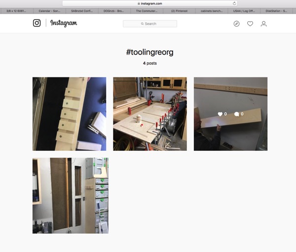

Also, I tried to find your account on Instagram. I wasn't able to track it down. I'm new to instagram, so it may be user error on my end, but I was wondering if maybe it was a privacy setting you had in place.
I just started using Instagram to share so it's kinda new to me too. There's two ways that you can follow my posts - search for #toolingreorg and you'll see all of my posts which I mark #toolingreorg.
What's cool about using #toolingreorg is you can also share you're organization efforts on the same thread by simply including #toolingreorg when you post. Creates a "ToolingReOrg" community of sorts.

Huh...there’s something I don’t get then. I’ll get my wife’s phone and see what she’s sees. I see 3rd one down. You don’t?

Got me, I can find it on her phone and through the Instagram website (not app) too. You guys are typing #toolingreorg with the “#” on the front right?

yep.
even a google search doesn't find it, which is kinda weird. it usually finds these.
what's your account name? it should pull up at instagram.com/xxxxx without searching.

beelsr said:
thought: is your account set to private?
It was. That explains why my wife’s phone could see it. Not sure when I switched that on. Bet you can find #toolingreorg now...lol

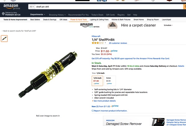

I was browsing around Menards one day (dangerous I know) and saw this Milescraft Cabinet Mate shelf pin jig. For ~$20 it was a worthwhile investment for my few projects. You can zip right along making the holes. It can kind of clog up like you were mentioning in your post #323, but I find that if drilling on high speed and once you get the right amount of pressure it seems to eject the chips fine.
L
lilscorpion
Mar 15, 2010
3,599
Colorado
Yeah, simple and gets the job done. I have the rocker version that’s just ok. It clears the chips like you said, with some speed. I liked the fixture a little but found that the bit tends to drill tight holes only when you get it perfectly perpendicular to the workpiece. I don’t think I’m good at free drilling perpendicular like it needs so my holes always seemed sloppy. It’s probably because Om just off a little. 🤪
To clarify my issue with the bit - this bit with my home-brew fissure didn’t clear the chips because the chip evacuation hole is buried in the jig (so essentially blocked). I know I didn’t explain that well.
EOC_Jason
Jun 25, 2012
11,388
Bentonville, AR
Yeah, you would think they would put more than two small holes in the drill jig assembly. It could be engineered to work better...

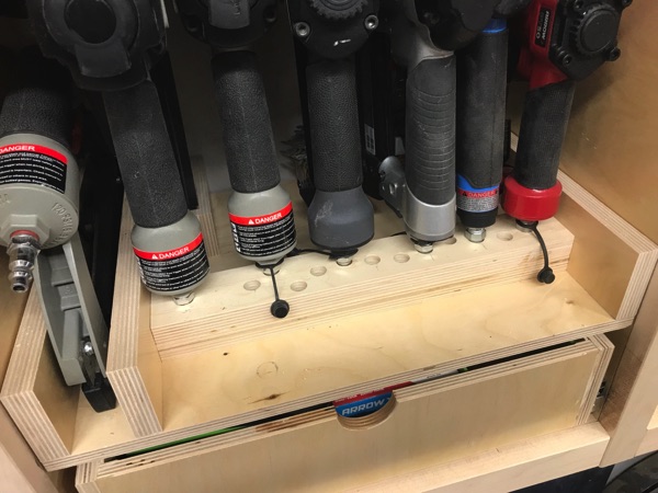

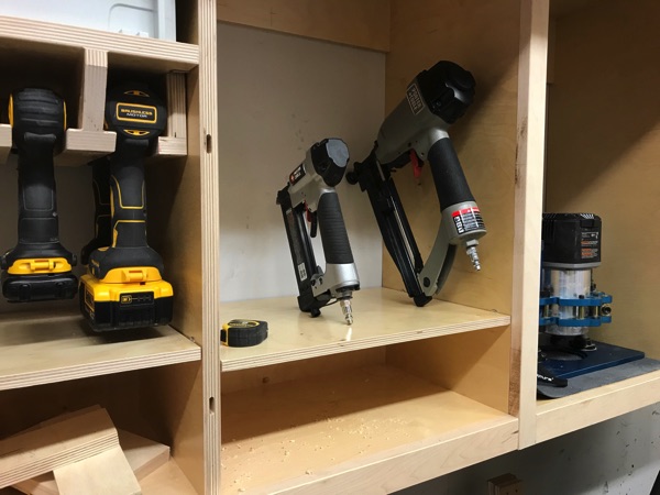

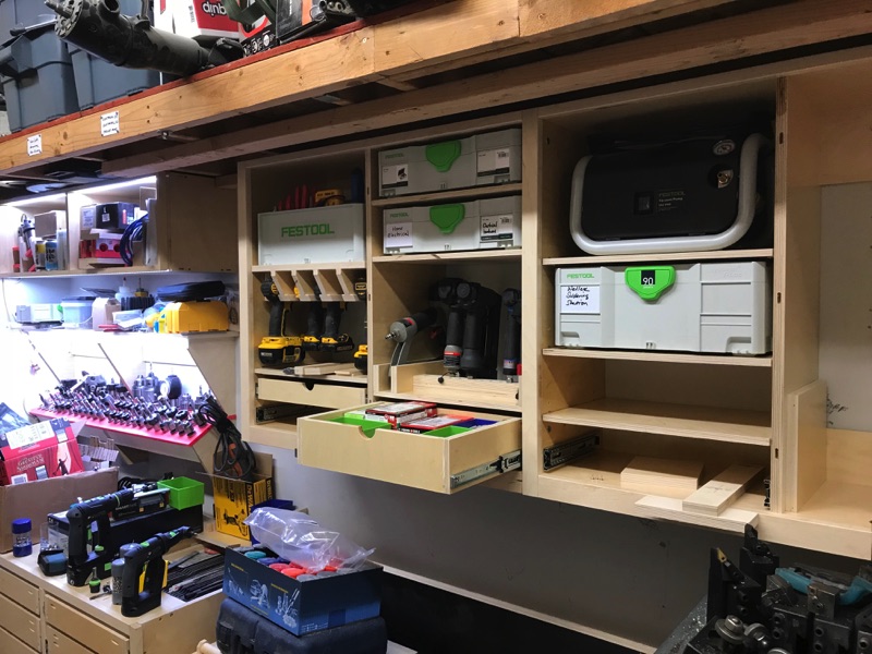

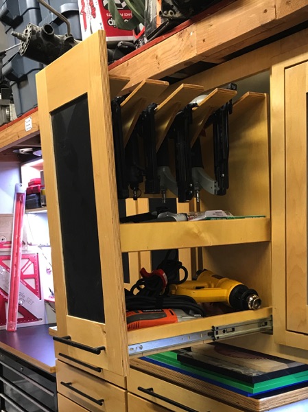

Nail Gun Module
Having the drills organized is nice. What isn't nice is my nail guns all stacked up in a drawer so a module to organize them is next. Here's the old storage strategy to correctly set context for the build.
This was the original design strategy:
  • Fancy as hell
  • Guns stored in hanging position made them easy to grab
  • Ramp back into the cabinet retained the guns nicely into the cabinet
  • Shelf below the guns made storage of consumables really easy and close to the guns
  • Additional shelf below allowed for storage of other stuff
Lessons learned:
  • Guns stored backward required me to grab the gun magazines to remove them from the rack
  • Guns stored backward in the rack required me to use two hands to put a gun away. I'm always holding it by the grip so I have to grab it by the magazine with my other hand to put it away...but, when going to put it away it's always in my right hand so I have to shift it to my left to grab it by the magazine then back to my right to put it away because of how the cabinet opens. Think about the activity - gun in right hand, left hand pulls cabinet open, pass gun to left hand, pass back to right hand gripping the magazine, put away, left hand closes the cabinet. About as inefficient of a process I could come up with.
  • Ramp back into the cabinet is just high enough that it takes effort to get the gun high enough to get over the peak.
  • Shelf below the guns (where I store consumables) is about 2-inches higher than slight-line so I frequently need to go tippy-toes to get what I need. This makes finding something small a PITA.
  • Addional storage shelf at the bottom is good in theory but it's shape isn't conducive to storing most things and it ended up being a catch-all for odds and ends.
I spent way more time than I should have trying to come up with a solution.
I oriented the guns in a variety of ways attempting to put them in a position where I could remove them from the cabinet with one motion (and in my right hand). I tilted the guns this way and that, balanced them against objects, and even flipped them up side down. What i kept coming back to was something I remember noticing during the last cabinet build. The guns all have inconsistent magazine rails in shape which makes them very difficult to organize. Finally frustrated I decided that this was not something I needed to solve. I have way too much left to do to spend half a day on a stupid nail gun rack. I needed a temp solution to get me by and I'll come back and be innovative later. Noting that the only consistent thing about the guns is the air chucks on the end, I decided to make a very simple block that I could drill to the OD of those air chucks so they could stand up on end. Then, if they needed support, I'd work one at a time to do so.
When dropping the guns in for the first time, I noticed that because the depths of the holes is deeper than the air chuck ends were long, the guns stood straight up. Only the narrow crown stapler needed a guide block to the rear to keep it straight. Otherwise, done?
My finish nailer was too big to stand up in the cabinet without wasting space. As you can see in the picture above, I created a simple slot for the magazine to lay in which, when just tall enough, balanced the gone nicely. It's the only gun that requires me to twist my hand forward to remove from the module. Otherwise, any of the guns can be easily removed by grabbing with my right hand, lifting up ~1 1/2-inches, and away I go.

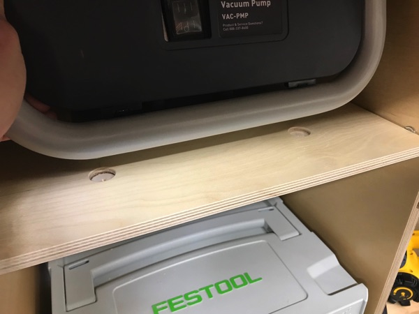

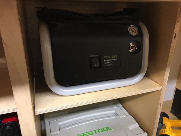

Moving on, I need to get my vacuum pump off the floor before I damage it so, after measuring it's height, I added a shelf to the cabinets for it. Long term it won't be staying here, I have plans to move it over towards the MFT in the main garage where it will stay in the cabinet even when it's in use. The pump does mildly vibrate when on (like an air compressor) so I added some recessed holes to locate the feet.
When settled down in the holes, it stays put. It's also fairly difficult to get out of the recesses so this storage solution will only be good if it can be in the cabinet all the time. I'll probably flip the shelf over if the forward plan is to remove it from the cabinet before each use.

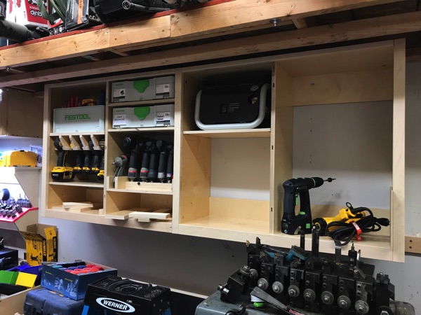

The cabinets are starting to come together. Progress should be steady now since each addition is now either a simple shelf or a module...or so I hope.

Good Lord man, you even have the Festool vacuum pump? How many inches of mercury or -psi does that pump pull? I'm just starting to look for a vacuum pump for vacuum bagging composite layups and I don't really want to buy a HF unit. But I think I can get a really nice pump for the price of the Festool model.
L
lilscorpion
Mar 15, 2010
3,599
Colorado
150mbar according to the catalog. It's strong enough to hang on to the board while I'm doing stuff to it. Works well 'cept it's difficult to setup when you keep it in the systainer between uses. I tend to just skip using it as a result. One of the goals of this redo in the shop is to figure out a way to make it much easier to setup. Maybe a module or something that bolts easily into a work surface that flips down when not in use. I have some ideas...probably a month or so out though.
The vacuum system does work sweet though. When I had to sand down the railing on my staircase the two vacuum clamps with the narrowest cups were able to hang on to the profile of just the railing which was about 14' long. It made the job so much easier than I thought it was going to be.

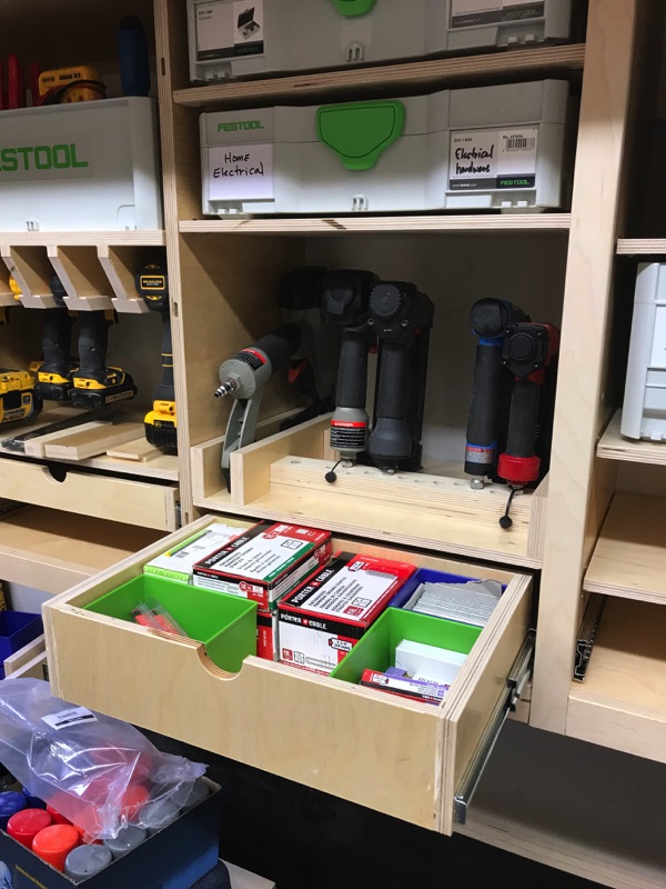

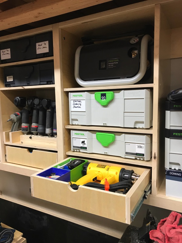

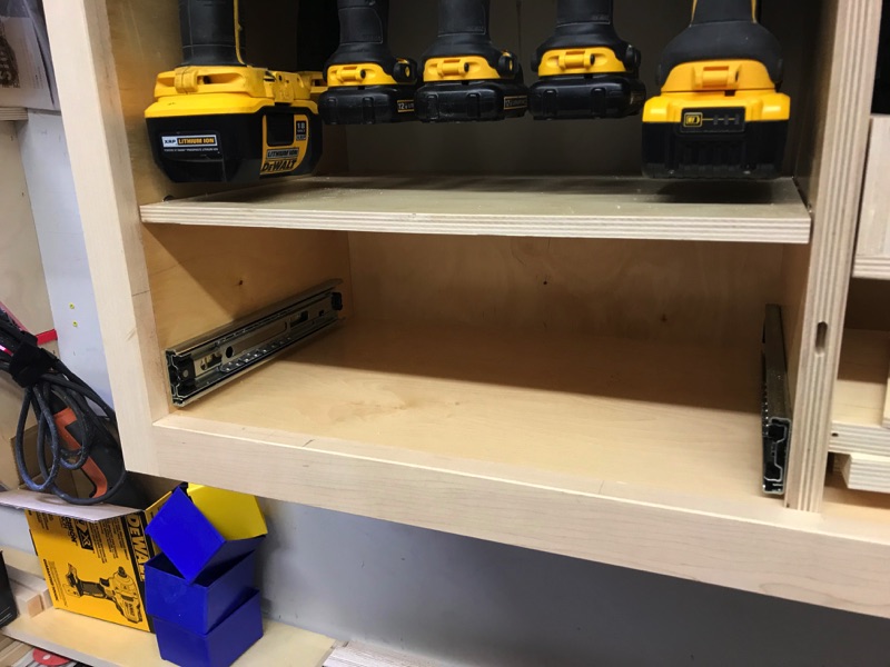

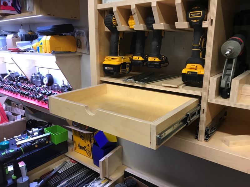

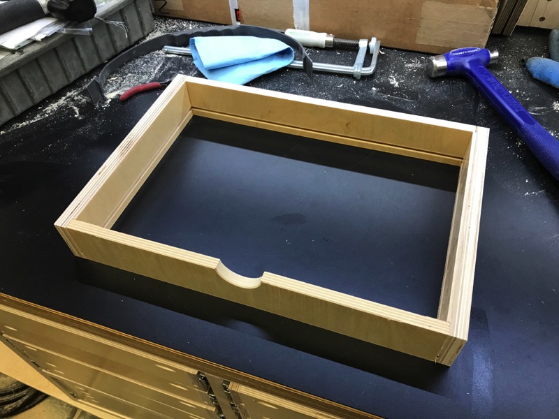

Chaos Drawers
I did like the idea of having drawers beneath the shelves and I really like the idea of using them to store accessories and consumables for the items stored above them. Since I might end up adding doors to these cabinets I decided to in-set the drawers by 3/4-inch so they’ll put slightly inside of flush. Since the cabinets are 12-inches deep, I down-sized the slides to 10-inches and ordered half a dozen pairs. I started with installing a single set to build the drawer to.
I’m now starting to run al little low on scrap plywood so I ended up making the drawers out of a combination of 1/2-inch and 3/4-inch ply for the sides and 1/4-inch ply for the bottoms. I used a 1 1/4-inch forester bit cut @ 50% overlap at the edge for a “finger pull”. This is what will allow me to get the drawers open.
Bada-Bing, bada-boom.
with the dimensions set, I built one deep one to hold my assortment of nails for my nail guns
and then one that I think I might move some of my electrical tools into (still largely undecided).
and a second thinner one for under the drill drawer to hold drill bits and hex bits. Here's a place I'm looking forward to 3D Printing some parts when I get around to it. Hex and drill bit organizers mostly but I have some ideas..

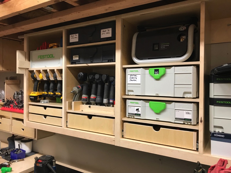

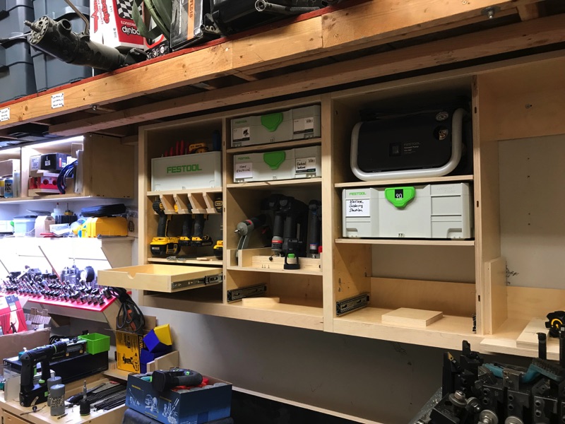

From a distance I can now begin to visualize the shop coming together. I can also see how useful some smaller drawers are for organizing the smaller stuff (even when the "stuff" isn't really organized that much yet).
