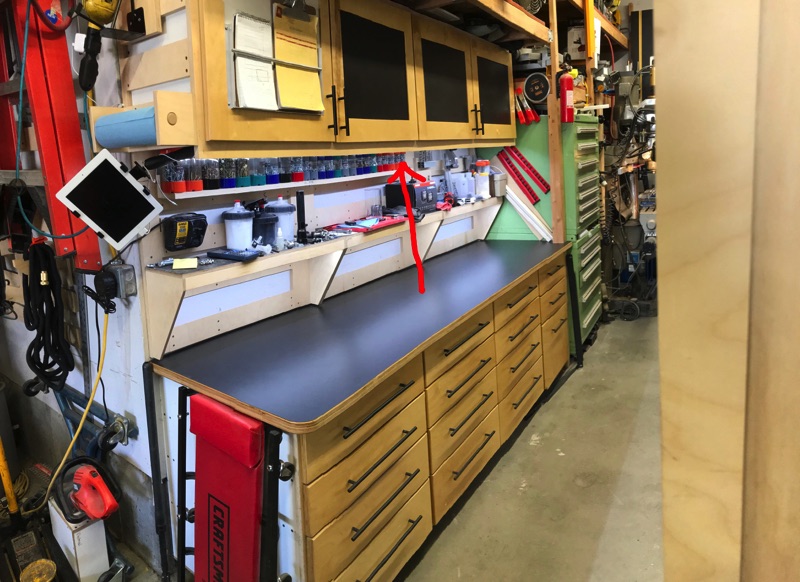

Moving In - Tooling Bench

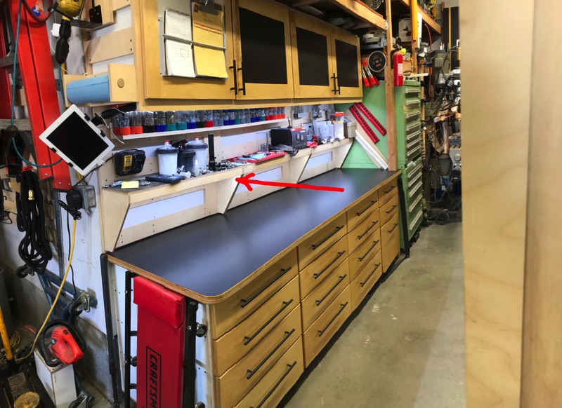

Got (mostly) moved into the tooling bench as well. After having moved in I'm not totally sure why I'm calling it the tooling bench. It would more appropriately be named the hardware bench. These two drawers are nearly the same since you last saw them. Both were designed to the specific depth of the two sizes of view-tainers that I use.
In these drawers are screws, cabinet hardware, and other misc hardware that I tend to have in bulk.

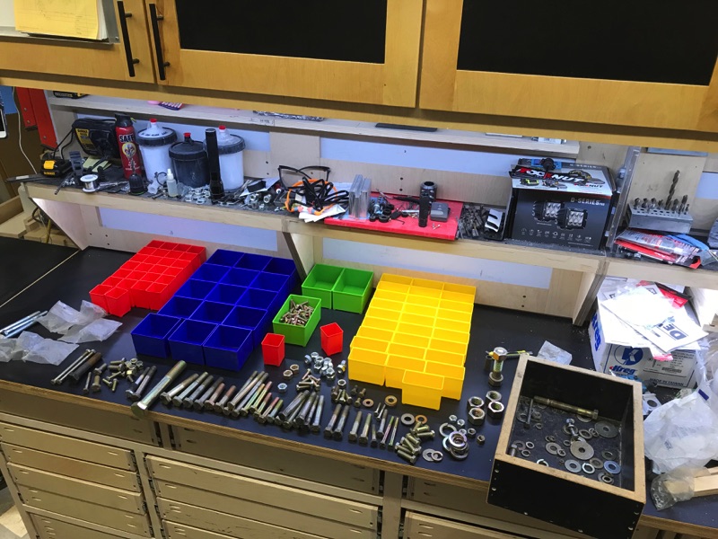

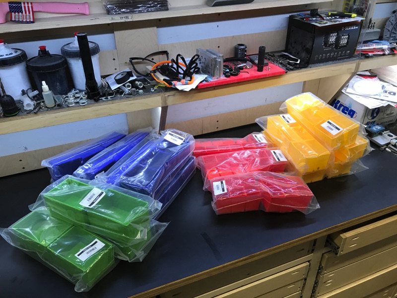

The rest of the organization will be done with plastic containers. For consistency, I decided to go with the festool containers that come in various sizes. I ordered kind of blindly making assumptions on quantities.
After removing them from the wrappers I, for a moment, felt like maybe I ordered way too much.

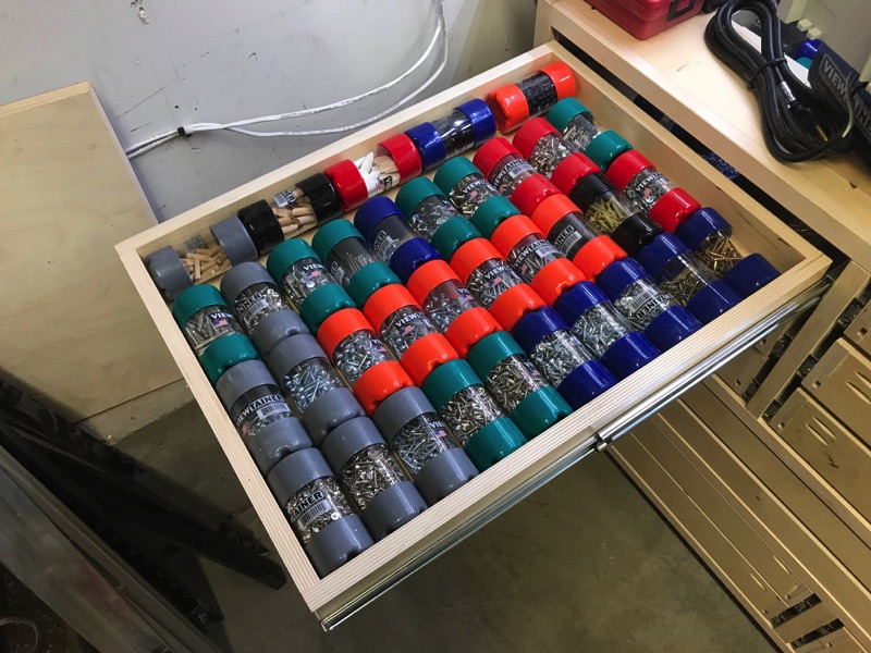

I started with my electrical drawer. The quantity of an item dictated the size of container to use. Seemed to end up fairly well. There's no way that they're the right size if I have to buy a package more of any one thing though. This setup is currently perfect for what I have not what I'll have over time. I'll have to come back to it when there's a good reason.
Second electrical drawer has mostly plugs, outlets and outlet covers. Unfortunately this shows just how many 3ph 220 plugs I ended up with after moving out of the business.
Similar outcome with the plumbing drawer only I had room for expansion.

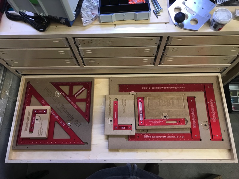

This is one of the super long drawers. The way the MDF ruler holders work creates a bunch of waste and makes it difficult to get at most of them without moving one of the others. Once I get time I'll cut some custom kaizen foam inserts for this drawer which will make all of them easily accessible.
This drawer, though it looks mostly empty today, will be where I keep all of my aluminum fixtures and smaller measuring utilities. It looks like the drawer will be barely used however I actually have a mess of fixtures that aren't in here today. I'll do a writeup just on organizing this and the other ruler drawer when I get to them.

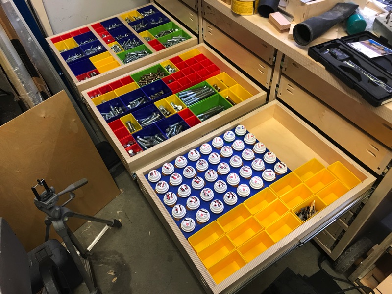

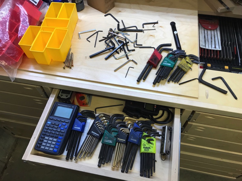

Next came the sorting of my hardware drawer(s). I had to take everything out and then figure out what I did and didn't want in these drawers. I decided to put everything 1/2-inch and smaller in these drawers (and smaller than 13MM in metric).
I'll save you from the time it took to go through the various buckets and bins but, in the end, everything became right there in front of me. No more heading to the hardware store for something I think I don't have only to find 25 of them later the same day. Even though I thought I had way too many bins, I turned out not to have enough. I did choose to continue forward with the medicine bottles for the smaller hardware because it had worked so well in the past and the containers were already clearly labeled.

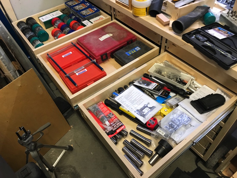

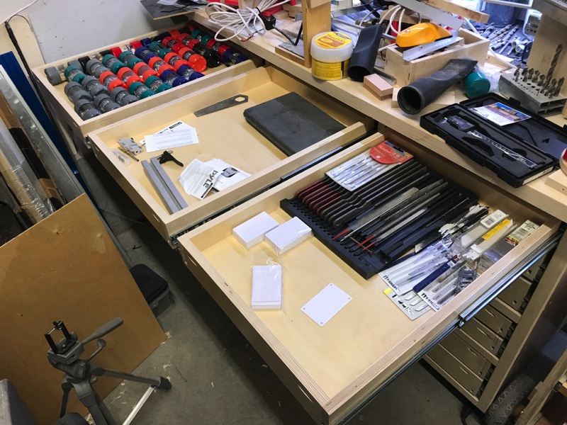

Middle drawers are still a work in progress. Far drawer is the large view-tainer drawer from earlier in this post. The middle drawer has my various parallels sets for milling. The closest drawers a temporary staging spot for most of the tools that will end up going above in the rack once I re-macihne the tops.
As I was loading the top middle drawer I kinda had an epiphany. Most of what I was putting in this drawer was "small stuff". To take full advantage of the drawers I found myself stacking things on top of each other which defeated the purpose of the depth of the drawer (felt wasteful). What was worse is when I closed the drawer, the stuff shifted and ends dup in piles.
So I had a choice - either make dividers to control everything or do something different...it was then I had my next idea which caused me to pull everything back out. I ordered some parts and plan to implement it this weekend.
Until then, here's what the drawers look like now. Far drawer is the small view-tainer drawer from earlier. Middle and now the right two drawers have a substantial amount of room to grow into
I now have about 75% of what I'd planned to move, moved.

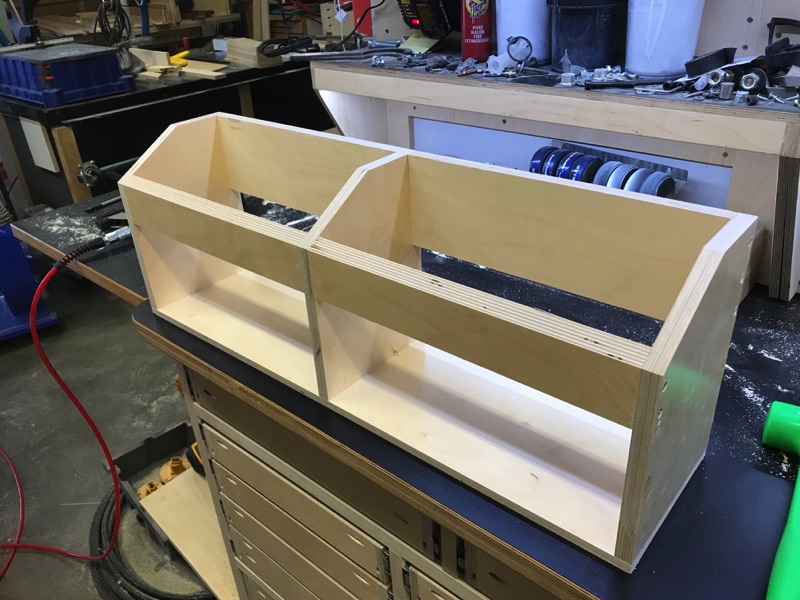

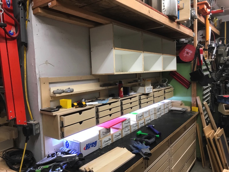

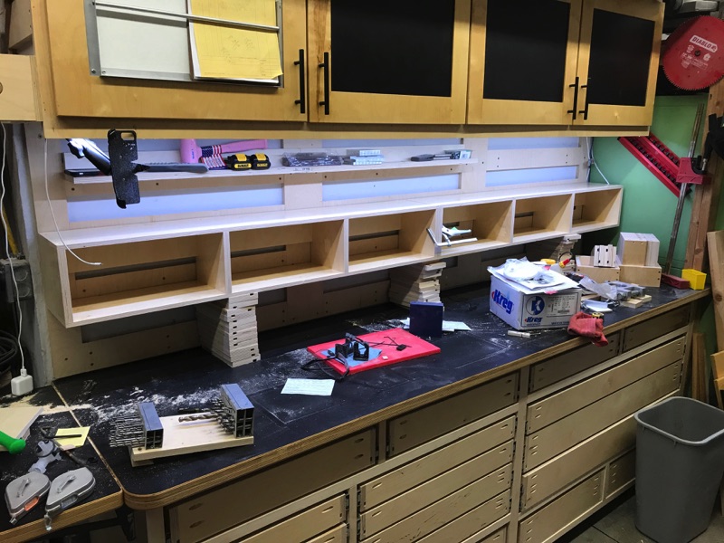

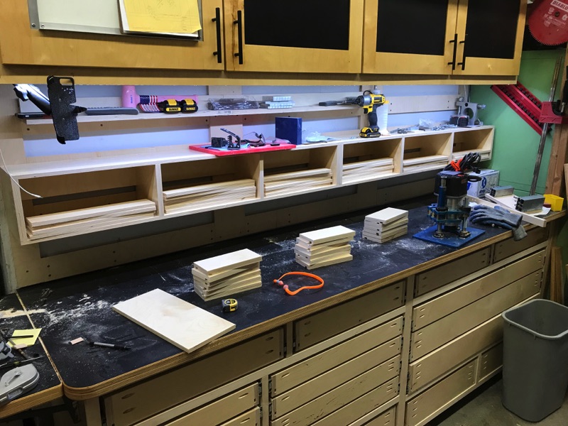

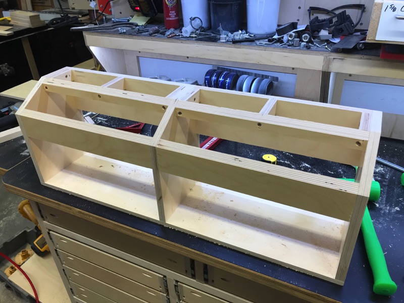

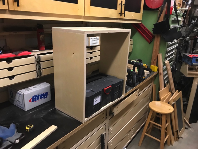

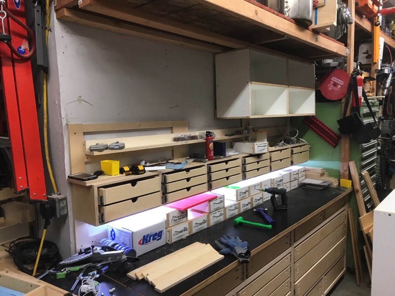

After seeing the chaos drawers come together, I realized something - smaller drawers are ideal for storing smaller stuff and I’m going to waste a ton of space if I put things like pens and pencils in a bigger drawer even if I build inserts. While cleaning up I realized that my mid-shelf design on my main bench could have easily had drawers built into them without taking away from the bench usability.
Relative to the cabinets these will be a relatively fast and simple upgrade with small and manageable assemblies so I can knock them out quickly with mostly scrap leftover from he other cabinet assemblies.
Brad nails are used to hold the pieces in place while I counter drill and screw them together.

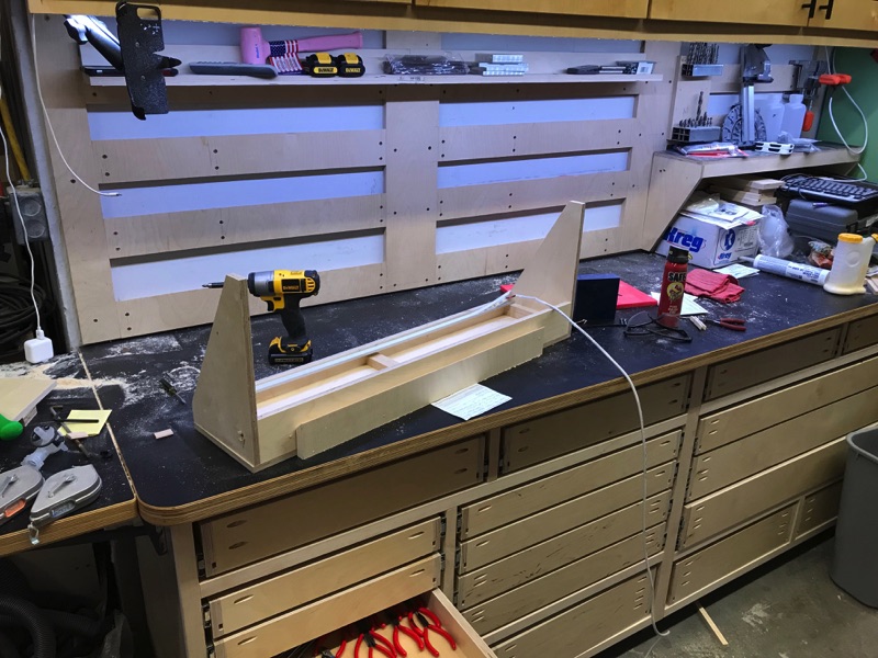

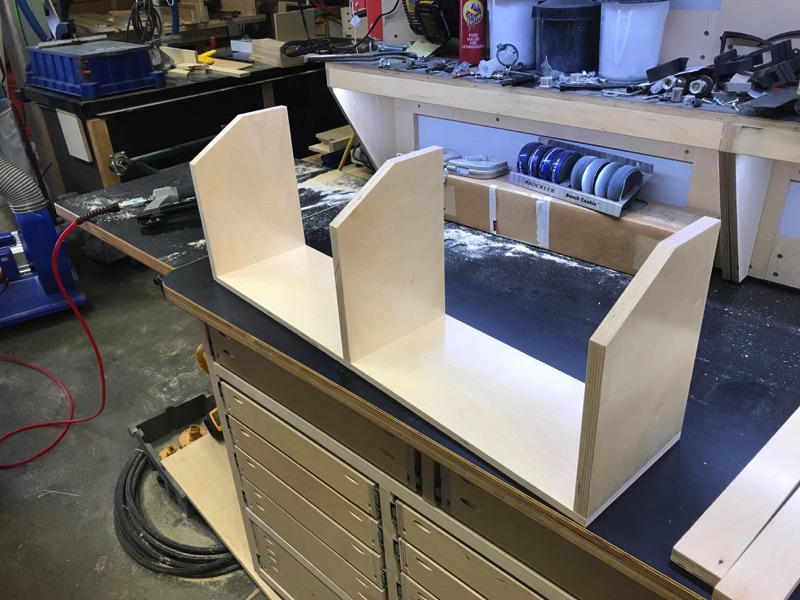

Since I needed to build an extension for the R8 Collet rack anyway I decided to rebuild the racks all together and add in drawers here as well. They’ll be perfect for chucks, keys ,etc.
The R8 rack boxes are a little more complicated but I have the benefit of copying angles and taking basic measurements from the previous R8 racks. With only a few tweaks, They go together quickly. IIRC, the first set took me half a day. These took me a total of a hour and a half.
The mid-shelves on the main bench are extremely easy to uninstall since they were attached using cleats. I plan to recycle the LED lights so I remove them as I go.
And just like that, the new mid-cases are in place.

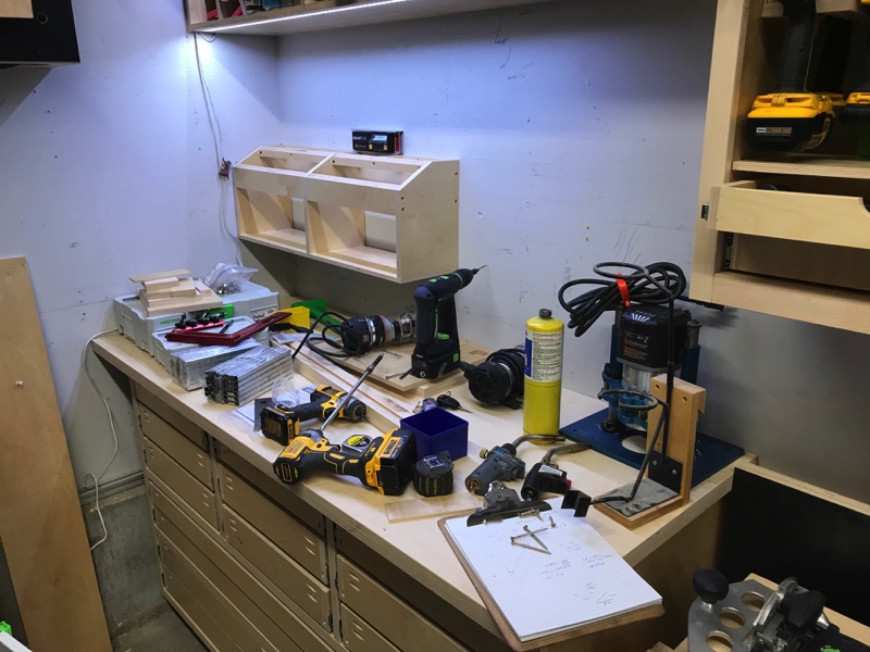

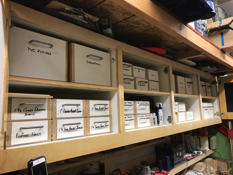

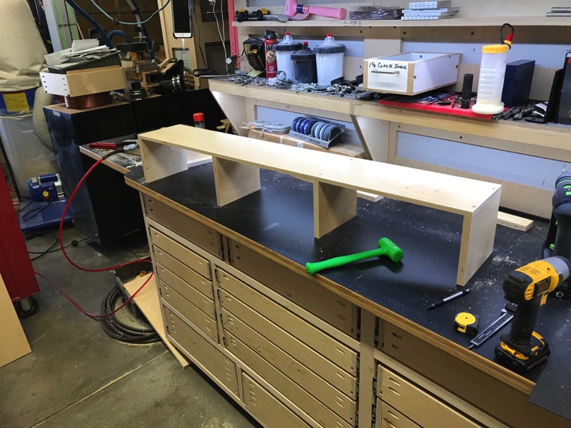

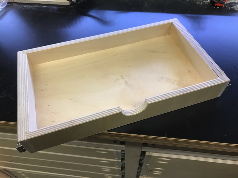

Now I’m back to building drawers I guess. Again I dig through my scrap and come up with a design that enables me to optimize my use of scrap.
Sidebar on scrap material: I’ll be honest, a scrap-inspired design is not usually the approach I take when building things. I’m not too good to use scrap, I just realized one day that most of the scrap that I’d been hanging on to is worth less than the value shop space that it occupies. As a result, I tend to burn my waste/left-overs within 30 days of a project ending.

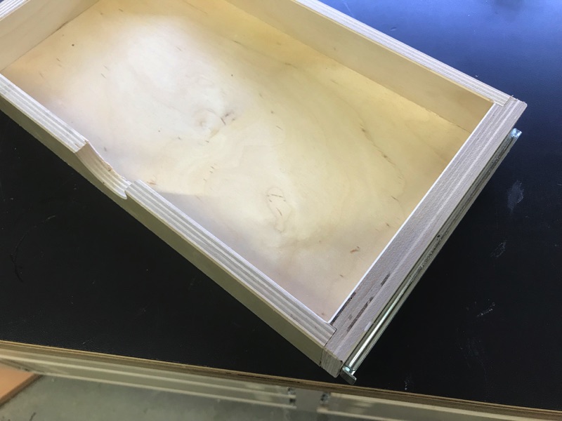

Back to the build…I have a bunch of 1/2-inch drops left over from the drawer bottoms and a few 3/4-inch drops. After some fast math it looks like I have just enough 3/4-inch to use it on the sides, more than enough 1/2-inch for the fronts and the backs, and plenty narrow 1/4-inch drops I can use for the bottoms. Using the 1/2-inch on the sides is ideal because it will allow me to run longer screws on the drawer slides. Here’s a completed assembly -
The little finger notch is added so I can more easily open them until I get around to making the drawer fronts for them. That was a lesson I’ve already learned on the base cabinets. Some of the drawers are really difficult to get open without pulls. Anyway, simple short term solution. I happened to have a single slide left over from one of the bathroom builds so i mocked it up. it’s a 8-inch, full extension, 100lb-rated Accuride slide. The odds of these drawers having 10 lbs of stuff in them is probably 5% so I’ll have to see if I can find something that’s not as heavy duty but quality enough that it has a nice glide feel like these do.
With the design set, I hammered out some drawer parts sticking them in their slot to stay organized and make sure I don’t lose count.
Spent the rest of the day assembling little drawers. As they completed I dropped them in their hole keeping them in order and ready for the slides.

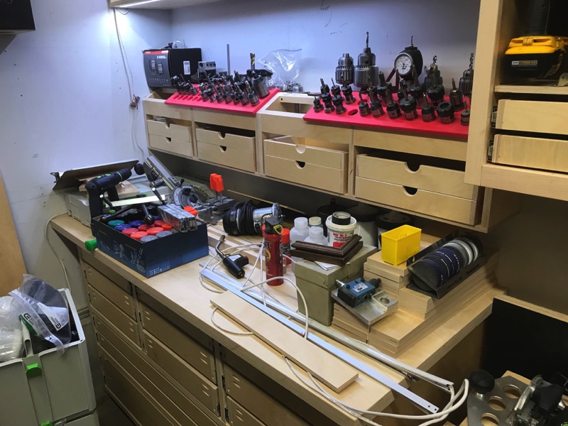

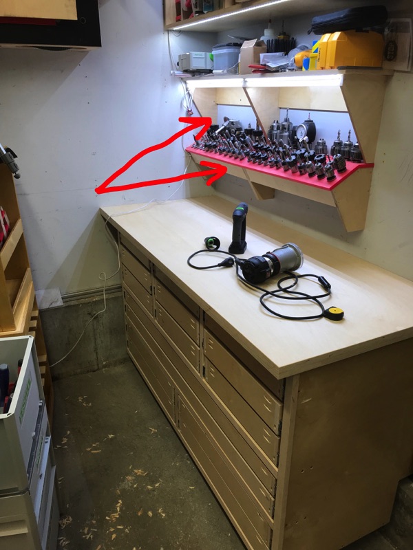

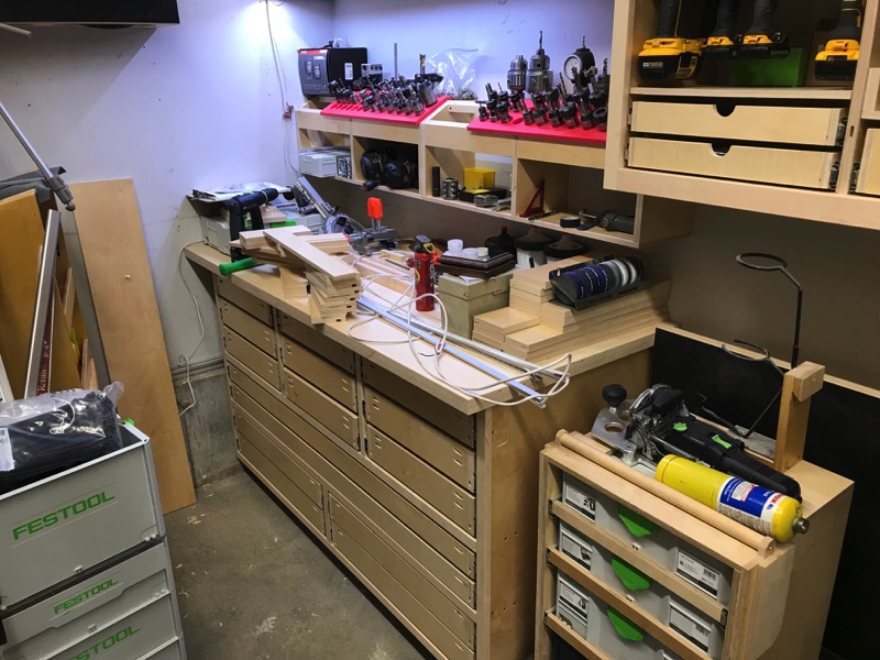

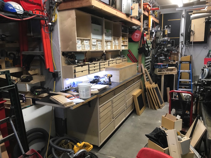

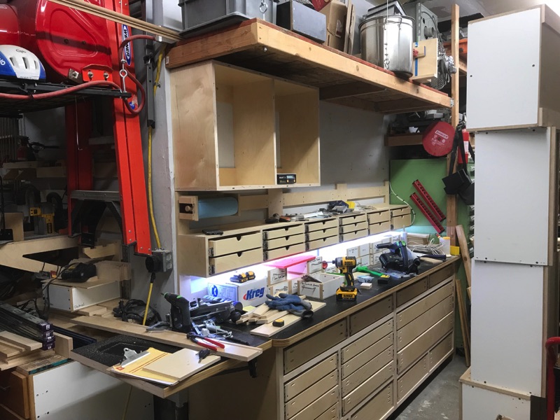

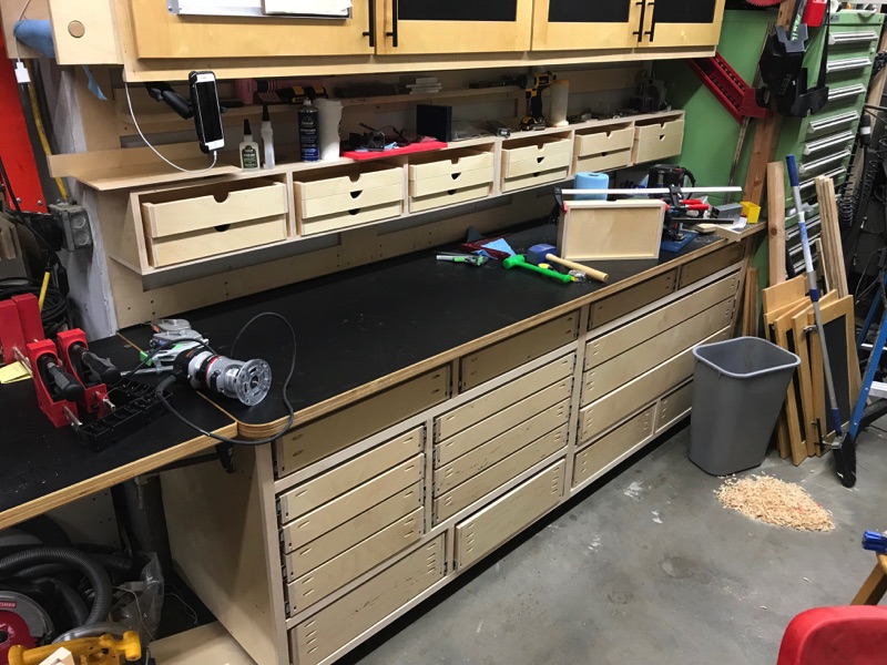

Shifting over now to the tooling bench, the swap is also easy.
Since I don’t really have a good way to store that much tooling without the rack, I re-installed the previous HDPE sheets so I have a place for about 95% of the tooling to live until I get around to making the new pieces.
Back to assembling drawers. Getting a little tired of completely destroyed work surfaces. Pictures make my shop look exactly like the mess that it is for the record.
Now I’m bummed that I hadn’t planned in advance on these. Had I known this is what I’d be doing I would have had the slides here already. Oh well, if I’m lucky they’ll be here by next weekend. I did do a little shopping…for the money it looks like I might as well just order more of these 100lb slides. Anything less expensive looked like junk..

Main Bench Upper Cabinets
I hadn’t planned on replacing the cabinets above the main bench since they’ve seemed to work just fine however I’ve been eyeballing them as I walk around the shop for weeks trying to make a final decision.
I felt like the design was good (enough) and they worked fairly well for how I used them though I rarely pulled the bins out of them so they ended up being used more as long term storage than they existed as part of the shop flow. The two largest bins (marked “irrigation” and “PVC Fittings”) have never been removed from the cabinet since I put them there. the PVC fittings were left-overs from the shop I had where i had all of my shop air lines plumbed in PVC until I learned why I shouldn’t (boom). I probably have 20-something fittings of every style in that bin and I’ll never use them again. Not sure why I’ve allowed $50 in materials to occupy valuable shop space for so many years. After peeking in the other bins I came to the conclusion that most of it had to go or be stored elsewhere. The space is getting repurposed.
1 by one I pull the doors, strip the face frames, and demo the car-cases.
Removing these cabinets is a different experience. As the wall gets more and more bare, the space begins to feel less and less like my shop. I’m so used to the bench looking a certain way. I did not get this feeling while demo’ing the opposing wall over the lathe which is equally strange. Maybe there’s something more personal about the workbench space.
With all the cabinets down, I pull the tape to get some rough measurements. One of the challenges of shifting towards Systainers is storing those tools that are larger than the standard/normal systainer format. An example of these tools is the sawmill which is a few inches too long. Tanos (mfg of the systainer) must have seen me coming so they offer a MIDI version of the systainer which is about 3-inches longer and perfect for the sawzall (they actually have an insert specific to the sawzall). Up until now all of the upper have been the same width (increments of 18”). In the case of the MIDI, the cabinet needs to be a little wider (~23). I now have a justification to build a new sized cabinet. In the space above the main bench adding a new width to my standard cabinets makes total sense. The space is just big enough for 2 @ 36 and 1 @ 23 and the single 23 would accommodate at least 3 MIDi sustainers before I’ll need another. Plenty for now.
On to the two cabinets at regular dimensions. By now I can put them together in my sleep (meaning I still have the fixtures, the work itself is not any easier or faster).
New cabinets going up. The new cabinets give the bench space a slightly different feel. It’s the wood contrast I suppose or maybe it’s just me justifying the replacement of cabinets that really didn’t need to be replaced.
With the cabinets up, I’m now able to move things around as I build inserts. The storage feels to have doubled and the ability to add a shelf wherever I want makes the effort worth it. For now the bins go back up on the shelf however only temporarily. With the hardware drawers in the new tooling bench there’s little to no need to have so many hardware bins up on the shelf anymore. Some of this stuff will move to long(er) term storage and some will go away entirely.
Strouty
Mar 21, 2010
38,247
Southern Maine
I completely understand the thought process. I redo things when they irk me or just don't seem to work. The cost of storage is definitely not always considered, you are absolutely considering it!

Enjoying your progress! Question on the small drawer slides- are these Accuride 3832-E8? I didn't find 8" slides on the ahturf site, where did you end up getting these?
L
lilscorpion
Mar 15, 2010
3,626
Colorado
The filter doesn’t work well on their site. When you select 8” it narrows down to all of the slides that have an 8 in the number (like 18, 28, etc) and then the ordering is weird. The 8” ones are on the very last page at the bottom. Here’s the link directly to the ones I used -
