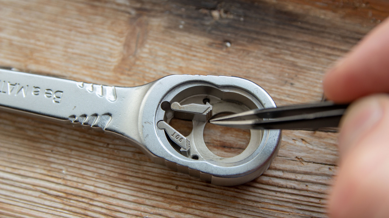

Used the Matador ratchet today and found a bit of a fault. One of the pawls is loose which results in some play in the mechanism. The lower pawl is retained in a slot. To remove it you slide it out of the slot up towards the camera. The upper pawl is not retained at all. The pawls are identical so the issue remains if they are swapped round so I assume that the recess for the upper pawl is too big. Hopefully the seller will exchange it for another one.
<iframe width="560" height="315" src="https://www.youtube.com/embed/EVQ4MEVi08Y" frameborder="0" allow="accelerometer; autoplay; encrypted-media; gyroscope; picture-in-picture" allowfullscreen></iframe>
Edit. Just noticed some conflicting info on the bill.

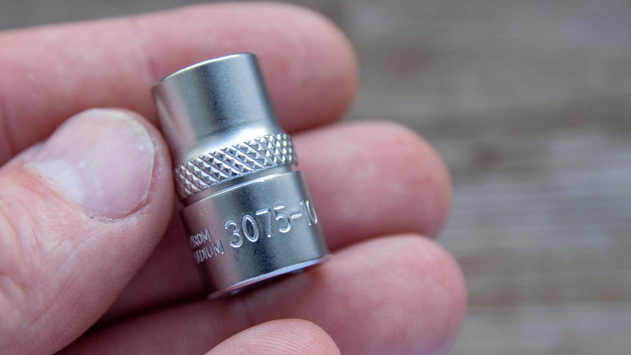

Matador replied to my email about COO. I asked specifically about the '3075' range of sockets and asked why they no longer have 'Germany' stamped on them. I think it was good of them to take the time to reply.
Thank you for your interest in our products. Except for very few exceptions we generally do not stamp our articles with "Made in Germany" even if they are produced in Germany.
The sockets are manufactured by a sub-contractor according to our specifications and drawings and we buy them as semi-finished parts. As a traditional and conservative manufacturer we would not consider them as a strict "Made in Germany" product as we only do some of the overall working steps in our factory in Remscheid, Germany. We hope you are happy with that.
Can anyone say what they think these 'working steps' are? Anything more than a buff and clean?

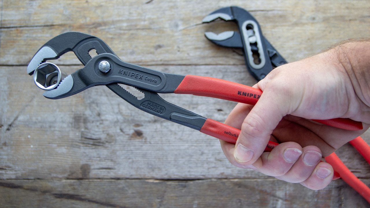

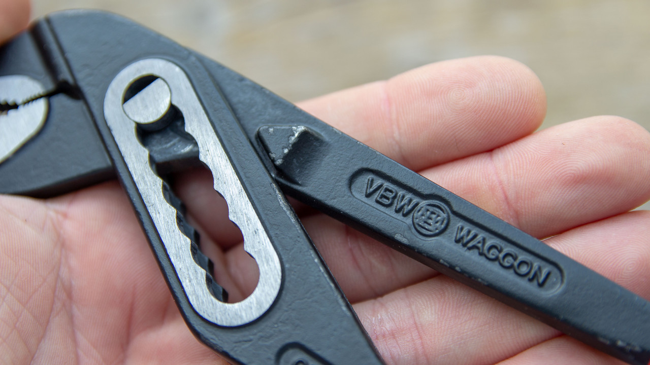

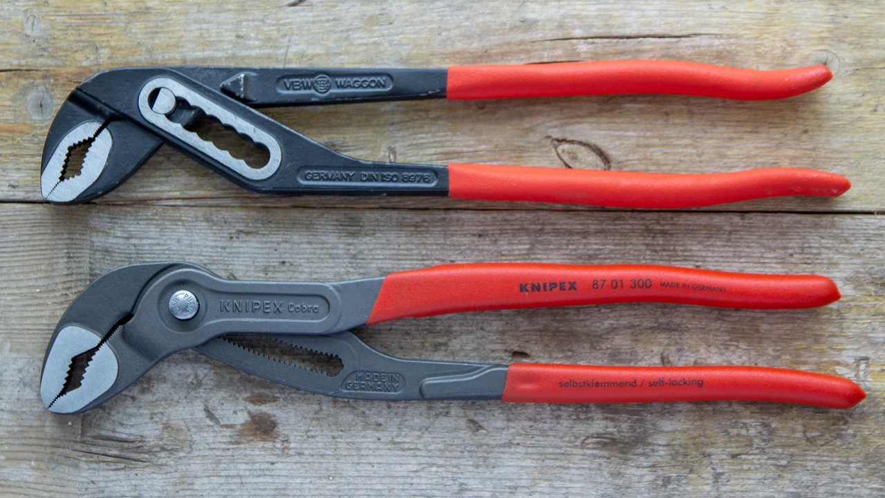

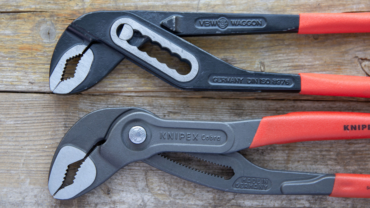

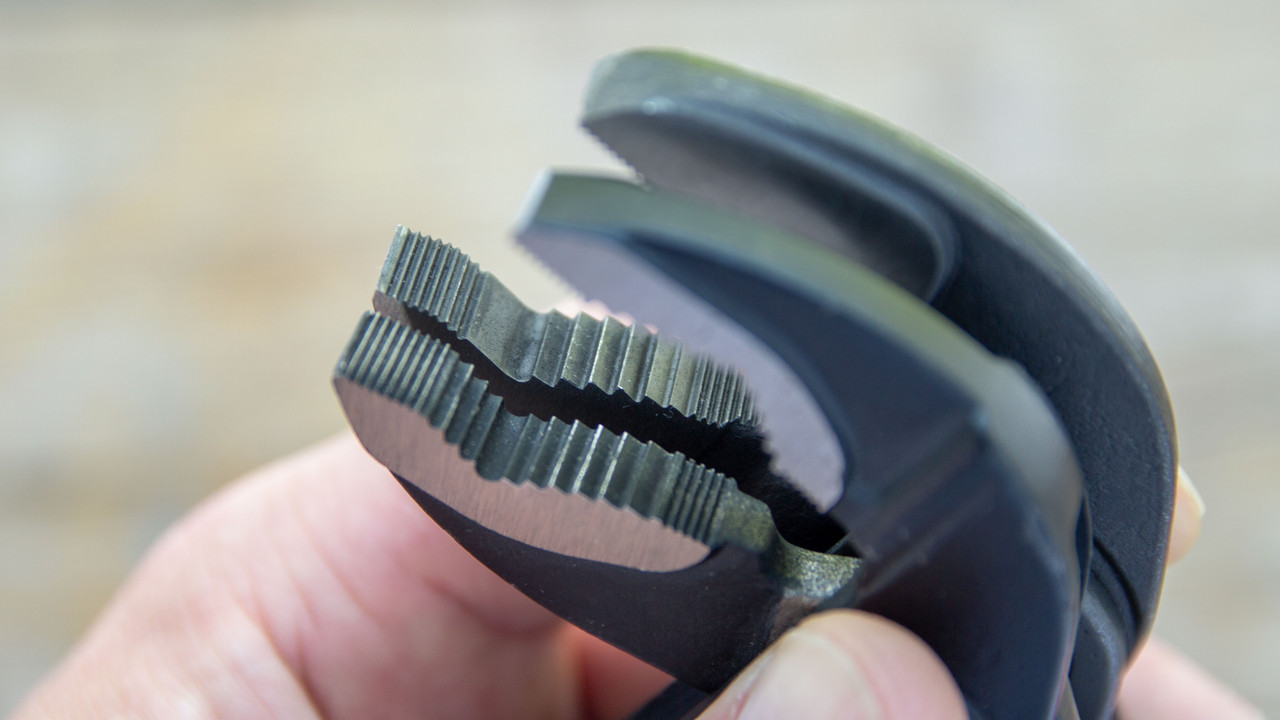

I find the adjustment on Knipex Cobra pliers to be a little fiddly and annoying so gave some VBW (Stahlwille) Alligator style pliers a try. Model number 966-315 (300mm).
VBW has a few more teeth.
I tried both pliers on various sized objects to see which was the quickest and easiest to adjust. Probably obvious but having only seven relatively widely spaced adjustment settings on the VBW means that on certain objects you have to put up with the handles being far apart. The Cobra's can be finely adjusted to keep the handles closer together and so easier to grapple with. Knipex Alligator pliers look to have nine settings. Not sure if this gives a finer adjustment compared to the VBW or just a wider overall jaw opening. I must say that I appreciate the Cobra pliers more now.
The black finish on the VBW pliers appears thicker and less durable than the finish on the Knipex as it looks a little dinged up just from storage and transportation.
Not sure if it makes any difference to function but something I noticed is that the VBW handles flex quite a bit more than the Cobra handles. Also should note that I have never directly compared VBW and Stahlwille pliers so don't know if they really are exactly the same but with different coloured handles.
I would hope they get them as a forged basic shape, then do the stamping, machining, cleaning and heat treatment, and chroming, but very unlikely.
The finish, and quality is too high to suggest most of it was done in germany, no imperfections on any of the sockets I have compared to Elora, and Gedore.
Best guess would be they are the same subcontractor who make Sonic Tools sockets, as they are basically the same just different brand stamping.
It's a shame. I was hoping that they may be an interesting alternative to the main German tools brands. :(

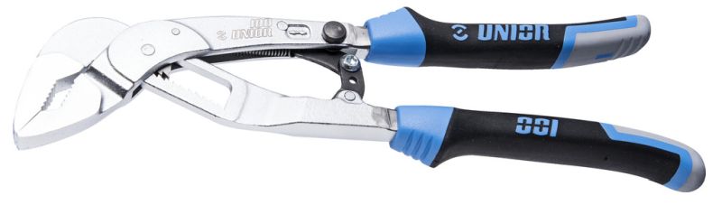

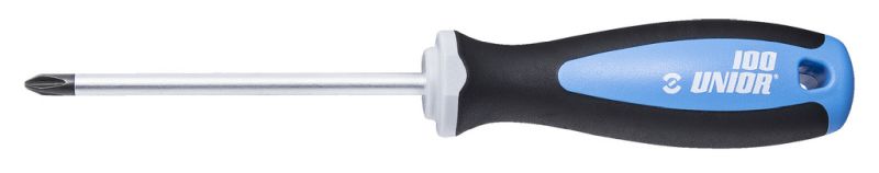

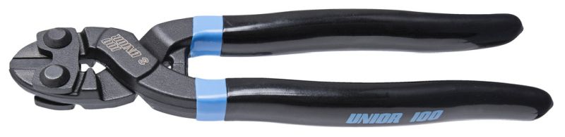

Some limited edition '100 year anniversary' tools and promo stuff from Unior.
https://uniortools.com/eng/category/946716/limited-edition-100-years
Not sure why the mannequins are not wearing and trousers :wtf:
Unior is another company selling tools with mystery COO. I have looked at some of their tools at my local tool store and couldn't find any COO info on the tools or packaging. They are said to make some tools in Slovenia where they are located but have read here that their 1/4" sockets and maybe other sizes are from Taiwan.
Really? Do you have a link to the thread? I thought they made pretty much everything at home in Slovenia. Their 1/2"-drive sockets are immensely strong. I’ve been amazed at the torque they have tolerated. Their special bicycle tools are also very, very good – clearly made of better steel than the Park Tool equivalents that I have owned. (But Park Tool items are often made in China nowadays, so perhaps that isn’t shocking.)
Not a lot to go off but noted while reading through old posts on this thread. Pretty sure 'Jure' was someone who had/has reliable info. Maybe it's just the 1/4" tools. :dunno:
https://www.garagejournal.com/forum/showpost.php?p=4331649&postcount=20496
Yeah I have a few of their spanners, and pliers found them stupidly cheap on amazon and the profile on their spanners is different and pliers seem nice quality as well.
No COO on anything either I thought the spanners might have had something.

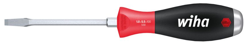

Just been on the Wiha website. Haven't noticed this slotted tip profile from before. Have they always looked like this or is it something new?
Dave455
Mar 19, 2013
5,871
Sussex, England
Wow! That's a traditional "flared tip". No, not something you generally see on modern drivers. I suspect the balance is very nice.
Usually, when a modern manufacturer re introduces an old pattern, they find that there were some very good reasons why that pattern evolved.
It's nice to be given a choice, and set of those would sit very well in my woodworking box, next to my Estwing "English Pattern" hammer - another fine product to which the same comments apply!
