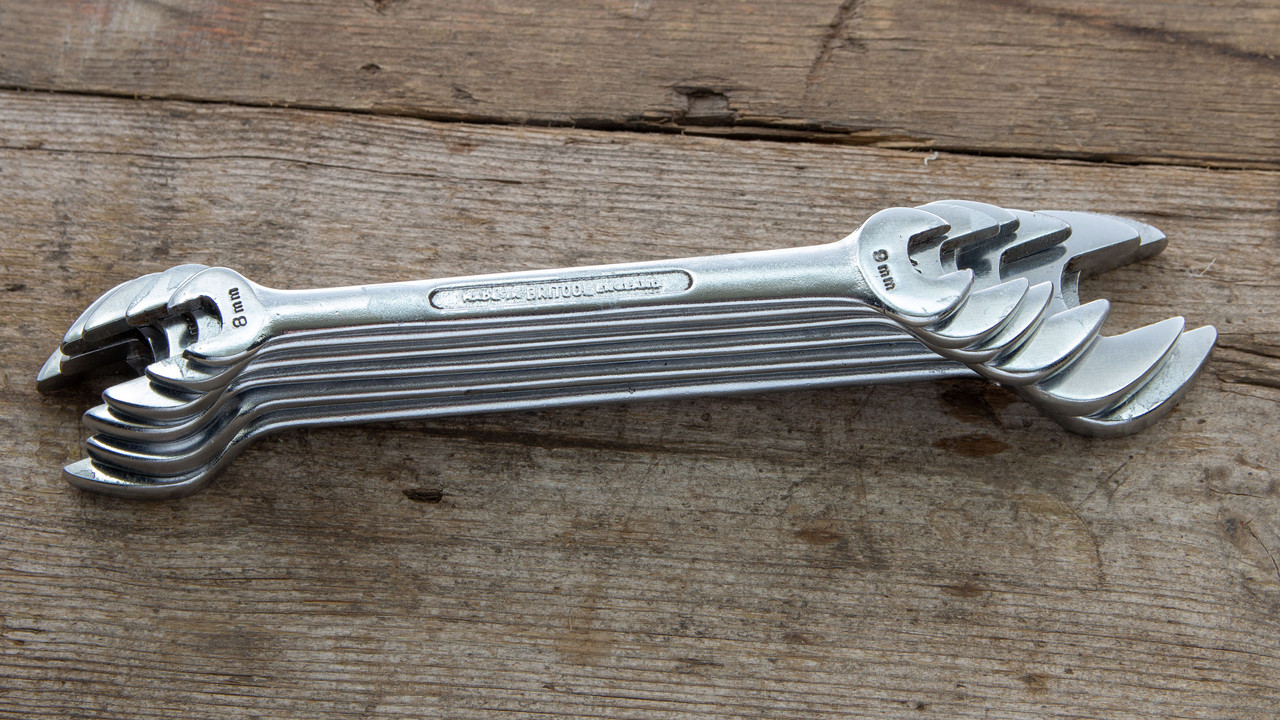

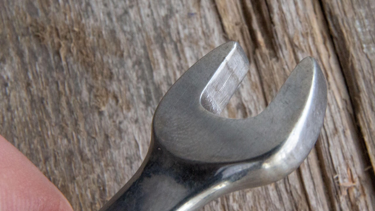

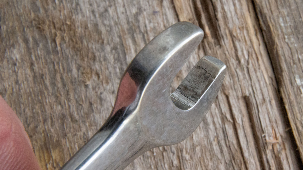

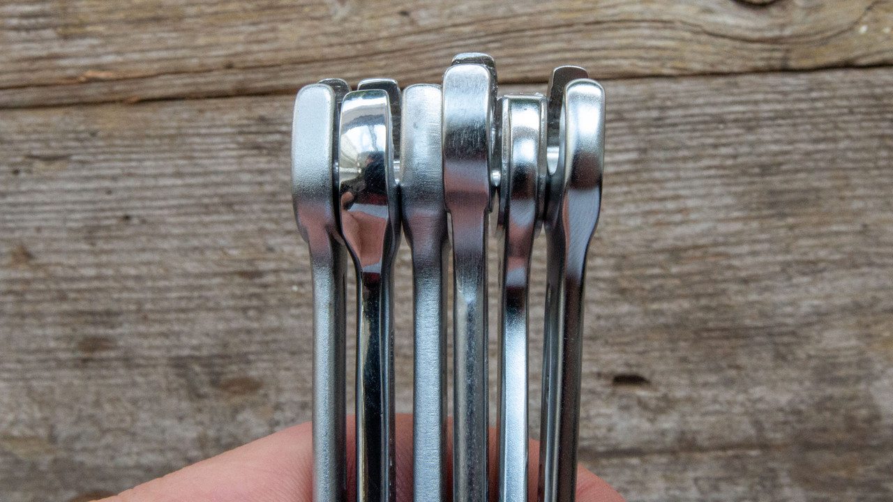

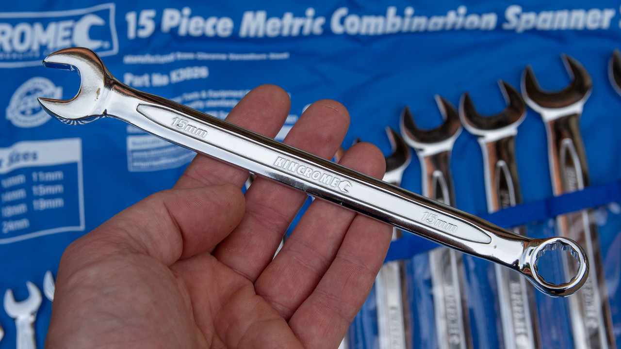

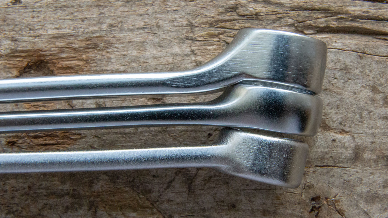

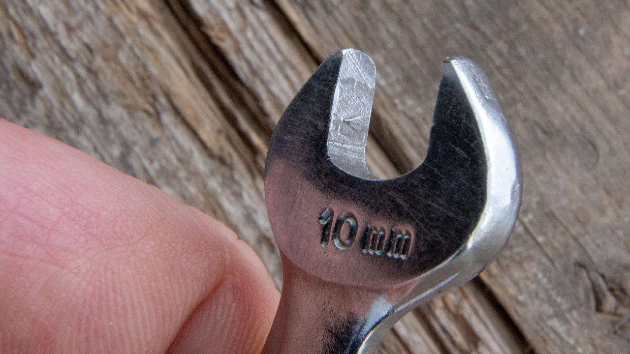

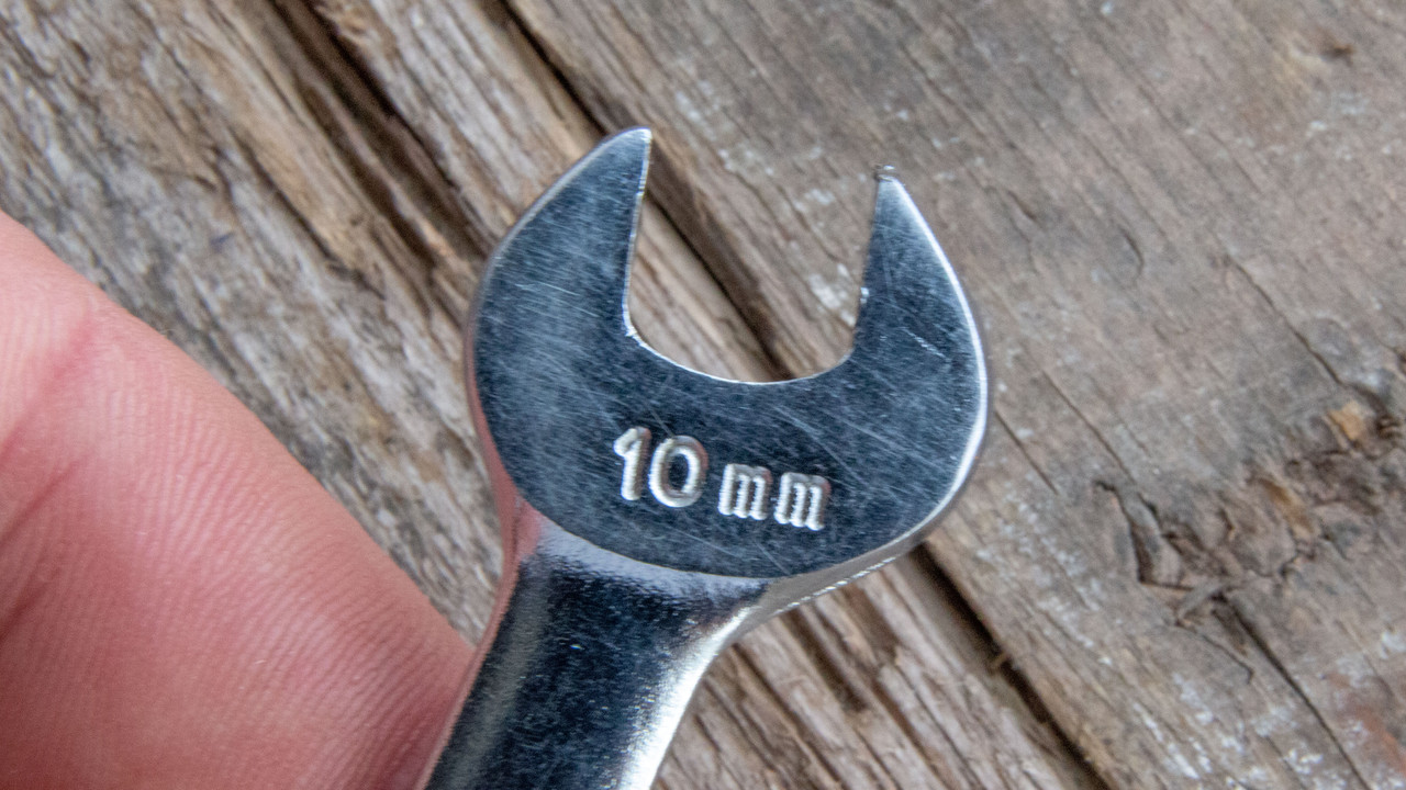

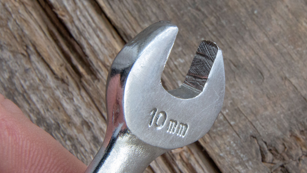

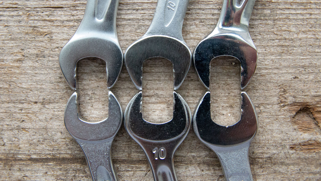

Played around with some 10mm spanners today to see how strong their open ends are.
Interesting test, commentary, and photos.
Would you be able to list the jaw thicknesses of the tested spanners? I wonder if that accounts for some of the differences.
mr.lemons
Oct 24, 2017
2,191
UK

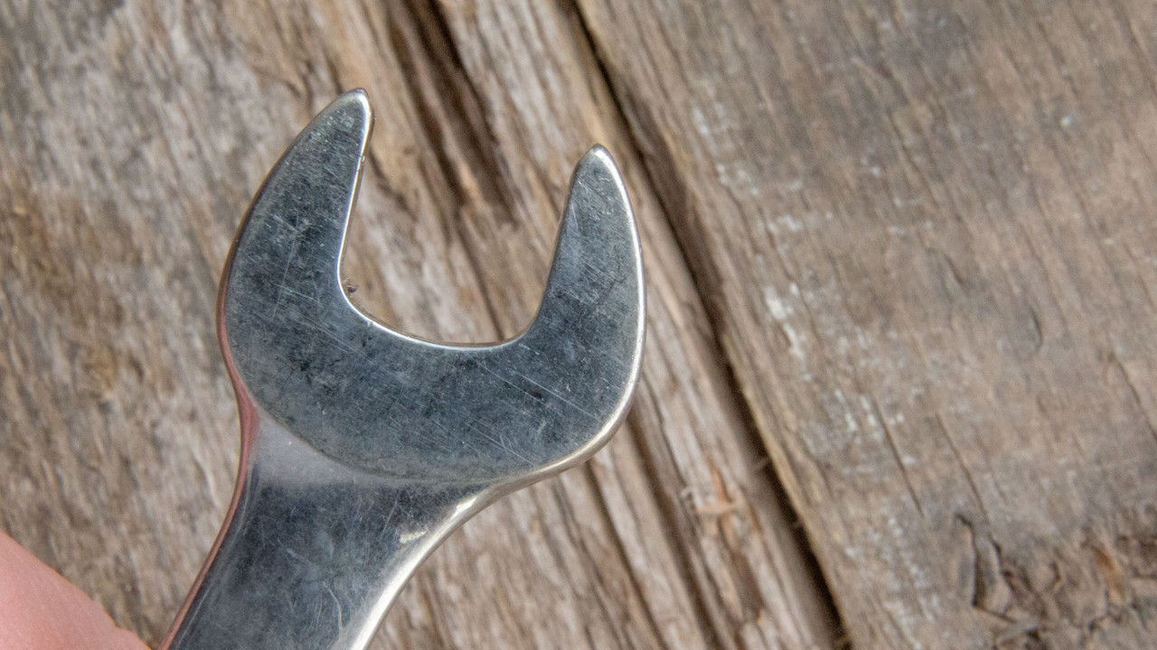

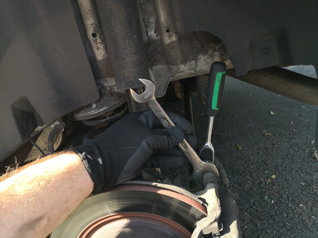

It was farm work (rusty fence brackets) I was struggling to dismantle with the Stahlwille 14. Had to use the open end as the brackets were up against a wall which was flush behind the fencing. Ended up cutting the brackets. Farm work is new to me and I'm sure someone more experienced would have gone straight to the cutting.
I can only go off the tools I have in my hands and unfortunately Stahlwille let me down this time. Yes it could be a one off bad example or from a bad batch. Hope it is really as I have a few Stahlwille tools now.

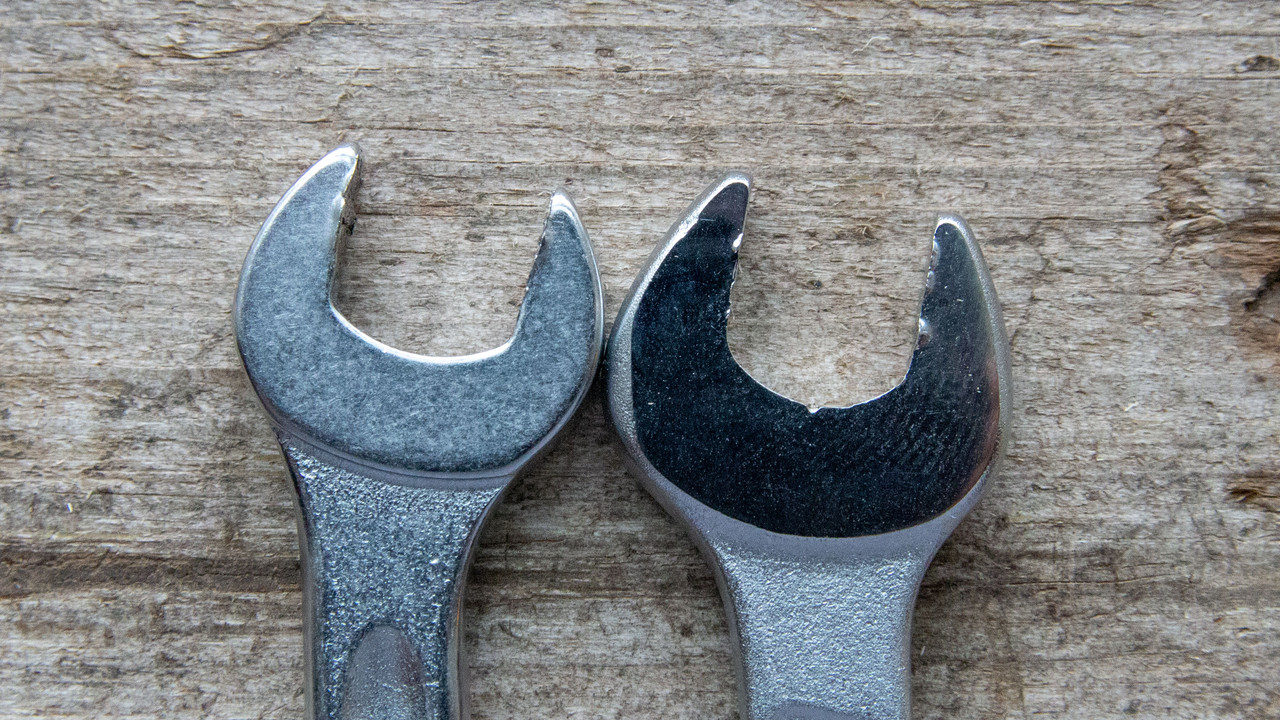

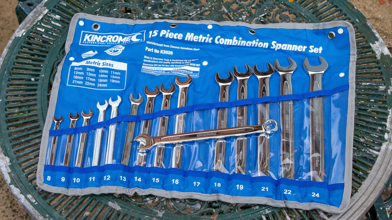

Very approximate measurements as the thickness is not uniform. Most taper towards the tips so first measurement is as the back of the open end and the second is nearer the tips.
Elora 4.80 4.68
Kincrome 5.86 5.54
Hazet 5.31 5.14
Stahlwille 5.32 5.30
Facom 5.23 5.23
Toptul 4.78 4.61
Also the width and shape of the jaws varies. Stahlwille (bottom left) are the narrowest.
Stahlwille next to Hazet.

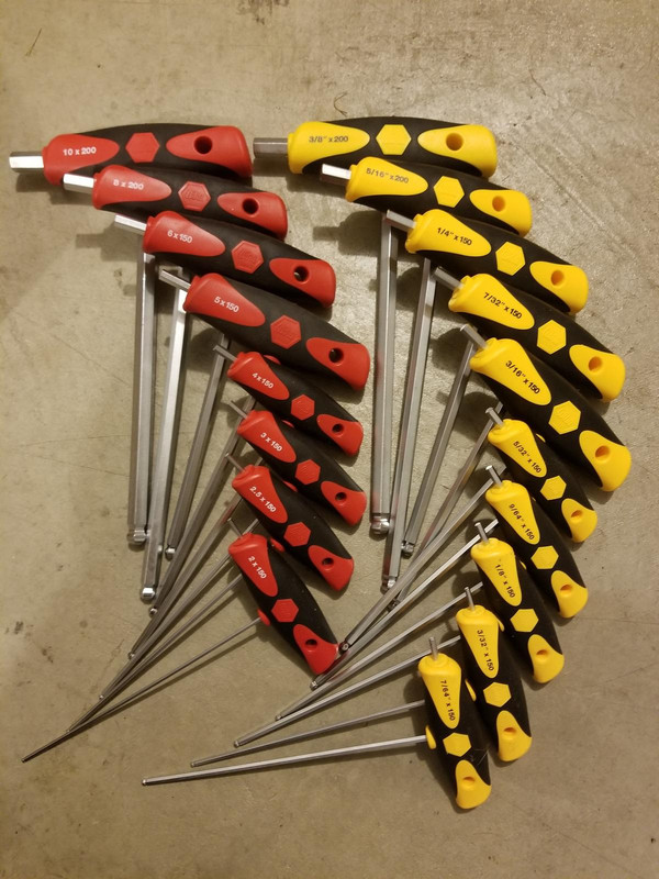

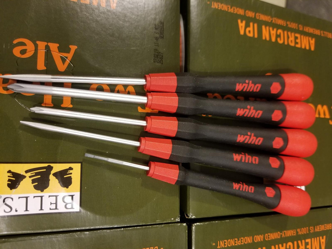

Been wanting a set of t-handles for a long time.
My first impression is I prefer the standard type over the pico finish.

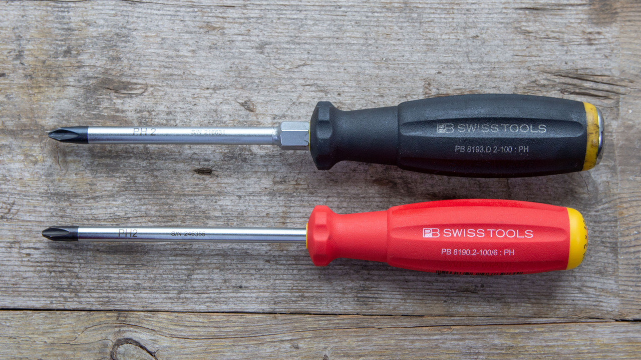

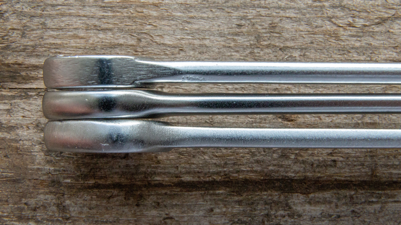

I don't know if they have altered the sizing at any point. These are both PH2. Heavy duty has longer/thicker handle and thicker shank. Similar differences in PH1 also.
The end caps on the black handles have changed over time. Plain caps, stamped caps then laser etched. The slotted in the pics have laser etched caps.
You were right, I never noticed that. The Phillips handles are a little oversized, where as the Slotted have the same handle size but shorter shanks.

^ Yes, not much in it. Only noticed when I put them side to side for pics.

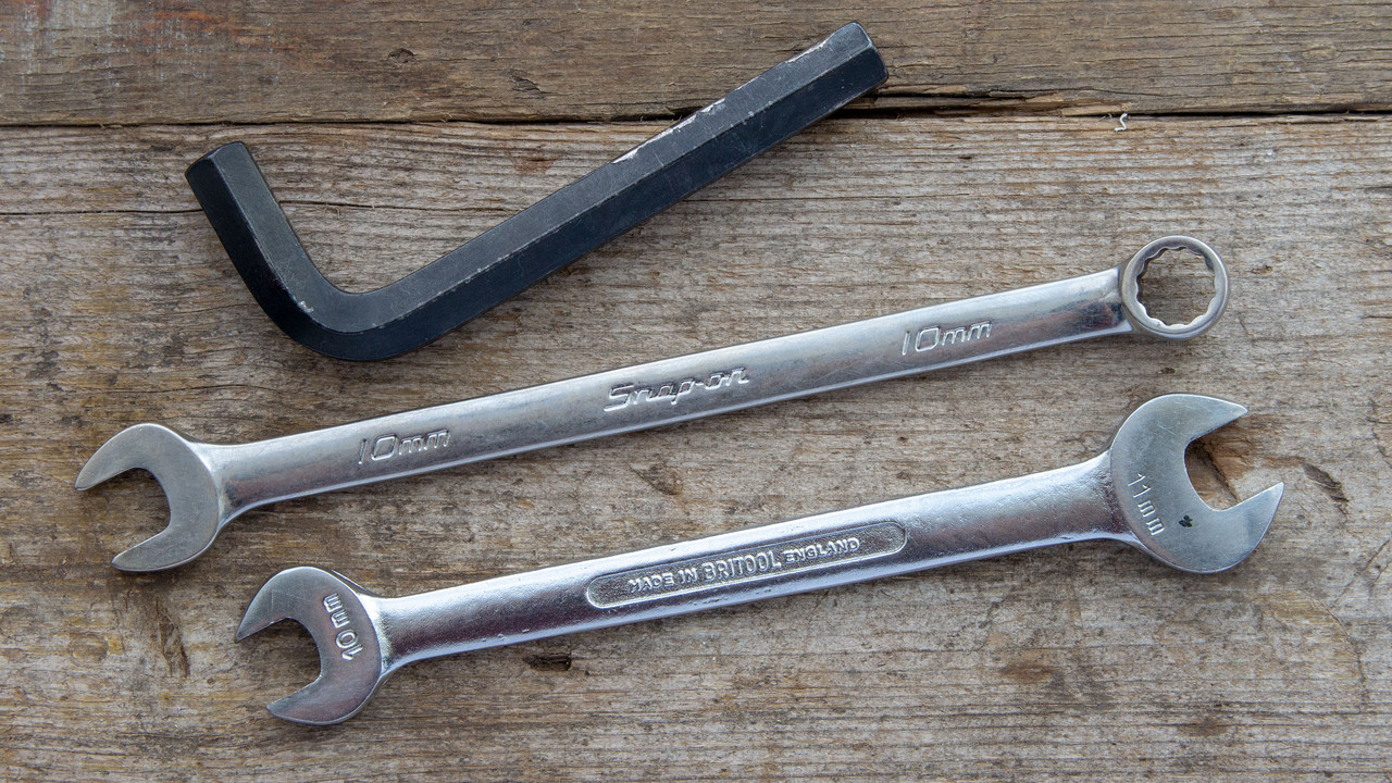

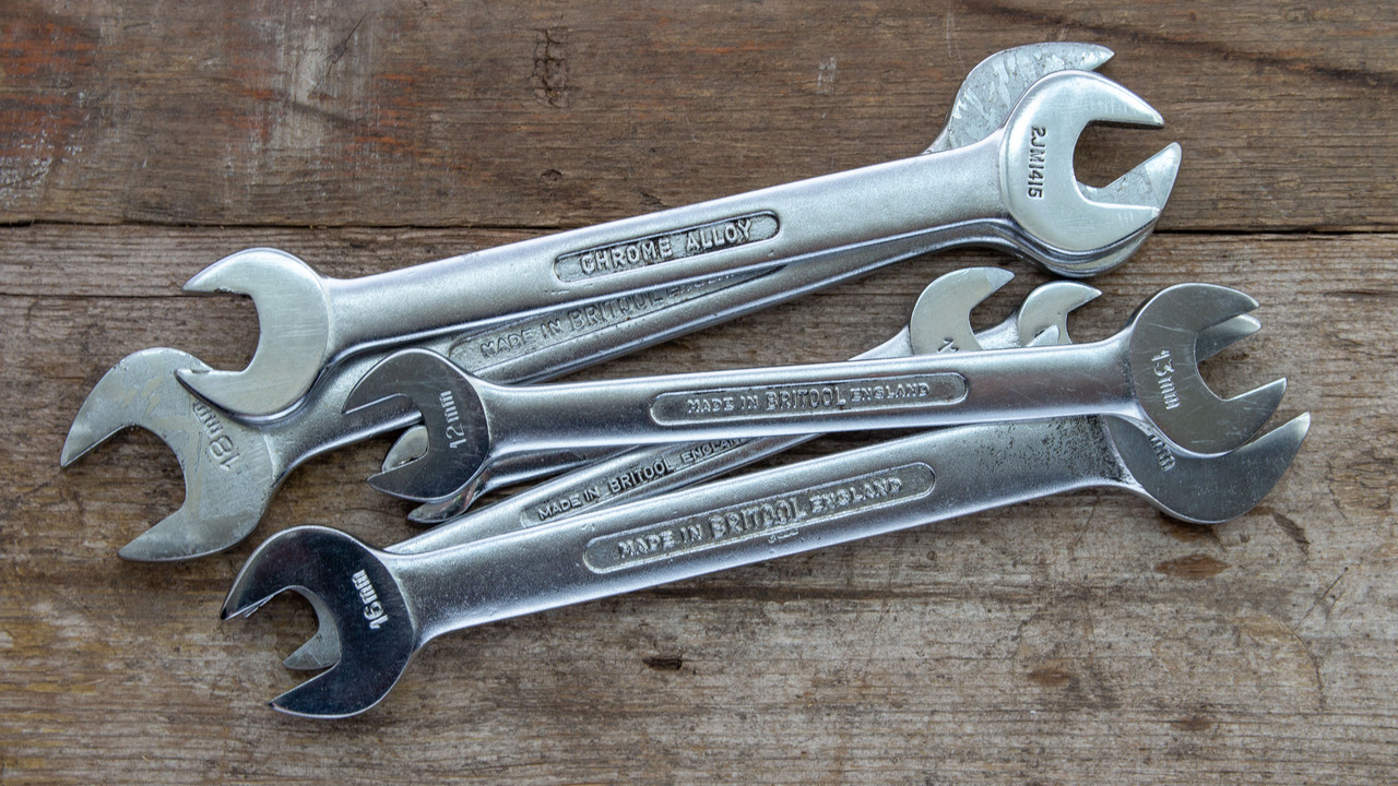

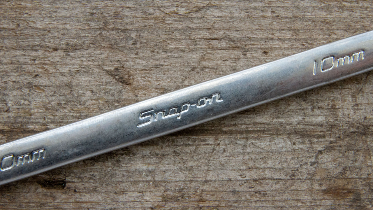

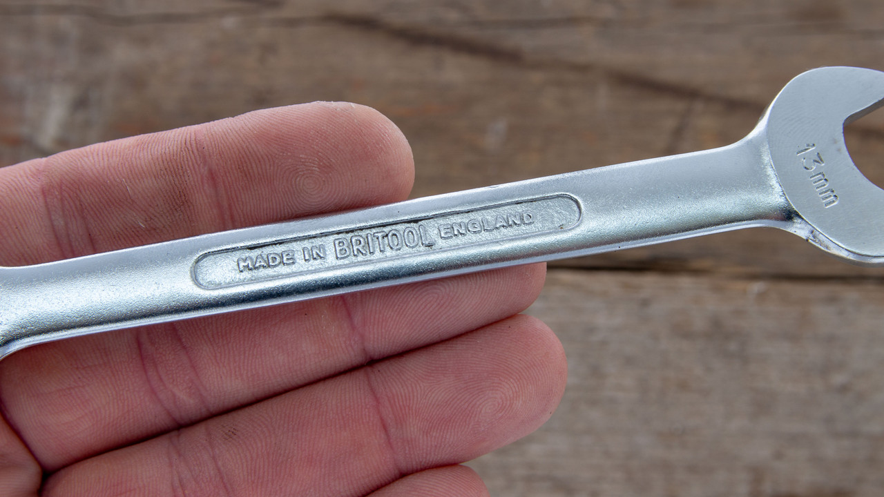

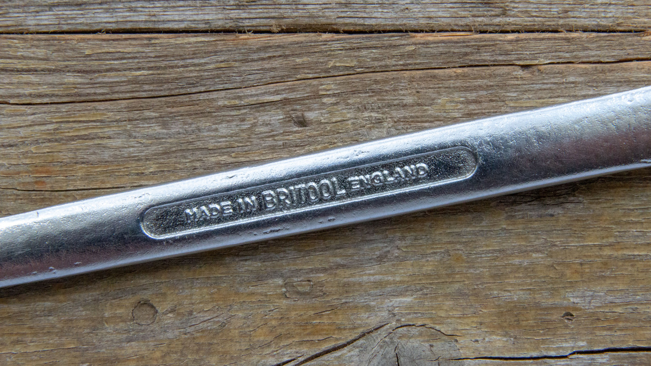

A couple of late arrivals that I wanted to try. Don't worry this is the end of this questionable testing. :)
Snap on 10mm combination and Britool open 10+11mm. Both were purchased used. The Britool is vintage, not sure about the Snap on.
The Snap on open end slips off quite easily with a bare hand. About the same as the Elora and Stahlwille. Was surprised that the Snap on sustained very little damage. Elastic rather than soft :headscrat. The Britool did not slip even when wearing a glove but did sustain some damage.
Snap on.
Britool.

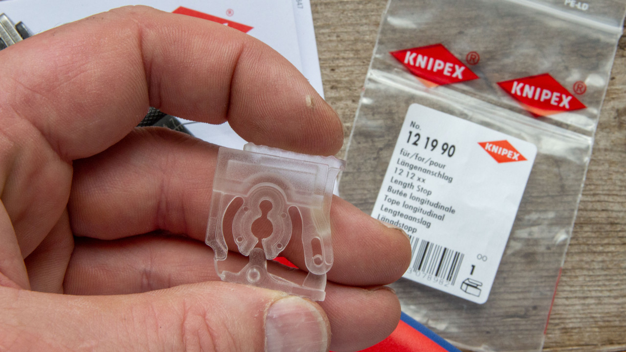

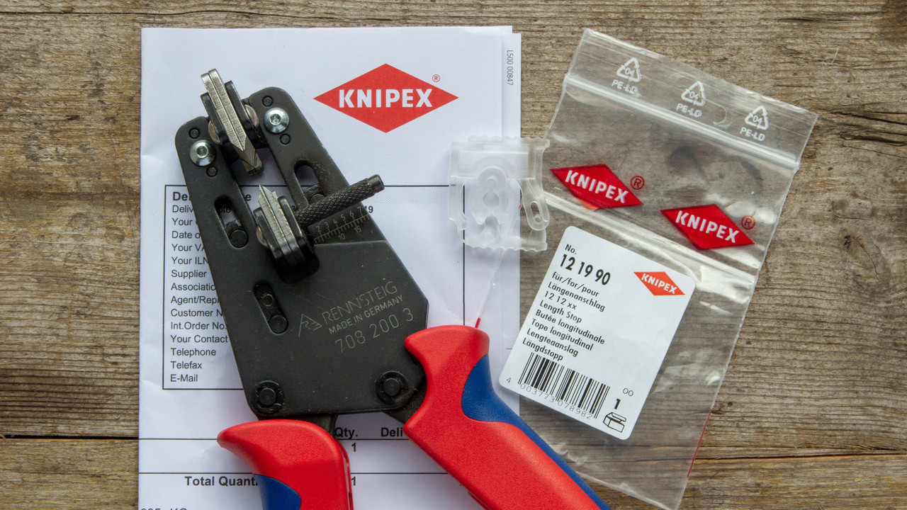

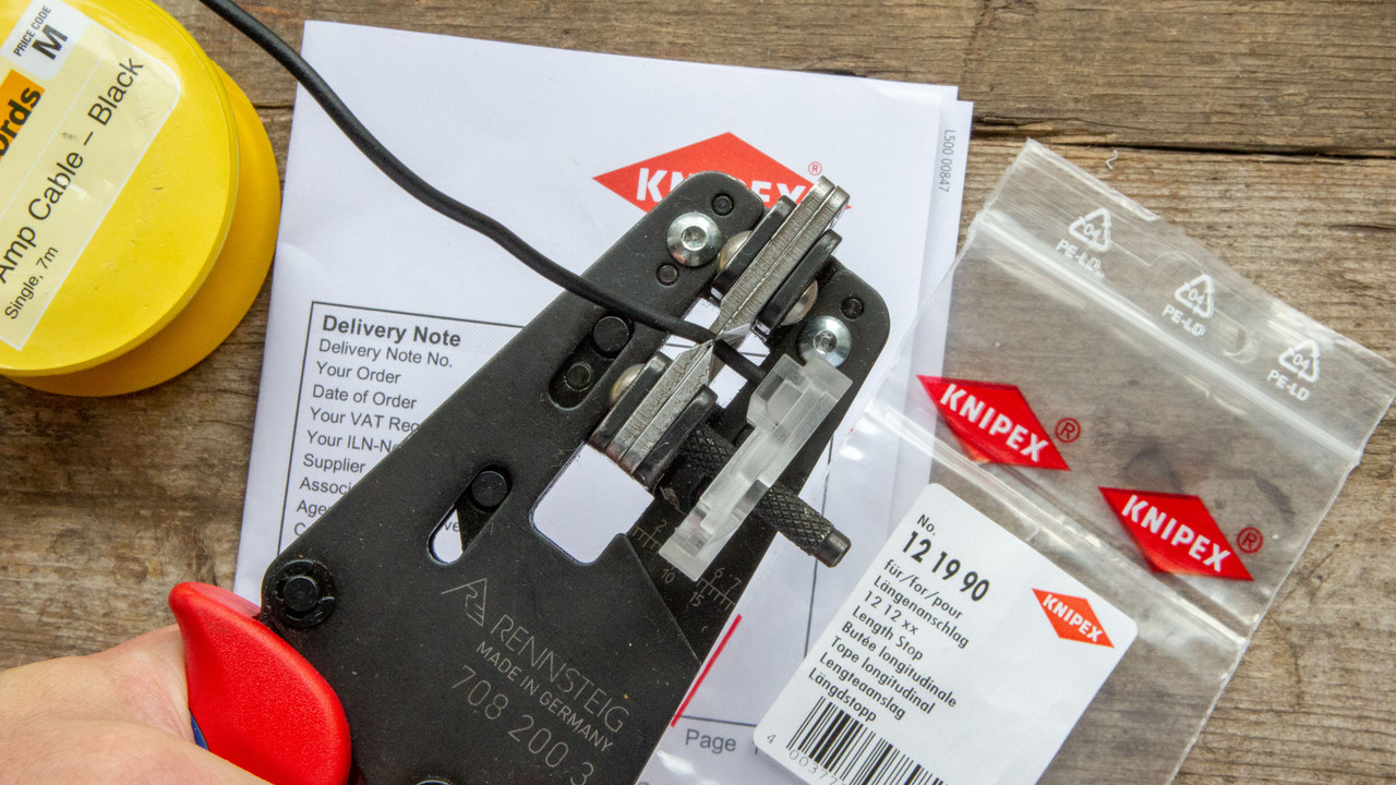

Posted previously about purchasing a pair of used Rennsteig wire strippers which had a missing plastic part (length stop). I emailed Rennsteig and Knipex enquiring if I could purchase the part separately. Rennsteig have not replied but Knipex got straight back to me and said they would send the part out FOC. Two weeks later I received the part. Squeezing the 'length stop' opens up the central hole so is can be moved along the knurled rod and used as a guide to strip equal lengths. Great service from Knipex. :bowdown::thumbup:
JBH
Jan 17, 2018
812
But German tool companies have crappy customer service, remember?
Seriously, impressive that someone from Knipex would go to the effort of finding a spare part and posting it, for a tool that technically wasn’t even theirs. I assume that Knipex and Rennsteig subsidiaries in the U.K. are different companies; they are in the US.
mr.lemons
Oct 24, 2017
2,191
UK
I used the contact form on the Knipex website so the part and service came from Knipex Germany.

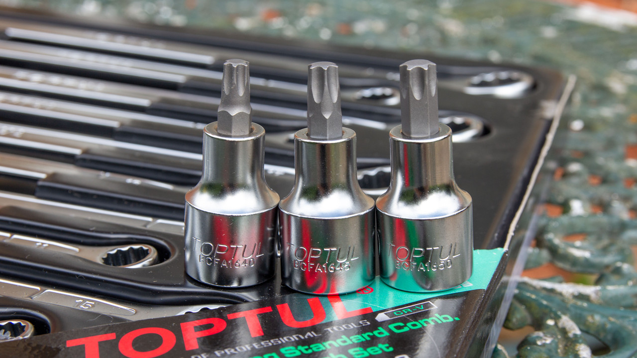

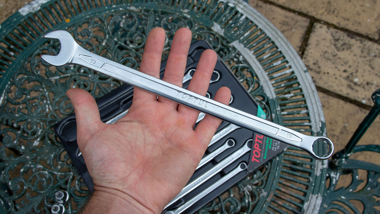

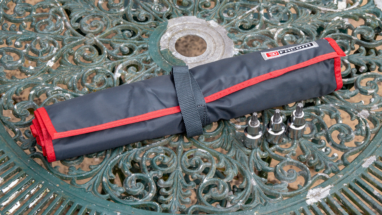

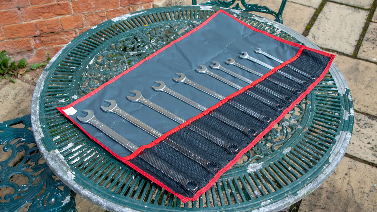

Toptul GAAF1008 extra long spanners. 10-19mm. Interested to find out if they can be used as my main set or if they are too long for general use. No COO on the spanners or packaging. I believe they are made in Taiwan.
Fit well in a Facom N.38A-12B tool roll.

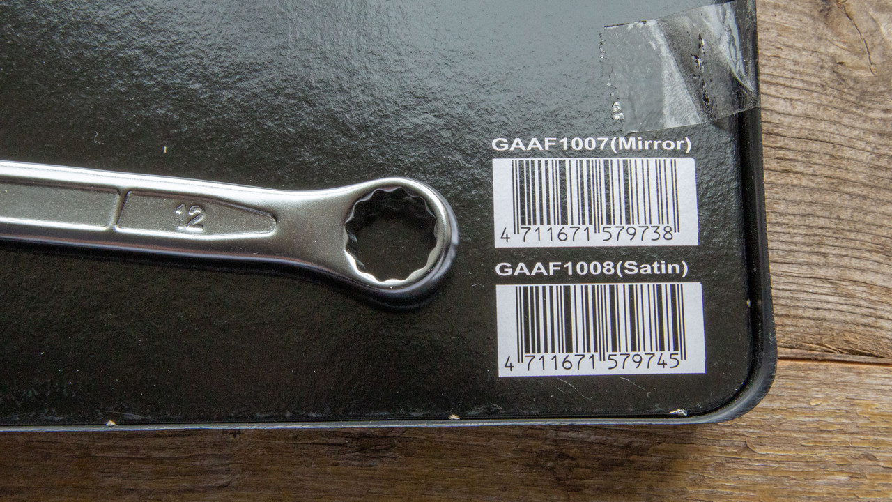

Info on the packaging suggests that the set is available in satin or mirror finish. I've seen mention of a choice of two finishes with other Toptul tools but haven't seen any of the 'mirror' finish available.
Also picked up T40 T45 T50 1/2" bit sockets.
I find it interesting that the Toptul tools I've seen look to take influence from European tool design rather than US. The long spanners look very much like stretched Elora 205s.

Tried the xl Toptul spanners today on a job that didn't require extra reach or extra torque. For me they are too long for general use. Smaller sizes are ok but the larger sizes knock into everything and feel unwieldy.
Quickly reverted back to shorter tools.

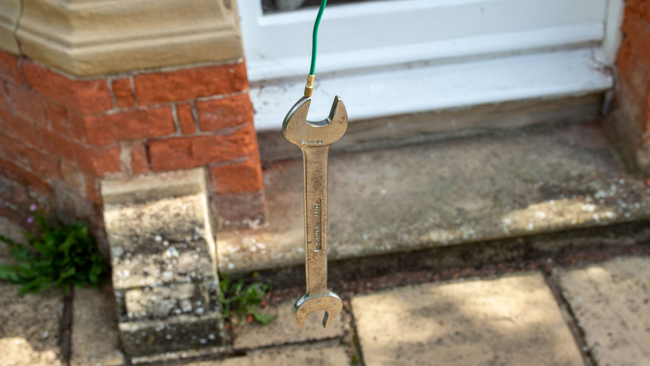

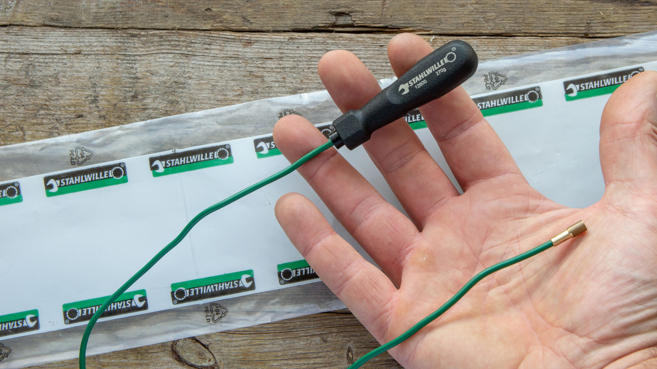

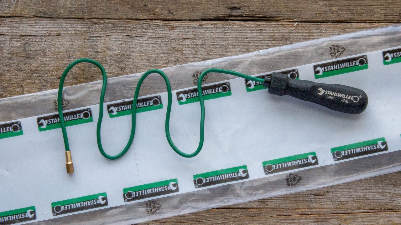

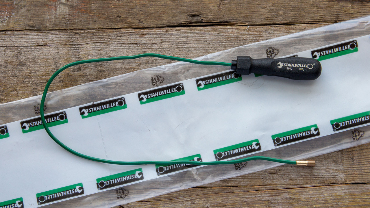

Stahlwille STW126005 Flexible Magnetic Lifter 500mm
Feels a bit cheap and gets mixed reviews regarding durability on Amazon but seems like it will be functional enough.
Wire stays in whatever shape you bend it.
'Made in Germany' on the packaging. No COO on the tool.
Small magnet can hold a 19mm spanner.
Compiled a metric set of used Britool open end spanners from Ebay. Bit rough around the edges but cheaper that a new Taiwan or German set.

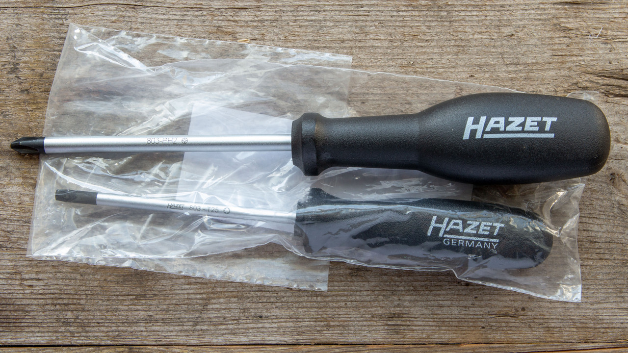

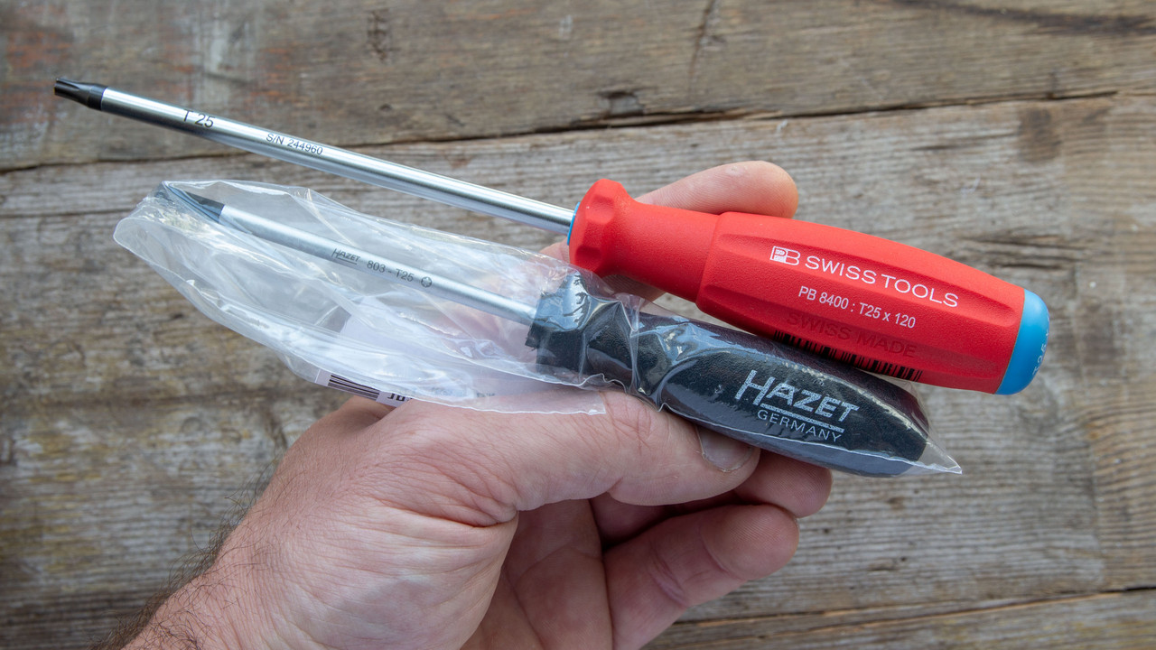

Hazet 803-T25 torx driver.
My fault for not checking the specs but disappointed with the small size of this. Expected the handle to be the same size at the PH2 handle from the same range.
Compared to Hazet PH2
Compared to PB T25.
I'm a fan of the Elora magnetic pickup tool, which can supposedly pick up 1.8kg. it has made in Germany cast in the plastic of the handle. Here I'm testing it successfully with an Elora 1.25kg hammer, which I believe is made by Osca.

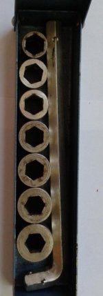

Hi, guys!
I recently bought two little socket sets. The Britool seen at the pictures, cost me around 3 euros and 30 cents, while Orenco cost me around 2 and a half euros. It was really cheap.
Orenco has sizes 10 to 17 (missing 11). Britool, also miss one socket, and beside regular sizes (like 11), it has some odd sizes (like 22.5).
I know that Britool made some really quality tools in the past, and although I am not very familiar with Orenco it seems they were also good.
Can some one tell me something more about these sets. How old are they?
At the end, are they worth keeping? I already have a lot of tools so I am thinking whether to keep them, or to give them away to some of my friends...

Dave455
Mar 19, 2013
5,868
Sussex, England
Britool did produce some very good quality tools in the past (probably the British equivalent of Snap On) sadly now they are jut a name, owned by Stanley, and put on Far Eastern made tools.
The Britool set you show is fairly old, it predates me for sure, and I’m thinking it probably dates from the 1950’s.
As you probably noticed, it’s hex drive. The original Britool sockets were hex drive, but they continued making hex drive tools long after they had introduced square drive, so you can’t date the tools from that alone. The logo style, the finish (both tools and box), ‘British Made’ instead of ‘Made in England’ and the typeface all scream 1950’s to me.
These tools would probably have been produced for export. Metric tools were very rare in the U.K. in the 50’s!
Still probably perfectly usable, and you can probably pick up other handles in hex drive for relatively little money!
Edit - I should have added that the sockets in the Britool set are not the standard sockets. They seem to be a ‘short’ pattern that I only generally see in these small sets. I see these sets used quite often in the U.K. usually in Whitworth sizes. They don’t generally fetch much money, considering the quality, but you got a really good deal for €3.30!
willehaz
Dec 8, 2018
22
city
Thanks Dave! All the info you gave me is really valuable!
By the way, it can not be seen at the photos, but sockets are marked this way:
22.5mm -british BRITOOL made- 7/8 A/F
19mm -british BRITOOL made- 3/4 A/F
16mm -british BRITOOL made- 5/8 A/F
14.5mm -british BRITOOL made- 9/16 A/F
11mm -british BRITOOL made- 7/16 A/F
They have values in both, metric and A/F. Maybe this additionally helps you to determine the age of the set...
