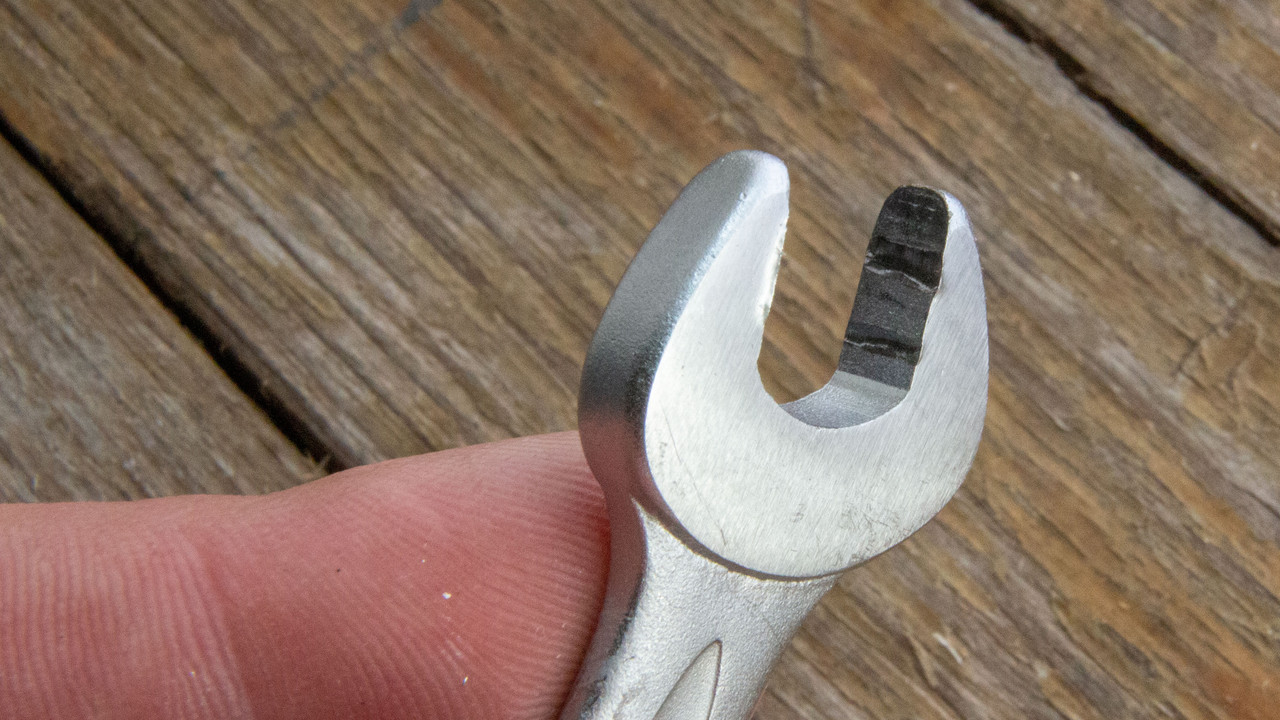

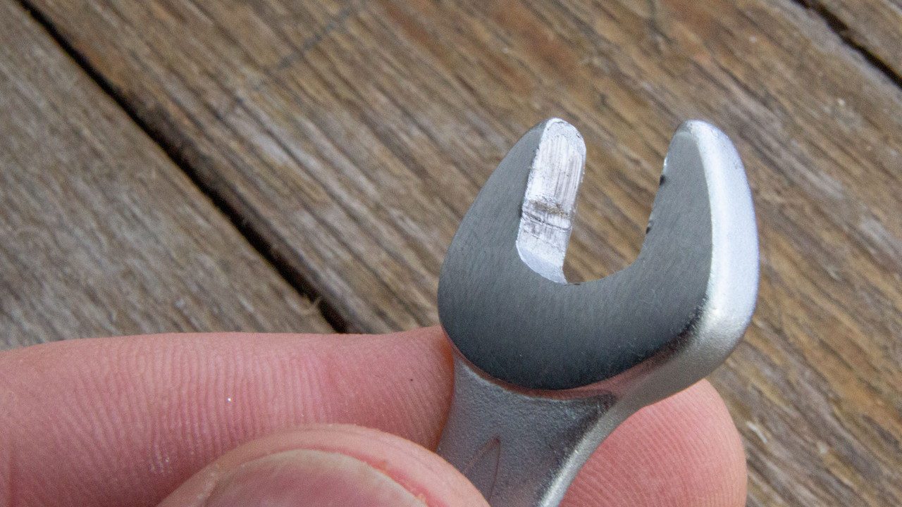

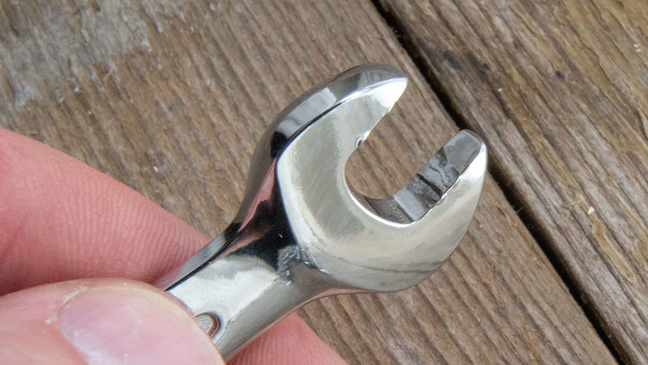

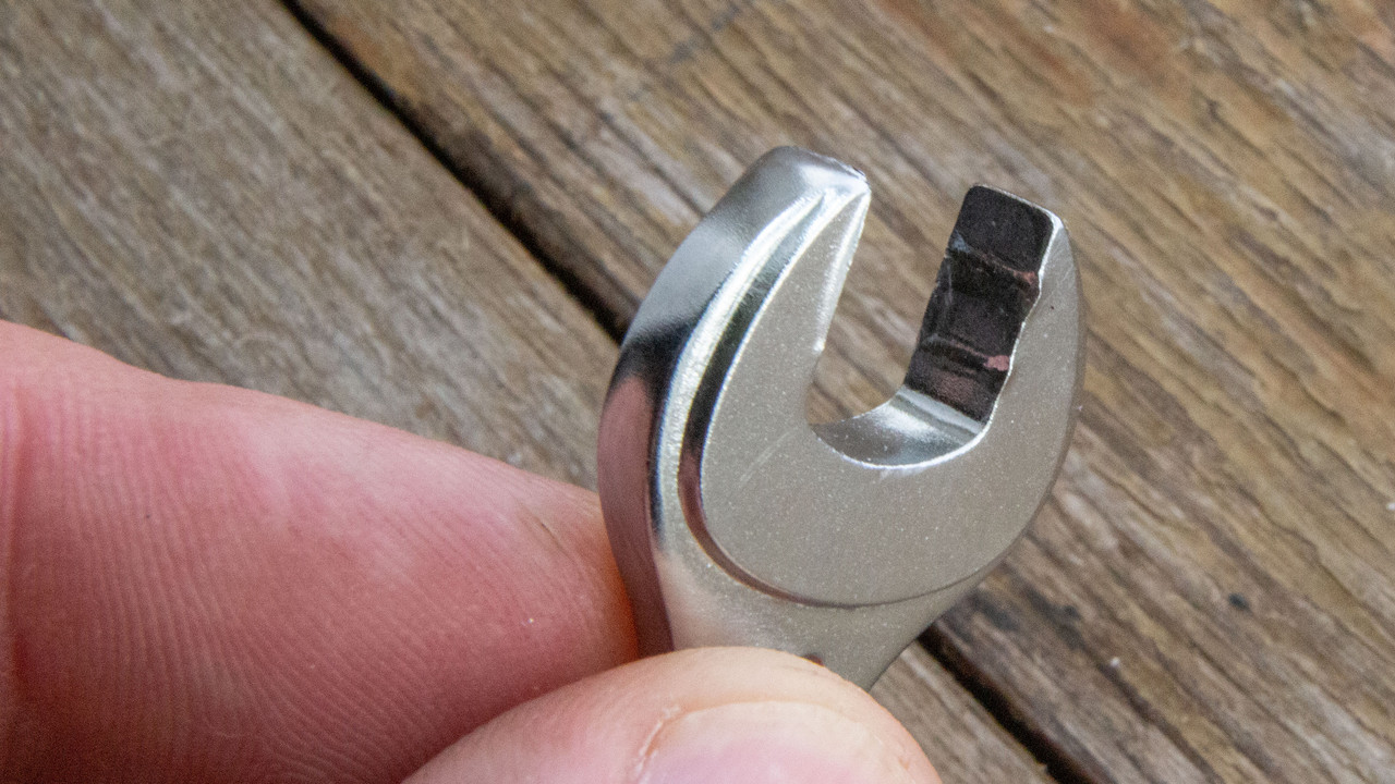

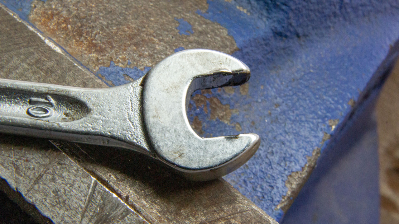

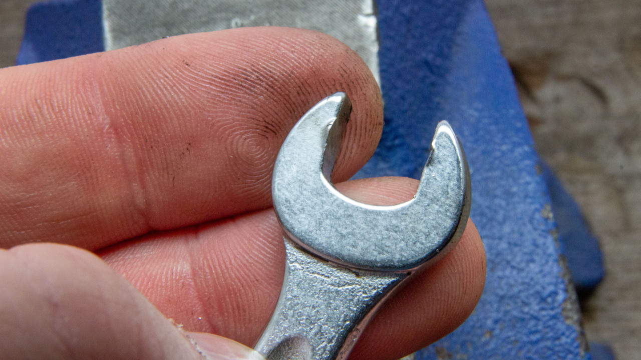

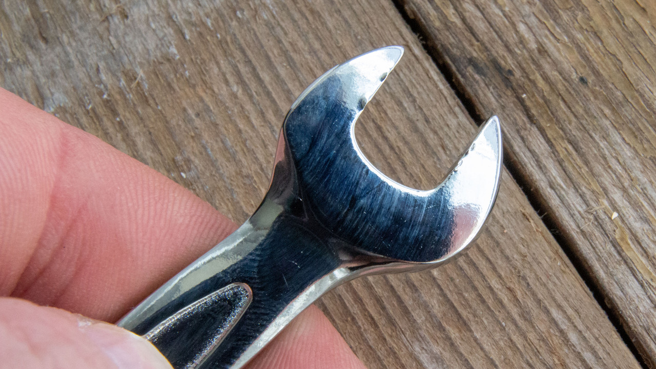

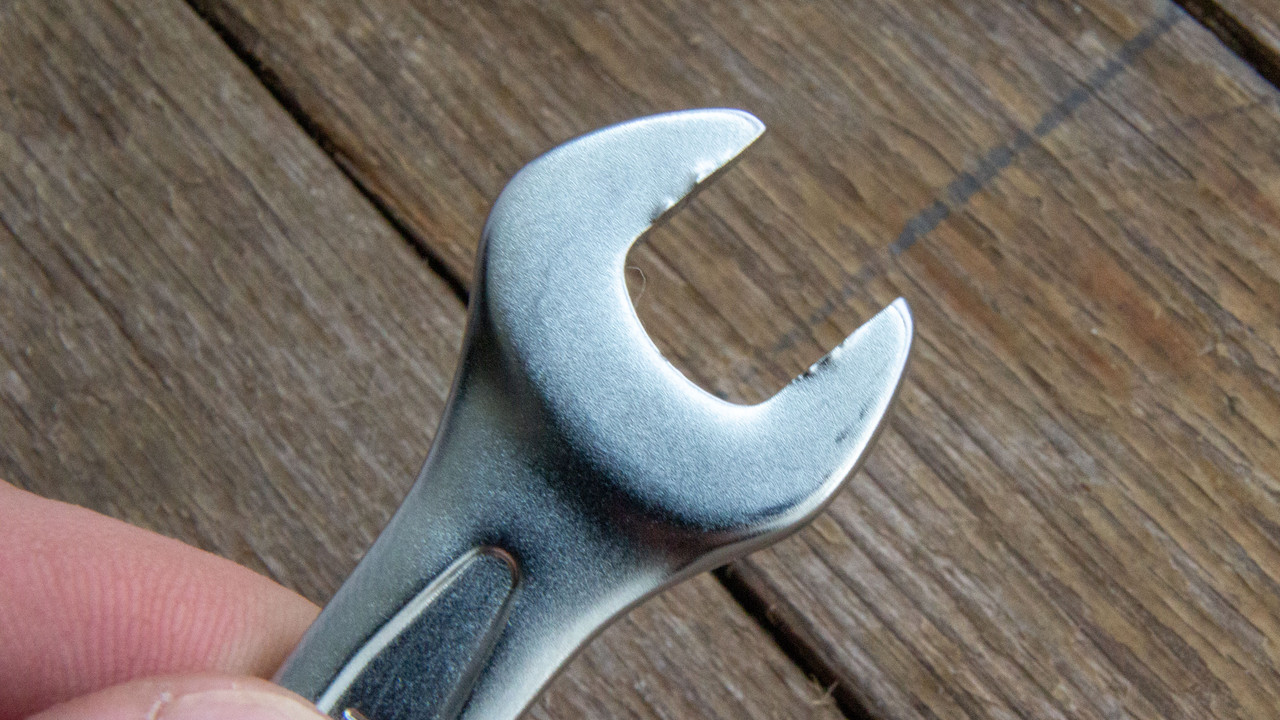

Hazet 600LG will still deform under load they feel a little soft, TopTul I haven't really put that much stress on the open end, but they do flex on the ring end.
I'm maybe expecting too much. Don't often put much torque on the open end but needed to today and struggled with the Stahlwille. Will be fun to compare even if I don't find anything better. :)

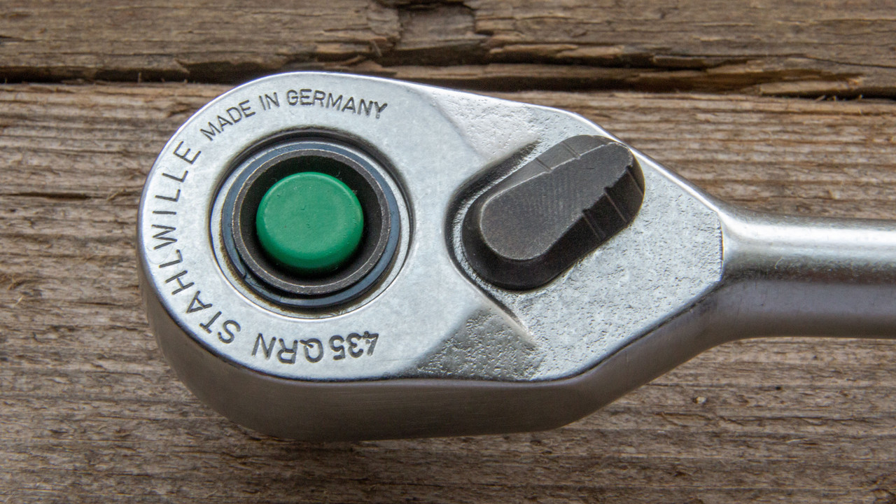

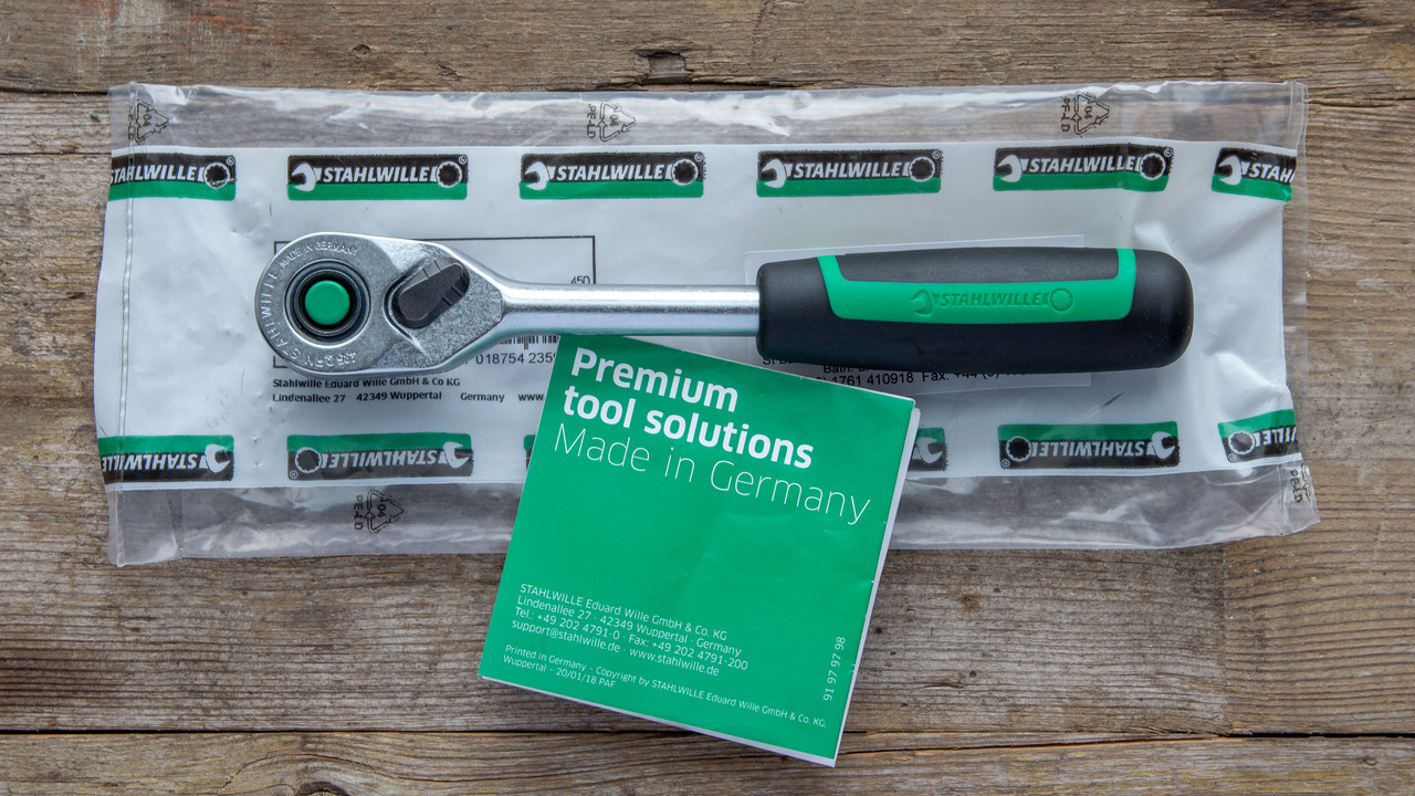

Replaced the Matador ratchet with a less interesting but hopefully more reliable Stahlwille 435QR N. Happy to report quite low back drag for an 80 tooth ratchet. I think it feels very similar to the Matador in this respect but it's hard to say when not comparing side by side. On a parr with Gedore 60 tooth and certainly less back drag than Facom 72 tooth pearheads which are my benchmark as I've used them the most. I've read some comments on this thread saying there is nearly zero back drag on these ratchets. I would not really agree with this (going off my ratchet only). I really need to try Ko-Ken to get more perspective.
Typical Stahlwille slightly lumpy/bumpy satin chrome finish (not a complaint, I like it) and quite soft comfortable oval profile rubber handle. Anyone had durability issues with Stahlwille rubber grips?

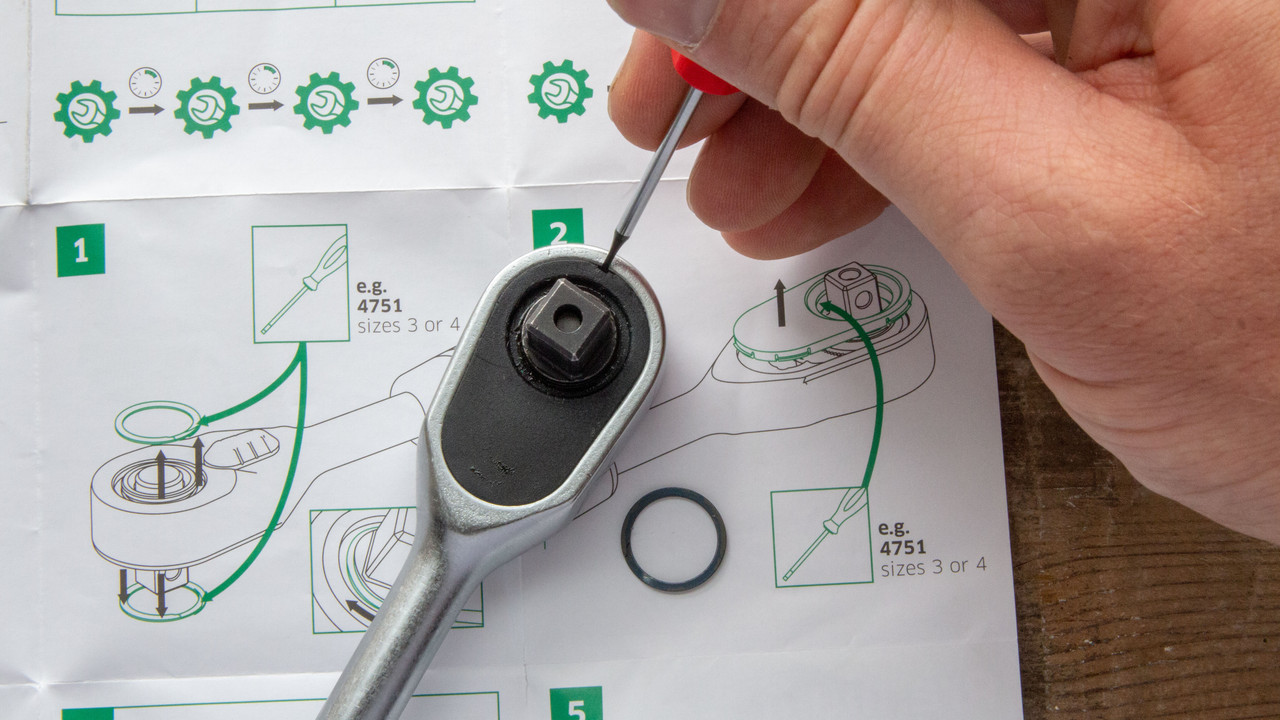

The ratchet comes with instructions on how to replace the internal parts. There is also an official instruction vid on youtube. Despite this I still haven't found a way to open these without marring the plastic cover and it looks like the repair kit does not include a replacement. Wish they made a non FOD fine tooth version.
Printed instructions show prying from under the removed split ring but this method did not work for me.
Youtube vid shows prying at the top which leaves pry marks in the soft plastic.
Inside.
Those marks look like what you get when you use an open end at a high angle because you can't get down flat on the nut and the load is all on the corner of the jaw as it goes over the corner of the nut, most makes of spanners will do that, or they have been double spannered. They don't look to have spread at all which is good.

No misuse, just eat too much spinach I guess. I've ordered a couple of similar length spanners to compare.

Replaced the Matador ratchet with a less interesting but hopefully more reliable Stahlwille 435QR N. Happy to report quite low back drag for an 80 tooth ratchet...I've read some comments on this thread saying there is nearly zero back drag on these ratchets. I would not really agree with this (going off my ratchet only). I really need to try Ko-Ken to get more perspective.
Definitely agree with you and disagree with the "nearly zero back drag." I think you're about right. In 1/4" drive I'd say roughly the same as 90T Nepros, a little better than 72T Facom, a lot better than Snapon Dual72 or Gearwrench 2*60XP, a little worse than Proto 24T, and a lot worse than Koken/Zeal.
Yes to the last point. :)

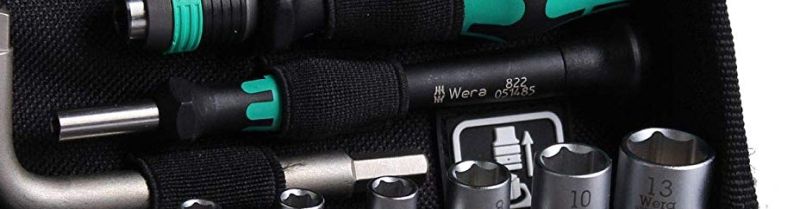

Is that the magnetic precision driver that was previously only sold in an Advent calendar set? A lot of folks wanted one. I would like to see it as a regular production item.
I would definitely buy one if offered separately. Wera, what's the holdup?

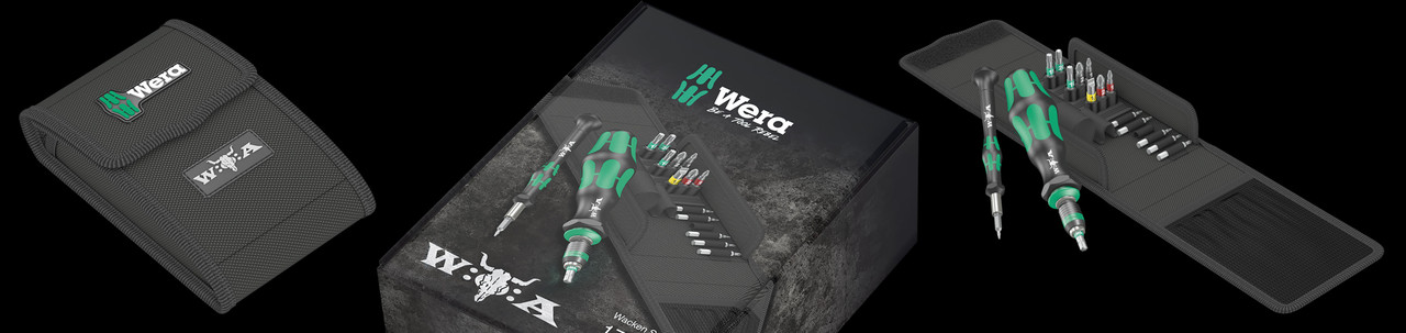

For fans of German rock music and Wera tools.
W:O:A - Toolkit - Wera x Wacken
https://www.metaltix.com/w-o-a-toolkit-wera-x-wacken-merchandise-51567.html#tour51567
It's 61EUR for me including shipipng. That's a bit steep for me, but that's a seriously cool set.
According to the description, that is the magnetic micro driver.

I'm also in for one of the Wera magnetic precision drivers if they make them available for separate purchase.

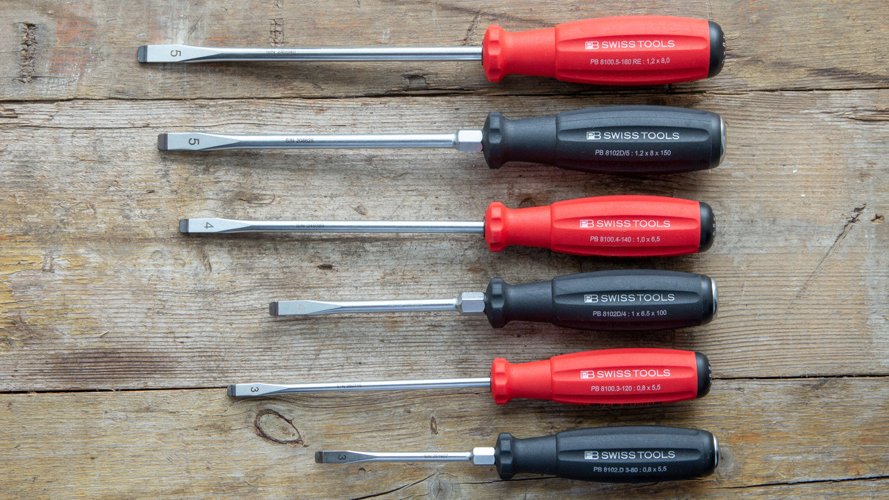

PB Swiss slotted.
I posted a while ago that the Phillips black heavy duty drivers have larger handles and thicker shanks than the corresponding standard red SwissGrip drivers. Not the case with slotted as they don't have larger handles or thicker shanks compared to the standard versions. They do however have shorter shanks.

I have the Pb Swiss heavy duty drivers and I’m pretty sure they are the same size as the regular screwdrivers. Maybe I got new stock? Or old stock? Idk I’ll post up pictures later.
mr.lemons
Oct 24, 2017
2,191
UK
I don't know if they have altered the sizing at any point. These are both PH2. Heavy duty has longer/thicker handle and thicker shank. Similar differences in PH1 also.
The end caps on the black handles have changed over time. Plain caps, stamped caps then laser etched. The slotted in the pics have laser etched caps.

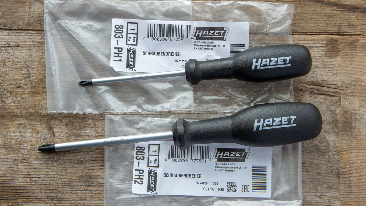

Hazet 803-PH1 + 803-PH2. Textured hard plastic handles. Already have these in Pozi for home use and Torx used at work. The torx handles and tips show very little wear after about 18 months daily use. No COO on the packaging or drivers. I assume that they are Oplast but not sure. :dunno:

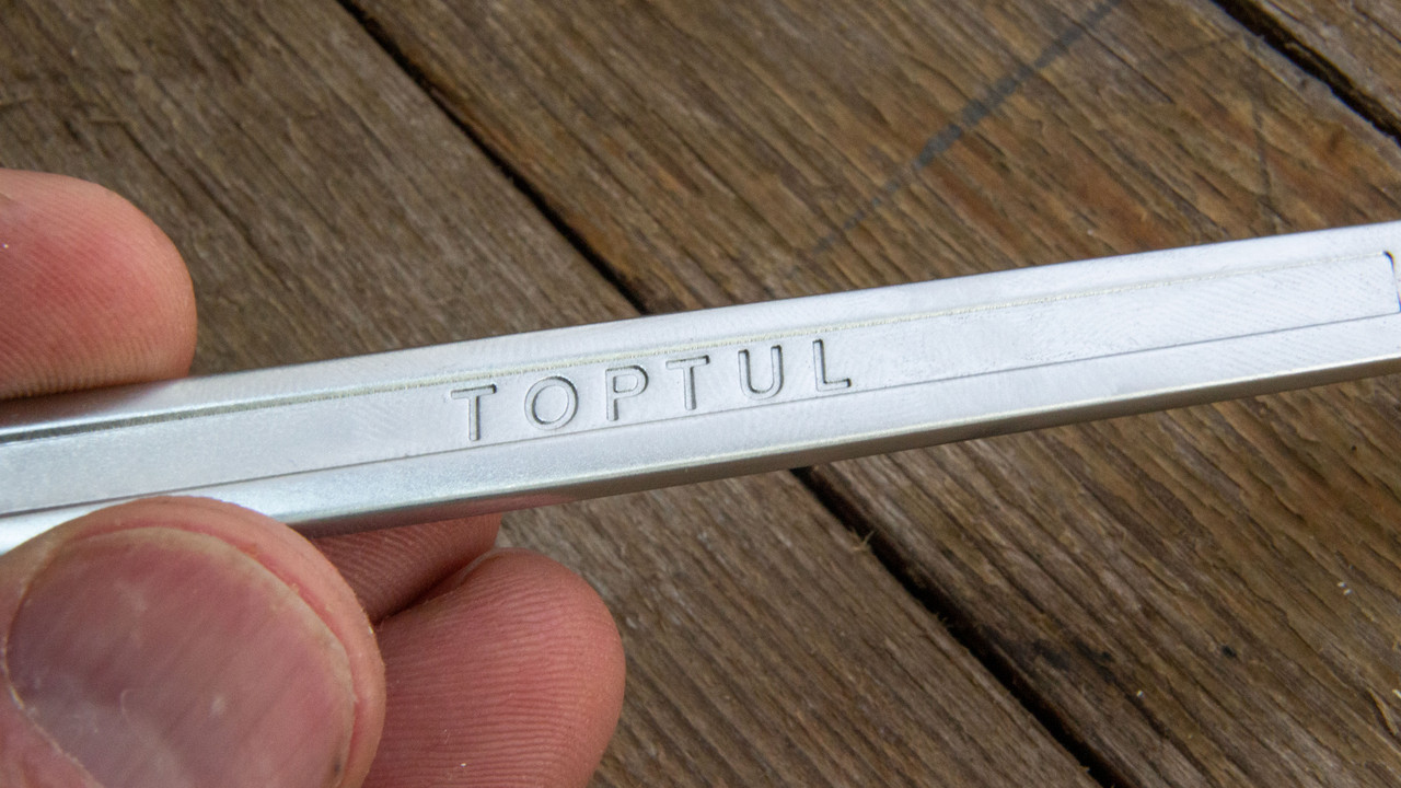

Is that a non-recommendation (sorry words failing me) for the long Toptuls? Does the flex in the box end seam worse than other spanners?
These are made in Slovenia by Oplast like the Gedore ones.
If you don’t see Made in Germany then is not!
According to their catalogue and several other websites, the Torx and security Torx Trinamic drivers are made in Germany, while the Phillips, slotted, and Pozidrive Trinamic drivers are made in Slovenia, which is where Oplast is. Seems odd to have the same style of screwdriver made in two different places. Maybe it's due to tooling requirements for the tips.

I picked up mine for £30-35 can't remember the exact price, for that price I really do recommend you won't be disappointed, the flex is under a lot of stress and for the price I paid its fine, they don't feel as if their going to break nor do they take the form so yeah if you can find them cheap enough I would buy.
My Hazet ones feel a lot stronger but cost 3x as much, the only other long spanners I have felt flex are Sealey long combination spanners the jaws open up on those..
Compared to the Hazet 600LG the toptul are a tad shorter, thinner, but a nice finish and mine came in a over sized plastic tray.
I constantly see Toptul been around £80-120
Hazet 600LG/10 - £100-150 I would go with Hazet any day.

I've been using Stahlwille 14 spanners for a while now and have found that the open ends spread and deform quite easily. Not sure if it's because I'm not used to the extra length and therefore extra leverage or if they are a bit soft. Going to try Hazet again and maybe the Toptul long spanners to compare.
In general Stahlwille 14 spanners don't have very stiff open ends. It's decent and gives good access but not the strongest. However they are normally quite hard and you don't see marks on them and they usually last forever.
But I have seen very similar damage to Stahlwille 14 open end - on my little used 10mm wrench. I sort of wrote it off as being a dud, something went wrong in the hardening process or whatever. Strange to see another one of the same size with similar damage.

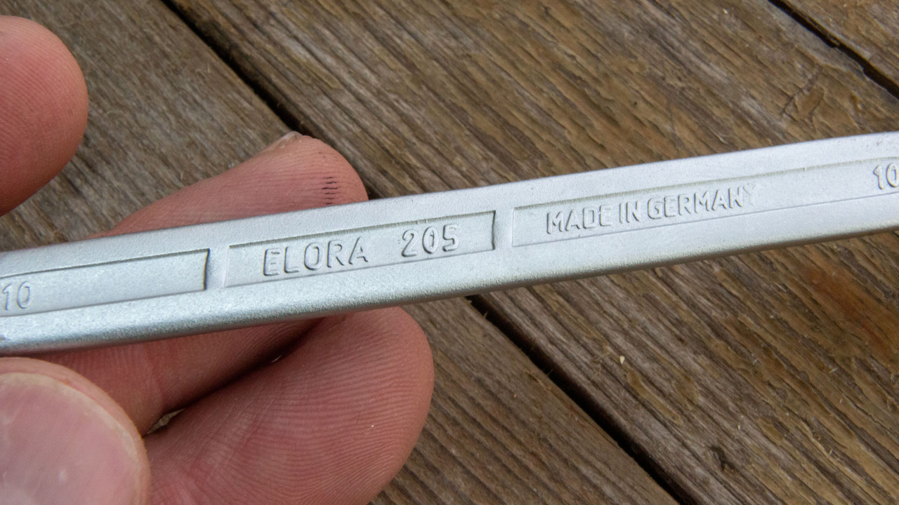

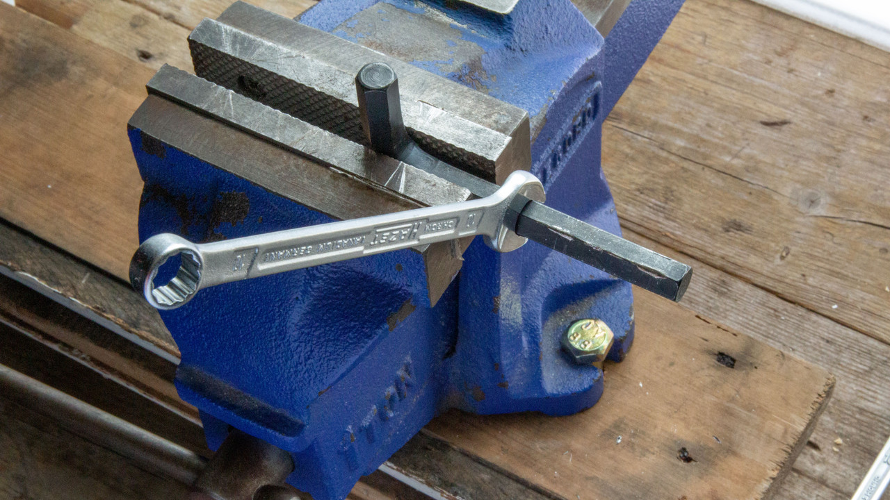

Played around with some 10mm spanners today to see how strong their open ends are. This was done to compare other brands to my Stahlwille which I found to be worryingly soft. Not in anyway scientific. Just wanted to see if there was any obvious difference in strength between them. The cheap bolts I had proved to be too soft so I stuck a 10mm allen key in a vice and tried to put enough force onto the spanners to open the jaws and slip off.
Spanners compared = Toptul Long (Taiwan), Facom 440 (Taiwan), Stahlwille 14 (Germany), Hazet 600N (Germany), Kincrome (China), Elora 205 (Germany).
I started using my bare hands and was able to apply enough force to make the Elora, Stahlwille, Facom and Toptul slip. The Elora was the easiest to make slip even though it is the shortest followed by the Stahlwille. The Facom and Toptul took quite a bit more effort. The extra length of the Toptul allowed me to comfortably apply more force so I think it did very well. I was unable to make the Hazet or Kincrome slip so I put on some thick gloves. Same result, both spanners would not slip. I revisited this later and still could not get them to fail.

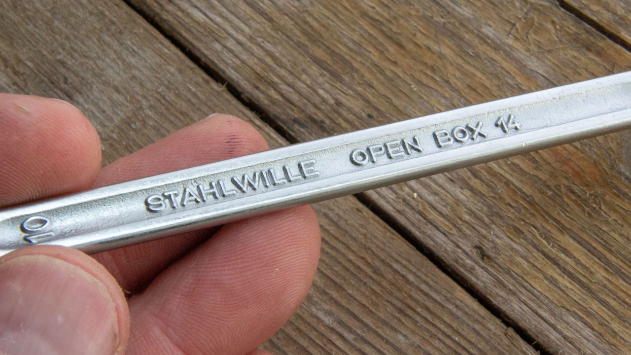

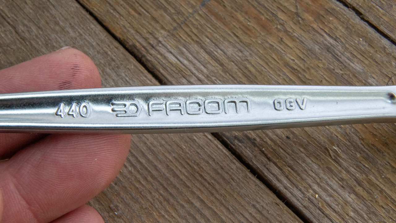

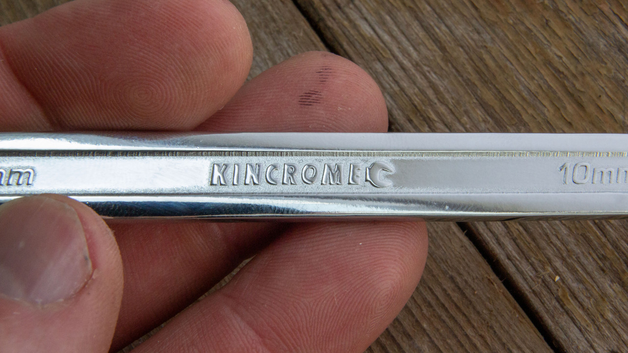

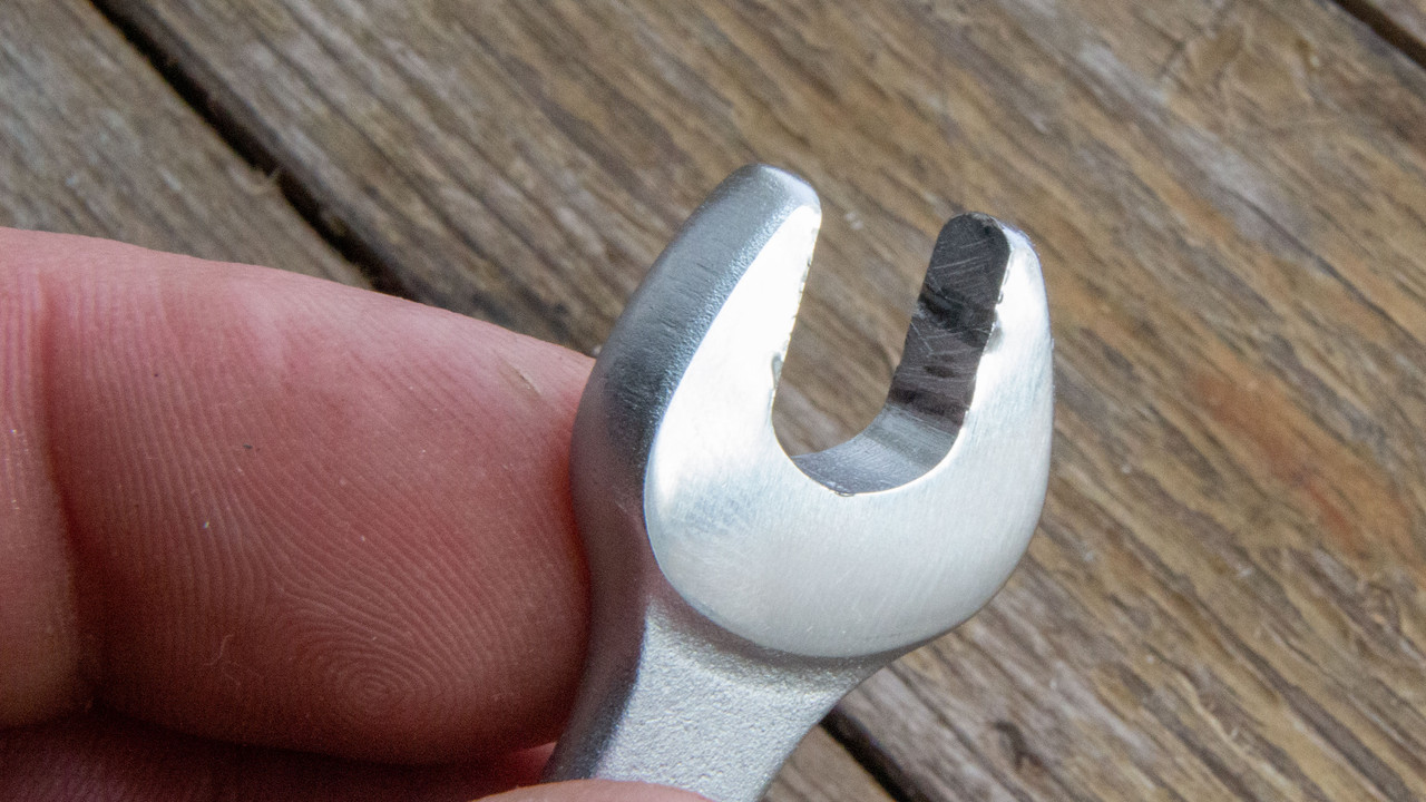

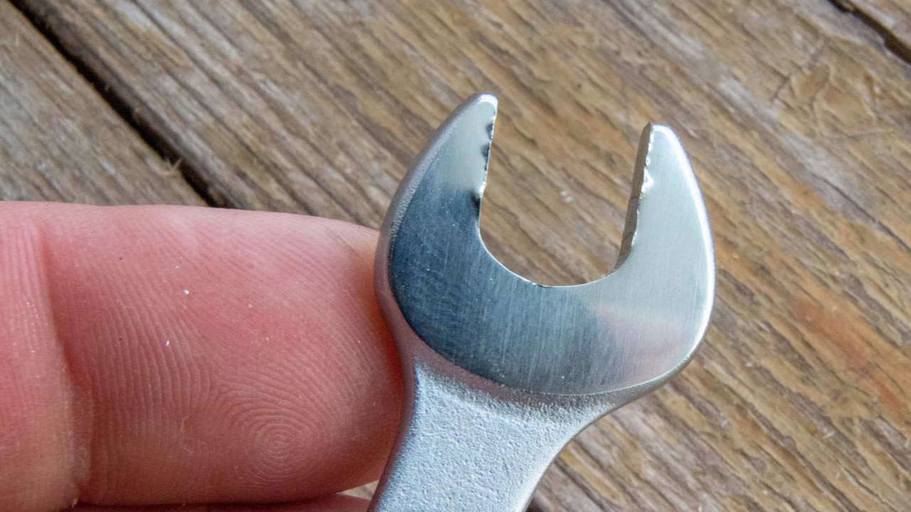

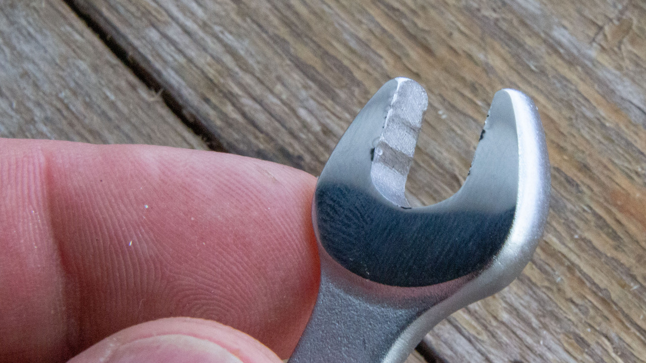

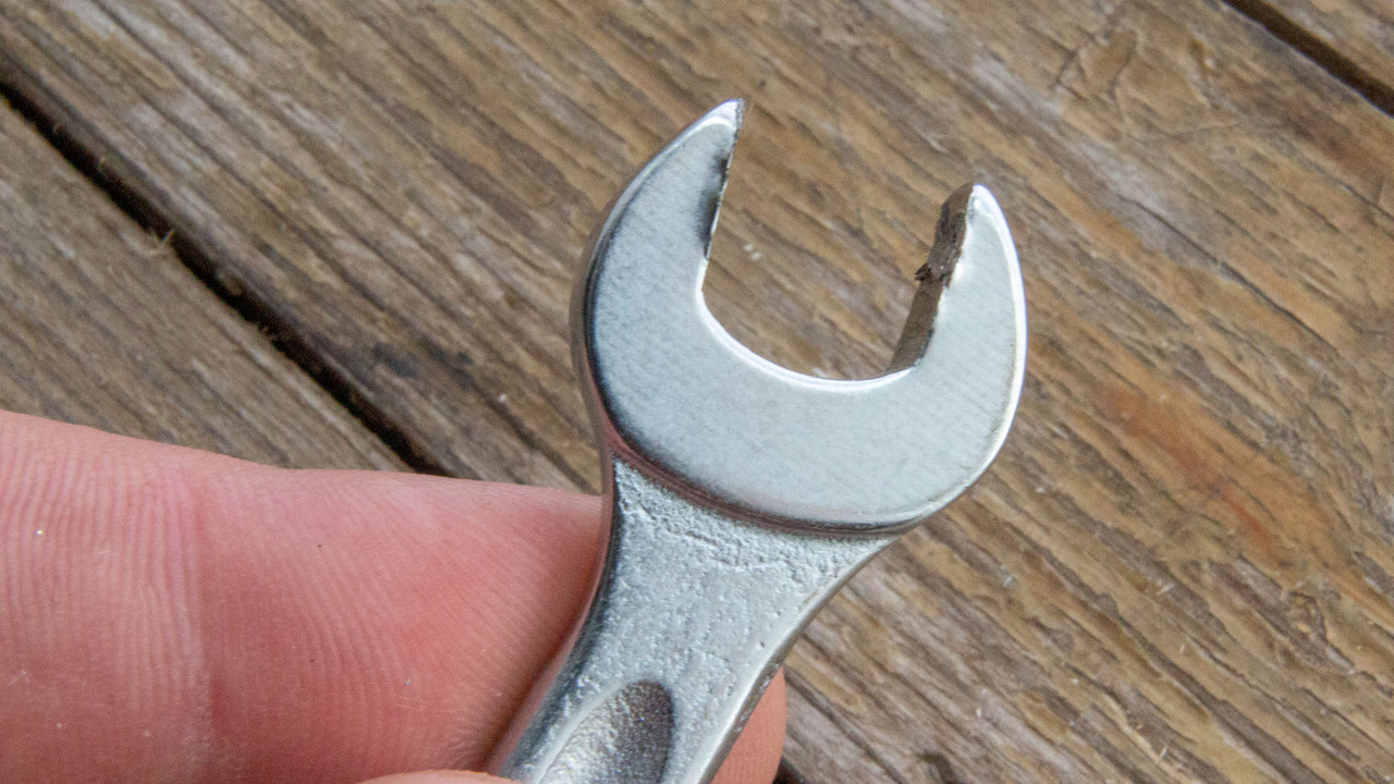

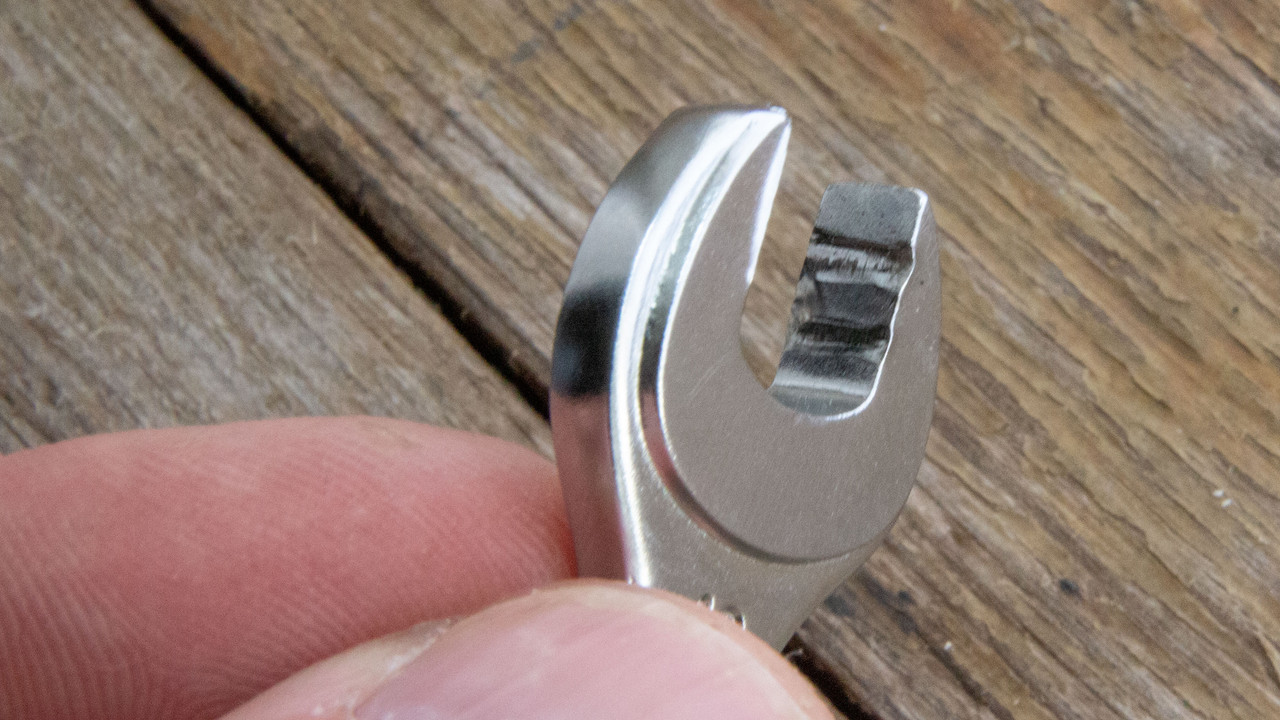

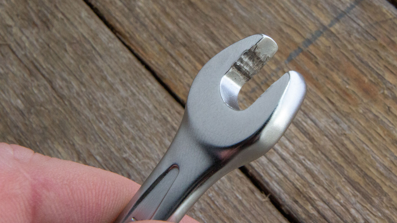

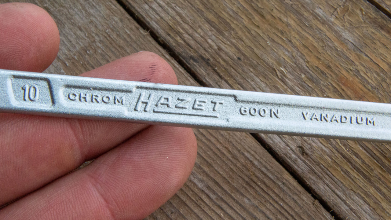

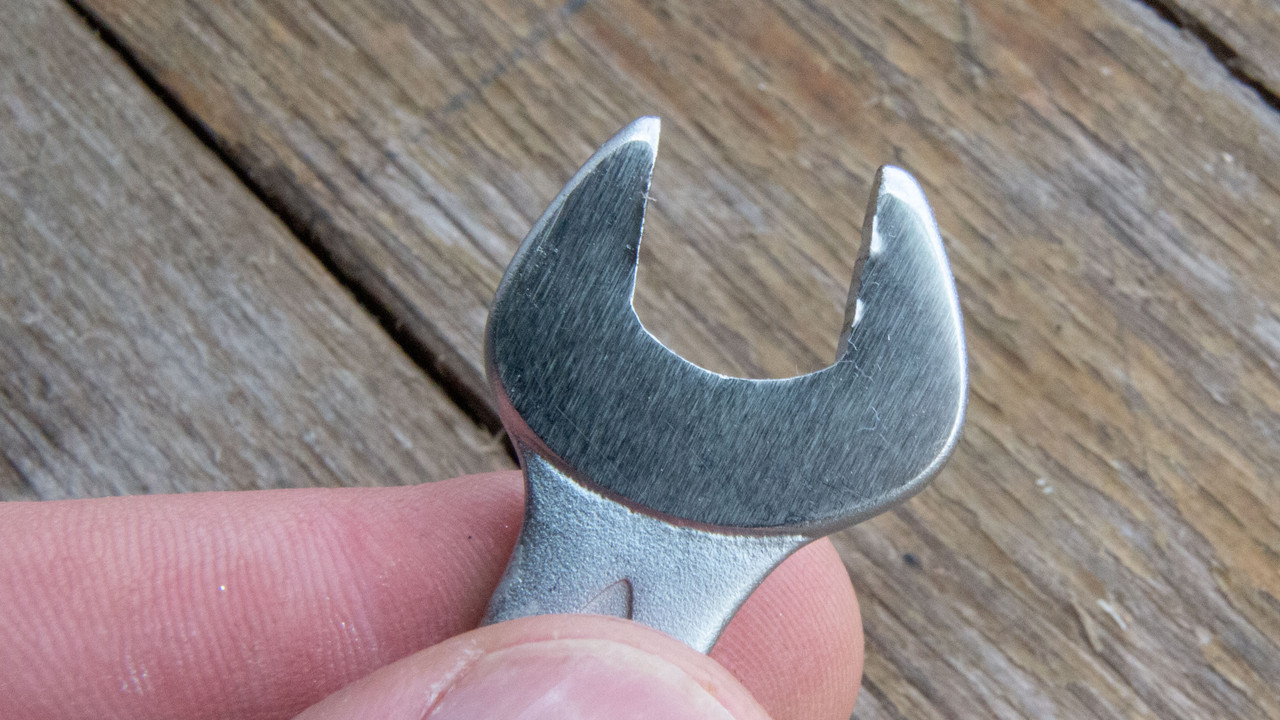

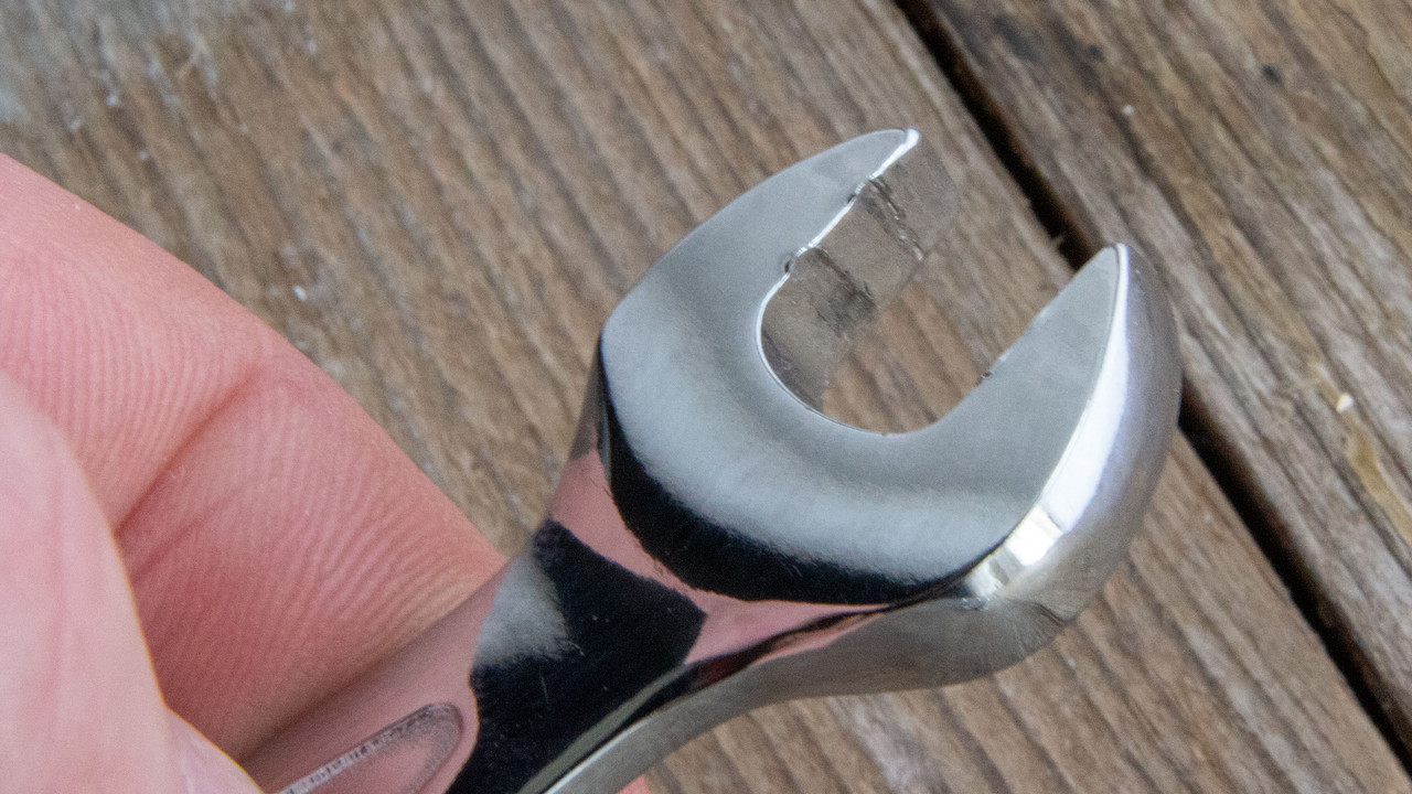

Some pics from after the test. I realise these are pretty meaningless without knowing how much torque was applied but at least they show that I had a good go at them.
Toptul.
Facom.
Stahlwille.
Hazet.
Kincrome.
Elora.

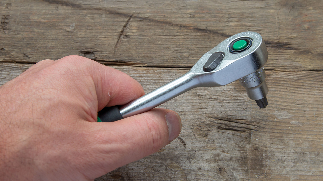

The other Stahlwille ratchets need an “N” suffix to ensure you get the fine tooth version. This is a newish release and it’s only available in fine tooth, so it’s just a “418 QR”
I got mine from TBS Aachen who have a bit of a deal, or at least did 2 weeks ago!
Was shipped as part of a big order so the shipping from Germany wasn’t a factor.
Problem is, there is now one obvious deficiency among my 1/4 ratchets and bit ratchets...!

Nice. I got Toptul set series AAEX, and when is comparing open end to gedore wrench... Toptul is better in tollerances. When i measure with caliper on 13mm wrenches is about:
13.1mm Toptul and 13.7mm Gedore - Toptul AAEX is way better IMO.

Interesting tests, the Stahlwille looked destroyed, but softer spanners will usually bend before giving up saving your hands, while the harder spanners will usually snap or give up and may cause damage to your hand.
The Hazet, Toptul, Elora so on have are well balanced in my opinion.
While the Stahlwille for the length seems really soft.
I have old indian made Gedore and Draper with no idea of COO but the rings ends blow out of those and I was lucky it wasn't under extreme loads or I probably would've broken my hand or something.

Looks like you gave them a fair workout! Thanks for posting the info. Interesting.
If Toptul was easier to find in the U.S. I'd definitely give them a go.

A member here did some testing on plenty of 13mm open ends wrenches he used in CNC operation. If memory serves me Stahlwille 14 did very well in his tests.
Regarding Toptul I think they state their long wrenches are for access, not extreme torque. Toptul has shorter wrenches advertised as 2 times the strength of the DIN standard. I have used them quite a bit and can confirm they are very strong and the open end easily matches Hazet 600N in stiffness and strength. I don't understand why they are not made longer. Strange product.
