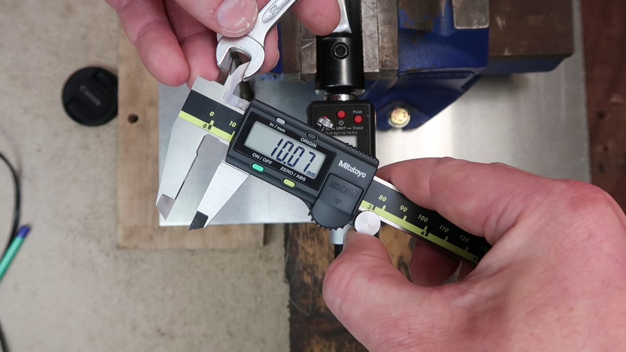

You might want to measure the open end of the Stahlwille again or check your calipers. It measures smaller than 10mm at 9.82mm. That can't be possible. Good follow up! Maybe my philosophy is wrong and by no means am I questioning your test, but I always thought open end wrenches were directional. Meaning the angled handle points toward the pull force. If that doesn't make since it just so happens to the opposite of how you held yours. Mute point since both were held the same way. In my mind you are pulling the joint, but when flipped you are compressing it. I am probably wrong and it makes no difference.
I considered the directional use for the reason you mention and Googled it but couldn't find much info. I think you mostly use which ever way fits best to give you the space to swing the spanner but one way may be stronger than the other.
+ Well spotted thanks. I used the wrong image.
Thanks for doing the test. I think the Hazet had a bit more life in it, should have used a different pair of flats on the hex bit (or another hex bit) for each wrench.
True. The hex is pretty hard though and I made sure I tested the Stahlwille first.

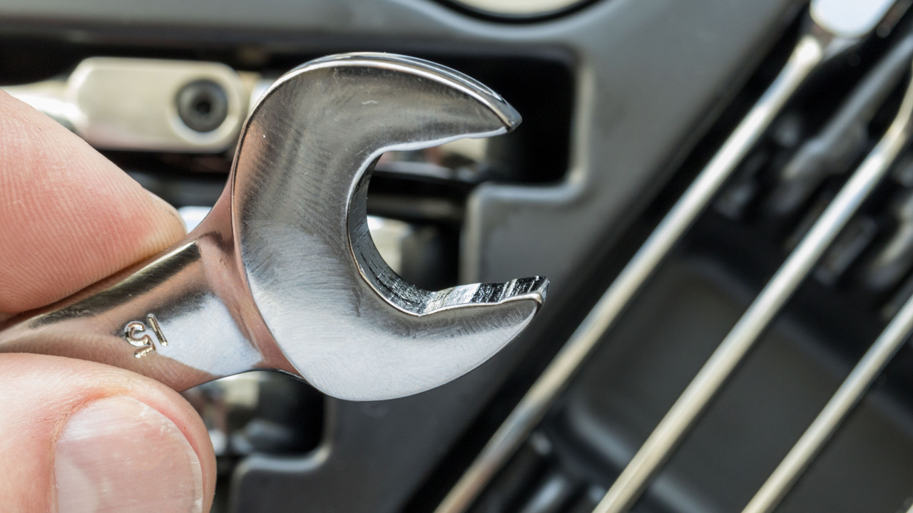

Agreed. That’s why the open end is not aligned with the handle of the spanner but rotated 15°. It’s intended to be flipped, and so it’s intended to take torque in both directions.
It might be obvious, but if the jaws were aligned with the handle you’d need to swing the spanner 60° (because 360° / 6 sides of the fastener = 60°) to catch the next pair of flats. With the jaws rotated 15°, the spanner can do a 30° swing and then be flipped to do another 30° on the same pair of flats before repeating the process with the next pair of flats. So the 15° rotation halves the minimum necessary swing arc from 60° to 30°.
The ring end of a combination spanner, having 12 points, is broached at an even smaller rotation to the handle: 7.5°. So flipping the spanner gives a 15° different handle angle, for an even smaller minimum swing arc of 15°. However, the ring end is often offset by 10–15° in the other orientation, for knuckle clearance with fasteners on flat surfaces. So it’s not always possible to use this feature. But even in those cases, because there are 12 points rather than 6, the minimum swing arc is 30°, the same as when flipping the open end.

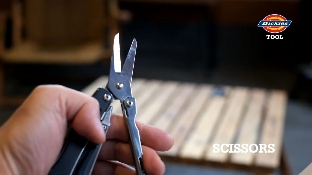

Multitool from Dickies. For Japan I think.
Probably a bit **** but the design of the scissors look quite good. Normally have to choose between full size scissors or pliers but you get both with these. I haven't really looked at multitools for a while so may not be anything new.

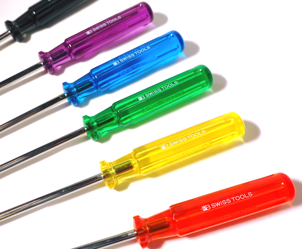

Those PB Swiss Acetate handles look like you can't get enough of a good grip on them compared to the Vessel Acetate handles. They also don't have the blade being supported by an additional acetate support like the Vessel Acetate screwdriver handles. I can't see the Japanese picking that over their locally made Vessel screwdrivers in my opinion.
I find that you can grip them just fine. They’re one of the highest quality screwdrivers out there, but they are aimed at folks doing relatively clean work. If you’re going to work with really greasy hands, then there are probably better drivers than either the PB or the Vessel.
I don’t think those pictures are screwdrivers. I think they are some novelty item like barbecue forks, presumably included to show the colours.
If you do have a problem gripping these, you can always get the Multicraft handle, which is a different shape, different texture and a little larger.
The Vessel acetate handle drivers are good tools, but the PB Swiss are better. The blade steel is better, the tips are stronger (and better ground), the plating is tougher and the handles are CAB rather than cellulose acetate.
I’m sure they are considerably more expensive than the Vessel, but I suspect there are enough folks in Japan who are prepared to pay it!

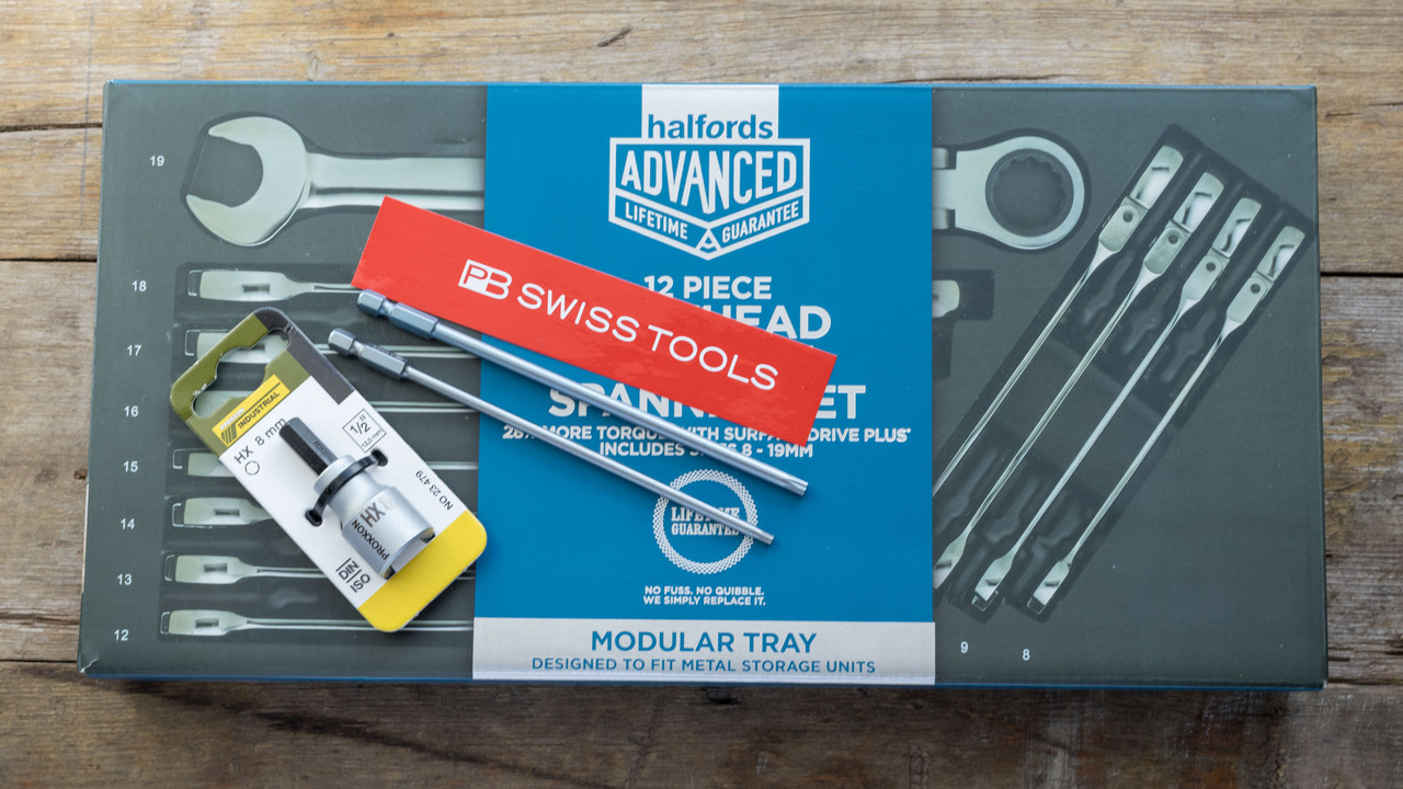

Had to use my brand new Hazet 916HP yesterday not because of it's high torque but because of it's fine teeth. Works fine, wouldn't have worked out with one of my normal 1/2 hazet ratchets to change the starter that I was working on.
Wout

Multicraft seems like a Swissgrip with CAB and a textured surface.
Better is subjective but you can't just claim they're better. The only difference with the tips is that the Vessel doesn't have any tips with an oxide coating but they are magnetic. PB Swiss has the oxide coating but they aren't magnetic. Vessel says it's cellulose acetate resin but doesn't specify if it's CAB or cellulose acetate. I wouldn't claim the PB Swiss is better as you're comparing Swiss to Japanese steel. I'd like to know where from where you claim that the blade steel is better, tips are better, plating is tougher. That's quite the assumption to make since Vessel makes some of the best screwdrivers in a market full of competitors from Europe, Asia, America, and elsewhere. If you can provide reliable sources or links to a comparison of PB Swiss classic/multi-craft directly to the Vessel Crystaline series I'll look at it. Maybe I'll even ask to borrow classic/multicraft from a few people I know for direct comparison. I also covered the cost of the individual screwdriver here:
With regard to the Multicraft, essentially yes, although it’s actually the other way round as the multicraft predated the Swissgrip.
I believe the PB Swiss to be better, based on 25-30 years of using PB Swiss, some of it in an industrial environment, and probably even longer of using Vessel, which has been a common name in the U.K. since the early 70’s at least.
I say that the steel and tips are better on the PB than the Vessel because I have encountered several Vessel slotted drivers with distorted tips over the years. Not so the PB. I’m not saying the Vessel are failures, they are very decent tools for the price, but the steel on the PB holds up better.
I say the plating is better on the PB because I have encountered Vessel drivers with stripped plating, but again I have yet to do so on the PB Swiss, and I have some that have had very hard use.
Vessel say their handles are cellulose acetate. If it was CAB I’m sure they would say so, and it looks, feels, performs and smells like cellulose acetate to me.
I don’t have any problem with cellulose acetate handles whatsoever, and I’ve never seen a broken one (Scuffed maybe, broken no) but I can’t deny that the CAB is more impact resistant, so I’ll go with ‘better’.

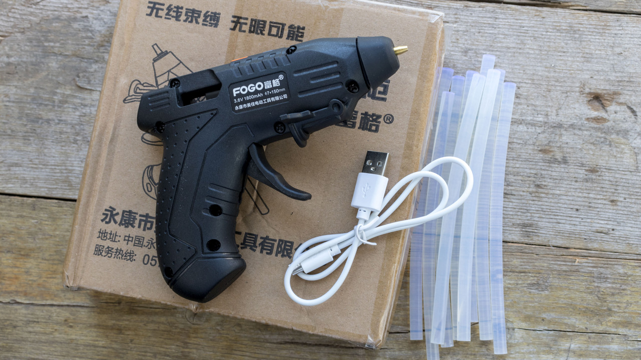

FOGO ML-HG2 rechargeable glue gun.
Cheap glue gun from Aliexpress.

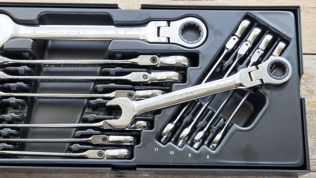

Those extendable ratchets look very interesting. Perhaps an ideal tool to keep in a road box or on a vehicle.
I was thinking about them before they introduced the HiPer version, but I’ve never actually seen one, or know anyone who owns one.
Has anybody got any feedback? In particular, how rigid are they when extended?
I have all of the 1000n ratchets, the extending one is super rigid throughout its range no noticeable flex when using it to change wheels. Solidly made but as you might expect, quite heavy at approx 1.4kg.

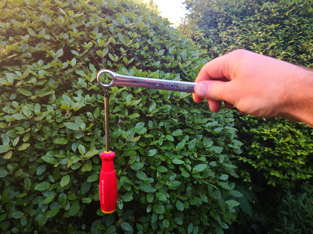

All screwdrivers that I have used can be magnetized and demagnetized with a magnet. :dunno:

Some new bits and bobs.

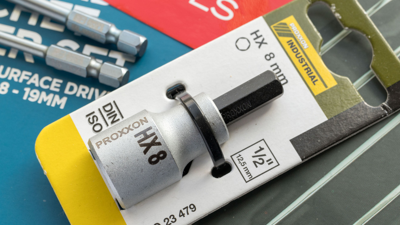

Halfords flex ratchet spanners, 150mm PB Swiss torx bits and an 8mm Proxxon hex bit (to be used properly on hex bolts this time :thumbup:).
Bought this Halfords set to leave at work. I have a set for home use and did not really know what to think of them as I have not used other brands enough to make a fair comparison until recently. The Halfords spanners have always just worked but I wasn't sure if they are different to cheaper offerings. Having spent the last week using Silverline ratchet spanners I can now confirm that Halfords spanners are good, or at least better than cheaper spanners. Silverline ratchet spanners have a rougher mechanism that binds up when you crank on them. Sorry, I know this is only relevant to UK members.
They come with knobbly open ends now.
