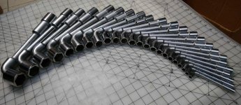

Ok, I'm going to try to make my first image post, let's see if it works...
I bought a set of old Facom 75 series wrenches last year. I work on European cars in the US and thought these might come in handy. They all say 'FRANCE' on them and none of them have the flank-drive style rounded inside corners. Not sure when Facom changed them over.
Pretty. What do you think of them? That set must weigh a ton!
I have often wondered at regional tool preferences:
  • In France, these clé à pipe type wrenches are popular. They’re almost the default wrench for a lot of jobs and people
  • In Nordic countries like Finland, flex-head ‘Saltus’ socket wrenches are extremely popular. I mean the Bahco 4040M type
  • And in some other countries, people favour deep-offset spanners like the Stahlwille Stabil 20.
What accounts for these differences?
They are very useful in specific circumstances, where an offset box isn't quite deep enough. With a crossbar or tommy bar inserted through the short end, I can spin fasteners off, which is nice. With a bar stuck into the long end, I can break very tight fasteners. They also make a convenient pass-through wrench for strut nuts.
We have a saying, different strokes for different folks. :thumbup:

Those look Awesome! Where did you get them and are they 6 point on one end and 12 on the other end?
I got them on Craigslist, I periodically type in 'wrench' and 'wrenches' for my area and saw them one day for a reasonable price. They are all Facom 75 series, so they are 6-point on both ends, except for the 20mm, which is a Facom 76 with 12 points on the short end. I believe it was added later to the standard 8-32mm set by the original owner.
I don't have a good way to store them right now so they take up an entire drawer in one of my boxes.
Yep, even today the Facom 75.P22M 22-piece set does not have the 20 mm:
https://www.manomano.fr/p/75-jeux-d...es-metriques-et-en-pouces-facom-75p22m-737607
(And I see the weight there: 13.4 kg! (30 lb.) This is why I’ve wondered about these wrenches. I like using them, but they’re very heavy compared to alternatives.)
