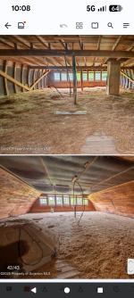

Four human-size stories or four chicken-size stories?
I didn't measure but I'd say about 6'-4' to clear under 12' beams upon which sit 12" joists.
Pictures from Zillow of house and barn exterior, and barn 3rd and 4th floor. Barn - by pacing - is approx 75 x 35. I will look at removing third floor (second framed) to make double height main floor (second, street level), and perhaps remove ceiling above top floor. No idea if that is possible but also only focusing on making house habitable for son and family.

So back at building, a short look yesterday but plan to be there most of today.
Lots of oddities, but what affects this issue is that first floor framing runs parallel with ridge, second floor and attic floor (rafter ties) naturally run perpendicular to ridge. So I don't know what if anything beam in attic and cables replaced. Thinking to remove some second floor wall - it happens to be paneling like wainscot panels - and see what we can see. Trying to save lv rm ceiling but could bore a hole and scope it.
Curious number of thin walls - like maybe framed with two by flat - I think including the wall with cables.
Temporarily supporting the floors and rebuilding that wall with a beam on it might be a option. Remove the wall, set a lvl on the floor, maybe replace cables and eye bolts with all thread, and build wall on top of it. It's just supporting the floor from a beam over rather than under the joists that is odd.
Hopefully sketches and photos to post tomorrow.

I was in house Sunday but haven't had a minute to look at photos or do a sketch.
The second floor appears to be 2x8 spanning 23 or 24' over living room. Cut a hole in ceiling to see what wire rope was attached to. It's simply wrapped around a 2x6 that is flat and notched into 2x8s. Seems like a terrible idea - notching the bottom of the long joists dead center.
Absolutly no sign of there ever having been a wall on first floor under this. No says anywhere. I'd guess the cables are from the 1950s. Have to decide if we live with it and skip ever finishing the attic.
Wire rope is 5/16" 1x7 galvanized with clips on backwards.

Yes. Look at the two attic photos that depict a truss like structure in the attic, though pretty sure the structure is all the beam on attic floor. Eyebolts through "top chord" with cable attached, down through wall, and wrapped around 2x6 under 2nd floor joists.

Think of it this way, see how the beam in the attic sticks up above the floor? Imagine a steel beam, but instead of it sticking up above the floor, it would be below the ceiling on the second floor. Any beam would need to be supported on each end obviously.
