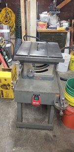

Ok here’s some poor photos of my recent $50 pick up. It’s interesting because it is mounted to this stamped base. I haven’t seen this type of base before. You guys seen this before? I’m guessing late 40’s based on the early king seeley logo. Saw is an 8” saw and I am looking for a 10” so this one will get moved along to a new home. I’m not above parting the saw so if someone sees something you need let me know!
Craftsman model 103.23832
Toolguybak
Jul 9, 2012
27
Nice find!
The 2383 is from model year 1950 or 1951.
The stand consists of the Craftsman bench legs with sheet metal side panels that loosely resemble those on the Double A built Craftsman Builders Saw. To date we haven't seen this stand in Sears Power Tool Catalogs. Possibly a retail store item.
Note: the motor mount plate is on backwards.
