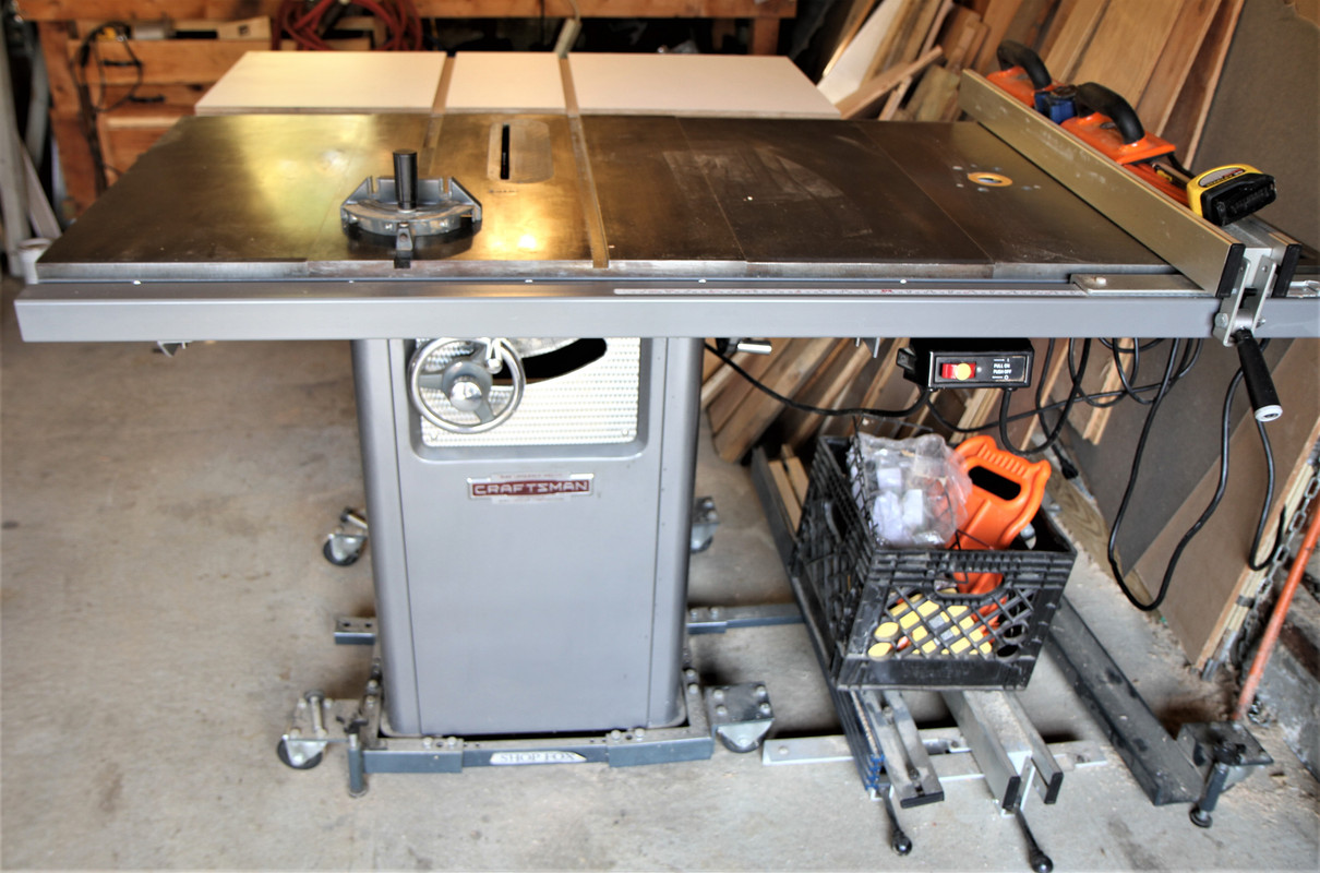

I work in my basement, so everything needs to be on wheels. This has got a Shop Fox base with an extra set of casters (6 total) that will allow the whole thing to rotate 360 degrees
The best mods were the Vega Pro 40 fence, 2 additional cast iron table extensions (eBay purchases), folding outfeed table (how did I ever get by without one?) and the SharkGuard system. The saw cuts well for only 1hp, but anything super hard/thick, will cause it to bog down a bit.
I've got most of the saw dust under control now with the upper intake, and a lower collection:

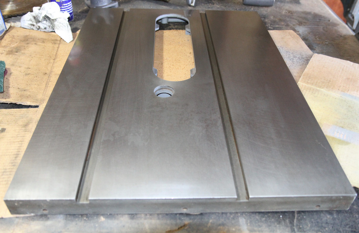

Anyway, my current saw is a Craftsman Floor Model Table Saw model 103.27270. Here is an image of that saw. This was mostly a functional restoration. I painted it. New bearings. It has a later 1.5HP Craftsman Contractor Saw motor. The 2 solid extension tables came to me on a non working Craftsman 113.27520. The router extension was on my last Craftsman Contractor Saw. There is one of the original extensions from this saw on the far right. The rolling base I picked up on CL. I made the rails for the Delta T-Square fence so the saw could cut 36" to the right side of the blade. Has a Starret tap. This saw is my daily driver.

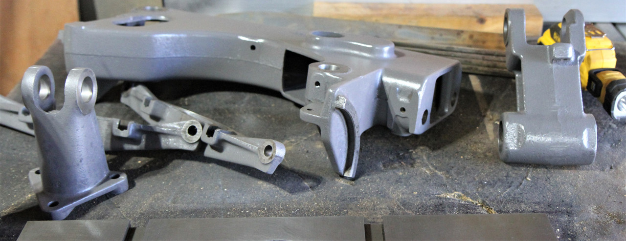

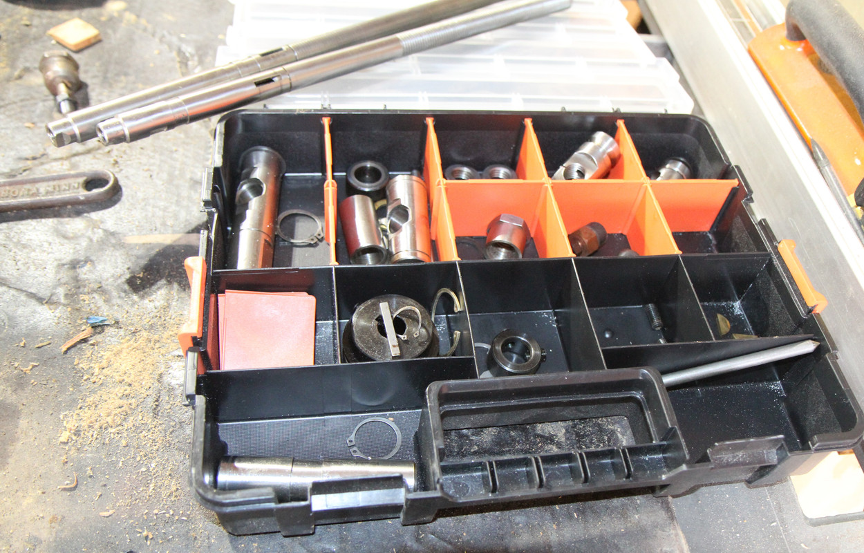

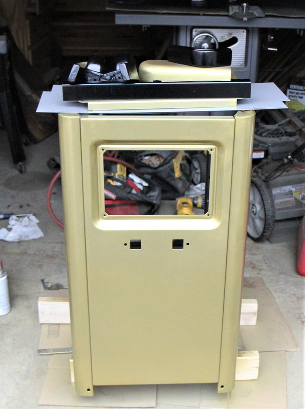

Here is a project currently in the works. It is a Craftsman Floor Model Saw model 103.22450
Saw case and associated parts waiting for assembly
Cast parts cleaned painted waiting for assembly
Saw parts, pins, rods, spacers, clips, etc. after cleaning readuy for reassmbly
Saw top after cleaning waiting for assembly.

Do any of your tables have the machined swirl marks of the original finish? Mine looks like it was surface ground with a fly cutter that had a diameter of maybe 10 or 12 inches. Just curious as to how everyone dealt with that. My first in my life table saw. Slowly bringing it to being usable and presentable (not a restoration by a far sight!).
Well, truth be told I find those swirl's, at some level, desirable. Not so much so that I would seek them out but it just illustrates, to me anyway, that the top is little used and little worn. I expect there are purist out there that would be critical of the machining and consider it less than finished. Far be it for me to argue with that. I have cleaned maybe 10-12 pieces of cast iron machined surfaces between table saws, band saws, drill presses, table saw extensions, router extension, etc over the years. So, my experience is limited to those pieces. I don't remember my contractor saws having them nor does either of these floor saws. I have had a few band saw tops that had them. I am cleaning a band saw top from a 103.24280 now and it has them.
Anyway how your deal with them and what you think of them is up to you.
I wish you luck on your saw. Just putting the saw into service is good enough and should be very satisfying. Get it set up for your own particular needs and space available. What model saw is it?
39,418
Rarely are the cutter marks an issue. In fact, they may be an aid for sliding material across the surface.
Two perfectly machined surfaces can lock together (vacuum) and those cutter marks prevent a vacuum from doing so.
Just get the Rust off (a Safety razor works well for machined CI) and call it good.
I wasn't wanting to eliminate those swirls but getting it all clean and shiny is a problem so far. I guess I'll stop trying while I'm ahead and give it a coat of wax. The model number is

Well, there is rust, pitting and staining. At least that is how I break it down. It is only going to get so good. After all, the few recent ones I have done are 60+ years old. I reach a point where I say good enough. If you look at post 418 in this thread you can see some staining in the lower center/left quarter of the saw top. Not trying to remove any more on this particular top. That particular top is "good enough" or at least as good as I am going to make it.
Here is the process I use.
My process has simplified to tell the truth. The first change I made was not "dreading" the work. I don't love doing them to be sure but I approach it as just another job and get to work. A good clean top is a satisfying result, so there's that. These days there are just a few things on the bench when I clean something cast. A roll of paper towels or some rags, a razor scraper, WD-40, green and red scotch-brite and just occasionally naval jelly and a bit of water if that particular surface has a lot of staining and I think it will help. I just carefully scrape the rust off the thing and start scrubbing a WD-40 soaked top with the green scrubbie. In the end, it matters what you started with. If the surface has lived out doors under a maple or pine tree for 8 years and is covered in pitch, sap, rust and beer can rings or was it just sitting in an unheated garage or barn with just some surface rust and grime.

I don't think this saw spent a great deal of time outside but it was outside when I bought it and had a good surface rust going. It also has some very slight pitting but nothing to worry about. It's actually hard to see.
I might have started off wrong but it's cast iron, it'll still do what it's supposed to do.
My initial go-to was a hand held wire brush, that barely removed any rust or gunk so I goofed out of impatience and grabbed a roloc medium grit 2" wheel on a die grinder (the picture shows that result). So I waited for my new Christmas presents to arrive- two Dewalt tools; a osculating tool and a random orbital sander. I started with the ROS and 180 grit. It did OK but i was worried about maintaining the sharp corners of the miter slots so I did the edges with the osculating tool and the triangular sander. Then moved to 220 and went over it again. Then I used some liquid wrench (an old can I'm trying to waste) and some 2 aught steel wool under the ROS pad to polish it some and then went over that again with 4 aught. I finished up with red scotchbright under the ROS.
Obviously I have zero clue about this. It's clean, just isn't shiny.
I just hand wire brushed the grooves. I brought in my 4-1/4' angle grinder with a knotted wire wheel but I'm reconsidering how aggressive that might be since it's not a variable speed grinder. As I said...leave well enough alone.

Well, I am not going to comment on your method. There are many ways to clean a top. I told you mine. That said, you are down to bare metal. There really isn't anywhere else to go. Take the finest material you have, give it a once over by hand and then put a coat or 2 of paste wax on it.
