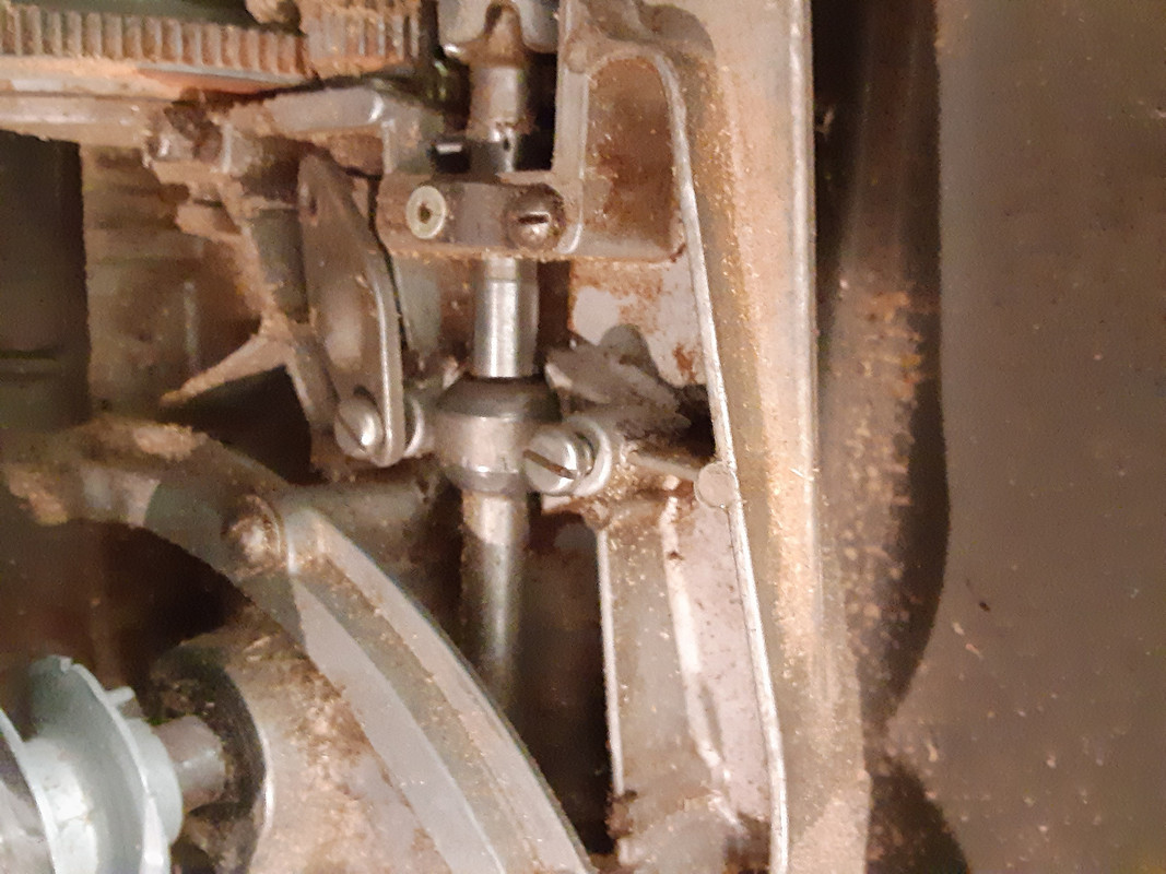

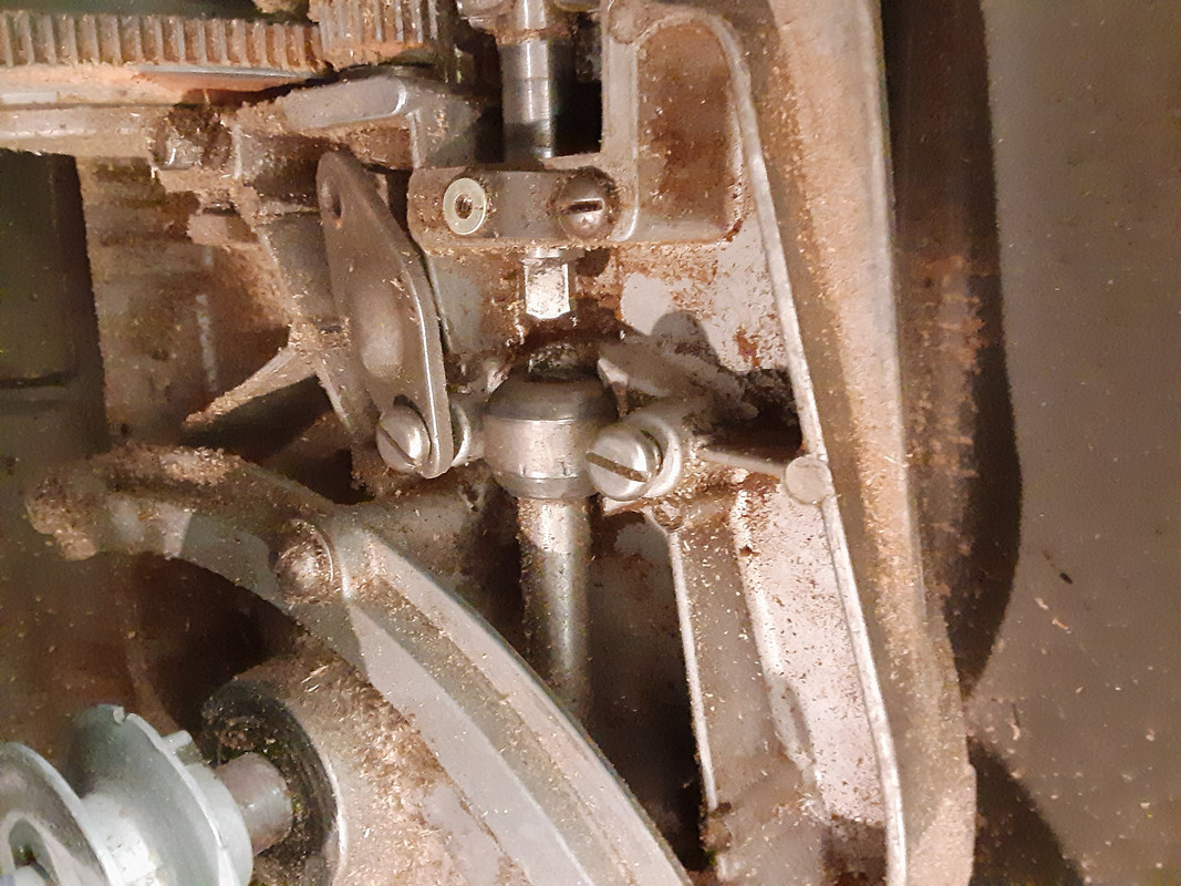

I have one here in the stack of stuff. I flipped it over, pulled the screw and had a look.
There is a square female drive on the ball to receive that shaft.
The part as it sits disengaged
The part as it sits engaged
