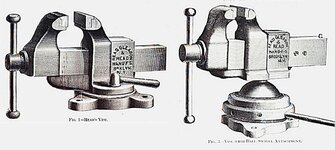

Read, Gleason, and Read vises
On October 24 of 1882 Henry Read was granted two consecutively numbered patents for vises - #266522 and #266523. On December 26 of 1882 an additional two consecutively numbered patents for a vise and a ball swivel attachment were granted to Mr. Read - #269708 and #269709. All four patents were assigned to Read, Gleason, and Read Manufacturers of Brooklyn, NY. Articles announcing their new vise were in many journals in the early part of 1883 but not much after that. Read, Gleason & Read were still listed as "vise manufacturers" in 1890.
