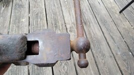

I have a question for my peers on a recent eBay sale of an Athol no. 3 clamp-on vise, which had the clamp ground off and sold for 5X the normal amount I'd expect to see for that particular vise.
Good looking vise, but why would it fetch so much more than the original?
Or is the vise unmodified and I'm unaware of this version?
It looks like a swivel base version missing the base to me.

Never seen one like that. The base looks like it either has seen plenty of rust or that’s the original surface from casting. Normally when you machine the bottom you would see a more precision center boss since you would be cutting on something like a rotary table. Also their Isn’t that much material after removing the clamp I’m my experience.

Looks like two different vises to my naïve and untrained eye. That bottom center pedestal on the ebay one doesn't look like it was added on by the user ¢¢

Fierljeppen the static body of that No. 3 vise looks quite a bit different than the clamp on Athol No. 3. Looks like the base under the dynamic is thicker, note where the "N" is in relation to the dynamic, and if the clamp on had the casting for the clamp cut off flush the jaw support would be thinned considerably compared to that Ebay vise. It's a strange one, don't think Athol used 2 swivel locks either, leads me to think someone drilled those holes to mount it, weird. Hope the buyer knows something we don't and is happy with his purchase.

Thanks for all of the input on the Athol no.3 vise!
I couldn't find any catalog scans of the vise and my best educated guess is that it's from circa (1914-early 1920's). I'm also guessing the new owner isn't the only one who knows something more than we do, at this point. Bidding was very strong, right out of the gate, with seven different bidders.
I'm really hoping the new owner is willing and able to enlighten us on another GJ vise puzzle.
39,607
I think that #3 has a clamp on base that it slots into, (that round base section has a groove for a set screw) and its a swivel base clamp on - I have a Miller's Falls clamp on that is the same way, and so does my son. (it just took a dozen years to find him a base....)

One other interesting feature about the Athol no. 3 mystery vise is the missing the embossed "Mfg by A.M.Co. Athol Mass" I've seen on all of the other Athol No. 3 vises that I've seen.
I did verify that the specs of the mystery vise are identical to a normal Athol no. 3 vise. Looks like it should have been in an Athol catalog no. 32 if anyone has one laying around.
