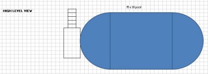

The big project this year is to add a small deck onto the end of our above ground pool.
We have a screened in porch on one side of the pool, which is great for sitting away from bugs to watch everyone splash around - but you can't get into the pool from there.
You may also remember the lifeguard chairs that I built last year - great for poolside beer sipping.... but you can't get in the pool from those either.
So, the new project is a 5 x 8 deck that will serve the purpose of providing a spot to remove your flip flops, and to do canon balls into the pool. It is not intended to be a lounging deck. It's a pool access deck.
To begin, I met with my township code enforcer to figure out what specifications I needed to hit. He provided a 40 page guide that took a little studying to understand.
With the help of that guide, I designed the deck and drew plans, including a detailed materials list and submitted to the code enforcer for approval.
Once the code enforcer approved my plans (he only had 2 minor changes! not bad!) I submitted the materials list to the lumber yard (they beat big box pricing, and offer free order pick and delivery... plus, many of their materials are much better).
Anyways, here's a couple pics of what I'm aiming for. And a few bullets of explanation:
- 5 x 8, overhanging the pool lip (so that kids don't ruin the pool when jumping in)
- Trex decking
- Metal ballusters
- Stairs with self closing gate outfitted with safety latch
- Solar safety lighting (or maybe low voltage lighting...we'll see)
Plan is to start digging for posts by end of March.

Regarding the deck build... getting the deck squared to the end of an oval pool takes some doing. We had a nice warm (50 degrees F) day last weekend, so I started doing my layout.
To begin, we established a string line that was just touching the long "straight" side of the pool (which was slightly curved). Then, I used another string line and the 3-4-5 method to create a right angle.
I found center of the end of the pool, and transferred that mark to the 2nd, right angle, string using my 4 foot level. I measured from center out in both directions and marked the ends of the deck and where the posts should be. Using a plumb bob, I transferred marks from string to ground and marked with marking paint.
The reason for the strings is because I couldn't think of another way to square up effectively, and because I can take the strings down to dig, and then reinstall them to final check post placement before they're locked in. This is how my former company marked out post locations for pole barns, so I figure it will work here too.
