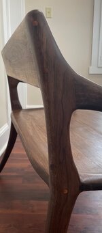

I have gotten very far on the bench build now.
The seat is contoured for comfort.. I have never done this before but chose to get various zones of the seat to a prescribed depth using my router, a huge bit, and a trolley.
Then, using an angle grinder with a carving disc (and then 24 grit sand paper) I fine tuned the seat. You can also see the "Maloof joints" in this picture.
Lots of other steps ranging from simple to quite complicated eventually led me to having the bench completely assembled. At this point, I again used the angle grinder to rough carve the bench to shape. Some filler in a few spots as needed etc.
I'm awaiting my new Foredom rotary tool which will allow me to fine tune the carving... then hand rasps and hand sanding will take this one to the finish line.

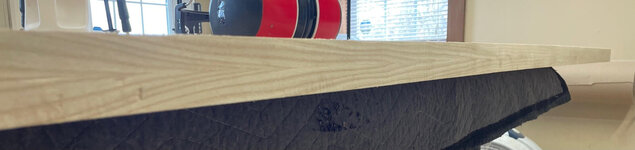

I've been busy lately building a table for a friend/customer a couple towns away. I've been a bit slow on this project because I decided it was a good opportunity to learn to use the new Festool equipment... and wow, was it worth the time to pickup the new skills.
This table is quite long, so jointing is a pain... I instead used the track saw to establish a straight edge, and then ripped parallel on the table saw. Later, I again used the track saw to trim the edges of the table top.
This table would have weighed a ton and cost a lot more than the customer was willing to pay if I used thicker lumber, so I decided to "fold" the edges over to make it appear thicker, while also creating a nice grain match. Once again, the track saw made quick work of this effort.
Next, I used the track with the new Festool router to cut the tenons on each end of the table to accept the breadboard ends. The mortise on the breadboard end was cut at the table saw using the dado stack.
And then, I used the new domino to put the legs sets together. Two sides of each leg received a slight taper over the bottom 13 inches (cut at the table saw) and the lower support was placed at 'footrest height' to benefit whoever sits at the end of the table. The legs will be set in 10 inches from the end to prevent bumping shins etc.
