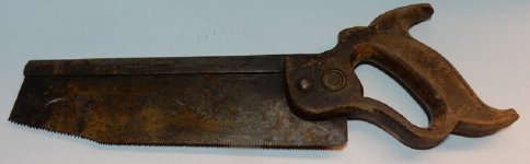

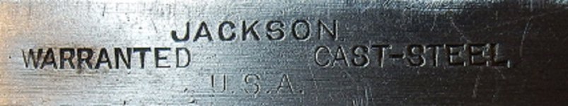

jar: I collected a lot of vintage saws that needed sharpening just to have something to practice on. What do you think of this one? I've never seen another one like it.

CRS--Interesting saw. I am sure others will chime in. Looks to me like previous owner modified the tip so he could start a kerf his way. I use the heel of the saw for that but guess he liked to use the tip.

I thought the same thing about that Jackson saw. It's curious that the Starter Teeth are much coarser than the cutting teeth. It would be hard to set too. The coarse front teeth would have to have the same set as the finer teeth. That's probably why that style didn't catch on.
Its was certainly modified by the owner, though I can't come up with a reason other than the saw plate suffered serious damage and this was an attempt at salvaging it. The teeth on the front are filed at a coarser lower tooth count and not done particularly well.

jar: The other teeth weren't done especially well either. It would take an entire retoothing to get it right again. That's why it's now officially a DECORATION in my shop.
