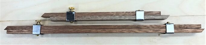

More Fun with Scraps
I saw a blog from Chris Schwarz about a way to make adjustable pinch sticks. There are other names for them but they're used to compare the lengths of diagonals in a box to check squareness. It's much easier and more precise than measuring. Put the beveled end of one beam of the pinch stick in one corner and slide the other beam until its bevel is in the opposite corner then set the thumb screw. Place the pinch stick into the other diagonal corners. If its fits you're square. The same thing can be done with two sticks taped together in the middle but that will only work for that one box. I added a picture of pinch sticks in the box I made for STANLEY #66 beading tool.
I made the beams from scrap mahogany left over from the trestle table build and the metal brackets pairs from 3/4" square steel tubing cut into 5'8" lengths. One of each pair has to be tapped for the thumb screw. Both of the brackets have to have a through hole for a #6 round headed wood screw. The outside measurement of the tubing is 3/4". The inside measurement is a bit less. In order for the two beams to fit inside the bracket and still be able to slide against each other, they have to be milled down to a consistent 9/32" thickness. Bingo!

I have a nice set of 'bar gauges' that have different tips you can use - inside measurements, corners, etc. They were a little spendy but I actually use them quite a bit instead of a measuring tape. They are from Lee Valley, current price is $75 but I have head them for years and don't remember what I paid for them. (I also have the 12" extensions, so they can measure up to 44" in length) Very handy to have
