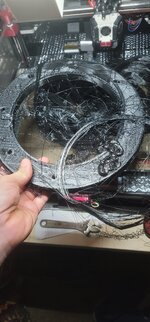

So here is a bit better shot of what I think was the worst looking print that actually finished I'd had in awhile....
I personally hate printing in gray as it seems to spotlight issues more than other colors, but it was what was at hand so used it. This was IIID Max brand PETG material, brand new, sealed in bag and opened up and immediately started printing....but the stringing and little bubbles in the layers screamed "wet filament" even though it shouldn't have been an issue. The IIID Max filament has printed decently for me, maybe not as consistent as some other brands but when buying in rolls of 10 or more it's an extremely attractive pricing
So after buying an "el-cheapo" china filament dryer and sticking the roll in question in for 9 hours at 50 degrees(Max temp of el-cheapo), I reran it overnight:
So definitely an improvement with stringing mostly gone...however still present and the surface finish is still showing the small imperfections indicating it may not be dry enough. So this to me confirms my suspicion of wet filament, next step is that roll is back on the dryer for another day or two to see what that does while I research a better dryer option...but looks like I'll probably end up with the one Austin recommended above as it hits the major things I was looking at in terms of being able to dry ABS/ASA which take much higher temps and also being able to dry multiple rolls simultaneously

Definitely wet filament! It's extremely common to get wet PETG even straight out of the vacuum seal. The manufacturer often doesn't dry the material prior to packaging. I would also print a temp tower for that filament to see what it's optimal print temp is.
Another filament dryer option, although it only heats to 70C, is this Sunlu Filadryer S4 which I actually just backed minutes ago. It's the first Kickstarter that I've ever backed. It was about $105 for the dryer and a spool of filament (it was the cheapest available tier) and that's super cheap for a 4 spool dryer. Not exactly sure when it will be shipping, but it's kind of too cheap not to try.

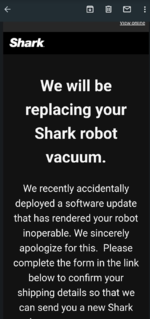

Getting notifications like this makes me glad that I wasn't the one responsible for this error....shark 1.png
I'd noticed that one of our robot vac's had a fault light on it but hadn't done anything more then I got this a day or two later. Filled out the form and got the email notification today the "order" was processed and should ship tomorrow....0 charge. 0 complaints about that level of customer service!

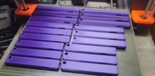

I said I'd draw up and print a couple of hangers for the cross bar...cause why not? That and donating the shop space, materials and labor to move it around are my contributions so far.....not a bad way to go!

I had an issue with my robot vacuum, but it's a Roborock and it wasn't due to software update I don't think. But it lost connectivity to the internet. After 4 failed attempts, I was finally able to get it to connect to the internet again. Now it does its job so I'll keep it around for a while longer.

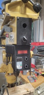

And little project in between finishing the drill press...and before another big one may show up:

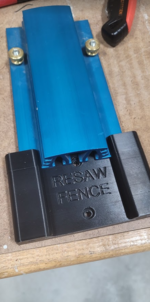

Father in law was cutting some lumber and it highlighted that I need to get a short outfeed table on the saw permanently...so this is a roughly 11" or so deep extension to help until they get big enough to need rolling stands or the height adjustable table
This isn't the final setup...but will be using 3/8" bolts across the angle iron on the backside of the saw, plus (2) pieces of unistrut(one piece painted white in pic below) to attach the top. The bolts will let me fine tune the height adjustment to get it planar with the cast iron. Once I get attachment all figured out and exact placement will put in the grooves for the miter slots

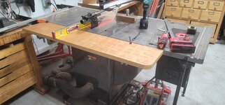

Wife decided it didn't need to be painted(aka she didn't want to paint it)....so in from the garage it came
Kids love it so far and it has gotten some toys off the ground, plus it's out of the garage so a win.
Did get the extension mostly in...
Need to put 1 more threaded hole in on the end closest to the wall to pull it down as its a bit proud of the cast right now...hence the Jorgy clamp that's there. Then clearance groove for the miter slot

Kid closet and SawStop extension table came out great!
Thanks sir and appreciate you and everyone else continuing to follow along!

Speaking of storage for things...printed this to hold the resaw fence piece for the bandsaw....lettering looks a bit like poo but it'll work and remind me to put it away when it's out so I don't see it :)

Speaking of kids....commented in the Everything 3D printed thread about some Halloween handout printed train whistles...first 18 piece print got done a couple hours ago:

While on the topic of screens...walked out the front door today and briefly got excited....
Till I remembered no way did someone buy me these and not tell me and saw they were at the wrong address. So I delivered them to hear "oh we already filed a claim that it was lost"....they probably could've seen them on my porch had they looked out theirs....oh well they're where they belong

  • Finding suitable switch for input power disconnect for drill press project

Snuck in some garage time before work as daycare drop off was unusually calm and easy this am....looks like everything fits, wiring the terminals on the bottom side of the rotary will be a bit tight but looks feasible
That should be the last component I need. Still have to wire the 12v power supply for the LED buttons/spindle speed and another light not shown here and that may test the capacity of the vfd box...but it's getting closer. Also still have to design and fab(likely print) the mount for the sensor for the spindle speed
