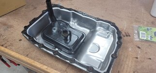

Ok it was too early to call it a totally unproductive weekend
Also tried to marinade parts of the floor with ATF from the 2014 Silverado
Pan finally off, cleaned up and ready to go back in. Factory gasket was much better than the crappy die cut flat rubber one that came with the Wix filter, so factory pan gasket went back on
And it's back in the driveway with close to final fluid level. Little one was getting up from nap but I didn't want to leave it without anything in it so got it at least back on the dipstick.

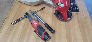

Little recap for anyone doing this down the road
Transmission filter change
2014 Silverado 1500, 5.3L with 6L80 transmission
Approximate time: 1 hr
Fluid required: mine took 6 quarts, I did not do a full flush, just what drained from the pan. Dexron VI fluid
Tools used:
Oil drain pan and sawdust for cleanup not shown.

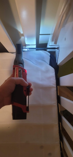

The single, ubiquitous 10mm is all that's required. 6" extension on the M12 ratchet made quick work of the fasteners....is it required...no. did it make the job more enjoyable...hell yes.
You can get the pan out without removing the exhaust Y pipe or jacking up the transmission, but it takes a bit of wiggling. No drain plug, kinda regret not putting a cast pan in earlier when the exhaust flange bolts would have been less aggravating. Swapping the pan to a cast pan with a drain may be something I do down the road if the exhaust needs to come apart anyway.
Online torque specs called for 80 inch pounds, so the Tekton 1/4" click type came out.

Logan, that M12 ratchet is on my list of "needs".
Last 6L80e I did was on our 1500 Suburban that was the wife's DD. Probably another one we should have kept, it was Victory Red with tan interior.
I've gotten in the habit of adding a pan with a drain plug just for the ease of fluid changes...keeps a fair amount of oil off the floor, but not all of it 🤣

I bought the ratchet for some specific project...not expecting to use it much after that and have been pleasantly surprised with how dang nice it is. I was likely jaded by my prior experience with a pneumatic one growing up that I didn't think was that useful, but I grab it when ever I can. I haven't found a need yet for the longer/extended reach versions, but I wouldn't hesitate to buy one if I thought it would make an upcoming task easier.

I have the Milwaukee 2567-20 3/8" ratchet. I have only used it a few times and each time I have used it it has lacked the torque to break anything free. I have to hand break a bolt free and then basically just use the ratchet to remove and replace it faster. Maybe my expectations are to high 🤷
Everything else I have out of the M12 line I love, this is the one questionable one for me. The drill is missing out of this photo, my wife stole it to drill holes in sticks for crafting yarn/bead wall art or something or other.
L
loganb
Dec 29, 2011
5,702
Omaha, NE
I have no idea if my expectations are accurate or not...but they were low from my prior experience so I haven't expected much in terms of torque...but will agree it's no impact. In this case with 80 inch lb torque there was no problem with it breaking them loose, but will agree it should be considered a fast, low angle of movement speed wrench and not anything that's breaking stuff loose.
Looks like Project Farm did a comparision of some of these a year ago...torque was in that low 30 ft lbs which was slightly less then advertised at 35 ft lbs but comparable with others. Torque measurements at 8:40 mark or so
