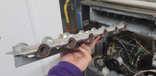

Again pulled out the tools when furnace wasn't working Friday night:
Original to house (date of manufacturer Feb 2005) carrier unit, ended up that it tripped the flame rollout sensor which wasn't where I started as it killed power to the thermostat when it did that and I hadn't seen that in my limited HVAC troubleshooting experience. But couldn't find anything obvious, vent pipe was clear so reset the rollout sensor and away I went and hoping that it was just a strong gust of wind from the wrong direction as it called for heat that caused it.
Narrator voice: The hope was short lived
Fault came back this AM around lunch....so that's not a great sign on a nearly 20 yr old unit
Pulled the burner assy and they didn't look bad, cleaned them up with a brass brush and blew out the debris and reinstalled
Some additional darkening/evidence of heat around burner 2 and 3
So going to see if this does anything, otherwise I probably need to get the video borescope out and see what the inside looks like and get a couple HVAC companies out for bids on replacements. AC unit is 7 or so years old so only looking at a potential replacement of half the setup but expecting that if the heat exchanger is cracked it's not worth it to attempt to repair vs just replace due to age. In good news it did this before I bought spare capacitors for the blower and draft motors!

Well bids on replacement furnaces forthcoming as heat exchanger is bad.
The Carrier dealer is working up the options and lead time for both new with the credit from the warranty as well as replacement heat exchanger and what that lead time would be. In good news CO levels in the airstream were very low, so it's not red tagged.
While small talking with the helper, asked how long he'd been there and it was his first day which explained why the hoodie looked so crisp lol. Turns out he was from Ukraine and had come over with his family in February and over there he was a chimney sweep/repairman but found that wasn't as common over here so was working for a local fence company for awhile but wanted to get back to "heating" type work. Had a cousin who already lived in the area, so when they decided to immigrate they choose Nebraska for that. So far he and his family really liked it here and were sad they were forced to leave but happy with how things had worked out since then which was nice to hear.
2nd dealer is coming out this morning for a quote on a different brand(Goodman/York/Daikin)....see what shakes out, this is the last piece of "original" equipment in the house though as everything else has been replaced so that's a bit of good news.

Ugh good luck on the replacement. Are you considering a drop in heat pump switch out?
Did some digging on it last night as I was curious on what the options are there....at this point not considering it. Biggest issue is timeline...specifically that we don't see us in this house for the time period to really get that benefit. It also makes the install far more complicated as basement ceiling is finished and where the lineset would need to go involves about 40' of finished ceiling to pass thru.
If we saw us in the house for 5-10 years, I'd consider it harder, but I think that as things look now it's probably a 3-5 year house.
First full estimate came back on a 96% efficiency York at $5,758 which includes reconfiguring return air to get a 5" filter box in to replace the junk 1" filter in there now. That's a 2-stage burner with a 5 speed, high efficiency motor. Based on the timeline to be in the house, he didn't recommend pulling any of the other bells and whistles out of the manufacturer's bag like variable speed or modulating gas valve as it was going to add to long term maintenance cost and wasn't going to payoff in our timeline. And even if we end up here longer then mentioned above....it's a nominal 1% efficiency increase on paper.

Repair of existing came in at $1,400, as only the secondary heat exchanger is covered under the extended warranty program, primary exchanger was still a chargeable service. I didn't realize that the warranty only covered 1 of the 2 units and would've very seriously considered repairing if that option had been at a cost of free or sub $500. At that price, the remaining major components(circuit board, blower motor, inducer motor) all cost approximately $500/ea to replace when buying from repairclinic.com and would've been more ok with that....but if even 1 of those items fails after the heat exchanger replacement I'm now at 50% of the cost of new...still with no warranty.
New Carrier with the comparable feature set to the York came in $1,300 less before the cash discount and I was impressed with their tech this AM so so they got the job. Had Carrier not had the warranty buy back which helped that savings it would've been pretty comparable pricing between the two, but I've got 0 brand loyalty here so a 20% or bigger savings with equivalent product and warranty brings the decision down to service and price and no concerns with either on service from what I saw and reputation....so the warranty buyback offer did what the manufacturer hoped.

Install day came early as they had an availability open up which for a "limited heat" situation I've got no complaints about...couple space heaters kept the bedrooms at 70 overnight so the wife was happier this AM :)
I was surprised how many different brands some of the major manufacturers have and how similar many of them were....end of line differentiation and being able to provide "exclusive" offerings to dealers without significant cost/complexity to the manufacturing side. I get the strategy, most manufacturers do it at some level, I just didn't realize how "consolidated" the manufacturers were before digging in.
And yes...this is definitely the cheaper side of the equation. The AC unit was replaced in 2015 by prior owner with a 5 ton Trane and it was 7,300 bucks...so guessing that's a $10k bill now for an equivalent system. We got an awesome binder with the house documenting all the major expenses/receipts/manuals etc from their time owning it which has made chasing down "how old is X" much easier and we're keeping it going to make it easier on us and the next owners.
