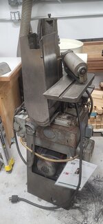

Making the mobile base for the sander:
Somehow I had exactly 16 of the chosen fastener....will have to get more when I decide where the toe brake is going but for now it was spot on....maybe I should go buy a lottery ticket
And she's rolling
Raised the work surface approx 7", maybe a bit high but for it's sparing use it'll be just fine and having it mobile is far more valuable for me then the perfect work height
Next up is wiring stuff. I'll be going with the VFD approach as I already have the main components and variable speed for different materials sounds like a fun "nice to have"....more to come

Pulled the motor to check wiring...and of course it's wired up how I want it (low voltage)
Oh well, needed to happen and lets me knock some more **** out inside of the base. Will get some new wire labels on all the leads and then get a new cord from the motor to VFD hooked up and it can go back inside

Far too nice to spend the last 30 minutes of the 8-5 in the office....the time will get made up later but this was definitely what a former boss would call a "Top 10 Day" with 68, sunny and slight breeze on Feb 20th.....Mother Nature will make us pay I'm sure
But it gave a chance to blow out some dust a bit....love the cordless leaf blower.
After that it was a bit of time with the label maker to help the next poor fool who pulls this motor out....hopefully it's not me.
And ready to go back in the base once I get a cord on it and a new ground attached

Little bit of progress:
The original 12/4 power cord, unsure yet where the vfd will get mounted so leaving it long for now. Wanted to get it back in the base but ran out of time before we had to leave for a party

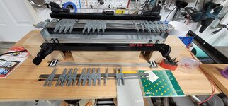

Anyone need a new dovetail jig? Cleaned up and ready to go...the next item to get downsized due to lack of use

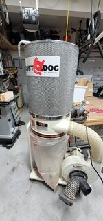

And another slight distraction from current project but a step in right direction on one that's been in the works longer....
3hp Delta dust collector blower...it's actually a barrel top model but I've got the barrel lid already off. Was about 10 minutes away and $80 bucks....but the catch is it's 3 phase.
But it works out as the 2 HP blower I had wasn't really what I wanted or felt was going to work longer term and now that I have some other filters laying around I didn't need the big pleated dust collector cartridge filter upgrade so was looking for a way to upgrade the blower capacity and hopefully allow me to put the other collector back together and on the market to sell....
So....new plan in rough order:
"current" 2HP Jet DC gets put back together and sold...neighbor up the street is actually needing a bigger one and it's exactly what he's looking for so hoping that works out.
Existing 5hp VFD gets pulled off the Delta disc/belt sander and goes back to it's originally intended purpose of dust collection motor control....just for this motor while also working thru mounting and probably some 3D printing of some adapters for intake air on this blower. This project has been drug out way too long so hopefully this helps push me over the hump and removes the mental justification of procrastination as I wasn't happy with the dust collection components.
New smaller frame 3HP vfd gets bought for the Delta...this should allow a few more mounting options...likely ends up being an Automation Direct GS20
