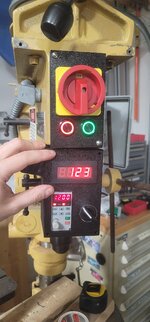

As I'm wrapping up the drill press project and getting closer on the dust collector, went ahead and ordered the components for the sander vfd conversion this AM. Source is https://www.factorymation.com/?lang=en_US
3hp VFD, don't like the price of the new Teco/Westinghouse units so this is a generic-ish one. Will have buttons for start/stop, a switch to flip direction and also speed adjustment in a remote box somewhere easy to get to...probably above the disc sander. Will also put a rotary disconnect in so that I can kill power to the VFD without unplugging. The hope is to mount the VFD inside the base in an box, then have the push buttons and disconnect handy...will see how that goes once the parts show up and I figure out where there is space

You planning to print the remote box or have a box in mind that’s already made up?
Was originally going to buy a metal enclosure like this:
But that price put me off. For 10 minutes of modeling and a couple dollars in filament and a few threaded inserts I can have it printed. Would I want it printed in a higher usage location...no...plus the lack of UL rating could cause issues with some insurance providers in com'l settings. But for my home garage I'm comfortable with printing the enclosure

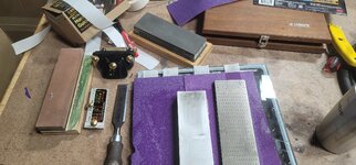

Thanks! And got a bit of time on them tonight:
Some sharpie to see how flat they are before a couple passes on a 400 grit stone
Flat enough for me, then hit at 1200, 3000 and 8000
Got the big boy 26mm done...5 more....now that I know what I need to do figure an hour will get the rest done. Then to plane blades

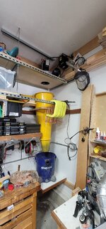

Little sander progress tonight after the bio-hazard generators got to bed
First up...see what I think of the ugliest print in awhile for playing with control locations:

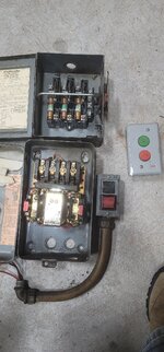

So thinking the 4 button(well 2 button, 1 switch, 1 speed control) will go there, tab off the box onto that socket head screw and it could rotate for either belt or disc usage but think could position it at an angle where either can use it acceptable. I don't like that it requires reaching over the disc to do it...so probably going to print something hopefully less ugly overnight and look at it more tomorrow
Disconnect probably going here(below disc side) where a prior start/stop switch was...hole likely gets cut bigger, then gets a 3d printed box and cover plate. Keeps the run of the bigger wire shorter....would prefer the disconnect and control buttons to be closer....still pondering that
Biggest question is VFD home. I want it inside the cabinet, I don't need a wart on the side to be a shin killer and source of investigation for the kids
There is an existing cover plate that is on the and looks like with the help of a cutoff tool there is sufficient depth...but it's close. The VFD is approx 5" tall/wide x 6" deep
Back of the machine, under the motor is where I'm leaning right now:
Again requires some metal cutting...but it'll get protected from dust in a 3d printed box with a clear front cover and this location has more space to make it work.

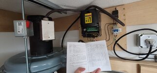

I was getting a bit irritated with it, then read a bit farther and found the problem
Panel Setting 2 was "Default motor setting"....and showed the default for single phase input was 50 hz...ok perfect....I can change that easily.....or not. After half a dozen attempts at trying to change it and hitting different buttons for it to try and hold the desired 60 hz value....I read on
Sure enough...I needed to adjust settings like 9, 13 and something else as well, and before I adjusted the start up default. Cause the Motor Max Hz being set at 50 will prevent your default startup of 50 from changing to something higher...in the end the documentation is better then some I've seen and it's actually fairly decent English and not some other English version translated by a non-native speaker. Just annoying that setting min and max motor Hz isn't before the default...but oh well.

So left to do to make the cyclone functional is:
  • Connection between top of separator and impeller/blower housing
  • Lid and connection hose to the chip container(aka former shop vac canister)
  • Exhaust plenum into the filter assy
After that it'll be
  • PVC duct work(main trunk to be 6" and already have at least the first several elements)
  • Wireless relay to trigger the VFD to start/stop it

Few steps forward
adapter to go from the cone of the cyclone to 6" flex hose printed. need to cut back the bottom of the cone to get a tight fit. Plan is to just attach with silicone but if necessary will add rivets
Next up is the mounting flange for the other end on the shop vac lid
Got the wireless start/stop working. $14 dollar, 4 channel wireless relay from Amazon. It's not how I thought it would need to be wired to work, but it is working and only took up 1 channel instead of 2.
There is currently a separate relay/remote killing power to the vfd. Plan is to rework that so it can run off this same remote. Have also thought and may still just make that "power to vfd" relay be energized when the lights in the garage are on, that switch is already a smart switch so making that happen would be pretty easy.
