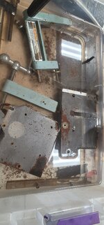

Cause disassembly of something always seems like a better idea then cleaning up or next assembly steps of an ongoing project:
The tenoning jig goes into vinegar tomorrow

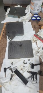

Vinegar did a nice job, couple minutes with a bristle brush got the last bit off
Neutralizing bath of baking soda and water after the vinegar. Dried them off and sprayed down with WD-40 for now. Hoping to get it reassembled today
And a couple clamps came in and confirmed the 5/8 stud clamps do work...so now to really figure out what to do with it

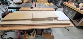

So instead I broke down a sheet of 3/4" for ripping on the tablesaw, this is what was left
Into the sides and top for the dust plenum.

And reassembled the tenon jig
Turned out nicer than expected, biggest issues is the miter bar is about .025" undersized and this one has no adjustment. I have a couple adjustable width miter bars on hand for shop made sleds etc, but the hole to hole spacing isn't right, so this one will probably get a mahogany or maple bar/runner put into it.
