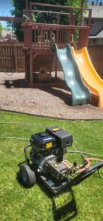

Depressingly little progress on garage projects in the last week or so, once again silly work and life getting in the way, but in this case mostly work.
Mother nature gave a few opportunities for some fun sky watching...most it amounted to for us was heavy rain so all worked out
The hail storm hit the playset hard, and after 3 years since it was installed and refinished (was used when I bought it) it was time for it again. Powerwasher already did its thing, so was now time for sander
Had to hit most of the horizontal surfaces, vertical/angled surfaces the finish was still in really good shape
The deck got a complete sanding to knock down the high ridges with some 80 grit. For a bit it made me regret passing up on the big Festool Rotex sander on marketplace a couple months ago....though a belt sander with some 60 or 80 grit wouldn't be out of place here and would be far far cheaper. Still need to bring out the detail sander and hit around the pickets on the fence posts and a few other spots
While at it...the climbing wall has seen better days and with 2 kids now using it...time for some repairs
The decision to put the slats on the backside of the posts putting the (2) screws per end in tension and trying to pull out of the 4x4 was a poor decision by the mfg/assembler. Assuming it was done to minimize the gap at the top between the wall and the deck...but either way I'm not repeating it and will be screwing these on the front of the post
Required supply to a big box...this time the orange one as selection at blue was lacking:
(6) 5/4 x 6 cedar boards with treatment...so should exceed the life of the rest of the structure. 'Lil Red really enjoyed playing with the carts that could spin in circles and was very upset when I pushed the cart without him
Knocked the boards down to the required 53.5" length with the tracksaw in the driveway. Way simpler...and cleaner for the garage
Which brings us to the end of progress on that part. Still need to strip the hand holds and existing boards, mount the new ones and then restain...but it's mid 90's and a bit humid so all that outside work can wait for a cooler day :)

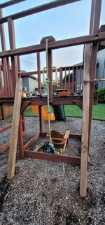

Lunch time shenanigans
Went out to strip the boards off the climbing wall and was wanting to get new boards mounted...no foreshadowing at all
Quickly discovered that the posts weren't as solid as I had thought....
So will be picking up a couple new posts before this goes any farther...so I stripped off the handholds, tossed the boards in the trash can and then brushed off a small army of ants I disturbed...which made me add "spray play area for bugs" to the mental to do list

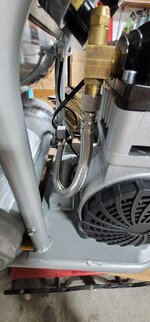

New toy day
Nice packaging
Had to install the 2 air intake filter canisters with intake straws, otherwise was ready to go
For what was a factory blem... Very happy with how it looks
And in its intended spot
Now to figure out next steps
Intending to plumb in a cooling loop of some sort between the pump and tank, that stainless flex line should help make that easier. Thinking about a copper coil loop submerged in a bucket of water. After that will be a filter and possibly a dessicant drier which is total overkill for my usage.
For now I think only drops will be for 2 ceiling or wall mounted hose reels I already own. Debating on how to plumb them, I have a couple rolls of 3/4" pex and assorted fittings from plumbing projects and for ceiling mounted with no UV exposure I'm sure it would do fine.
I could also pick up the Rapidair maxline kit in town at Northern Tool which is what I'm leaning towards
Either way significant progress on this project should be slotted behind dust collector which will hopefully have more progress tomorrow...

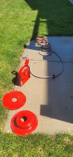

Speaking of reels....this is the first one to get looked at. Reelcraft 4625 which I got off a surplus "stuff" auction at the plant I worked at about half a dozen titles ago. I doubt I gave more then 10 bucks for it, but came out of a prefinish primer booth so it has a solid collection of primer all over it. Once that was kinda cleaned up it was time to pop it apart as it got pulled out of service due to the ratchet not working
After getting the hose off and a couple self tapping screw out...not hard to see why the ratchet pawl doesn't engage anylonger...
Looks to be a $240 reel new now...so I'll see if I can find a spring I can make work in the "Misc hardware" tote and put it back together after the case and the hose get a powerwasher supplied cleaning

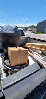

Marketplace distraction
40 or so bd ft of 4/4 white oak at 2 bucks a ft, couple have a decent crook but bigger issue is wtf do I put them as they're 12' lol
In discussion he asks if I need any dust collector stuff.... So to his shop we go. Turns out he's retired flooring contractor selling out and heading to South Carolina
$100 then got the barrel full of 4 and 6" flex hose and the box full of fittings, mostly bought the box for the metal blast gates that will hopefully get installed over the next couple days

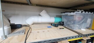

Back to progress for the project that hopefully *****... Pun Intended
Main trunk run coming into cyclone. Ran it straight out of the cyclone as far as I could before I was going to hit obstructions. 6" main, first wye is for a future run up and across the ceiling, then it turns down at a 45
Stepping back a bit
That Wall Control board comes down next and then it will transition to vertical and at the bottom a 6 x 6 x 4 wye with the 4" heading to the table saw.
At this point I'm planning to tape with foil tape all pipe joints but trying not to solvent weld them to make it more adaptable down the road. Thoughts?
After the table saw wye, it will transition to horizontal running to the right with 2 more 45's. Plan is it will be just above the stem wall/bottom plate to loose the least amount of space to push tools against the wall.
