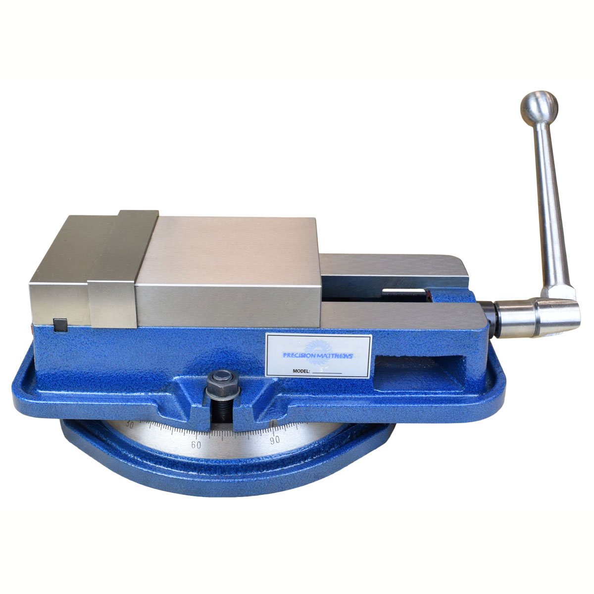

-Vise - I started searching and I'm finding options from $60 - $1,000+. Is there a particular configuration and size that folks generally use? Any recommendations on a budget friendly option?

As far as vises, I have witnessed Precision Mathew’s a pretty good value for a home shop. It’s no Kurt but no where near the price either. Their keyless drill chucks are pretty decent as well.

I ordered a lightly used Kurt 5" vise on eBay yesterday.

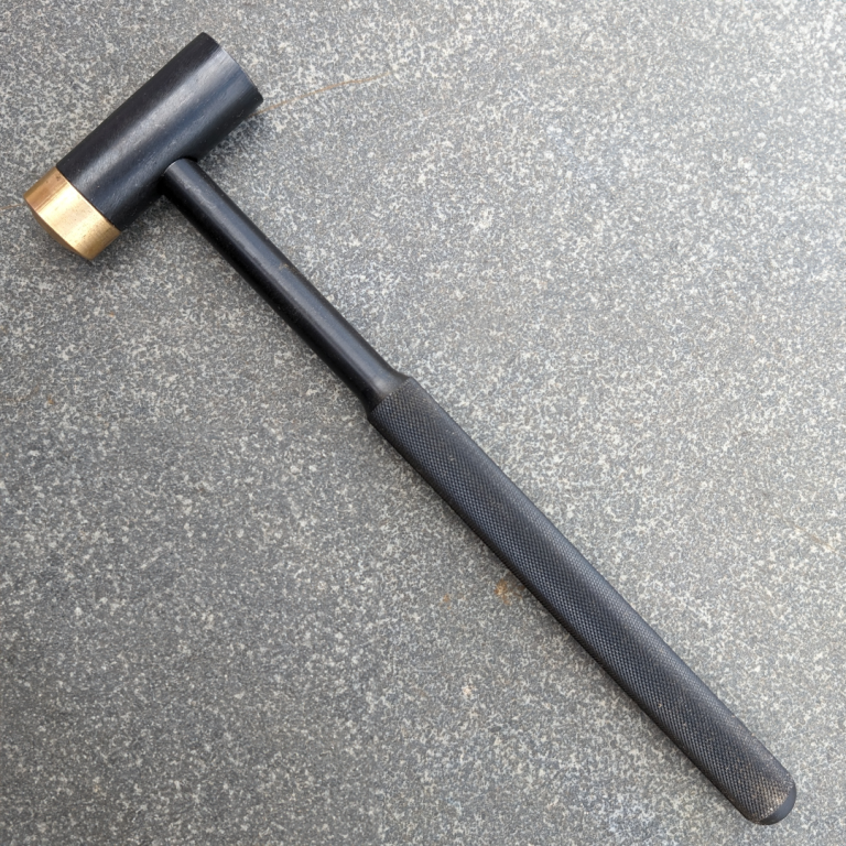

The draw bar wrench I got from H&W. It has a brass end which you can use to tap down on the draw bar.
Nice piece of gear. Did a quick search on their site and didn't see one. Found this on eBay: https://www.ebay.com/itm/4032484373...nOBYrh7ULTAaA6jTIQ=|tkp:Bk9SR8iQ0eK7ZA&edge=0
