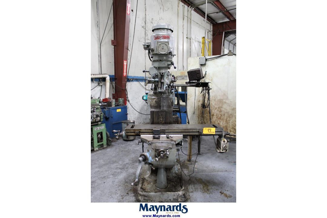

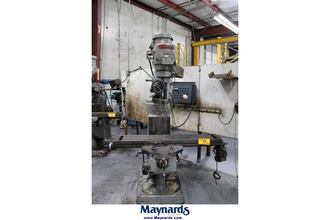

HGR up in Dallas/Ft. Worth has:
From an auction:
I also looked at Craigslist in SA but didn't find much. You do have to be actively looking at more than one source than CL and be willing to travel. It may take several weeks or just contact a machinery dealer. I've dealt with HGR in Cleveland (Ohio) and don't find them anyh more honest/dishonest than any other machine dealer.
