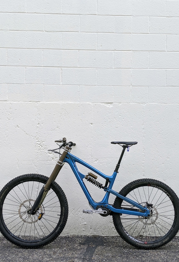

pretty much done. tubing is ordered. sending out some parts for laser cutting aswell.
it has quite a few special details I'll do a write up on when I'm at a keyboard and not on my tablet

Is that "box" near the bottom bracket the engine? lol!
gearbox! derailleurs are so 20th century
this will stay raw. larger chainrings have the force distributed more because of more teeth enagaged at once so they tend to last quite awhile still. rest will be laser cut then finised off in the mill.
still not done in cad yet but playing around with some renderings. tubing just came in today aswell
this bike is gonna be quite different. decided not to worry about any current standards out there and just design what i would think would be best. obviously to sell it like that wouldn't work so well but if i end up selling them ill have different options to make it work with all your standard parts.
Starting off with the rear end because i dont need a cassette i decided to ditch the standard 12mm axle and go to a 20mm to match the front. also because i dont need a cassette and only a single ring out back i can have a wider spoke flange spacing so decided to narrow the rear end to 130mm from the current standard 142. gives me a little more clearance out back for tight spots but lets me maintain a wide spoke flange.
Ive been running very large rotors i designed this year and once issue is the pcd on rotors hasnt changed in decades. rotors have doubled in size since then so it would make sense to increase the bolt pattern as well to give some rigidity to the rotor. This plus the special rear end means i need custom hubs. not a problem. I designed hubs for this purpose. the plan is to machine aluminum flanges and bonded them to a carbon shell. already have the carbon tube just need to get the flanges machined now.
I designed this bike with a floating rear brake. what i didnt want was a big fugly arm sticking out so i hid it behind the chain stay to give it a sleek hidden look. Ill also be using a EightPins dropper post which requires a custom size seat tube and a fixing bolt on the bottom of the seat tube.
Will also use my tapered needle bearings ive been running but the diameter of this headtube is oversized so i can make custom cups to change the reach and head angle if i want to.
im sure im forgetting some more details

Cool looking model, This the first I have heard of the gearbox, I've been of my bike far too long. I was wondering if you have ridden a bike with a gearbox?
How well does it work when your on a steep hill and need to grab a lower gear and you have pressure on the chain to keep going up the hill? I also checked out the P-line Pinion site, is that the gearbox your going to use?. Always thought there had to be a better way. Cant wait to see you build it.

thanks! my current bike uses a pinion and it is the shiznit.
i dont plan on going back to a derailleur bike again. shifting is a little weird at first but you quickly get use to it. you get in the habit of shifting when your feet are at 12 and 6, when least torque is on the system and you kinda of pause for a half second to shift. it becomes second nature and you dont loose any time or rhythm to do it

Love the bike project. What gear range do you get out of the gearbox? How much suspension travel will it have? I'm sure you've checked it but it looks like the rear tire will get really close to the seat tube if you have much more than 4" of travel, but with the USD fork up front I'd expect you were going for more like 6+"

thanks guys. in the pics above it had 170mm of travel front and back but i decided to reduce it to 130mm and go back to my reaper frame which had 170mm. redesigned that completely as well. heres all different models rendered up. have some tubing in. once i get some current jobs finished up i can get onto machining parts for these
as for the gearbox it has a 600% range so its pretty awesome
