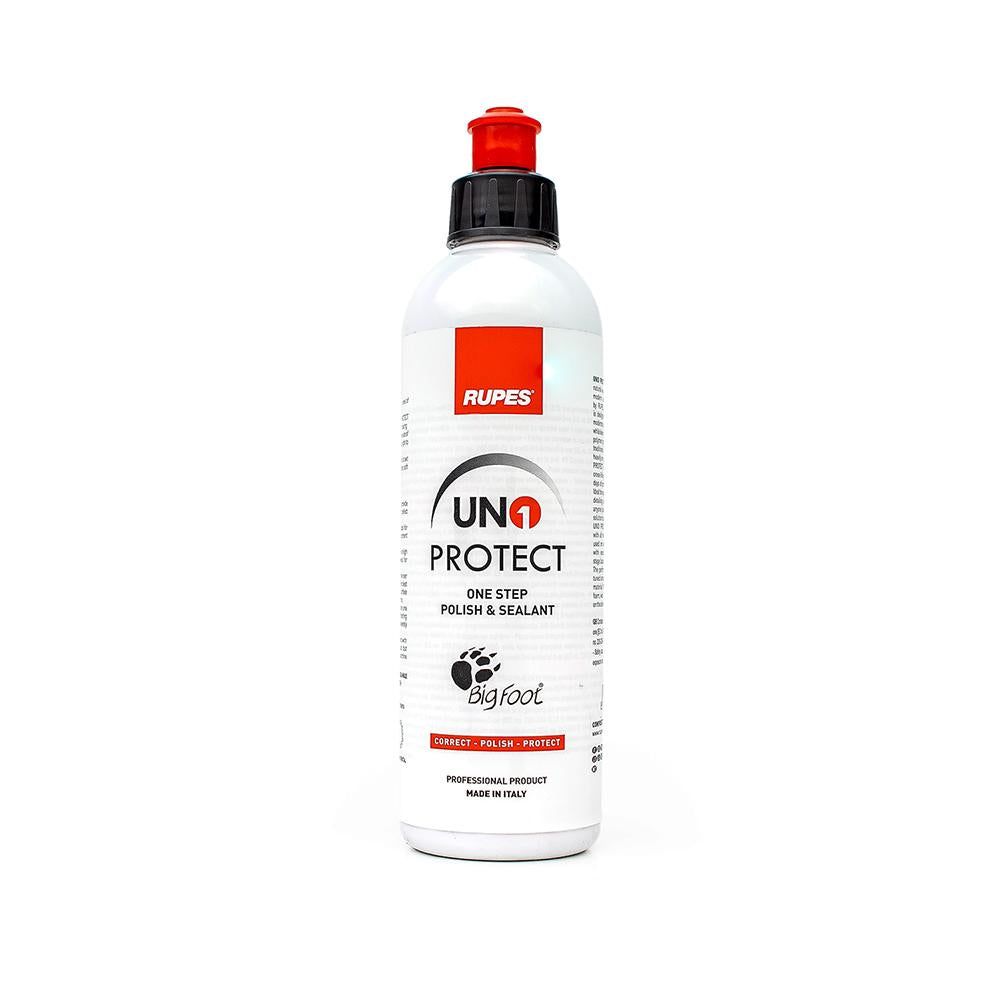

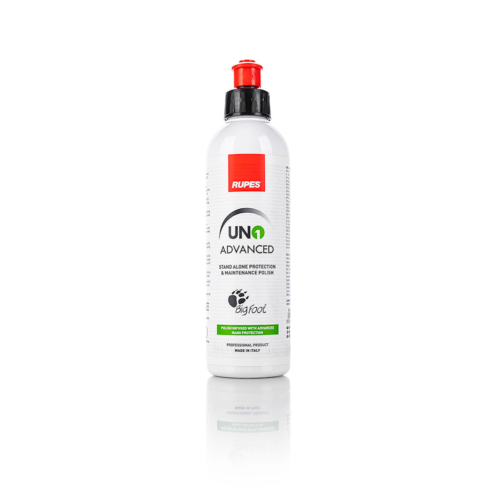

Rupes UNO Protect is considered an All-In-One product that polishes and protects in one single step. These products have existed for decades, and UNO Protect has been on the market for a while now. There are actually two versions of UNO Protect, the original that offers about 3 months protection, and the newer UNO Advanced with up to 12 months protection. The original contains a synthetic polymer sealant, the latest replacing that with an Si02 protectant. Both have the ability to provide correction (pad dependent) and minor filling abilities. For this project I have decided on the original, which I will explain shortly.
https://www.waxit.com.au/products/r...&_psq=uno&_ss=e&_v=1.0&variant=32113941184601
https://www.waxit.com.au/products/r...&_psq=uno&_ss=e&_v=1.0&variant=40265956753497
UNO Protect can be used on both rotary and dual action machines, and teamed with variety of different pad choices, meaning you can tailor the cutting ability to suit your requirements. Today, I am again using the Rupes yellow wool, which will provide some additional cutting performance while also finishing down nicely.
UNO Protect is used a bit differently than traditional polishes and compounds in that you polish the entire car at once without wiping off the residue as you finish each section. This is to allow the sealant within the compound to set up and cure. By the time you have worked your way around the car, its then time to buff the residue. Important to note that I did all of that with a 5-inch machine, with UNO Protect not staining plastic and rubber trim, you don't need to be as precious with pad sizes and taping. As you can see, I also went over the glass.
And this is where using the original version of UNO Protect comes into the story……………..
Instead of simply wiping the residue, the trick is to use P&S Bead Maker as a wiping aid. For whatever reason, this combination of UNO Protect and Bead Maker works extremely well together, the Bead Maker bonding to the UNO Protect polymers to create an ultra-slick and ultra glossy finish. Working panel by panel, spray a generous amount of Bead Maker over the top of UNO Protect, and then begin wiping. The Bead Maker aids the removal of UNO Protect, but also enhances it in the process.
The above is a proven winner for detailers looking to maximize their efficiency while delivering a marked enhancement to the paint. And so that proved here!
