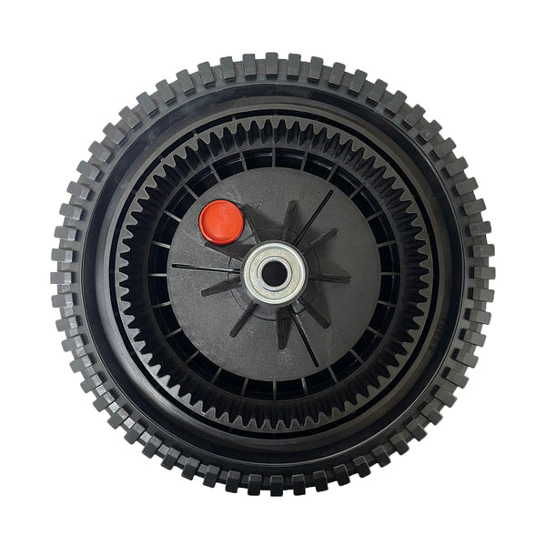

I also received my order or Rover Pro-Cut wheels today.
The two front wheels are pretty self-explanatory and relatively easy to find. The geared rear wheels are much harder to find. To my surprise, they are actually still available from Rover. I think what happens with these is that they are not generally stocked by retailers because of how specific they are and how much they cost. Having a set of these sitting on the shelf indefinitely would be a foolish game to play. As such, searching for these via part numbers alone yielded only one hit, and they were listed as special order. Reaching out to my previous Rover contact and the same applied. So, I ordered two sets!
If you will remember, despite replacing the drive cogs, I gained back then lost two-wheel drive, so the unit was single ******* and pulling to the left. When I pulled the wheels, one was engaging, and one wasn't. As soon as I opened the box, I knew what the problem was, the new wheels not spinning withing the "tyre" so to speak, meaning the left wheel had failed internally and was free spinning rather than engaging with the cog.
So, the unit will be pulled apart again and hopefully this puts things right. Having said that, with how the new Victa Commercial is performing, I think I may have found its replacement.

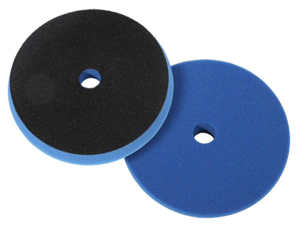

3. Polishing -
You could probably skip this step, but if it was my car, I would. I would start with something like Sonax Perfect Finish on a yellow ShineMate foam pad, if needed I would step up to something like Rupes Coarse on the yellow pad again, or maybe the excellent Rupes yellow wool. After finding the sweet spot, I would then wipe the car down with Carpro Eraser.

3. Machine polishing is one of those things that everyone starts out being afraid of, but is something that you quickly become confident in. I also wouldn't call myself an expert in it, but know enough to be dangerous. In any case, its better to start with DA/Dual Action/Random Orbital type of machine, you really have to be doing something stupid to burn paint with one of these.
You would start out with a 5-inch machine (5-inch backing plate with 5.5 or 6-inch pads), then a 3-inch machine if you feel you want to expand, followed by a 1 to 2-inch machine to get into the smaller areas otherwise done by hand. I also think you want the 5-inch machine with a 15mm orbit, some of the cheaper machines only have a 8mm orbit, which is safer but less effective. I could list countless machines, but I would shortlist down to ShineMate, Rupes, Griot's and Milwaukee.............would depend on budget and preference for cord or cordless.

Up with the sparrows to get out while it was still cool this morning. It's amazing how much weather effects the enjoyment or otherwise of a job, too hot or too cold/wet and I've had enough before even getting out of the car. So, the getting onto things before the heatwave continued its early Autumn tirade made things more bearable. It's been a week of 38 degree (100 f) and above temps, making up for the somewhat mild summer.

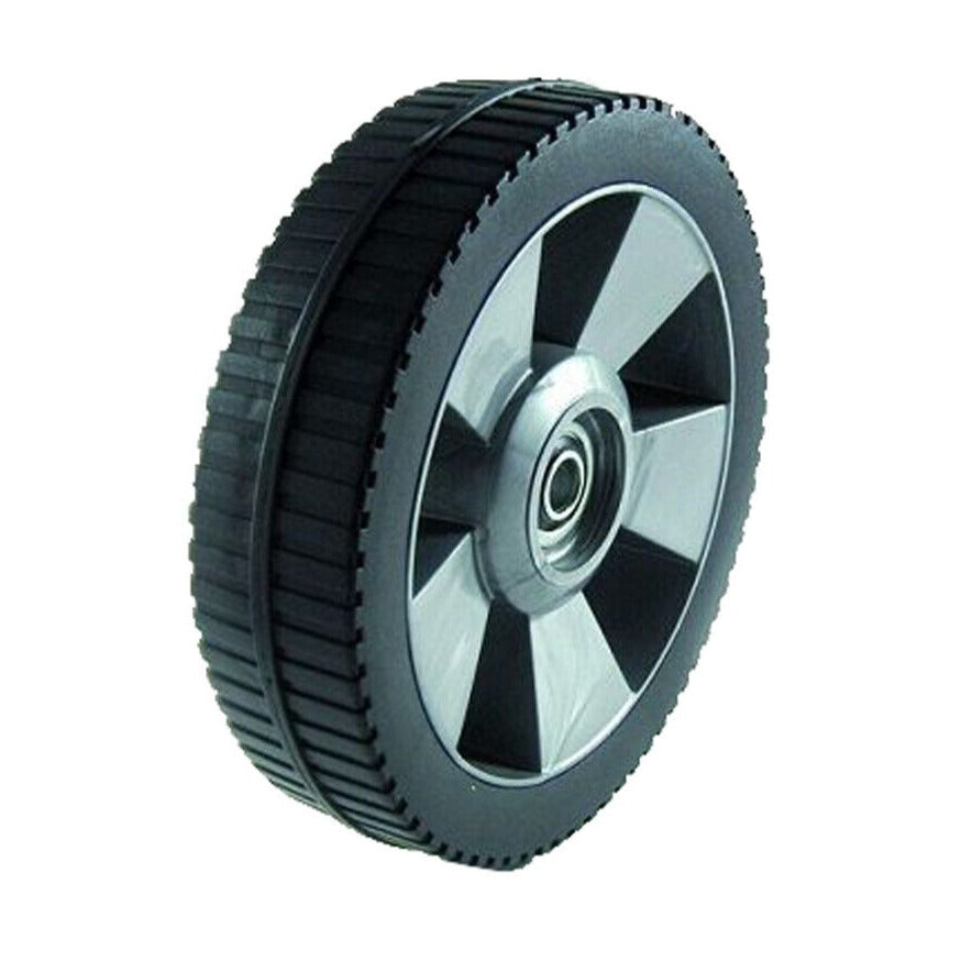

Getting home at about 12pm, it was then into the shade of the garage begin the wheel repairs on the Rover. To recap, I lost drive to the left wheel, which I briefly fixed with replacement of the drive gears and pawls. Shortly after, it again lost drive to the left wheel, which would engage and spin in the air, but not under load, in turn causing it to pull to the left. After pulling the wheels off (again), the left wheel would spin within the rim, but not the right-hand wheel.
Now, these particular wheels are geared to engage with the drive cog. There are two versions of this wheel, one for the ProCut 50 and one for the ProCut 560 that I have, neither are interchangeable. So, a very specific part for a very specific mower. After searching and reaching out to a past contact, it turns out these wheels are still available from Rover, so I ordered four of them! I get it now, these are not parts a retailer will have sitting on a shelf considering how expensive they are and only fitting one specific mower.
In this case, this is the 9-inch rear wheel as used on ProCut 560, Rover part 634-05015 or A10669 -
Knowing one of the two was broken, I didn't know which. As soon as I opened the box, I knew what the problem was, the new wheels not spinning withing the "tyre" so to speak, meaning the left wheel had failed internally and was free spinning rather than locking and then engaging with the cog.
With the hub cap removed, the press-fit wheel retainer needs to levered off with a screwdriver. The old wheel simply slides off, the axle cleaned and a little marine grade grease applied for good measure, the new wheel is then slid onto the axle and a new retainer hammered onto the axle using an old socket to drive it home square.
Old wheel on the left, new on the right. It's at this point I remembered what had been done last time the wheels had been attended to. These are not the original wheels, the shop replacing both the left and then right on two separate occasions, the left-hand wheel being the oldest, somewhat explaining its failure. It also had less "tread" than the newer right side.
New wheel against the old hub cap does things to my OCD............... :rolleyes:
I also decided to order new front wheels. These are relatively easy to find and are considerably cheaper. Again, there are two sizes available, the 7.5-inch for ProCut 50 and the 8-inch ProCut 560. Actually, I was a bit confused what front wheels I needed. Measuring the old ones, it came in at 7.5-inch, which Rover sell under A10621. But the part number on the old wheels was indeed the larger 8-inch A10622. I guess I have lost 0.5-inch of tread in the 10 years I've had this unit. :unsure:
Again, the same process here, removal of the hub cap and the stupid axle retainer, which is part number A03092 for those wondering. Those retainers can be re-used if you are careful during removal, sometimes they snap, sometimes not.
A quick startup, the wheels both turning in the air was a good first sign. Under load on the pavement and grass, we have two wheel drive again! 🥳
I now have two of those rear wheels brand-new, joining the good used one. The failed rear and both fronts went in the recycling bin! This will have the Rover in working order should I need it. I'm just waiting for the that ****** Krohler to blow up and then I can put a real engine on it...........a Briggs 850!
However, with how the Victa Commercial is going, I may have finally found the Rover's replacement! As I had planned, I'm trying to get some content out there on this mower, there just isn't much available, be that images or video. The below is pretty primitive, but it's a start...................
