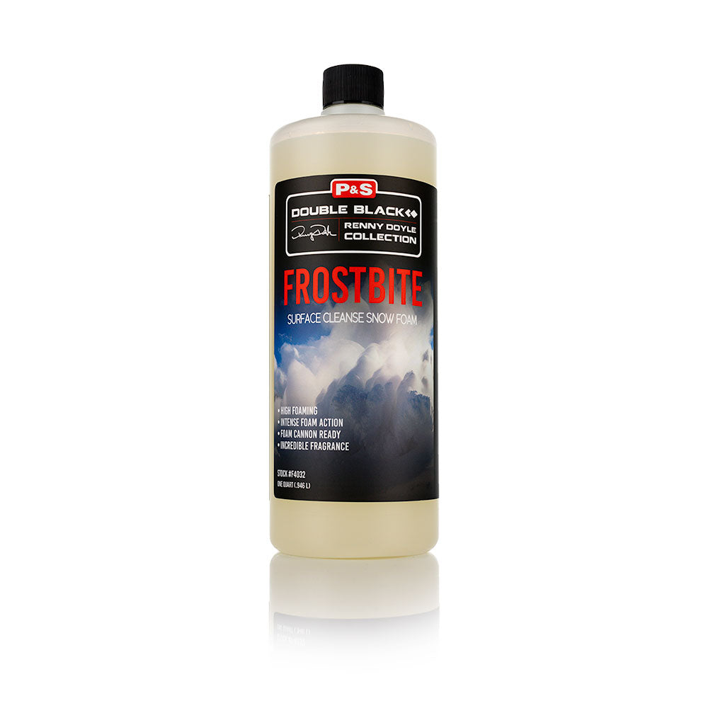

I then had a delivery arrive from CarCareCo, of which the bottle of Frostbite was only unveiled in the USA this time last week, so it's quite unusual to get a just released product so soon in Australia.
Compared to the runnier Pearl and Radiance from P&S, Frostbite produces much thicker foam for extended dwell time. It's also an alkaline soap, with the pH quoted as being 9.9. Scent is Eucalyptus Mint. The DIY Waterless Wash is something I have been wanting to try for a little while now.

P&S Frostbite was only released in the USA this time last week, and yet it's already on sale in Australia, so I'm one of the first customers to use it. This is a high foaming mild alkaline soap that can be used as a foaming pre-wash or in a bucket. The scent is quite unlike any other soap I have used, a distinctive "Eucalyptus Mint Green Tea" mashup.
In this case, I used Frostbite on the Ranger as it a bit of deeper cleanse, the first since the Gyeon Pure EVO coating was applied late last year. Unlike P&S's other soaps such as the excellent Radiance or the terrible Pearl, Frostbite foams like a champ at the suggested 10:1 ratio. It's pleasingly slick and rinses well. Considering the higher pH, I wouldn't use this every wash, but for dealing with tougher road grime or as a periodic coating decon wash, its a solid offering.

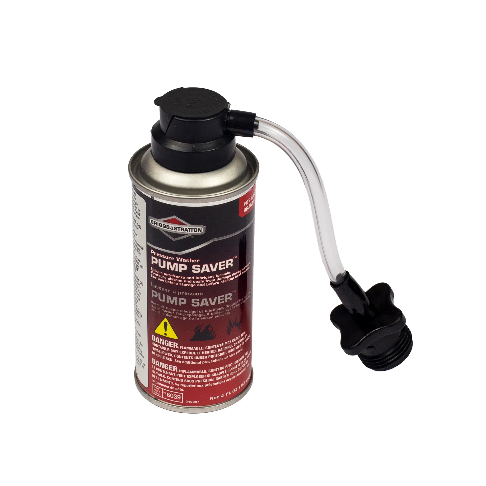

I have also ordered a bottle of Briggs & Stratton Pump Saver. This is primarily aimed at the US market to prevent damage to the pump if it happens to freeze with water in it. However, it also prevents damage to pistons and seals for long term storage or infrequent use.
