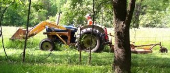

First of the big stuff is, of course, the tractor that came with the house (my wife's genius idea to request it!) As mentioned above, it's a Ford 4600, and it came with bushhog and rear grader blade attachments plus a front loader mounted:
That'll help with the basic surface excavation and grading work, but it's not much help for trenching for footings, utility hookups, etc. A backhoe would be great, but I can't afford to get one... :eyecrazy: Aside from trenching for the garage build, I have lots of other projects around here that I could use having an excavator for (includig digging out a tree stump or two for the garage build), so I'm thinking about picking up one of these:
