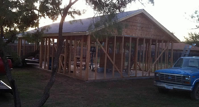

I'd seriously consider holding onto 1 or 2 of those bundles, in case you ever have to replace any shingles down the road.
Yep, I'll keep one. Too tired to put them in the truck last night anyway.

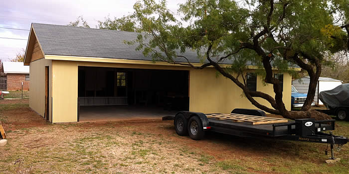

Drip edge is regular galvanized - it'll catch paint when I get to that point.
Not bad for an amateur. Hope it's stuck good. It was a balmy 90F yesterday, tomorrow the high is predicted at 45-50, rain, wind to 30MPH out of the north. Roofing is apparently a good workout, if you ask most of my leg, shoulder and back muscles. (View looking due west)

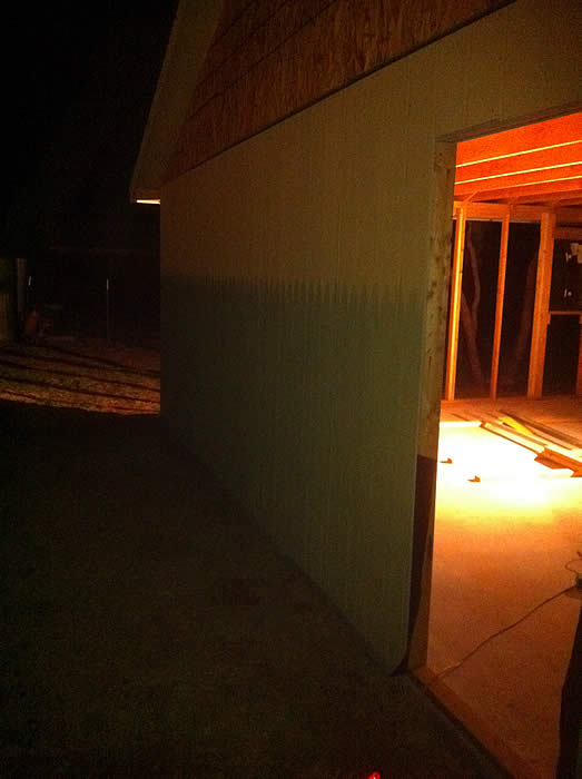

Before I totally crashed, I got up some Z flashing and got the end gables skinned with tech shield. Looks a little less like a picnic pavilion.
I scoped out some Kelly-Moore KM-15 floor paint on my lunch break. Could get walls by Sunday. I was going to put some treated 1x4 about the base for the siding but I think now I may just set some 5/16" Z flash and put up the Hardi. Papa likes the breeze but wants walls.

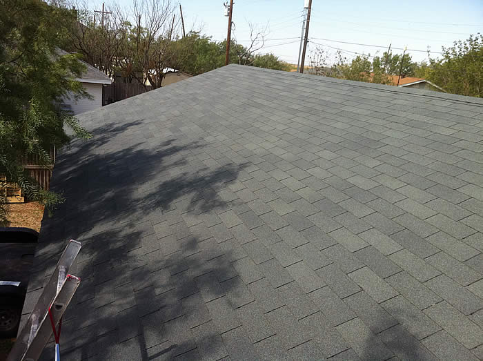

Galvanized, ok iy looked black in that picture. I guess I'm the only one that uses black drip edge. :lol_hitti
The shingles came out looking nice and straight.:thumbup:
LOL - looks that way in the picture and from the street anyway. In real life - plenty good enough. :thumbup: I was going to strike lines, measure off steps - brain said "screw it, mind the exposure and get yer *** to work".

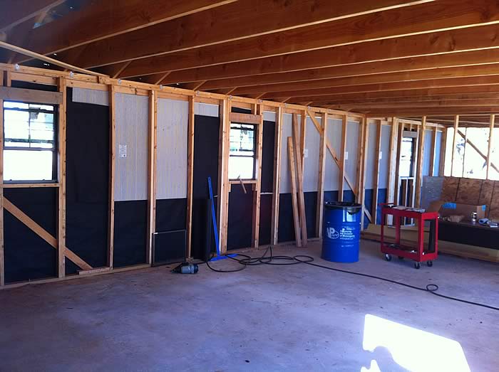

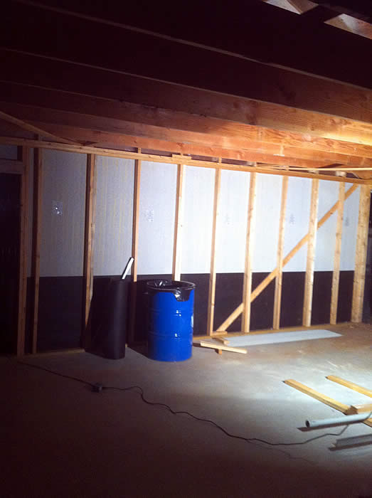

If I had to take a guess, it sort of looks like 2x6 walls 24" oc, to cram more insulation in there?

your studs look to be on 24"oc instead of 16"oc why??
Just did it that way - it's all that is required for the siding. 2x4 studs on 24" for R13 wall insulation. I may go back and add a few studs because after reading the Hardi install manual they recommend a double stud at the joints for Sierra 8. However, I did not use a double on the last building and it worked out. But it would be easier to nail with doubles. I'm covering with HardiPanel Sierra 8 :

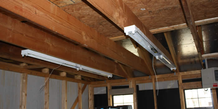

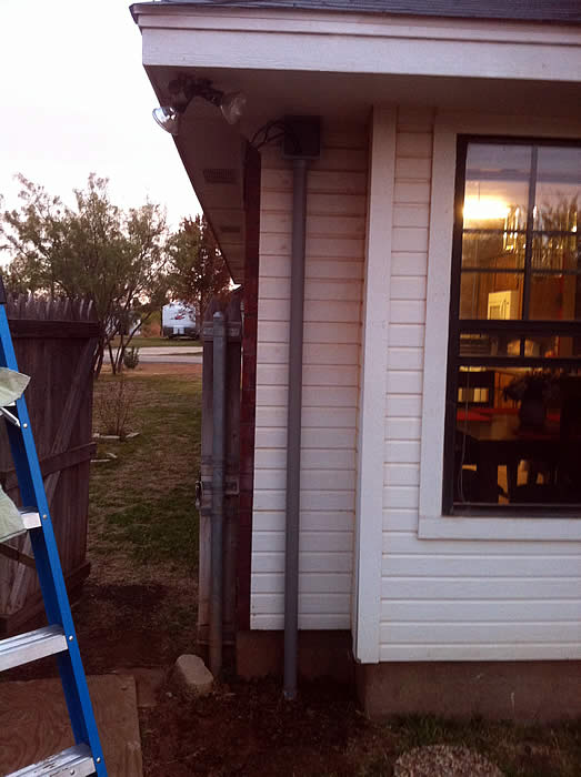

Cold and rain today, so I'll try to run the rest of the power cable through the house attic and maybe get power out there and a couple of outlets hay-wired up by Thanksgiving. I cheated on the soffits - I was going to bore 4" holes for security light buckets on the four corners. After pricing a 4" hole saw that would be used only 4 times, I just punched some 2" holes where the lights will go and will screw the bases to the soffit. I can fish the wires to that, good enough.

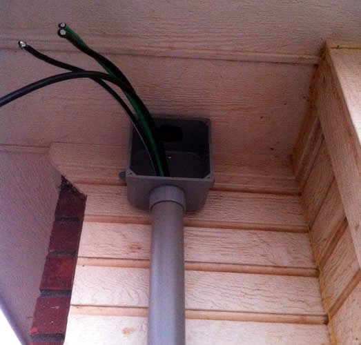

I am not an electrican. Not sure if you have an inspector. But an inspector might red tag you with a missing nut that goes on top of the pvc piece with threads that enters the box.

I have a nut/bushing that fits the top of the plastic but since the adapter was plastic and soft, I didn't think it was required. The insulation on the wire is a lot tougher than the plastic. I am due for an electrical/framing final once I get siding and rough electric. I have a propane heater to help in the space until the ceiling is in.
EDIT - If I had a chocolate chip cookie, I'd air freight it to you. I ran into our company electrician and he confirmed that the bushing is required.

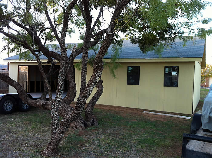

More bites out of the elephant - We got the back siding up today. We have been sitting out in lawn chairs when the weather is nice, so it feels like we're closing in the sun porch.
Wife is going to start the Thanksgiving stuff early while I cut more siding, then see how much we can get done before dinner. Rain coming Friday so we're going to try and box it in. It rained a bit Monday, then was cool and cloudy all day Tuesday. Today it was 70 and nice but we have mud tracked everywhere.
Son-in-law had to work late, so grandma picked up the bitty grandkid and I worked on power after that. Takes two to handle those heavy panels. After a little more attic work I had the feed into the service panel off the meter.
Dinner, a lot of splicing under the eve and at 9:45PM the shop is running on it's own power.

She helped hang siding on Thanksgiving and I peeled potatoes. We managed to beat the change in the weather due in Friday and eat like kings too. We hung 64 linear feet of siding and fed the family all in one day. We're a great team, could not do a lot of this alone.
I did get the man door hung Sunday but not fully nailed in. I have to engineer something for the dead bolt because the way the door is mounted in the frame, it leaves the dead bolt strike hole about 1/2 out from the 2x4 framing for the door. I'll pick up some more odds and ends today and maybe get the big door hung. Last two days have been cold with a 15~25 MPH north wind and today - working of course - is the nicest day of the week. I bought exterior paint for the siding and trim and ordered the epoxy for the floor. I was hoping to hit the lower walls with paint but the next 7 days looks like **** weather - cold and rain on the weekend. I'll be using a Kelly-Moore premix barn red for the exterior with an off white trim color from their "Jazz" pallet. The barn red is very close to our house brick color. We're thinking to do the gables with a horizontal trim board just below the flashing and the gable siding painted the trim color. I need something across the ends to give a level line to set the siding on. I also think it'll break up the big ends with the color change and something to mark the transition. Cutting holes for the soffit vents, gable siding, paint, trim boards and exterior lighting is all that's left on the outside punch list. Everything that's up has been caulked already too.

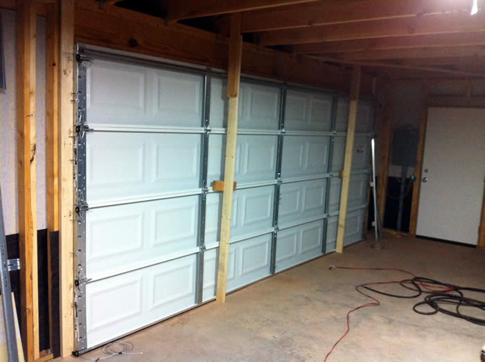

I got the big door tracks up and the door operational Saturday afternoon. After being lazy Sunday built a rack to get the lumber up off the floor so I could start cleaning. It never got above 45F all day and the heater managed to keep the place around 63. Got the lumber put up and most of the scraps sorted or trashed. Finished nailing in the man door and foamed the gap, so it should be water tight. Momma made a big pot of chili for Sunday dinner and nothing but feeding the fire place and watching Holmes Inspection got done after that. It was 30 this AM and the shop was 43. We'll see how the bare shop temp holds up because night temps are to be in the mid 20s most of the week. I think it's holding heat a little because I haven't cut in the soffit vents yet. I'll save that until after I get a ceiling. See - procrastination does pay off sometimes.

fergus
Oct 4, 2009
1,620
Yolo County CA
Awesome progress Chris! You've pretty much convinced me that I can build my next shop whenver (if ever) that ever happens.

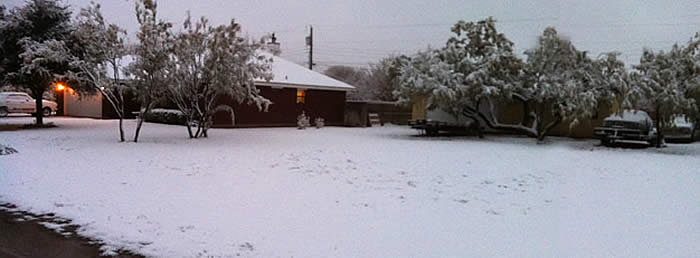

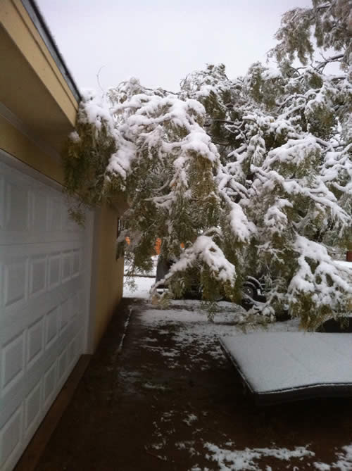

Wow I did not know you got that much snow up there. It was down to 28* here the other night. That is just not right for Texas. Well its warmed up today so I think we are safe. Glad to see you all closed in.

Anybody notice that the day I bought paint was the exact time the weather went to hell in Texas? Mid 60s next week - but rain. It was 48 out there this evening. I got the propane tank filled so between the two heaters I should be able to warm it up some.
