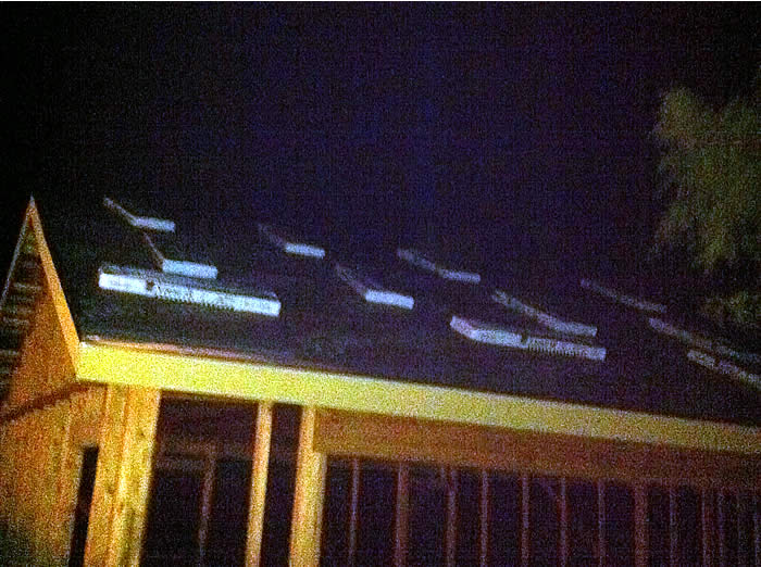

It's getting tested right now. 4" of rain in Merkel, flash flooding in Abilene. We'll find out how that roof paper holds up when we get back from the race tomorrow. Get to pull the cars through Dallas in the rain. gaak. Race update- falcon broke before eliminations, won first round in truck, out second round -.02 red 10.58 on 10.57 dial. Wife going to 3rd round.

Shop content: Building paper still on the roof, work platform in attic all dry. We got enough rain that you can see where the runoff and mud flowed back over the foundation and sole plates in a couple of spots where the slab is only about 3" off the dirt. I hear 4~6" in one day - a LOT for us anytime. Everything looks so clean and fresh and the ground feels like ground, not concrete. That'll last...oh, maybe a week. Maybe it'll pack down the dirt - where there is no grass around the building, the ladders were starting to sink 1~2" inches into the dirt because it was so dry and chewed up.

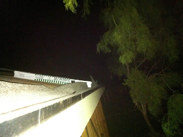

Nothing much new. After getting past the rain storm, wind yesterday tore off part of the roof paper. I'll fix it when I get that far with shingles. Dropped another $900 Friday morning for a pack of starter strip and 14 square of Estate Gray Owen's Corning shingles.

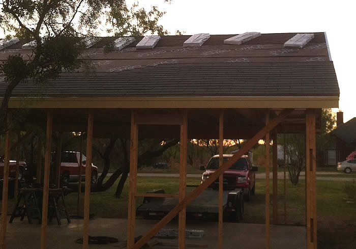

Well, I didn't get too much done Saturday due to work and PeeWee football. Sunday, I was able to get the starter strip put along the eves and I humped some of the bundles up on the roof. It was hot, and after about 16 of those I called it off until dark. Some more delays ensued, so at about 10 I got after it. By 11, I had all 42 bundles up. Graiiny cell pic for ya.
So good thing - got a jump on it for Monday. It was hot today (Monday) and was 96F when we got home. And to show that no good deed goes unpunished
Moisture in the bundles had wicked out in the heat and allowed many to slide down the roof and rip the starter strip to shreds. One bundle even made it to the ground. !@$!#@. OK, damage control starts. The weather service said Sunday that we'd be getting a good size cold front Monday night. About 6:30, we got it. I'm working the back side (north face) first and about half way through the second bundle when the wind makes it to 30 MPH. It got them down and didn't lose any, but it was touch and go for a while. I tried to hang on to my hat, but it ended up across the street. When the front came though Lubbock, it turned Lubbock into a dust bowl and winds were 61 MPH. If we get that here, most of what I've done will just fly away. Arf. I moved most of the bundles up close to the peak to try and pin down the paper, so we'll see what happens overnight. Right now it's 73, down from 96 (a record of course), wind steady at 15, gusts to 24. IT's going to hit 40 tonight, so anything I put down won't stick until tomorrow in the sun/ Not much I can do but sit and wait it out.

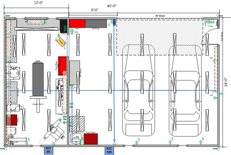

Falcon - Are you putting the Dayton G73 heater in the new garage as well? You provided pictures and help when I was installing mine 2 years ago.

Yes, it'll be in there. Glad to have been some assistance to you. I'll put it in the 4' doorway between the "clean room" and the car shop so I can swivel it around to blow heat where I need it. Still jacking with the overall layout but here's the current idea:

I would strongly suggest you have 2 9' doors instead of the 16' door. At our current location it was a 16' door. It seemed like it was always a struggle to get cars in without banging my own car doors into another car in same garage. We turned the garage into a family room and built a new 2 car garage with the 2 9' doors.
I have had both. I would not want to go back to a single large door for 2 cars.
I would also suggest the walk in door on the side swing towards the car entry doors or front and not into the cars themselves.
Hope you don't mind the suggestions.
Just a suggestion.

royal - I started with dual 9' doors but when the building shrunk 8' (original target was 48') I compromised with the 16'. I need the off-door floorspace. There's 28' there and dual 9s would have chewed up 23' of that. I've had both cars in the house garage with a 16' door and it wasn't too much of a problem. Dual 9's would be better. Too late now anyway - 16' door kit is already here and waiting to be installed. It's still better - the old shop had a 8' door. Try backing off a trailer and hitting that bitty hole.

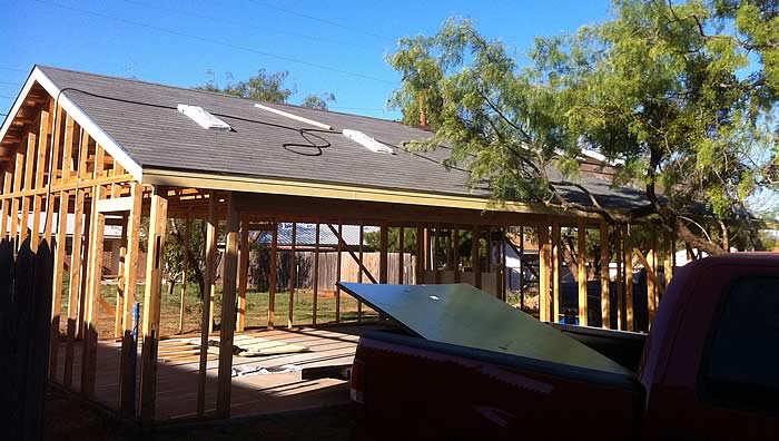

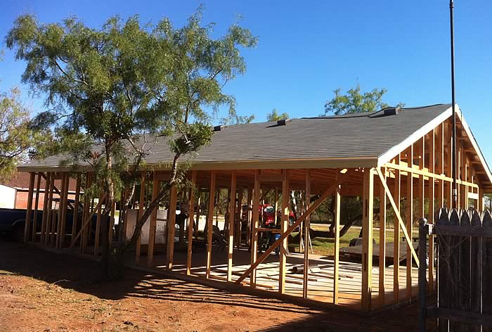

I've got about 16 hours into the shingling so far. Cold front with rain predicted For Thursday, so I gotta stay on it. Man, that is work. Getting a great tan for winter in sipte of the SPF 55. I just keep thinking how much $ I'm saving pounding this out. The Porter-Cable gun I bought has an adjustable stop on the bottom you can set to your shingle reveal, which helps speed things along.
North side done, south side almost half.
I speced it out at 14 square which is 42 bundles, 21 per side. Not counting caps to be cut, I pulled three full bundles unused off the north face. 6" offset doesn't excatly match the house but seems to be reducing waste.
I'd be farther along on the south side but I cut holes for the vents at 2' down from the peak. That turned out to be short sighted, because if I had lowered them about another 1 1/2" I would have eliminated having to trim the shingle row passing over the top. Oops. That added about an hour to the finish work at the top.

Counting nails, paper, flashing, starter strip and 25 year Owens Supreme fiberglass shingles, I'm out about $1140. That may come down if I get to return 5-6 bags. Not sure what the job would have quoted out. I'd guess in the $3000+ range around here. No dog people this time.*
*Last shop, I got laid up with a kidney stone just before starting the roof. Had the decking done, but nothing else. The people behind us were renters and had a bunch of dogs. Nice folks, but too many dogs. Turned out they were also a roofing crew. The guy asked about the roof and when my wife told him I was out of action for a bit, they offered to paper, flash and shingle for $100. They banged it out in an afternoon and we gave 'em $200. Nice.
Edit - I bought a box of 2500 nails, thinking "that should be more than enough". Ah - the OC web site says 80 shingles per square, 4 nails per - that's nearly 4000 nails to finish. Oy.
EDIT - the box holds 7500. So we're good to go.

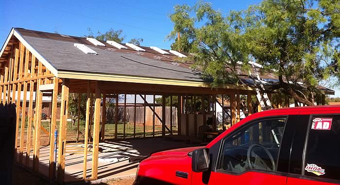

3 1/2 more hours this afternoon. Moving right along!
Took off Tueday to finish. It'll be 80+ the next two days and then a front is due in Wednedsay night. I'd like for the shingles to have a chance to get a good stick before we get a shot of wind, cold and maybe rain. Should have the tech shield up on the gable ends by tomorrow also.

Roof done in time for lunch. Wind 25+ MPH today and it peeled more than one shingle out of my grip and off the roof. But I got it over with and I can return 5 bundles. Very little waste. The only real big waste was the two shingles I cut wrong when going around the vents. Yea, yea, measure twice and cut once eh? Well - I cut one, well ****! Measured again, cut another - well ****!. Climb down, get into the Halloween candy, take a break, try again.
>Think this is the first build I have seen with the roof done and no siding on it yet.
I'm sorta working the problem from the top down. :lol: The siding goes right on the studs with no backer, so I wanted to get the roof dried in before starting to finish out the lower sections.
