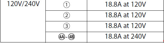

@Rick_Br says his generator is a Honda EM5000SX.
Attached is the manual I found.
On PDF Page 43 (manual page 36), it states the unit has a floating neutral, which is good for the OP's connection to the home. The wiring diagram is on PDF Page 102 (manual page 95). I did not study the wiring diagram to confirm the neutral was floating. This floating ground is reiterated on Page 68/61.
PDF Page 63 (manual page 56) talks about a voltage selector switch to fully enable the 240V receptacle (L14-30R per the wiring diagram) on the generator. This is also discussed on PDF Page 35 (manual 28). The switch must be positioned to "120/240" to enable both legs of the 4-prong receptacle. Looks like the 240V outlet is limited to 18.8A (both legs) if I read this correctly (Page 64/57).
Looks like if the selector switch is inadvertently left in the "120V" position, it enables one leg only of the 240V receptacle (Leg 4A would get 120V30A while Leg 4B would get zero). Study Page 64/57.
  • Honda EM5000SX Owners Manual.pdf

Larry - I certainly appreciate your research and the time it took but I gotta say I don't get it :).
Can you talk more about the "floating neutral" - not sure what that is and how it might affect me in terms of hook up.
I mostly understand the 120/240 volt selection. For my education -
1. if the selector switch is inadvertently left on 120 then the panel would receive only 120 and only one side of the panel would be active?
2. With the selector on 240 would the other 120 outlets on the generator also be active?
Rick
That is my read as well assuming you are using the 4-prong outlet on the generator.
Rick
That is my read as well.
Also note the amperage limitation for the 240A outlet of 18.8A.

The generator is correctly configured with a floating neutral for connection to your house.
Set the selector to 120/240 when using your inlet on the house.
The 120 only setting puts all available power into the 120 receptacle on the generator. It has a 30A 120V receptacle If you had a camping trailer with a 120V 30A inlet you would use that feature.
If you were using the generator stand alone and not connected to the house you would want the generator neutral bonded to the generator frame. This can be done with a bonding plug.
