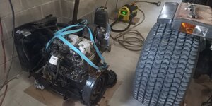

Keeping it brief, the input shaft from engine to gearbox has one shaft inside another. Theres a needle roller between them. That failed. Major nightmare. A common failing it seems,

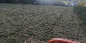

After a lot of buggering around with attachements, top links and all that other stuff, we got cutting
Surprisingly effective. Not done this before. Bit to hard and aggressive here

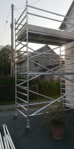

The observant amongst you might have noticed that the open eaves have now been sealed up with a foam filler strip. During the winter, with regular 90% plus humidity, things were much the same inside. The difference was very noticable. Yes, i still need to insulate the roof, but thats for another day.
The sheer scale of the roof meant this took a very long time to complete, all done from the scaffold or man basket on the forklift.

Further up, there were some pics of the tractor flailing the field. All was well for a while. Then one day, i couldnt change gear. Felt like cluch not disngaging.
Rather inconvinent to say the least.
Nothing for it but to fix it. With half my stuff packed away or in the wrong location, it was a bit of a struggle.
So i split the engine away from the front axle. Sadly, the result was very much a case of nothing to see here. So i decided to lift the lid of the main gearbox. Which was no easy task with everything rusted solid after 10 years outside. Eventually got that done. Still nothing to see. So then i split the front axle away from the gearbox.
At last. As you can see from the pics, the input shaft has another shaft inside it for the PTO. Seperating the two at the output end is a needle roller bearing. This lives outside either the axkle or gearbox and is thus not lubricated by oil. Relying solely on the grease installed at time of assembly.
Clearly, during its period of inactivity, this has corroded. Subsequently pressing it in to use has caused the bearing to fail. I might have got away with cleaning the shaft, but given the work required to get to this stage, i decided a new shaft was in order.
Not cheap at £600, but, in fairness, during the work on this, its become clear that virtually everything is available despite its age. Thats a level of manufacturer support thats rare these days. Big thanks to Kirkland tractors for their help here.
And so the re-assembly commences along with a few minor repairs along the way.
The down side was it was out of action for a couple of months, giving the weeds etc time to re-establish. And in July, the rains came, and never really went away again, putting paid to getting out on the field again.
Anyway, here some pics.IMG_20230608_200058.jpgIMG_20230608_200105.jpgIMG_20230608_200047.jpgIMG_20230601_203216.jpgIMG_20230601_203227_resized_20230601_090219066.jpgIMG_20230608_201717.jpg
