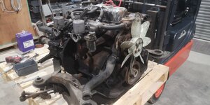

Loose plan is to use a triumph 1500 engine instead of the original 948cc unit. Good news is they a physically identical, induction and exhaust aside. More on the induction later.

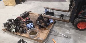

More fortunately still i have a spare unit and gearbox sitting on a pallet, alledgedly low miles (i took it out of the car) but clearly has had an issue as there was a head gasket set with it.
So, off the shelf, split from the geabox, and stripped. To avoid making a mess of my "clean" room, this was done in the main workshop. Ill let the pics do the talking.

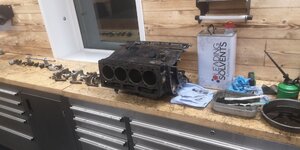

After this, lots of parts were cleaned in the parts washer.
So what did we find? Well, its all stock size, which is getting rare these days. Minimal wear on anything.
However, its clear that 3 & 4 have had water in them. Probably for a long long time. Car it was in had been off the road for 20 plus years. Remarkably, whilst these some staining on the bores, theres no pitting. I rekon with a hone it will go again.
Down side is, the rings on 3 & 4 are well and truly stuck. No obvious signs of piston deformnation, so maybe just corrosion. Good news, i scored 3 matching used pistons on ebay. Will asses once we have everything.
I then got carried away with more cleaning inc bead blasting smaller stuff. No pics. Ill get some. I love doing this, but its not fast. I reckon i have 2 full days in cleaning. Still its engine building. Clean is the right way.

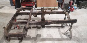

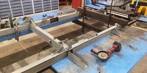

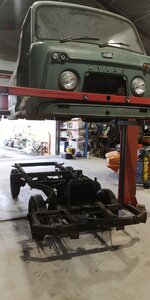

First job was to get the body off the chassis. As i want to do the underneath, i really needed it on the 2 poster. There is, however, no practical means of lifting it, the body have no useful structure around it lower portions.
The workshop manual details the front lifting point behind the grill. Theres no rear lifting points! The workshop manual says splitting the two "will present no difficulty". Handy info!
So i devised a frame. Crude. But it works.
With this in place, everything was disconnected and up it went. Ok, it wasnt that straight forward, and a fair bit of use of the "heaty up tool" was required
With the chassis out it was then duly stripped to a bare chassis. More heaty up tool use!

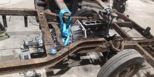

The original engine is a 948cc unitm 4 speed manual with a 6.61 ration axle. Not great for progress.
The later triumph 1500n unit is development of the original engine and is identical externally. So fitting that was on obvious solution. Thoughts of a stag V8 were consigened to the dustbin.
The gear selector is, possibly the worst design ever and completely unhandy. Somewhat controversially, ive decided on an auto for this. A ZF422HP from a LDV Sherpa. 4 speed, lock up, entirely hydraulic. Problem is. not one does an adapor. Which i guess is no suprise.
A mock in wood was required to do a test fit.
IMG_20250124_104756_resized_20250321_091035742.jpgIMG_20250124_105152_resized_20250320_084955400.jpg
With wrapped up, off to a nice man to great an aluminium version.

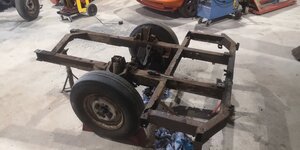

On this vehicle, the chassis is in 2 halves, the idea being the front half, complete with driveline could be easily removed for repair! Which they needed. Often.
With the engine test fit done, time to dismantle the remainder.
Yet more heaty up tool.

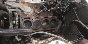

Sadly, the return also reminded me of the job on the Triumph Stag i needed to sort out.

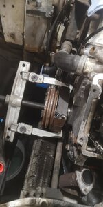

Prior to going away i moved the stag where it had been parked for 4 months. When starting it, it hydrauliced. Water in umber 6 cylinder. Not good. Though it is a stag, so not a great surprise. I had had an inkling all was not well for some time, but had not managed to pinpoint the issue.
As some may know, these are notorius as one row of head studs are angled to the block.
So, first job, see if i could undo the bolts and studs. Despite penetrating oil, lots of heat etc etc, the 5 bolts came out but 3 studs snapped .
Im going away mid april on a weekend jolly, then southern france in June. Needs to be working. But Atlas still to do. And major housework.
Normally at this stage, id pull the engine, but we all know how that will pan out. Plus engine bay is scruffy original paint, so id end up restoring that. No, plough on and try to repair in situ.
Tried and trusted solution is a 8mm piece of angle bolted to intake of head and jack it off. Not done it before, but managed to get it circa 1 inch off the block, which allowed my to cut the studs. The downside is that means dropping the cam wheel off and then the chain tensioner ratchets out, so needs front of engine off too :(
It was a long fight, including with the crank pulley, but the head came off.
Turns out, theres three significant rings of corrosion in the bore, so clearly been like it a while. Whilst anyone half competent would say rebore and new pistons, now is not the time. Plus it had been running just fine after at least 2 sets of corrosion had occurred. So decision made to put it back together.

Whilst that ewas going on, and in better news, i collected the freshly blasted chassis and fuel tank. Pretty pleased how the chassis came out. Not that much extra to do.

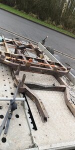

A distinct lack of updates here. This Atlas project seems to be taking over my life. Along with some of the outdoor jobs now the weather has improved. Dryest sunniest spring ever. Apparantly.
Anyway, whilst out buying another car, well another pick up (more on that later) a road closure forced a diversion. Whilst sitting in the roadworks, out of the crner of my eye i thought i saw an Atlas. Surely not. Well yes. And a pick up too. So maybe that seven in exsistence? Not that this one will ever see the road again.

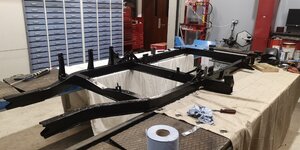

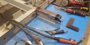

Back in the barn, time to finish off the chassis welding.
And finally, some painting.
Given ive not finished my spraying area, and the chassis is pitted pretty much all over, i did it with epoxy mastic brushed on then rollered. Looks rather rough in pic, but was still wet. Dries to something like a 30% gloss finish.
Progress!!!!

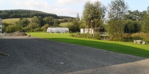

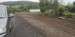

Having got back home, we were having, probably the driest summer ever. The ground here is hopeless and even in summer, often not firm enough for machinery to venture out.
This year, more like concrete. So time to crack on and do a bit of landscaping, drainage and paths. The grass area near the house was killed, harrowed, levelled, harrowed and harrowed some more. Then limed. The soil is quite acidic and deficient in magnesium so drains poorly.
And then rolled. With a roller kindly borrowed from a neighbour.
I installed some land drainage at key points, and then set about installing paths to the poly tunnel and sheds using drainage stone as the base and the pile of road plannings left by the previous owner to finish. Although i said all that quite quickly, it took about 6 weeks to get it done. For the more eagle eyed, it probably looks unfished on the side where it jois the yard/drive. Which is because it is. Some of the yard will become part of the lawn in due course, but thats a project for next year.
As usual, photos are a bit sparse, sadly, but hopefully you get the general idea?
Not sure what happened to the pic?
It was suggested not to seed until september to avoid the risk of it being to dry. Being in Wales of course, meant that sooner, rather than later, the rain would come. And it did.
In the last pic you can still see the work on re-working the septic tank lids is not yet complete. Sadly, as i type its still not complete. A hateful job.
Now we just need to let this establish itself. Its certainly draining much better than before, so breaking it up and liming it has at least achieved something.

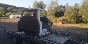

Whilst midway through lawn re-instatement, whilst perusing ebay i found a must buy.
Those who are paying attention will know that ive bought a chevy truck for a full hot rod build. However, thats going to be a while before i get to it. But, well, you know....................
So, some background. Much as i love these trucks, the tall roof can make them look a bit "greenhousey". A slight chop really sorts out the proportions. Small problem, ive never done a chop. Probably could, but the whole glass thing is just too hard.
However, the other issue is that, really, the cab is just to cramped, as in not long enough. The solution to which is to make it longer. Obviously!
Some googling later, its clear that a side benefit of this is with longer doors and sideglass, the proportions improve massively.
So what one needs is another cab so they can be joined together in a longer format.
Problem is, im in the UK and getting a cab would, invariably, involve finding one in the US and shipping it over. Difficult and expensive.
Whilst on ebay, there it was, an essentially rust free cab. In the UK. On the other side of the country, but in the UK nonetheless. Whilst i wont wont be doing this project soon, and could do without yet another large thing to find a home for, this was an opportunity that couldnt be missed. So i went and got it :). Though the 2:30 am start wasnt great!
Could do with a fleetside bed too though................................

Good to see your Stag on the road again. I had put the largest electric cooling fan I could find to keep mine from overheating. It did seem to help. I also had a 12 vane water pump instead of the 6 that was in it, mine had blown head gaskets when I got it, multiple broken studs was not a lot of fun fixing that but a learning experience. I miss that car.
Ahh, the old 6 or 12 vane conundrum.
In reality i think its well established now, that at speed, there is minimal airflow over the rad. A chin spolier fixes that. As i found out on my revious stag. Quite remararkable to be honest.
