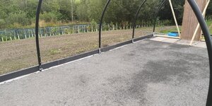

With summer upon us, i could no longer put off the polytunnel build for the wife.
So back outside we go.
First job level an area for the tunnel. This created a big pile of soil so this was spead out on the adjacent bank. Having roughly levelled this out, it was an ideal opportunity to try out my New (to me) power harrow.
Its certainly effective, but due to a lack of foresight, with the tractor being quite wide, and the harrow significantly narrower, meant that it was compacting the soil back down on the next pass. Not ideal
Still got it done, and reseeded it.
You will see in the area where the poly tunnel is going (cleared a couple of weeks earlier, there is on old paved base. This was orginally a greenhouse base. The idea was to widen it with matching slabs found stacked up behind the barn, and have them half in, half out of the tunnel, giving good hardstanding around the entrace.
This was a home built affair to save cost, and with a base from road plannings from the handy pile left in the yard by the previous owner.
I think the method of construction is self explanatory.
Handily, the doors were from my extensive stock pile of doors, so probably over kill for a polytunnel, but they were there, so why not.
Heres a few more pics
The eagle eyed amongst you may have spotted we put a drainage loop around the tunnel as the far end in this pic sits slightly below the ground level.
